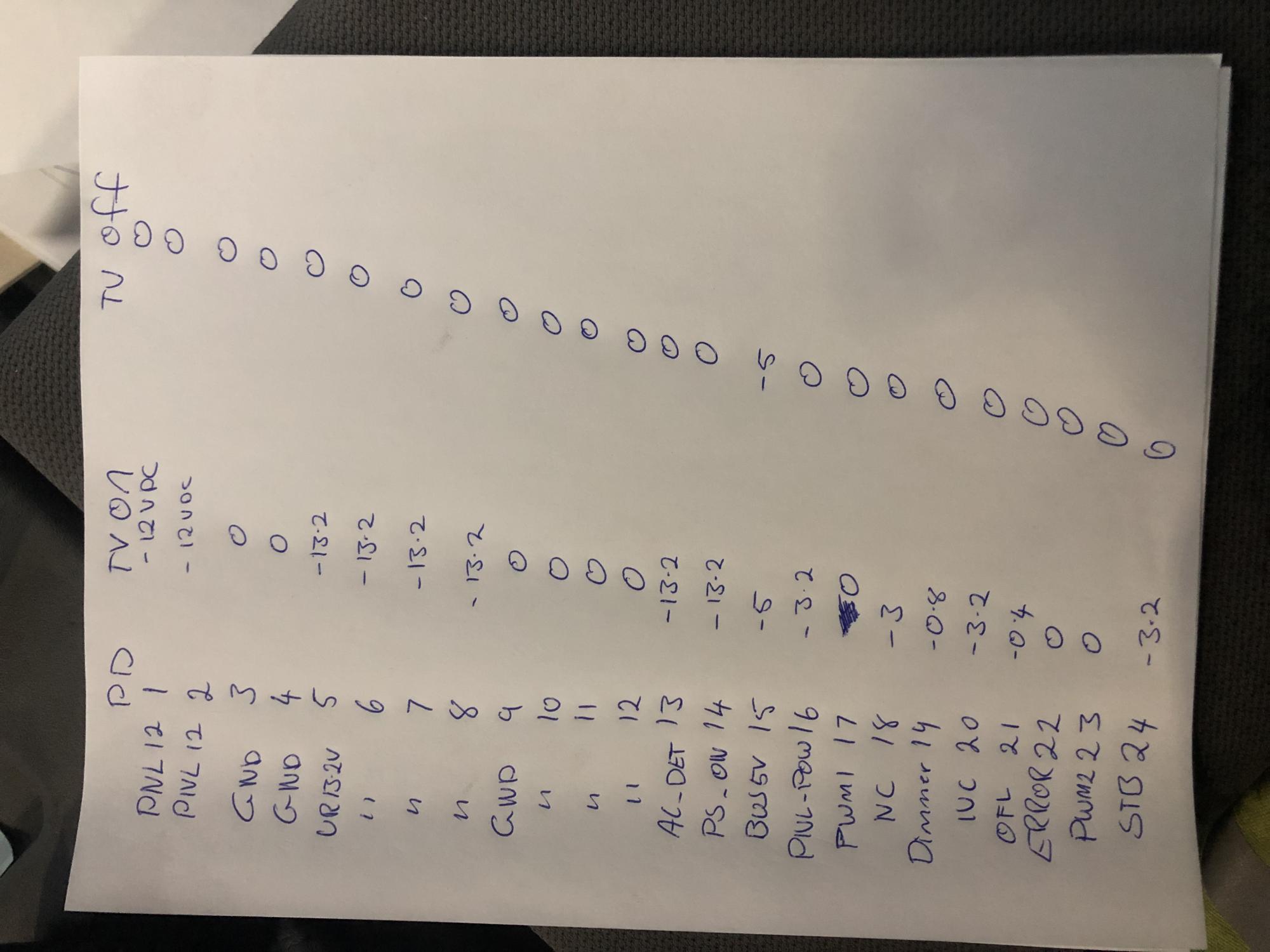

                                    • Forks
                                      • Aug 2019
                                      • 6
                                      #98
                                      Re: Sharp LC-70C8570U
                                      Hey Guys, this is the only thread I can find similar to a problem I have. I’ve got a lc70c7450u,l. It had a dead main board which I replaced with a used. The original problem was it was completely dead. Would flash three times then 1 quick.
                                      The new board fixed this but my backlight won’t come on now. I have a picture with a flashlight. I’ve tried hard resets. I’m missing my PWM1 signal jumpering it out turns the backlights on.
                                      I’m guessing the t-con board is bad.
                                      Does anyone have a schematic for this?
                                      • nomoresonys
                                        • Jan 2013
                                        • 12307
                                        • U.S.
                                        #99
                                        You have a backlight problem, do test #3 below, as always BE VERY CAREFUL working with powerboard, DEADLY VOLTAGE on the HOT side, that connector you will be testing is on the cold side.
                                        • Forks
                                          • Aug 2019
                                          • 6
                                          #100
                                          See the photo attached.
                                          I did this quickly before I left for work but I'm pretty sure I Got all the pins numbered right.
                                          Everything looks good to me except PWM1 & PWM2.
                                          I did notice all my voltages were reading as negative. Is this normal?
                                          Unless I accidentally had my meter probs connected to my meters backwards but I doubt it 0.o
