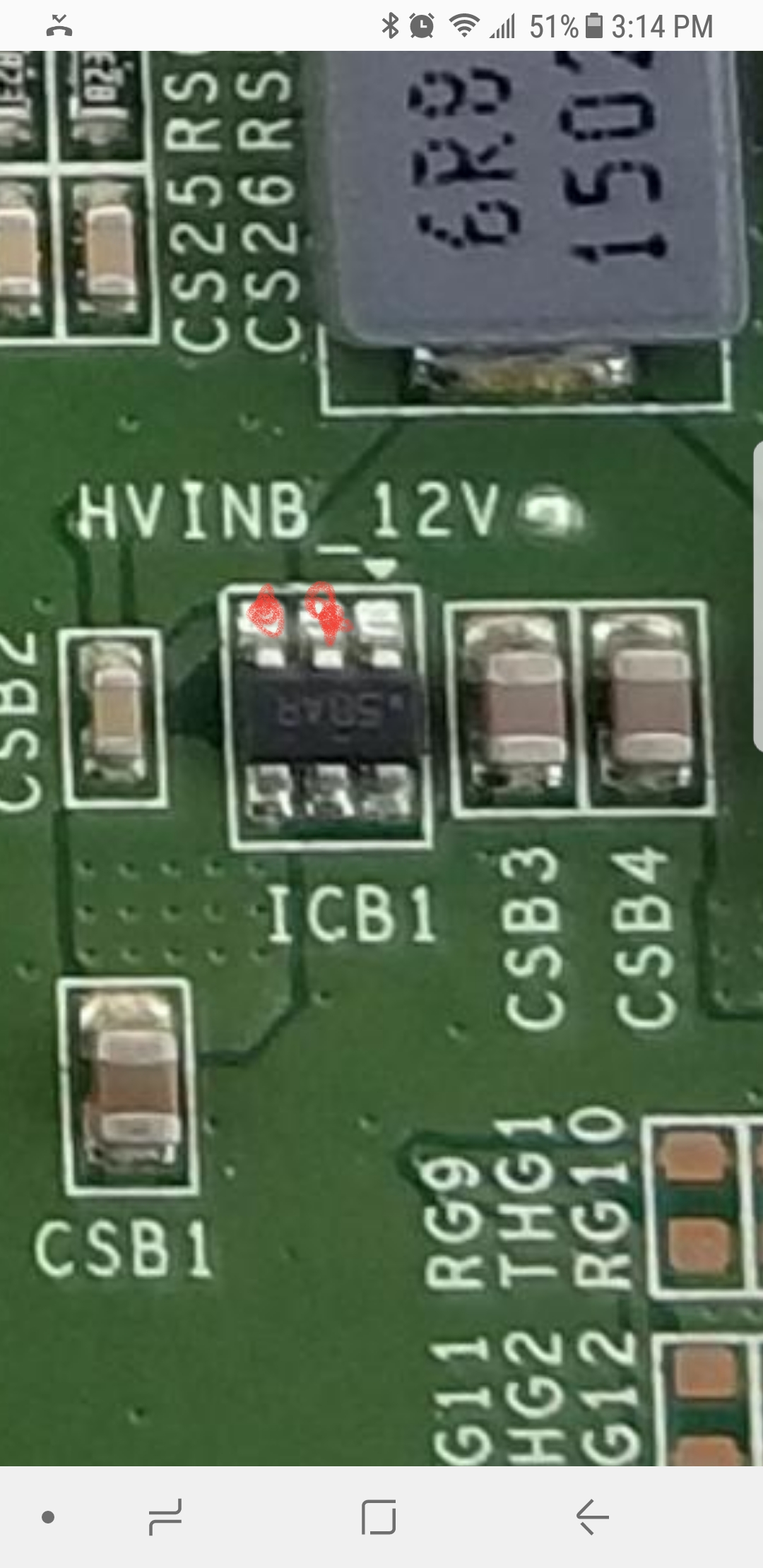

                        #91
                        Re: Sony XBR75X850C no picture backlights on
                        I'm starting g to think that this area the the PWM generator. The c oil is VCC 1.15v and there's 6v and 4.4v and 3.3v around that IC.

                          #92
                          What?? I'm curious, what you have fed to the tcon to see image?
                          • freakaftr8
                            • Oct 2012
                            • 3743
                            #93
                            These areas
                            • Davi.p
                              Hobbist Tech
                              • Sep 2009
                              • 4333
                              • Italy - Milan
                              #94
                              Sorry, i have understood nothing on post #91...
                              The PWM ic on the photo post#91 RT6932 is by Richtek, Samsung uses them often on LED TVs, on it's website unfortuantely there's no d.sheet for this, but i'm watching an interesting one of the series, found by "RT69" search term, this:
                              As you can see some of theese chips are fu**ing programmable ones so there's a nvm memory inside that stores settings, it's very hard usually to rebuild a lost programming of them, one has to write a program to use with a i2c interface and send the data to it, but you also lack of the data. Sometimes i2c lines are affected by bad mlcc caps on them, so on the tcon or on the mainboard is better to find the i2c line that goes to the 3 chips with missing tensions and replace the caps you find on the line/s, usually by only removing them the line return to work again.

                                  #96
                                  Each IC is receiving VCC 5v and there is some 3.3 and 12v there too.
                                  Too bad there are no schematic diagrams of these I c's in question. The Samsung tcon for the un75ju641df uses same ICs and it also will not power up.
                                  I am so close but still stuck
                                  Is the RT6932 the main PWM for all regulation ICs? It's always powered and putting put voltages.

                                        #99
                                        FIXED!!! I decided to have another go at this TV before it met the recycle bin, (spring cleanup around the house) and apparently the MLCC capacitor that I replaced on the panel board was not making a good enough connection I resoldered it again and perfect picture!!
                                        So all parties at were intrested, this particular T con board will not allow any power through the tcon board to the panel unless there are no shorts or "no opens" within the panel driver board MLCC capacitors!! Wierd setup!! I had never seen a TCON not attempt to output voltages if not connected to the panel but maybe I'm wrong. The side that had this shorted M LCC had the panel ID IC on it, So even though I was pretty sure the replaced M LCC capacitor was good it obviously was not. That's a 3 month problem finally solved. Now trying to put it back together is the interesting part..
