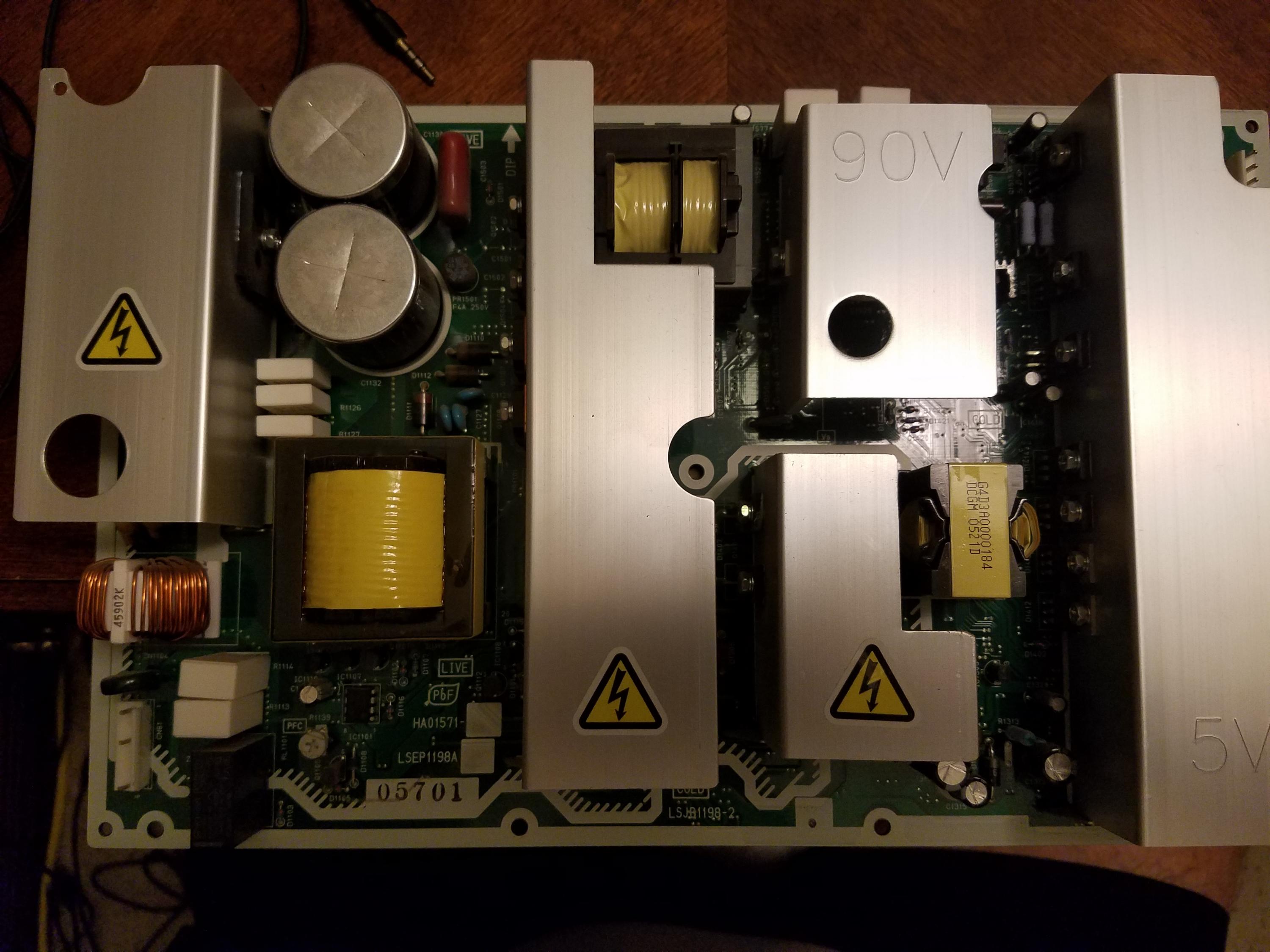

    I was wondering if someone could guide me through the repair of a Hitachi 42HDS52 TV. It has a great picture quality and unfortunately it works great as long as I don't turn it off. Whether it's with the button or remote, once I turn it off, I can't turn it back on unless I unplug from the wall, then re plug it back in then it would turn on. Any thoughts on where to even start?

    Just got around to really see what's going on... When plugged in, the light (power indication) is solid red. When I push the power button, it turns green. Then it blinks green 7 times. then 2 times. Then solid green, but no picture, however sound is on and TV is responsive to vol+ / Vol -. Where can I find the error codes / blinks on this TV? I have the service manual, but no info on error codes.

      Re: Hitachi 42HDS52 When powers off has to unplug to power on
      Usually on these Hitachi plasmas, if the tv turns on with sound, the fault is that a fault with the vs or va voltage was detected. If you monitor the vs or va you will see the voltage come up and then drop off. Normally this would be a faulty buffer board or Ysus board, but if the tv does still come on with a good picture, check what the vs and va voltages are.
      I think this model had some problems with the large caps on the power supply board that supplies the vs voltage, if they are bad/weak then that could be the problem as to why it wont start but when it does it stays on.
      I believe the green led flashing is normal when the tv first starts up.

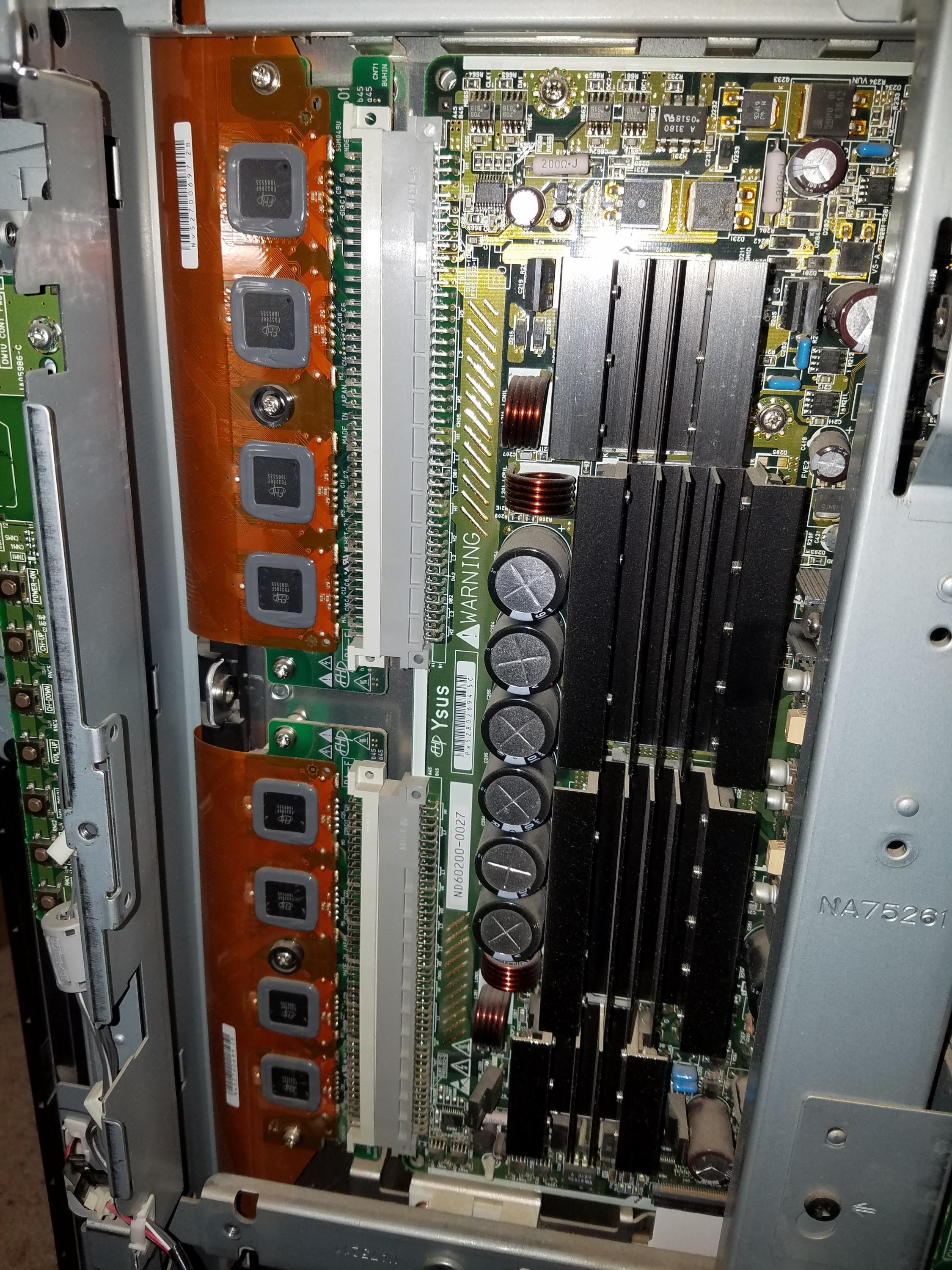

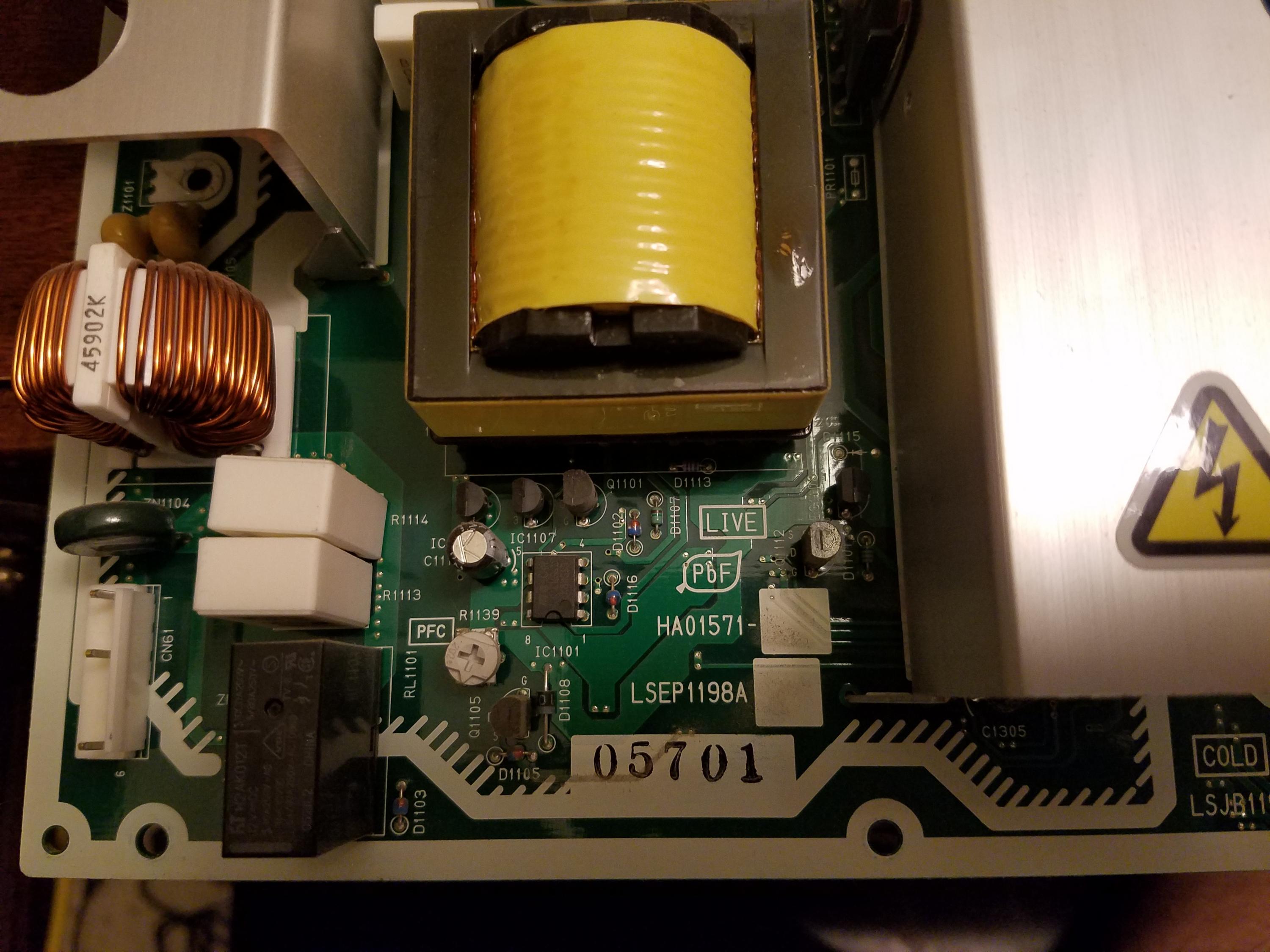

      Provide a couple of clear pictures of the boards, especially the power supply board
      I have this that might help but if your tv picture does come on I would say buffers are fine, ysus, might have a bad cap somewhere, or power supply has cap issue
        Thank you R_J
        I will review the guide and share some photos this afternoon. Appreciate your help.
        Picture used to come one on unplugging and re-plugging. Now, I only get sound. Occasionally, the Green LED comes one steady (Usually after unplugging for a while) and other times it comes on with the blinking, as described earlier. I'm curious as to why Hitachi doesn't make the error blink codes available. I looked everywhere online and I can't seem to find a decoder for the blinking codes.

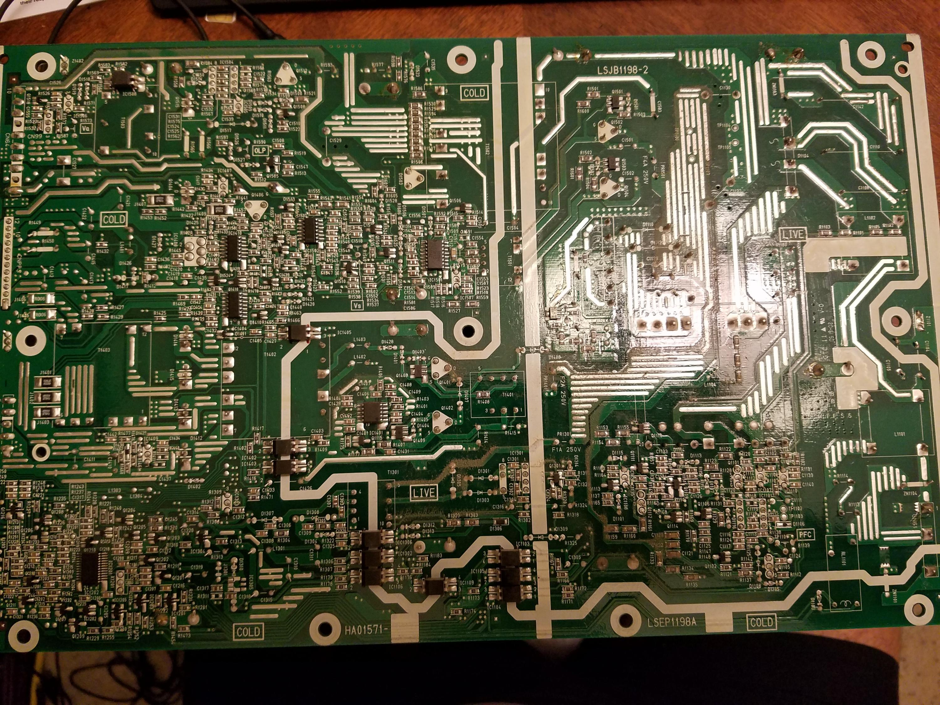

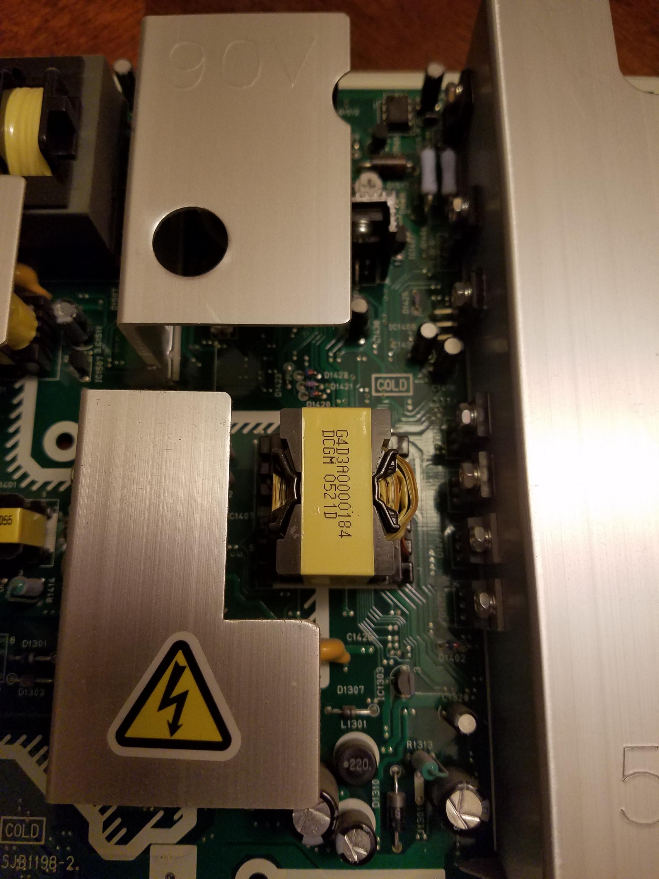

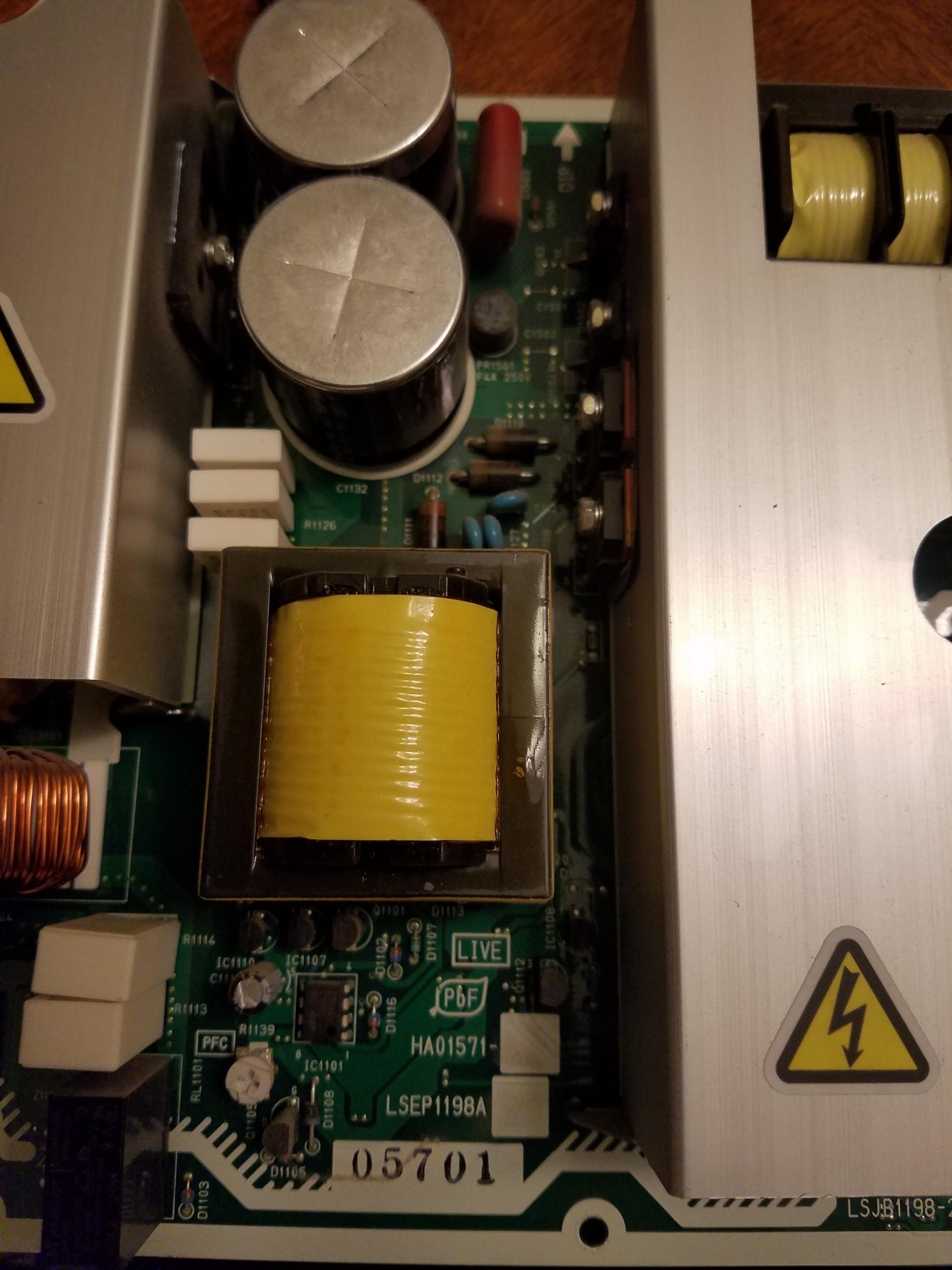

          a quick update. After being unplugged for a while, upon plugging in, Vs / Va (CN64 1 and 10) attempt to come up (fraction of a second - DMM can't capture - Simply starts going up and before settling goes back to 0)
          It does that with both the X/Y Sus boards plugged in (normally) or unplugged. Leads me to believe, maybe PS board is bad? I measured the resistance on the connector (when unplugged from the PS board) for Vs and Va, and they're high (not short certainly) - not sure if this is a valid test to make sure the short is not on the x/y sus boards?
          No swollen caps on the PS board and ESR on the large caps is sub miliohm. Nothing noteworthy on the photos, other than some dust, but included as requested. Thank you

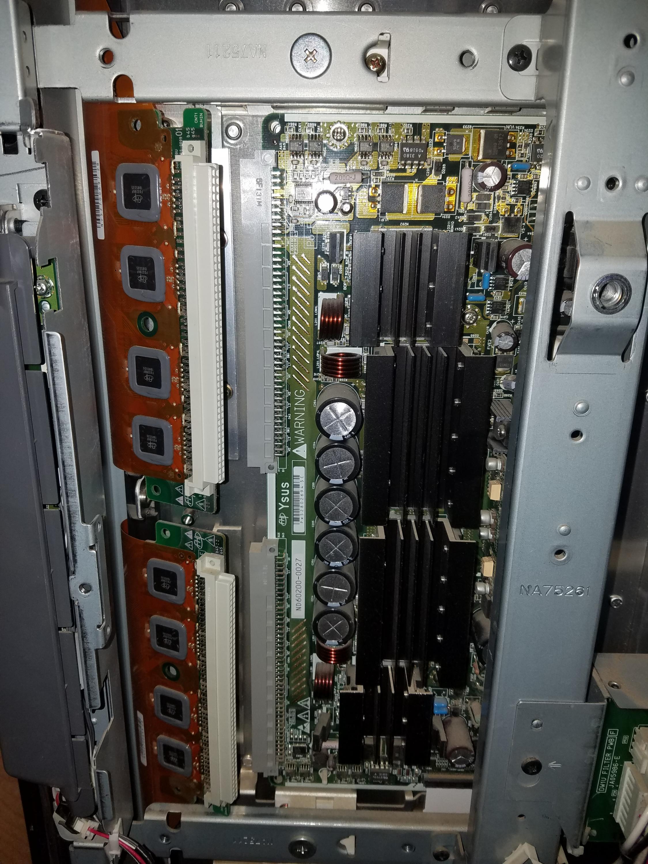

            What usually goes on these sets is one ore more buffer ic's on the buffer boards, usually but not always the upper buffer board, you could disconnect the buffer boards from the ysus, you can leave them connected to the panel, and see if the vs voltage stays up.
            If the power supply vs & va does come up and then drop off I quite sure the power supply is o.k.
            The ysus can fail without there being a dead short on the supply, if there was a dead short the voltage would not come up at all.
            There are ways to check the buffer board ic's for shorts, The pdf has a quick way to test
            I can't remember exactly but you place one probe on one of the pins that go to the ysus and with the other probe check the pins on the plug going to the panel (there are 2 rows of pins on each panel plug) there should not be any shorts to those pins if there are the buffer ic is bad.

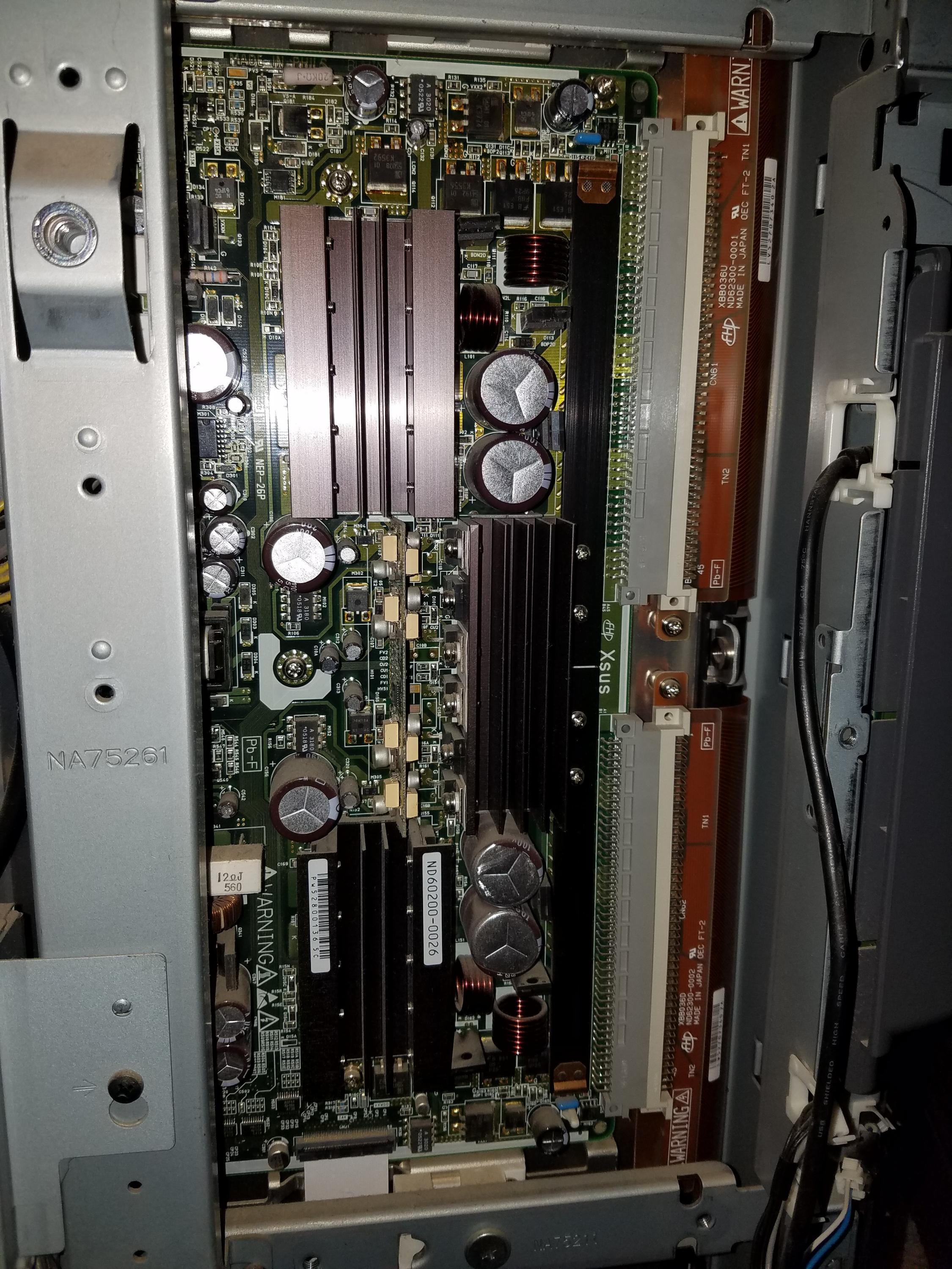

                    Did you try unpluging the upper and lower buffers from the Ysus and see if the Vs stays up?

                      Hi R_J, the first test, I completed.. and it worked fine with the exception that the Voltage on the 16 V was 14.55 V. The supply is producing stb5V and 3.3
                      I did try unplugging the entire Xsus, Ysus, and finally just unplugging the upper and lower buffers (see photo) and no change. Vs and Va are not coming on or staying on.

                        Just a note, I did order a power supply and it came in.. the first time I installed it and powered up the system worked.. so I thought it fixed it.. but it was one of those rare times where the system did come on.

                          You can adjust it, it won't make that much difference. those power supplies were usually quite reliable.

                              there are 2 connectors connected to the Xsus (buffers maybe?).. should I try disconnecting those and powering up?

                                I would leave those panel connections to the Xsus connected, they are not buffers they are just solid copper connectors that go to the panel.
                                I guess you could remove the ysus and check for poor solder connections, I would check the connections on the transistors etc. that are mounted to the heatsinks, sometimes the larger connections don't get enough solder when they are manufactured and over time they can become intermitint. but again these boards are built quite good. You could also check the xsus for the same poor connections.
