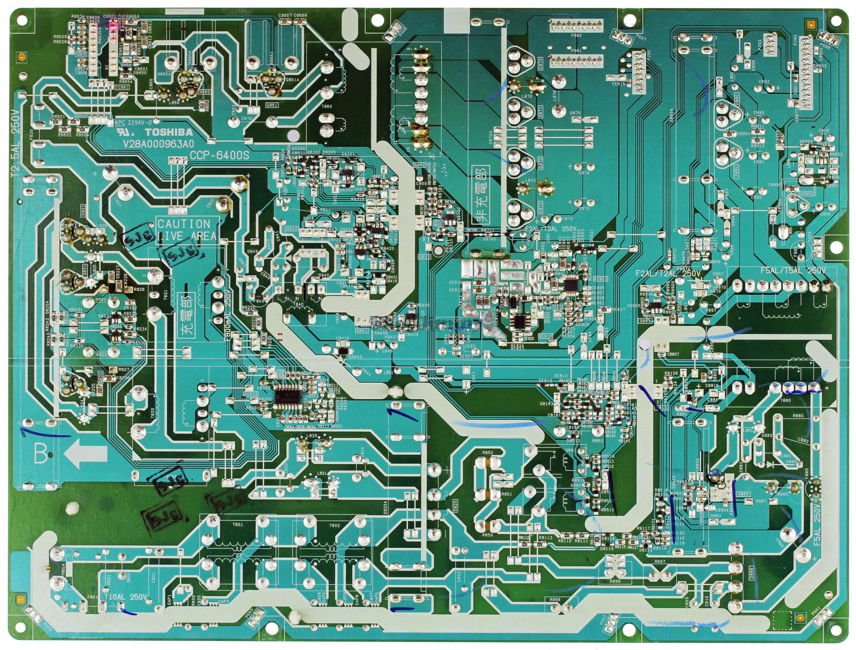

    Hello, I am trying to repair a Toshiba 46xV645U.
    It's symptoms are: when powered on it displays no backlight and its standby led blinks orange continiously. The unit failed flashlight test.
    I read in its manual that blinking orange is a backlight issue. I tested the two backlight connectors on the power board and read 3.38V where it's marked as 24Vinv (side question: what is "inv" after 24V)
    Is this enough information to determine the powerboard as the fault?

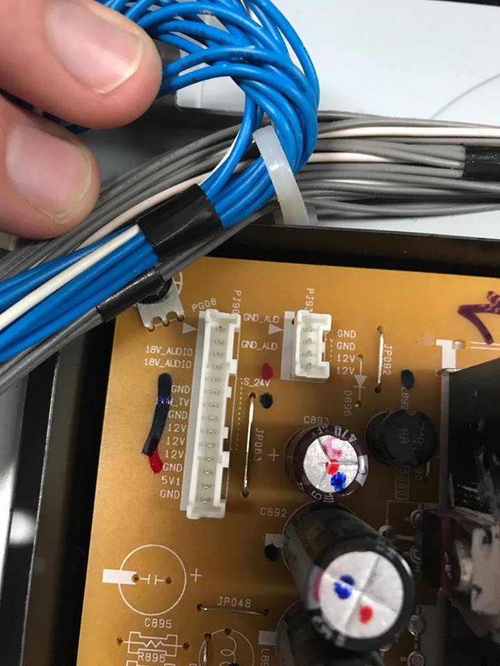

    Re: Toshiba 46xV645U Blinking Orange Light
    Need voltages from connector that goes from power supply board to main board. Will need pin#- PIN DESCRIPTION -Pin voltage in standby-Pin voltage when pushing power button and picture of connector on power supply board.
    Format:
    Pin# - Pin Description - Pin Voltage standby - Pin voltage power on
    1 - XXXXXXX - XXv - XXXv
    2 - XXXXXXX - XXXv - XXXv
    3 - XXXXXXX - XXXv - XXXv
    4 - etc.
      Format:
      4 - etc.
      Thank you for the reply
      Here are those measurements
      1 - GND AUD - 0V - 0V
      2 - GND AUD - 0V - 0V
      3 - 18V AUDIO - 0V - 24V
      4 - 18V AUDIO - 0V - 24V
      5 - S_24V - 0V - 0V
      6 - GND - 0V - 0V
      7 - POW_TV - 0V - 3.3V
      8 - GND - 0V - 0V
      9 - 12V - 0V - 12V
      10 - 12V - 0V - 12V
      11 - 12V - 0V - 12V
      12 - GND - 0V - 0V
      13 - 5V1 - 5.1V - 5.1V
      14 - GND - 0V - 0V
          Looks like you are missing 5 - S_24V - 0V - 0V which is probably power for your back lights

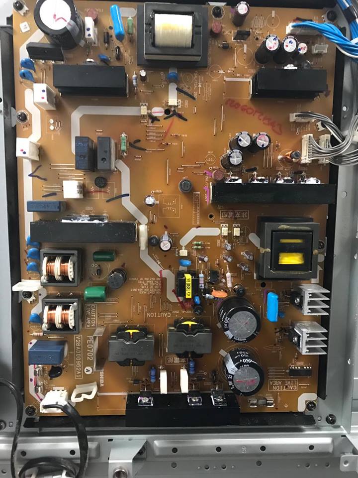

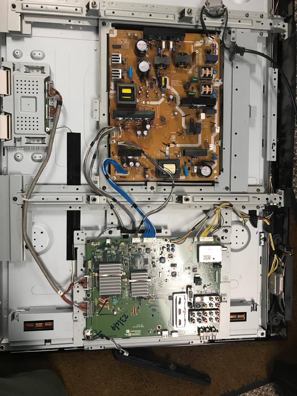

              S_24 on that connector pin of the power supply board that goes to the main board looks to be the command signal to run on the 24V power supply to supply 24VINV to run the backlights inverter board.

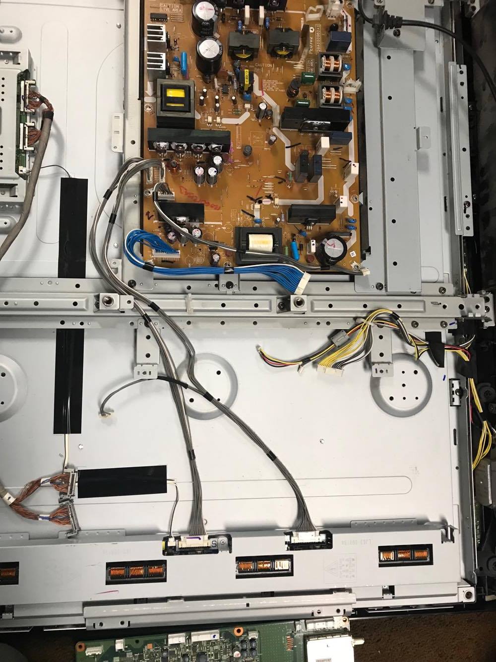

                We need good clear pictures of the whole backside of the TV showing how all the boards are connected together.

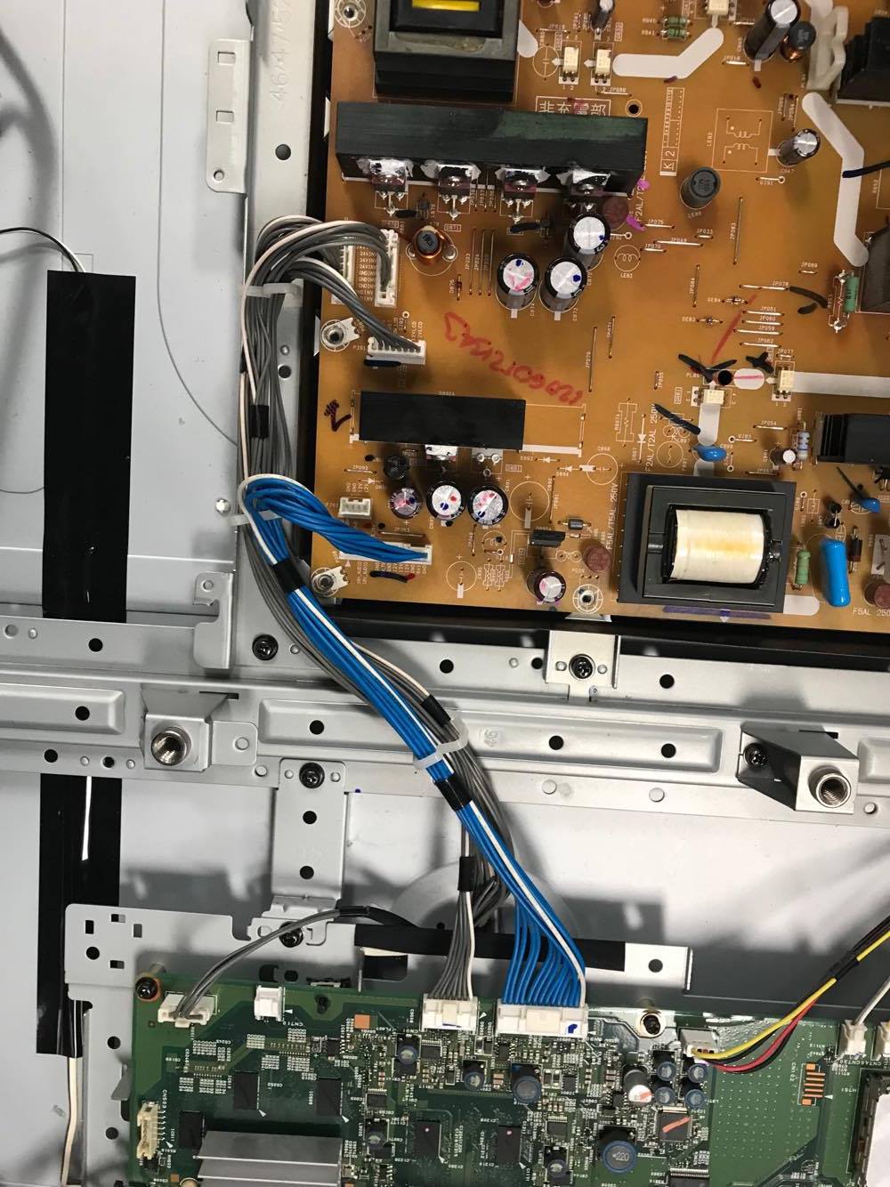

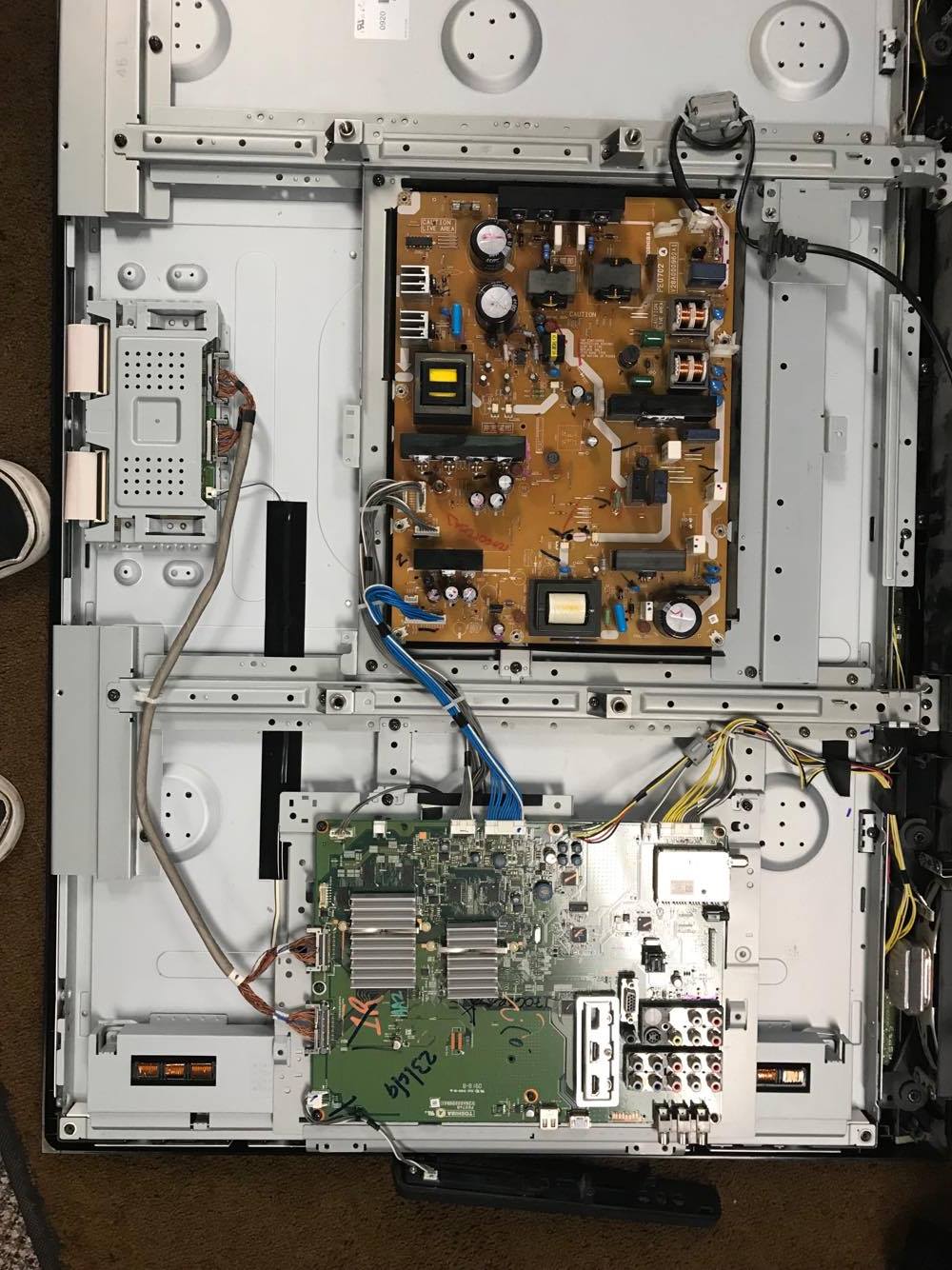

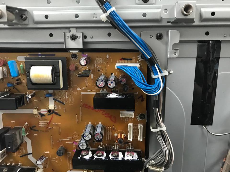

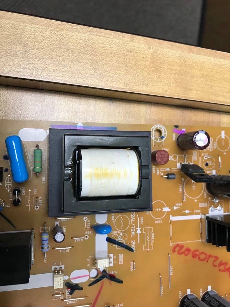

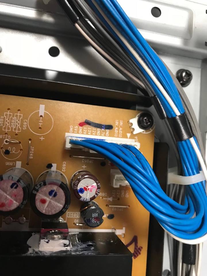

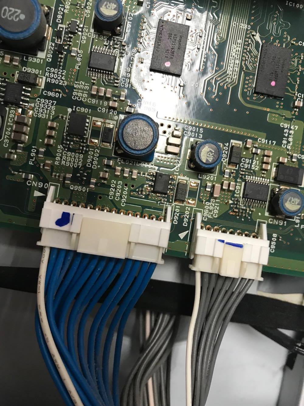

                  hope these work, let me know if you need more

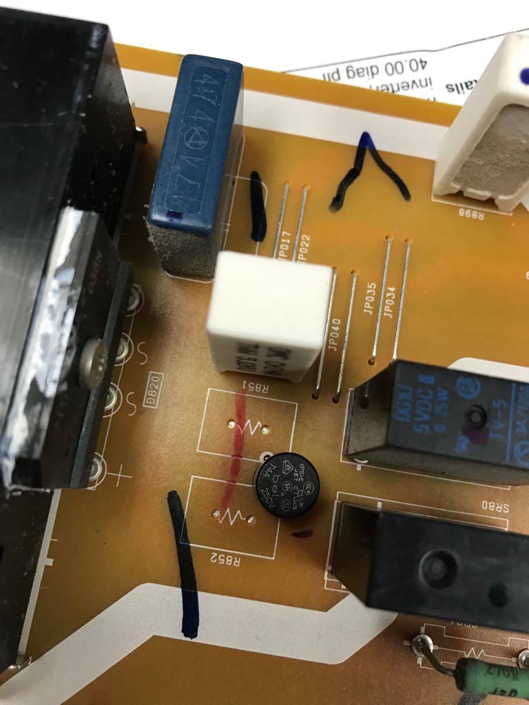

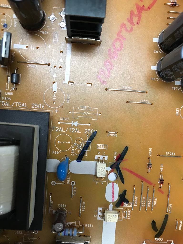

                    There are a number of small round (red) fuses on these boards, if you are missing S_24V
                    check and see if D897 & F897 are in place, if they are missing this voltage is not provided on this board
                    (S_24V is supplied by T880) so if you have audio 18-24 and +12v on PJ90 that circuit is working.
                    Check R851 (5Watt Cer.) resistor, near the relays Also check F870, F840
                    Check for +24 volts on P860 or P861. If you have +24 volts, check your inverter boards (under the shields at the side of the tv)
                        I just checked the board on SJ, If this is the same board? PE0702.
                        There is one winding off T880, it goes through F897, L897, D897, filtered by C898, up to a jumper wire jp091, then to c8952 and the plug
                        If these parts are not there, no voltage at that pin

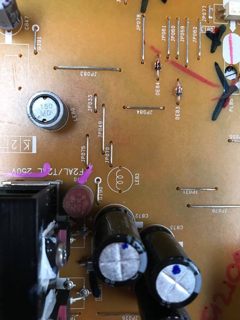

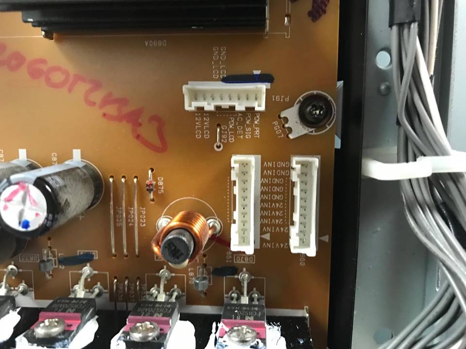

                          Missing L897, D897, C898, R851
                          P860 and P861 gives me 3.38V everywhere that 24vinv is marked when powered
                          Fuses 840 and 870 tested good
                          thanks

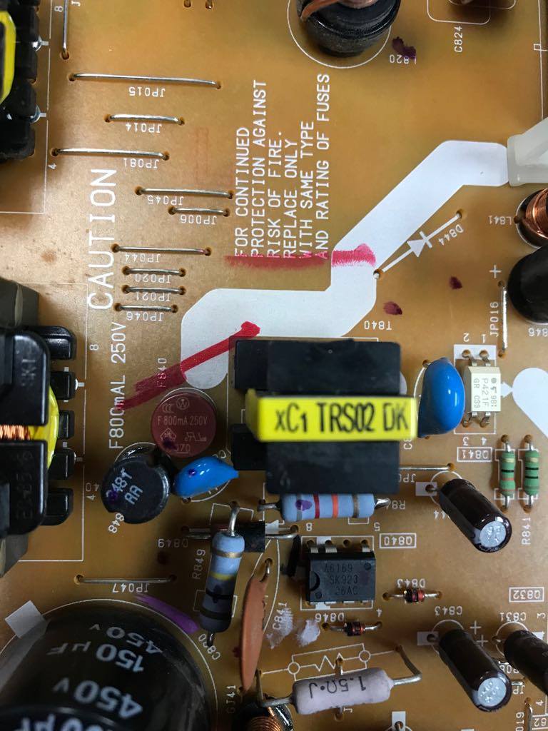

                            Mine is PE0702
                            Im missing F897, L897, D897, and C898

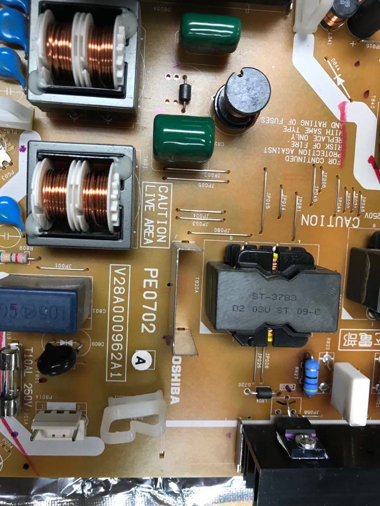

                              Some one else worked on this board before you? Just wondering what else is missing or may be not.
                              BTW, PE0702 looks to be the blank PCB P/N.. there should be another part number for the PCBA (PCB assembly which you can see that the whole board is not fitted with all the parts).
                              I cannot tell from your pictures.
                              As you can see, that PCB PE0702 is used in more than one Power supply PCBA:
                              http://www.shopjimmy.com/catalogsearch/result/?q=pe0702
                              There are repair kits for the boards.
                                yes this was serviced via "send to ebay seller for repair" I will try to get information on that whole deal once the owner of this tv hears back from him.
                                v28a000963a0 and CC-6400S is written on the backside if that helps
