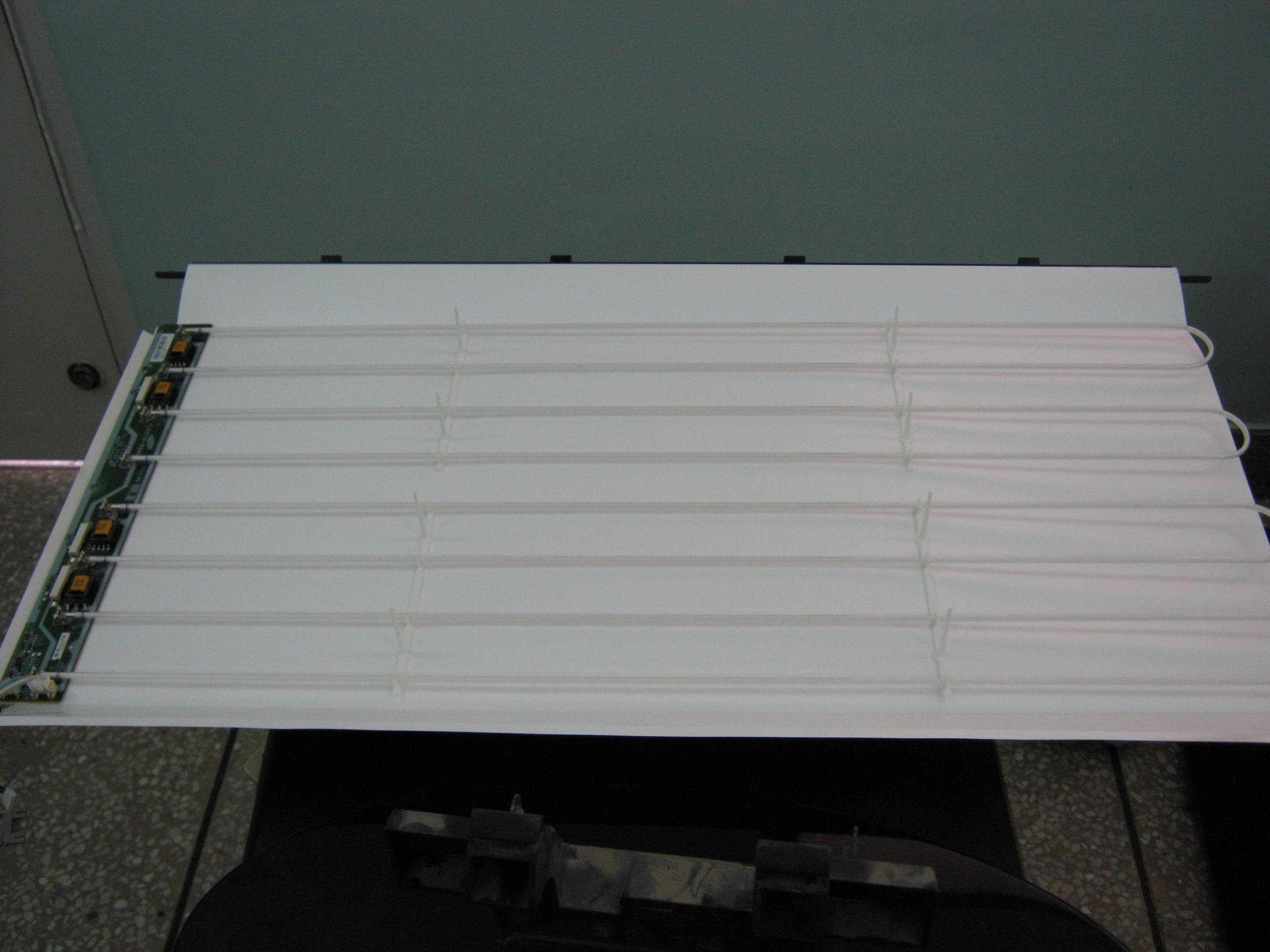

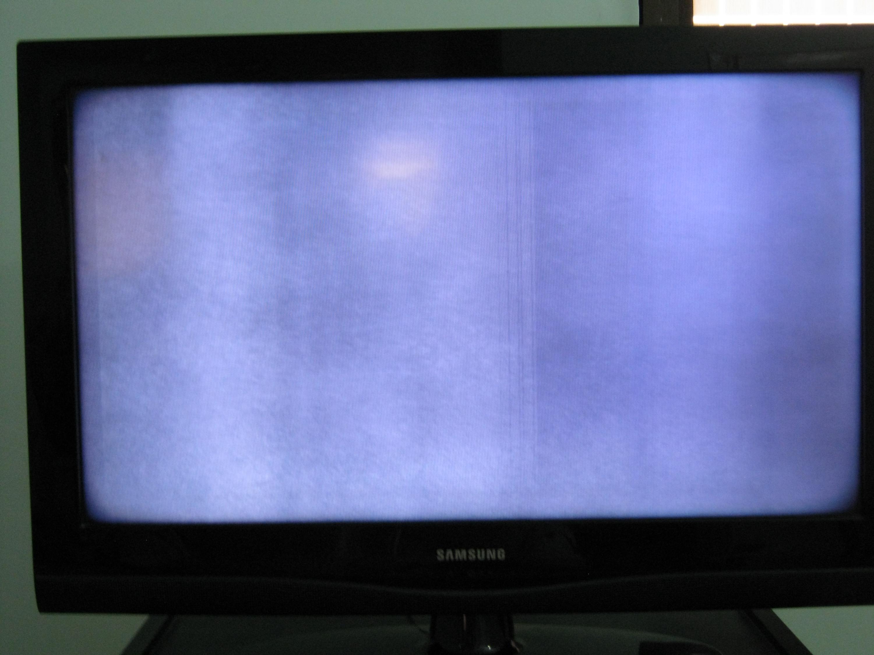

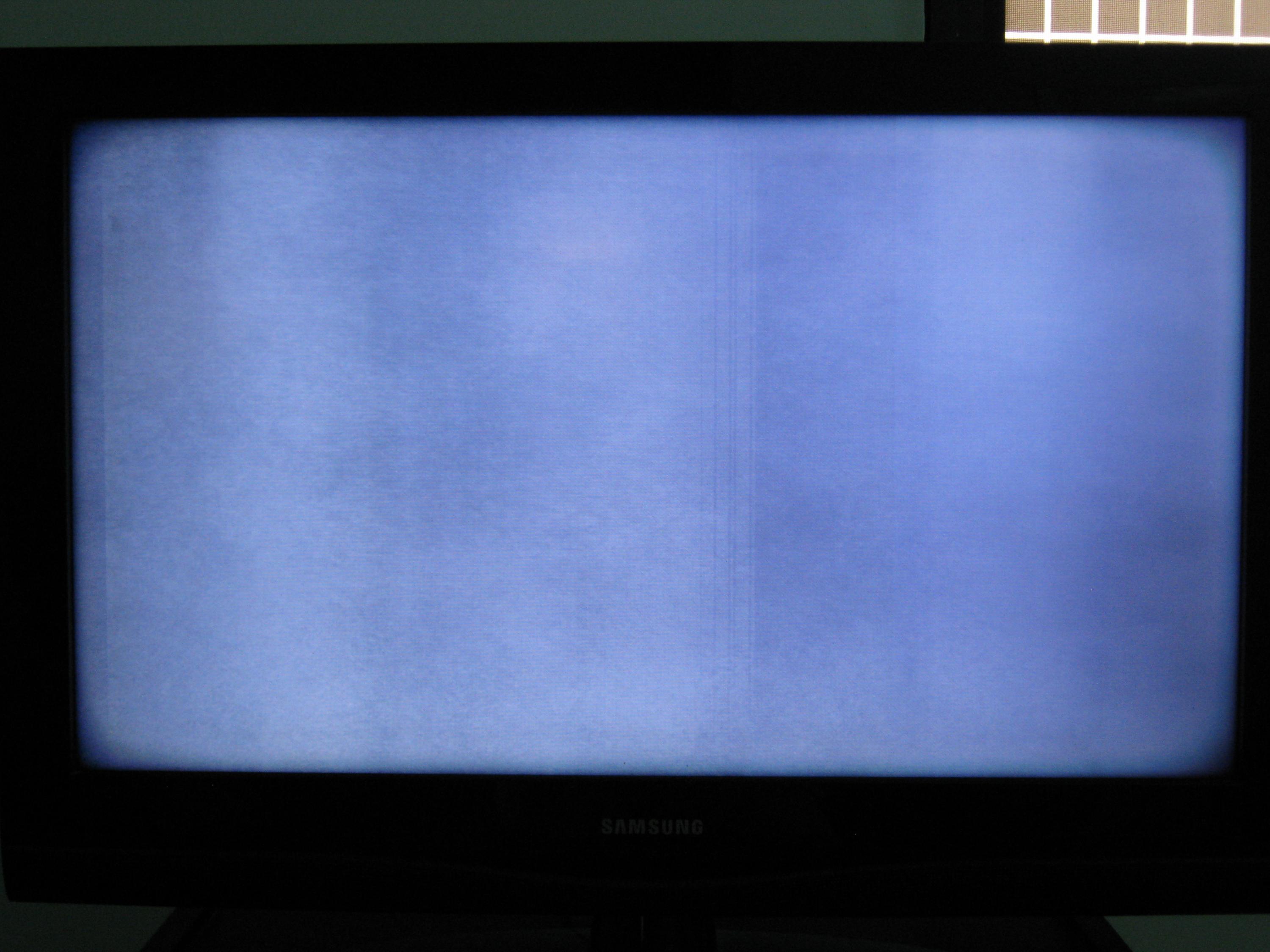

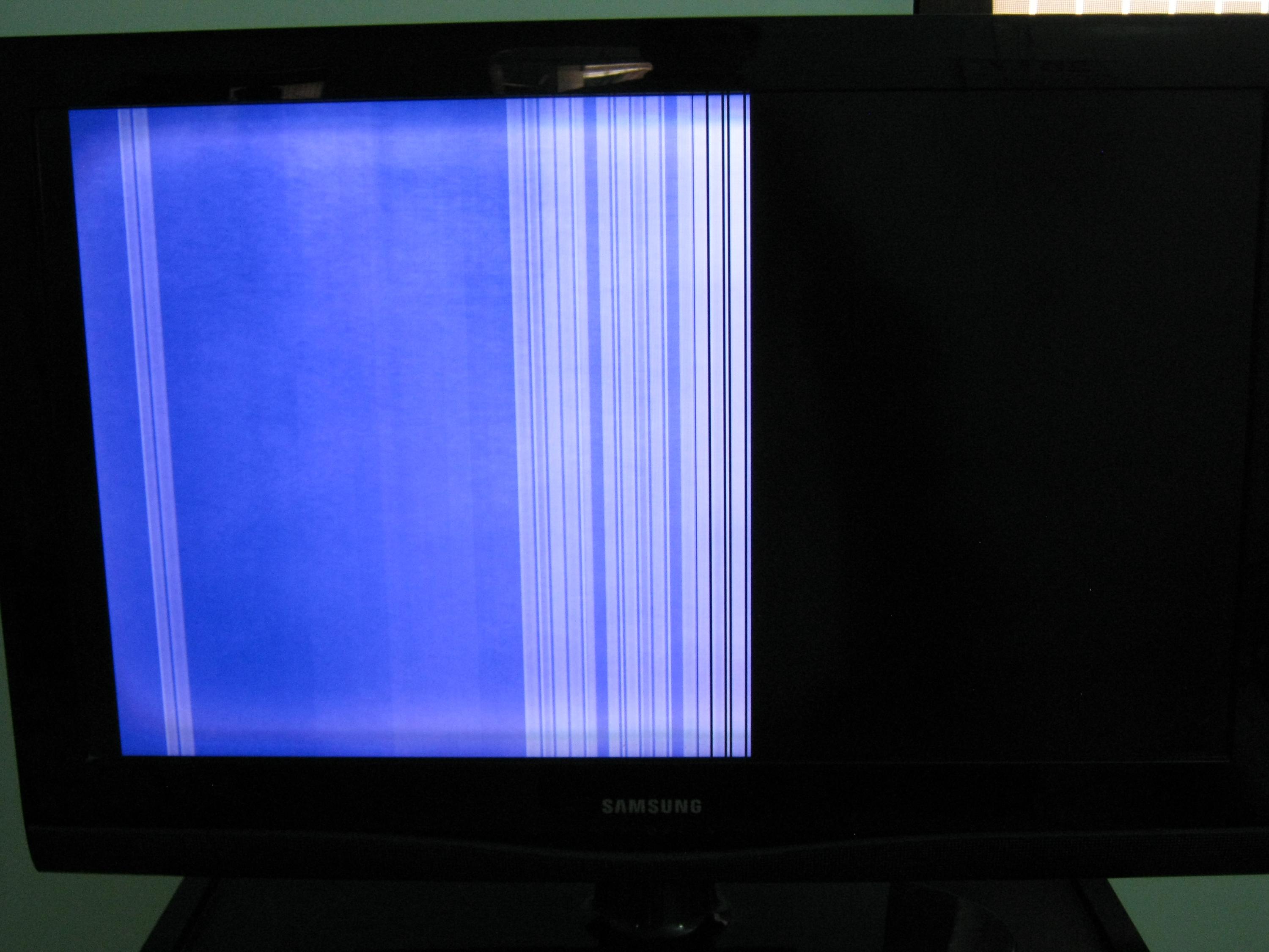

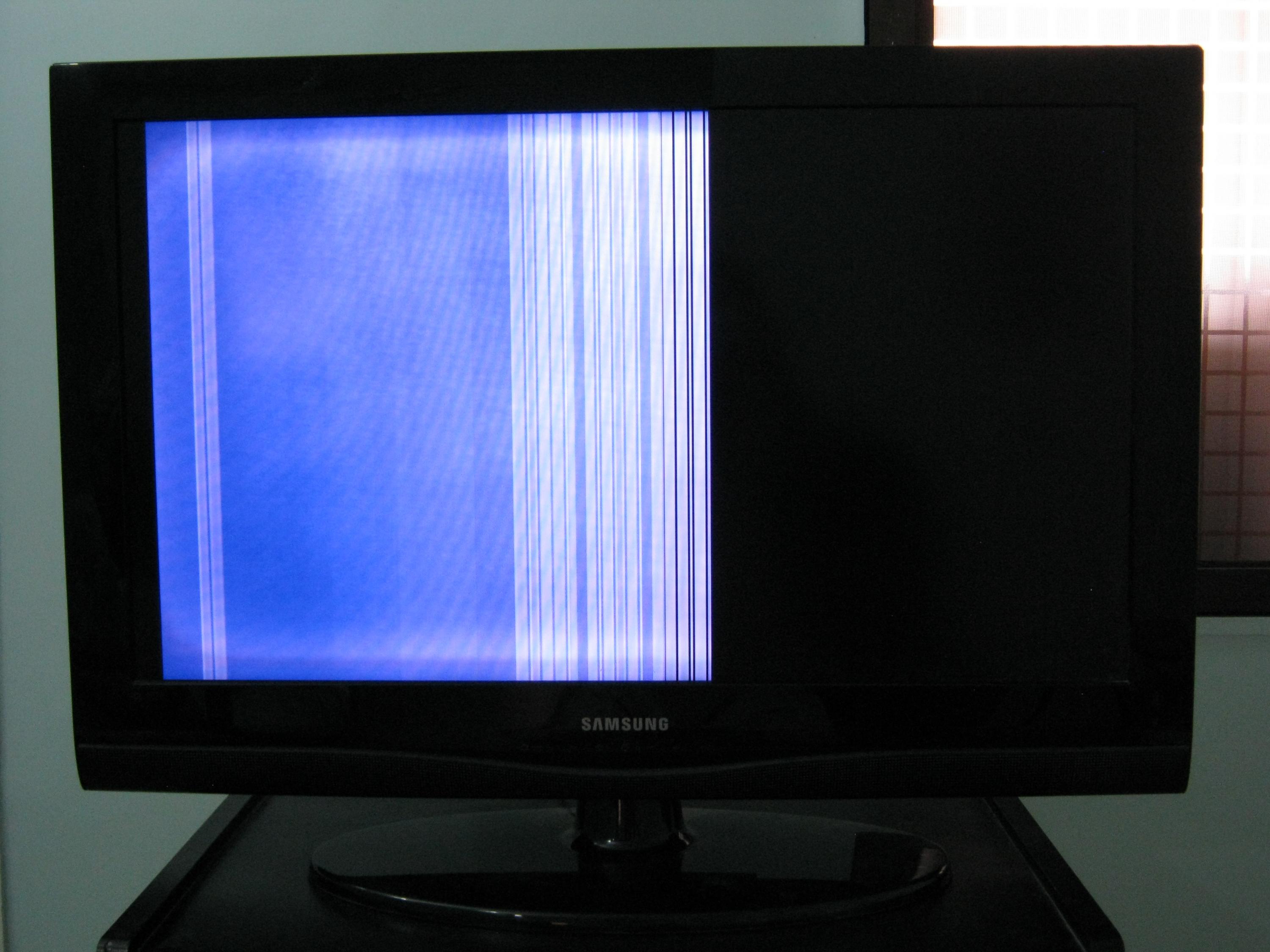

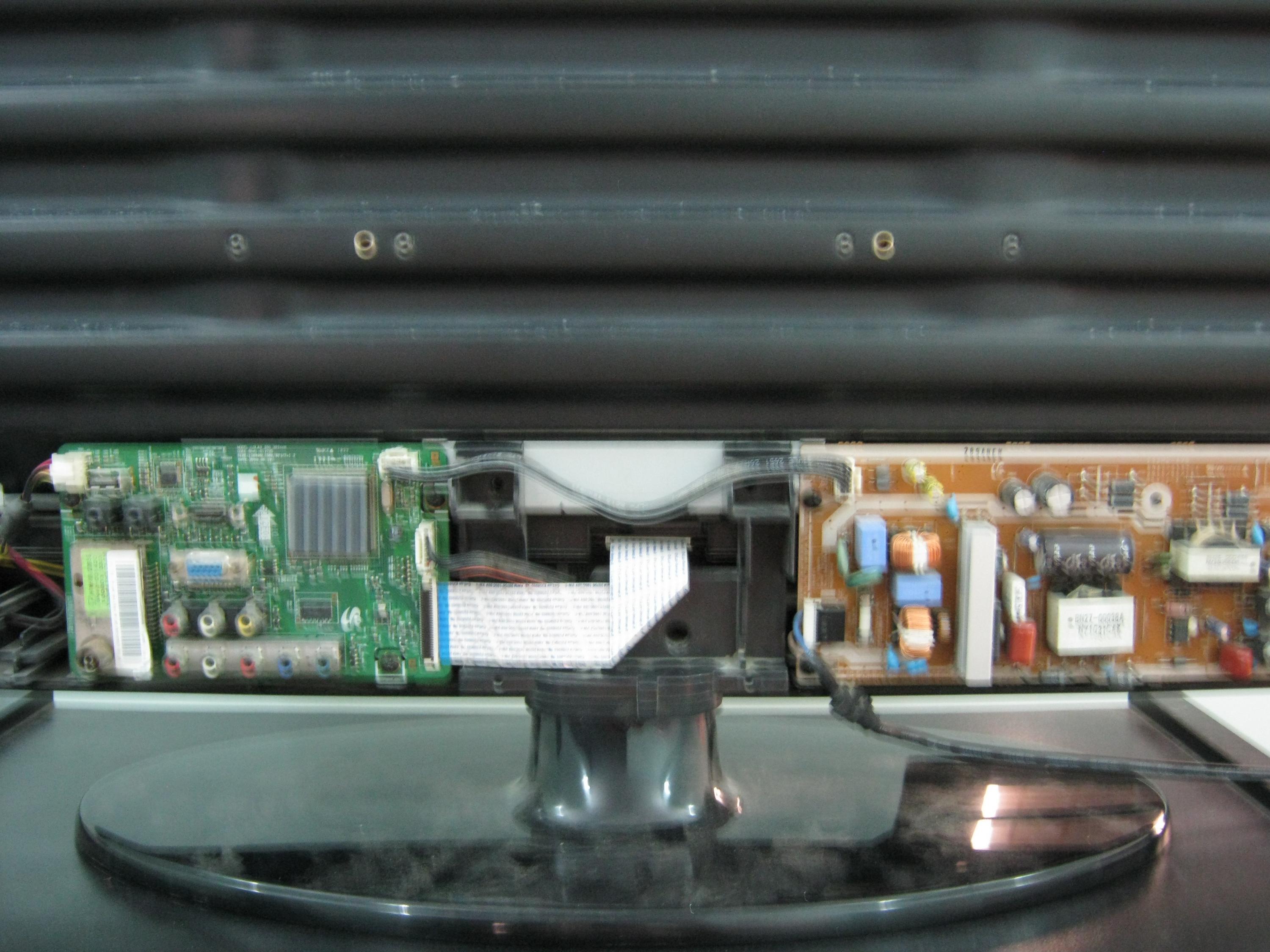

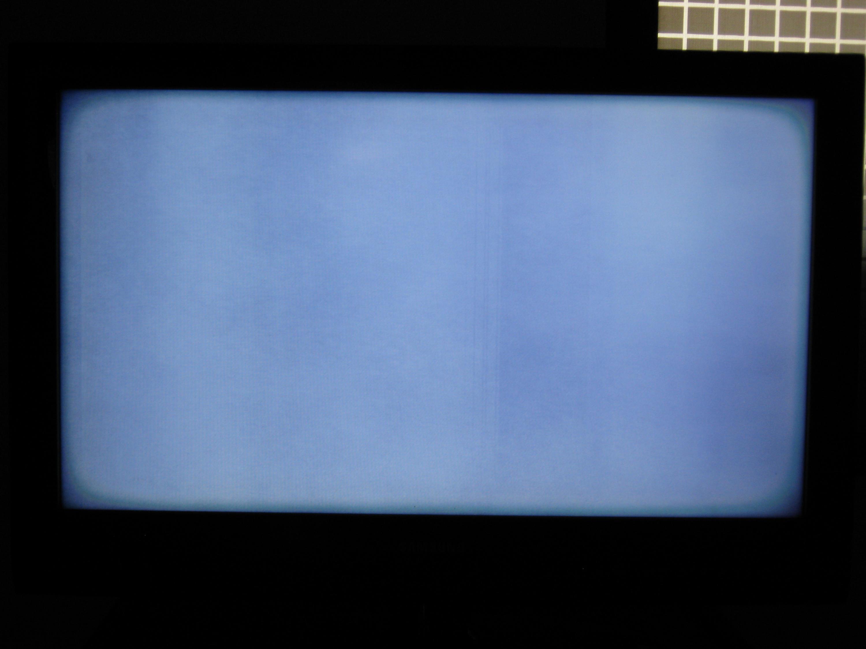

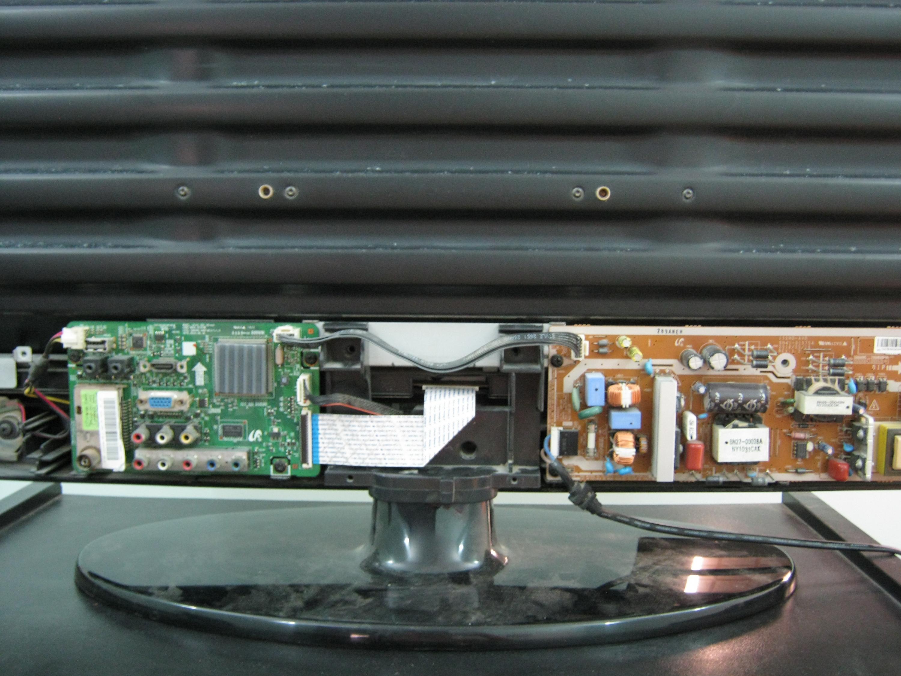

    Hello friends, my samsung LAC32C350D1 is in this position, has anyone has any idea what is the fault?, is it the main board or panel?
    pics are attached,
    Pic a.b.c has been selected tv source, pic. Front and front 2 is been selected HDMI Source.also attached back pics, there is is no T-Con Board, Only Main Board and Supply. Your help is urgently needed,Thanks.

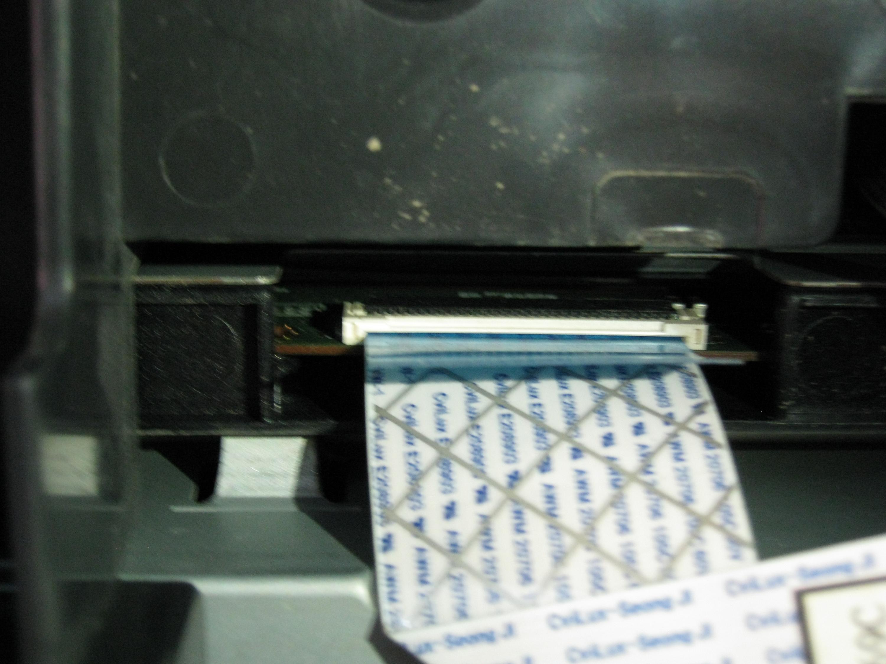

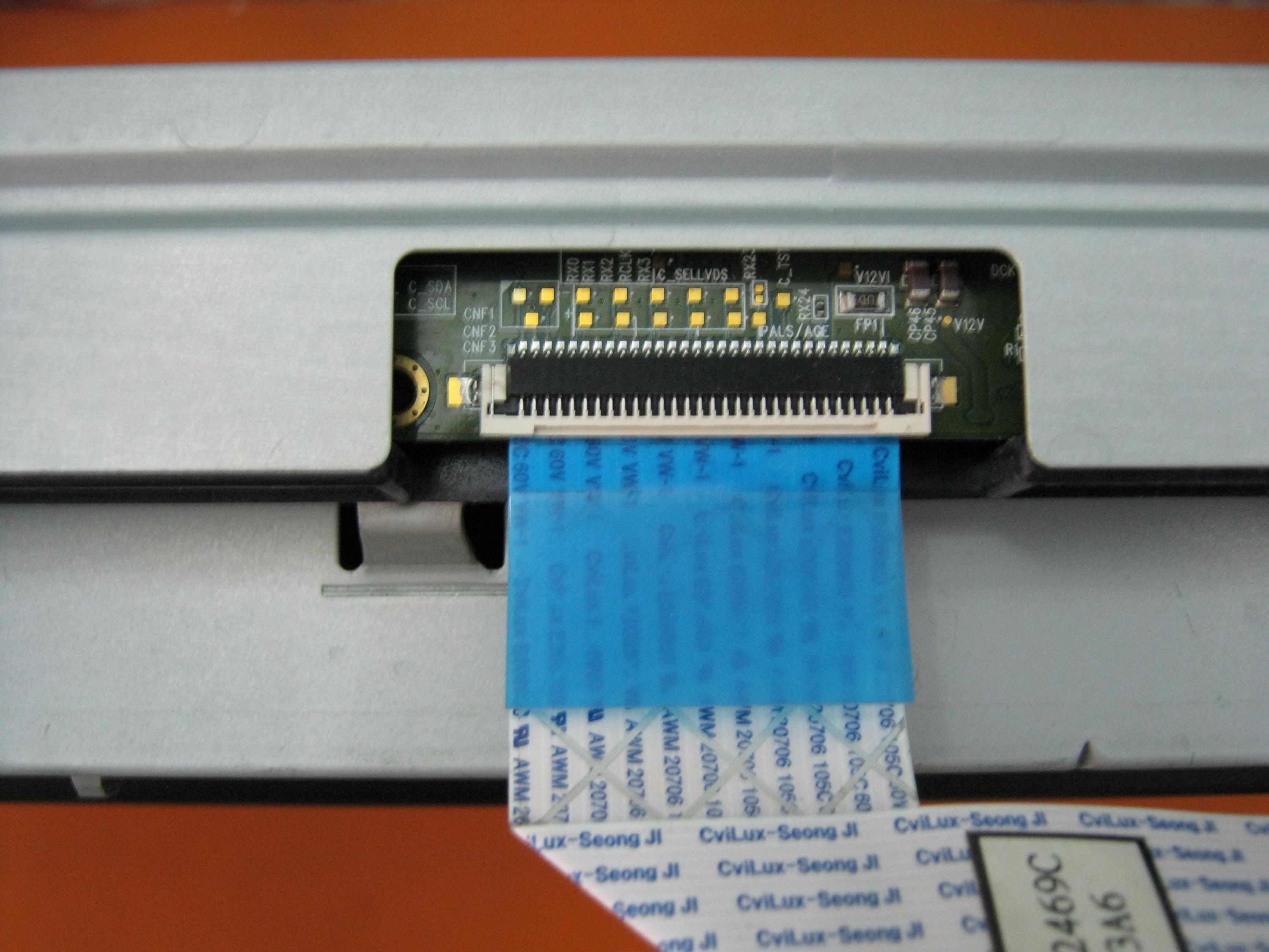

    The model i think is LA32C350, it seems more a tcon problem, check well is under the cover where the wide flat band connection goes from mainboard. (center of the tv).

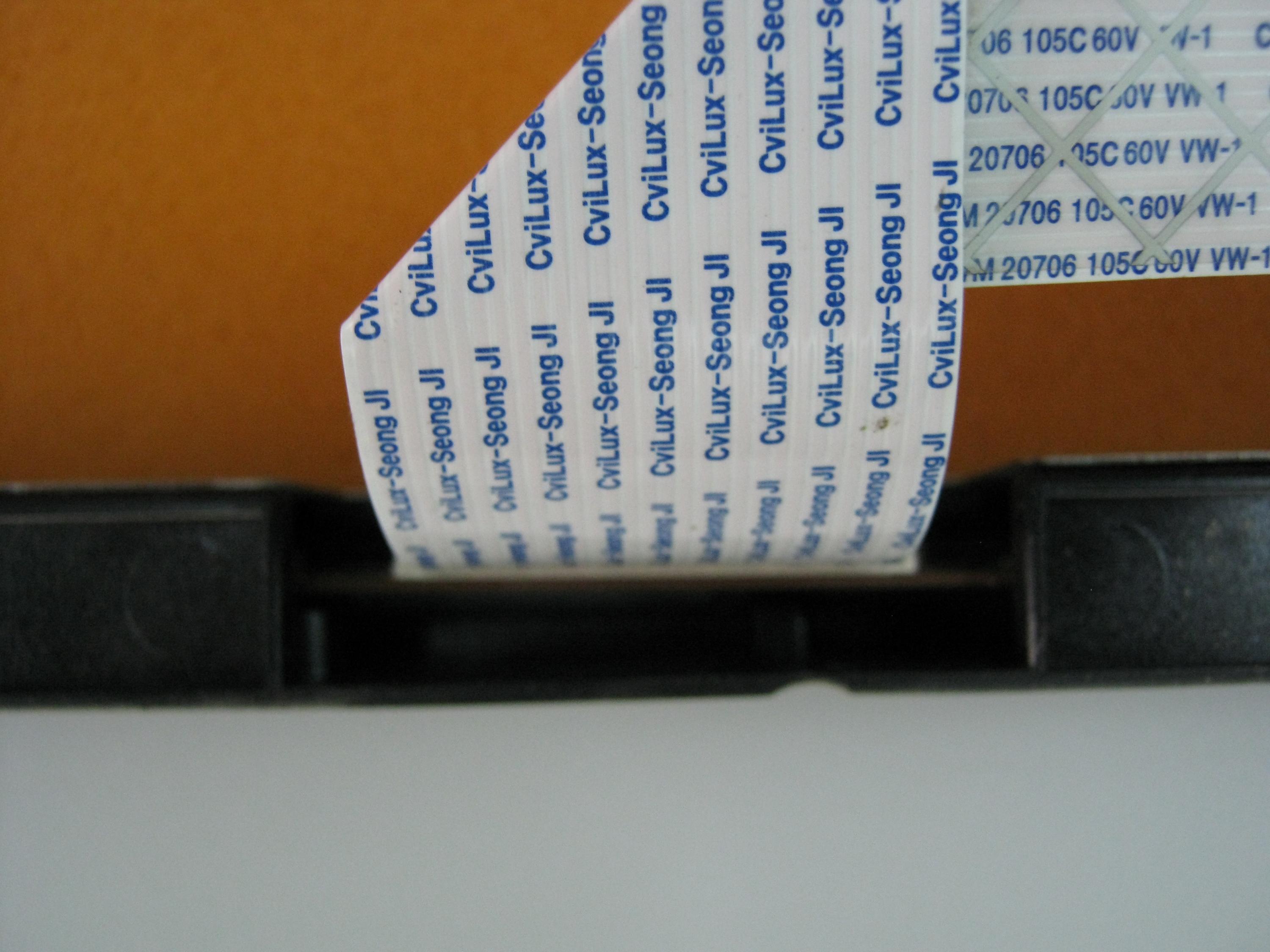

      The one you just mention goes directly in the panel pcb strip. see the pics i don't think there is any T-con Board this model has.
      The sticker on the backside says Model:-LA32C350D1
      Type:-LA32C350

        Maybe the the tcon is integrated to the screen but it always exists.

          Are you 100% sure that there is T-Con inside, so i dis-assemble it completely, because panasonic TH-L32C30 SERIES also dont have T-cons.

            100% there is always a tcon, when the output cable is only one tcon is on the screen.

              can we see a pic with the OSD menu on the screen?

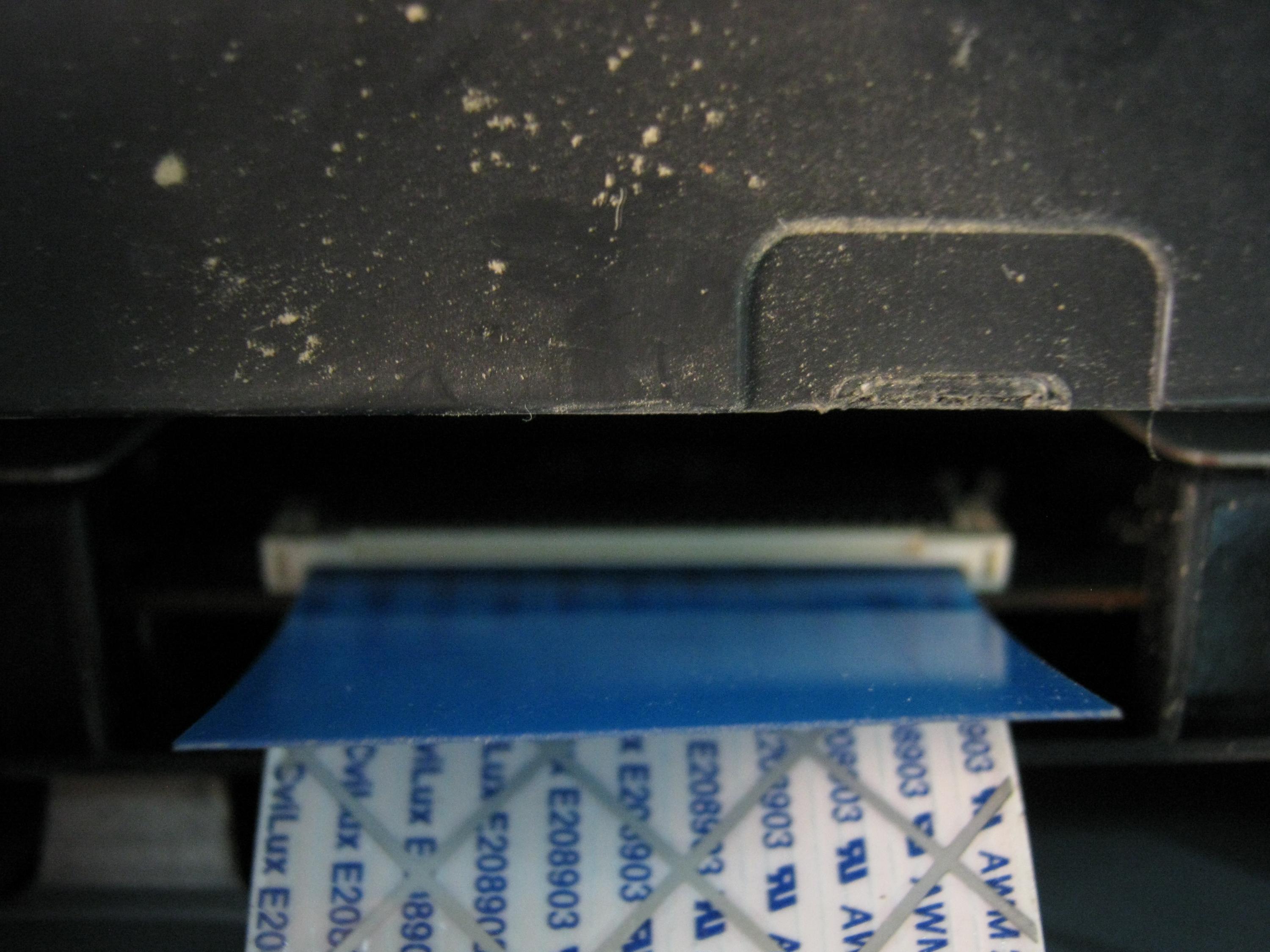

                I've seen a similar issue on italian forum, have you disconnected - cleaned - reconnected the flat cable?

                  @Capleaker,Nothing on the screen, No OSD Menu Display.

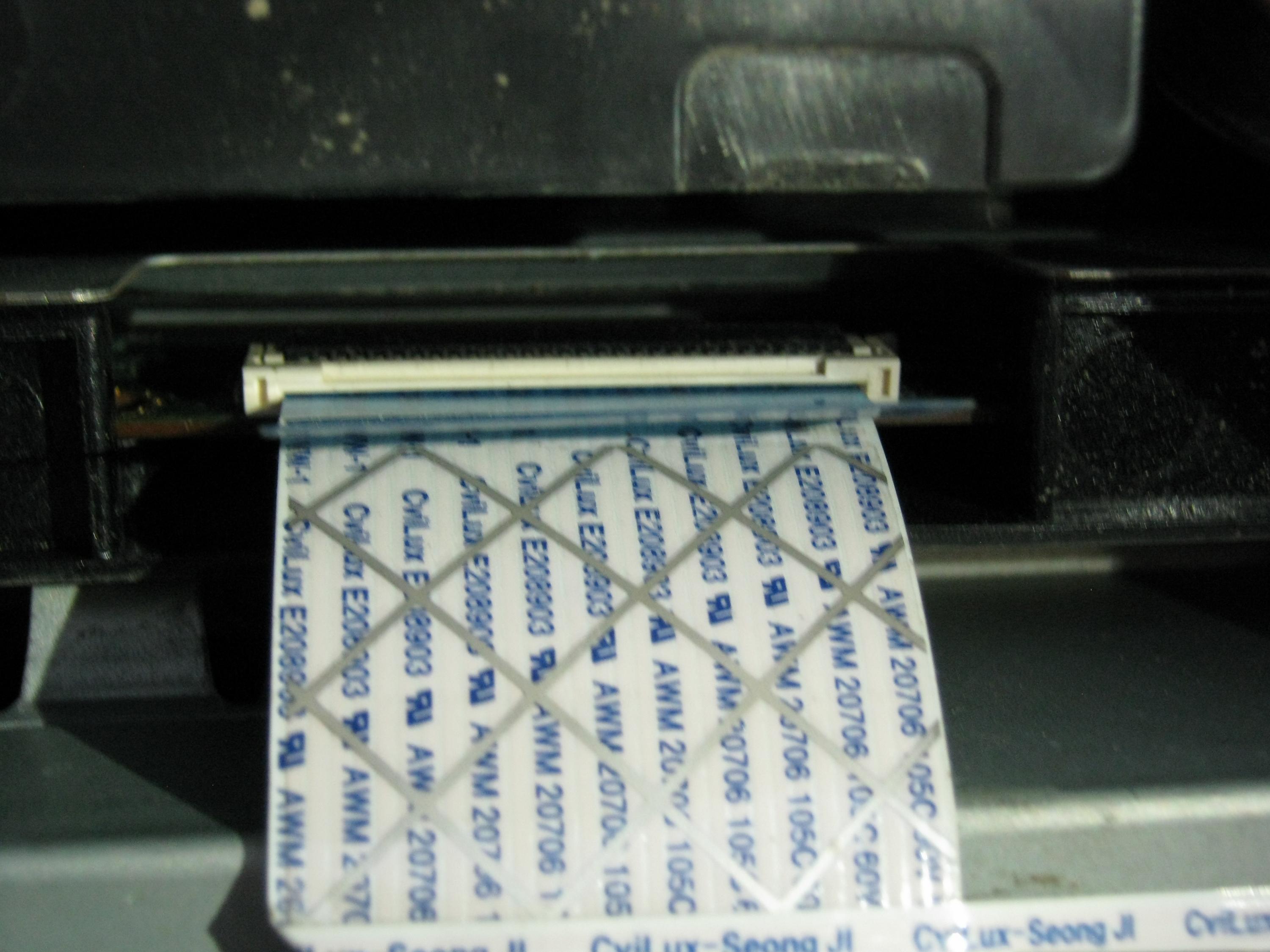

                  @Davi.p; yes i cleaned the flexcable with the eraser, checked the continuity of the flex cable with miltimeter.but same result.do you have a link of italian forum, may be i can use a google translator and see if i can find some solution to my problem.

                    Check the LVDS differential pairs with the oscilloscope and turn the OSD menu on and off all the time, while probing the LVDS. If there is video coming out of the main board, you will see the difference on he scope while the OSD is on and off. That will determent if you got a main board or a TCon problem.

                        Thanks Capleaker but i don't have oscilloscope.
                          Re: Samsung LA32C350D1 Any Idea About This Fault?
                          Looks like bad panel to me.
                          Tab boding boards are on the bottom edge of the screen, right?

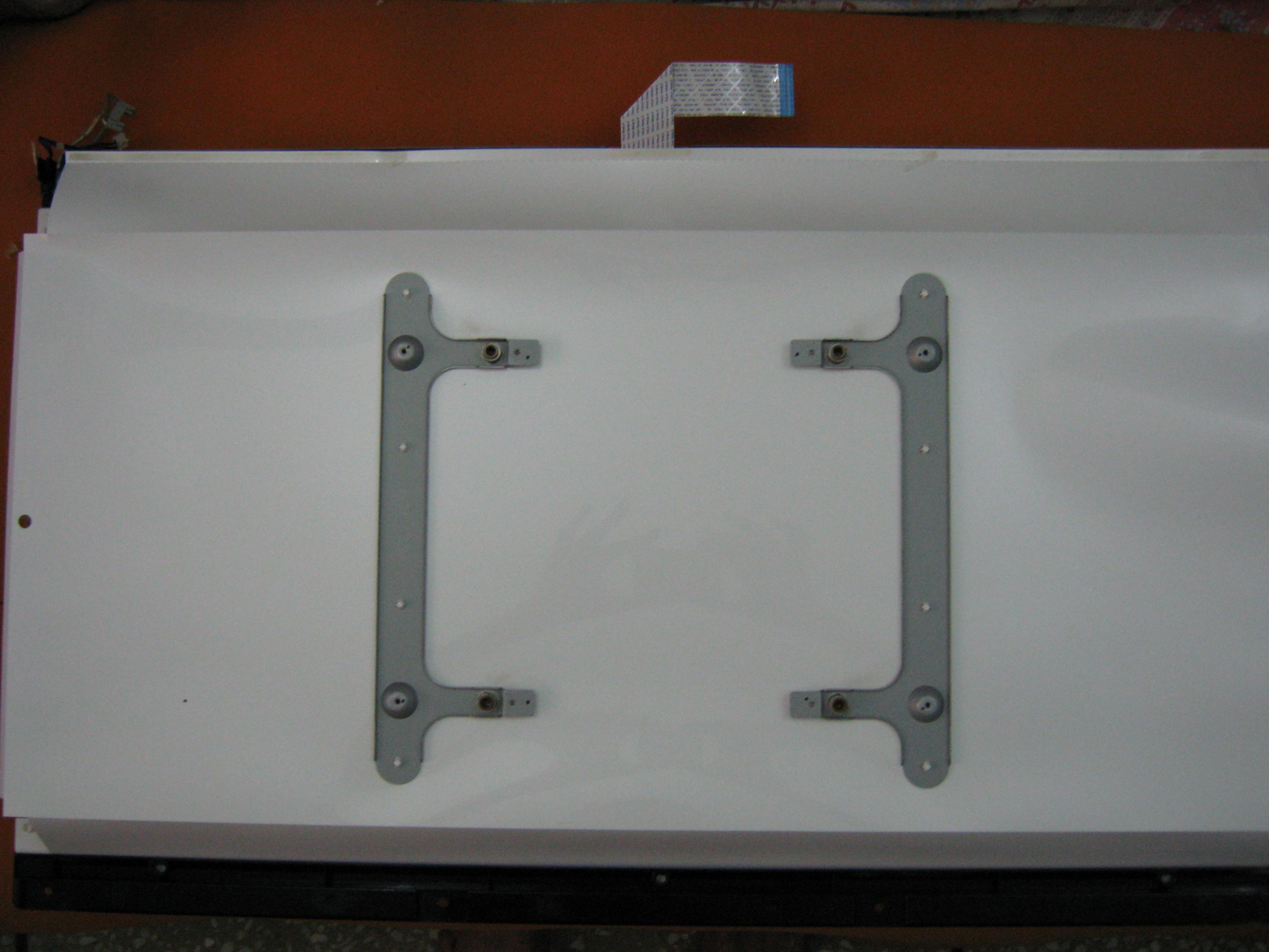

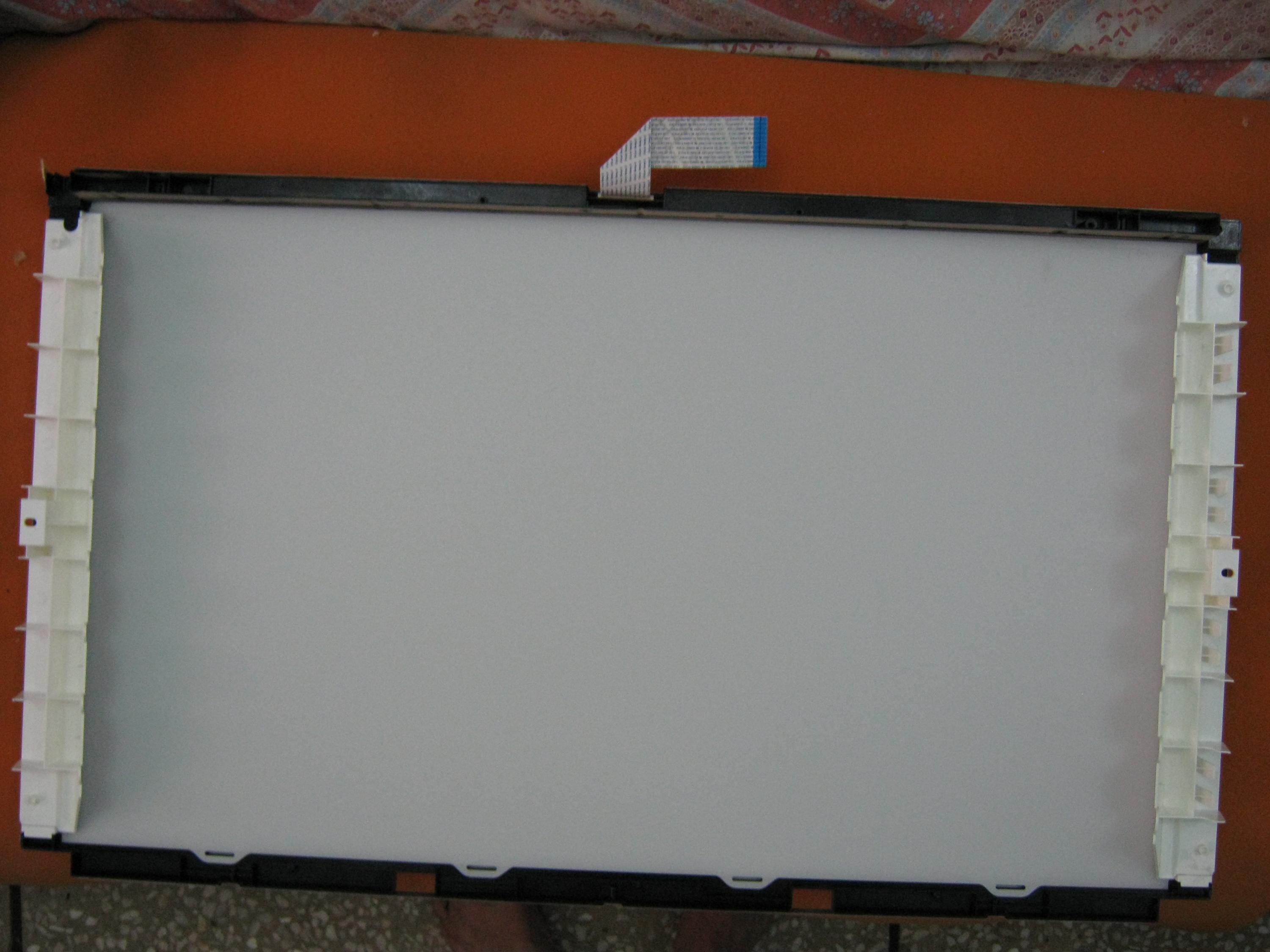

                            Where is the T-Con???, I Could Have Easily Damaged those CFL's
                            @budm:- Yes Tab boding boards are on the bottom edge of the screen.
                            Conclusion:- I think its a panel fault & T-con is built in MainBoard.
                              T-con is integrated into the panel, these panel with Tab bonding/T-con board on the bottom edge get damaged by the cleaning fluid that drips down on to the board and eats away traces and causes corrosion.

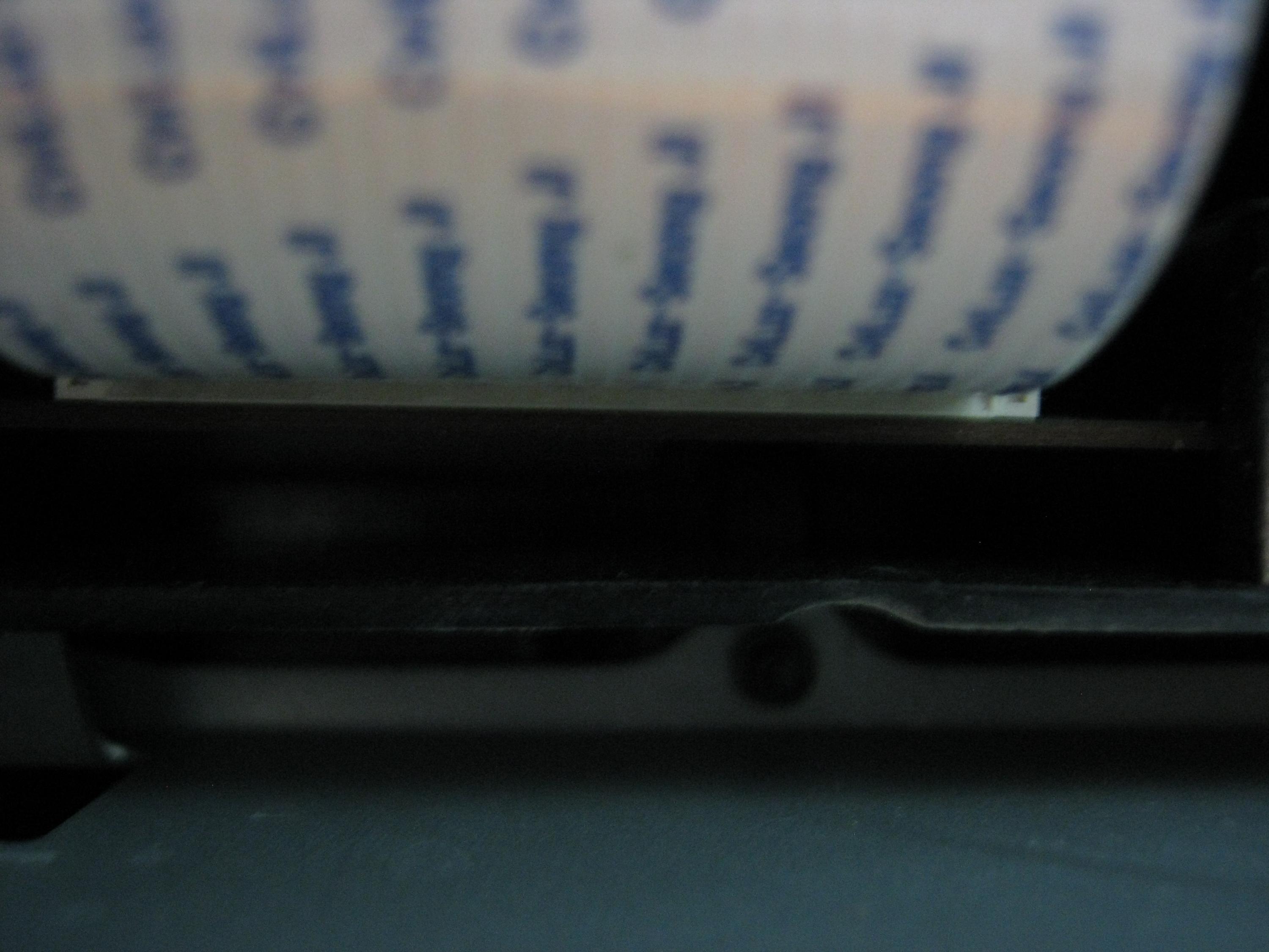

                                its visible on the last photo.
                                  As far as i know T-con board is atleast 3x4 Inches wide or more, there is not enough space in that panel,the panel top cover is 2 inches only, how can there be T-con Hidden inside there, its only Tab Bonding PCB there with few capacitance and resistors only, and the one you mention that Strip is hardly 1.5 inches.
                                    tiku.. e-ehm.. please.. watch the number of posts under your Nick and under my nick, i have also more than 3500 posts on Italian forum, you can trust me! Dismantle metal frame and you see..
                                      Though the external T-Con Bds are about 3"X4". The integrated T-Con Bds are about 3/4"X20" when they are built as part of the Panel. Ant LCD Tv MUST have a T-Con Bd for us to intelligibly see a picture.
                                        It is the T-CON/tab bonding board, you can see the SMD fuse FP1 (UD printed on top) and the 12V feeding it. If you do not believe it then there is nothing I/we can do to help. You may have not seen many LCD panels as we have here at badcaps to know what we are talking about.
                                        You can also see the LVDS signals RX0, Rx1, .....
                                        https://www.badcaps.net/forum/attach...0&d=1511171980
                                        BTW, look up the spec sheet of that LCD panel and you will see what we are talking about.
                                        Once you open it up, look for corrosion as suggested also.
