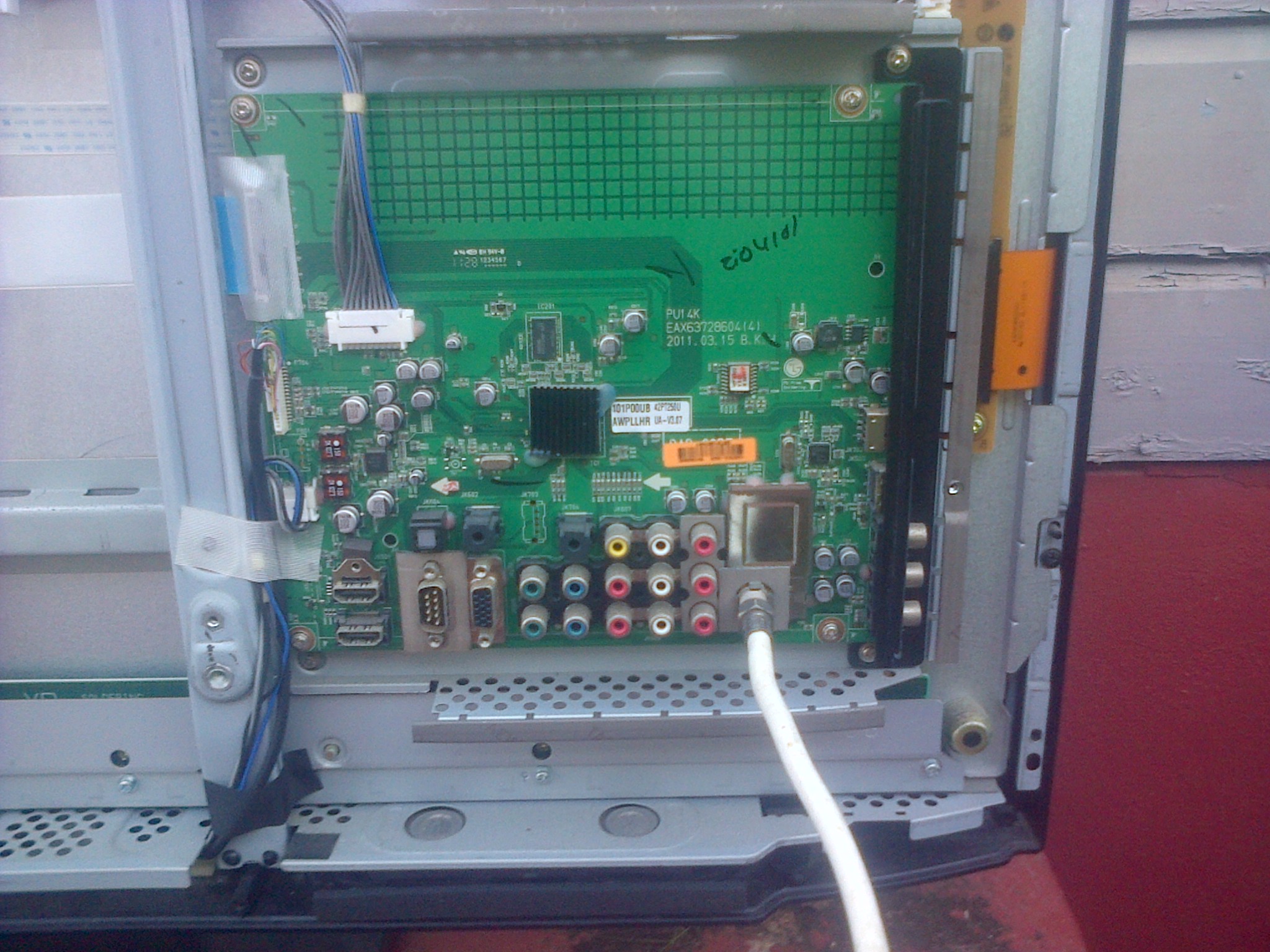

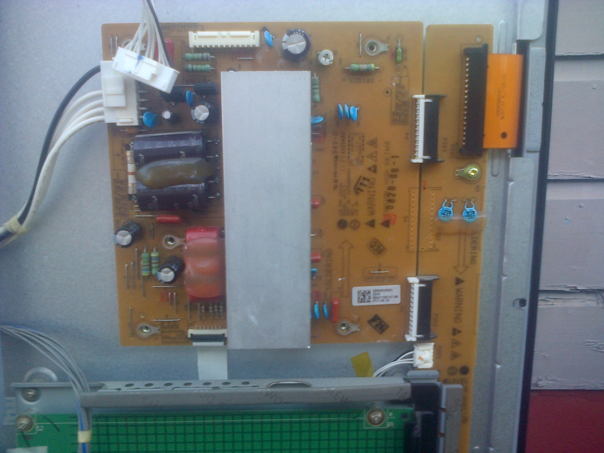

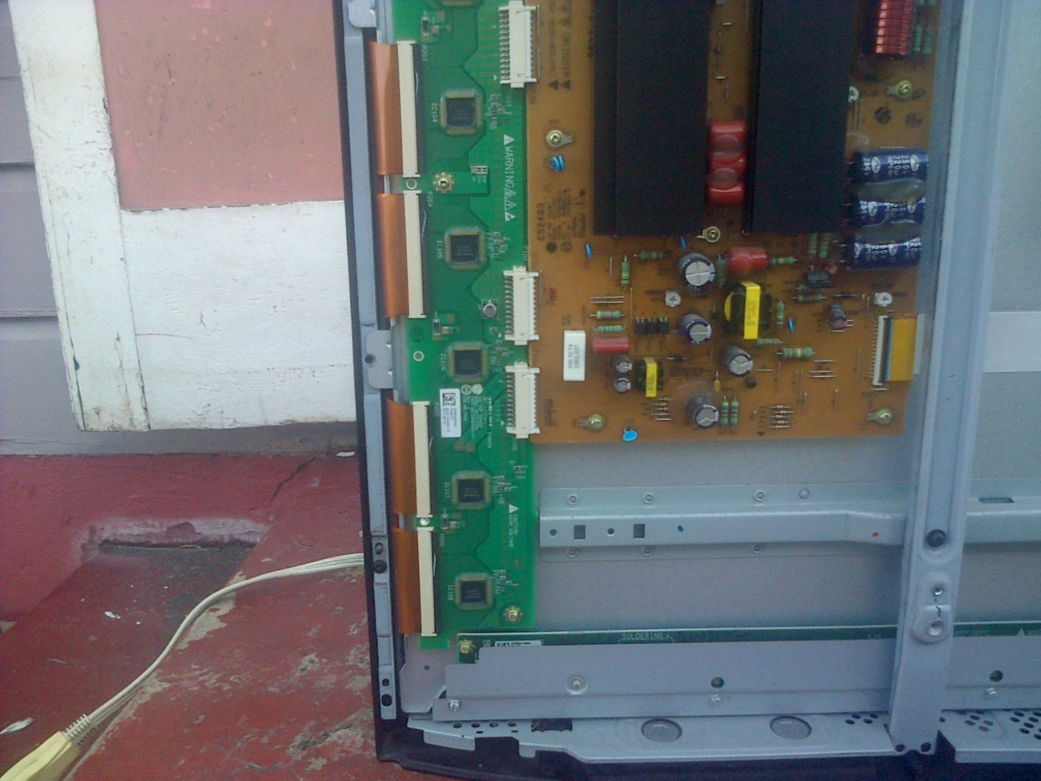

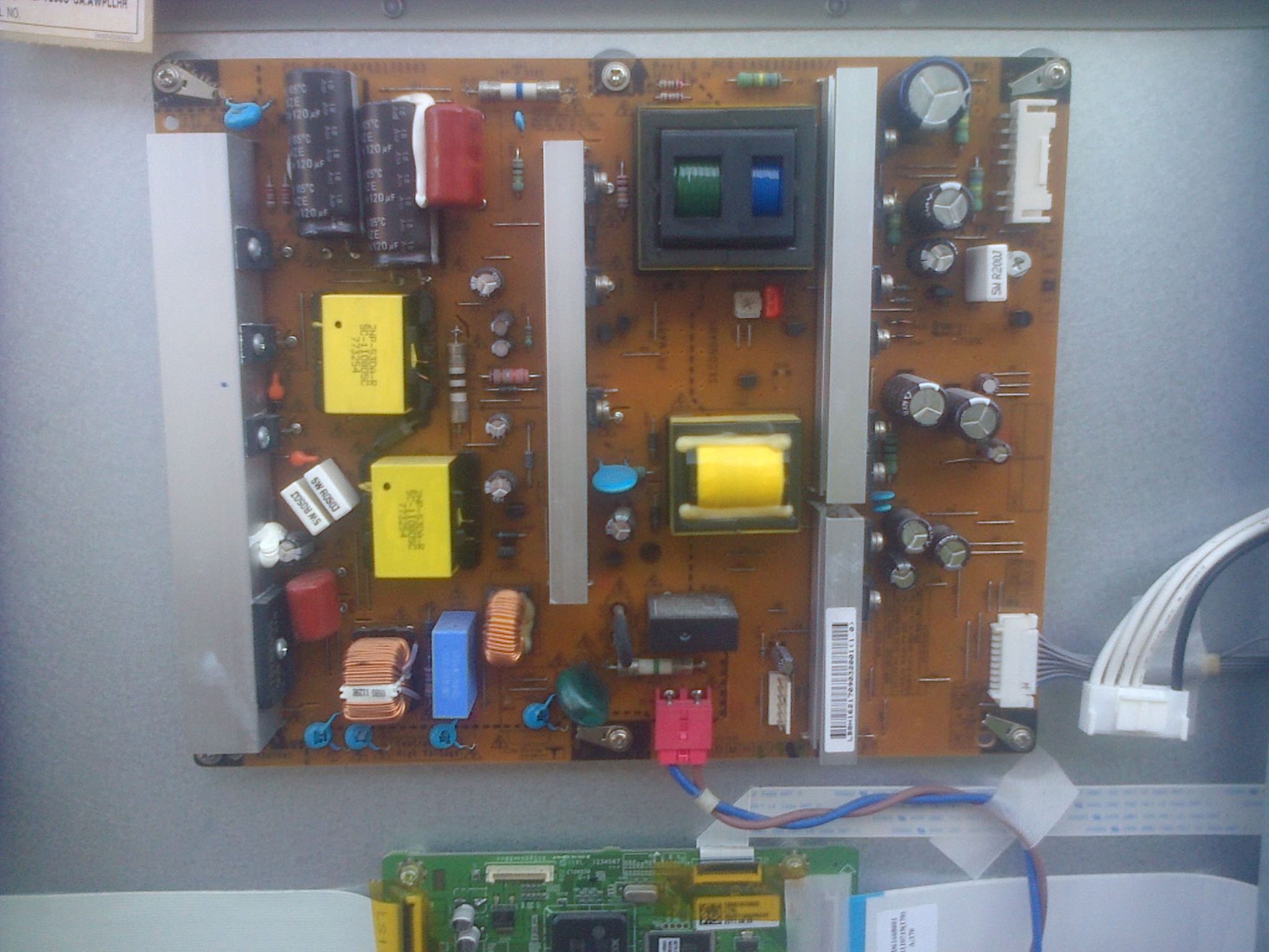

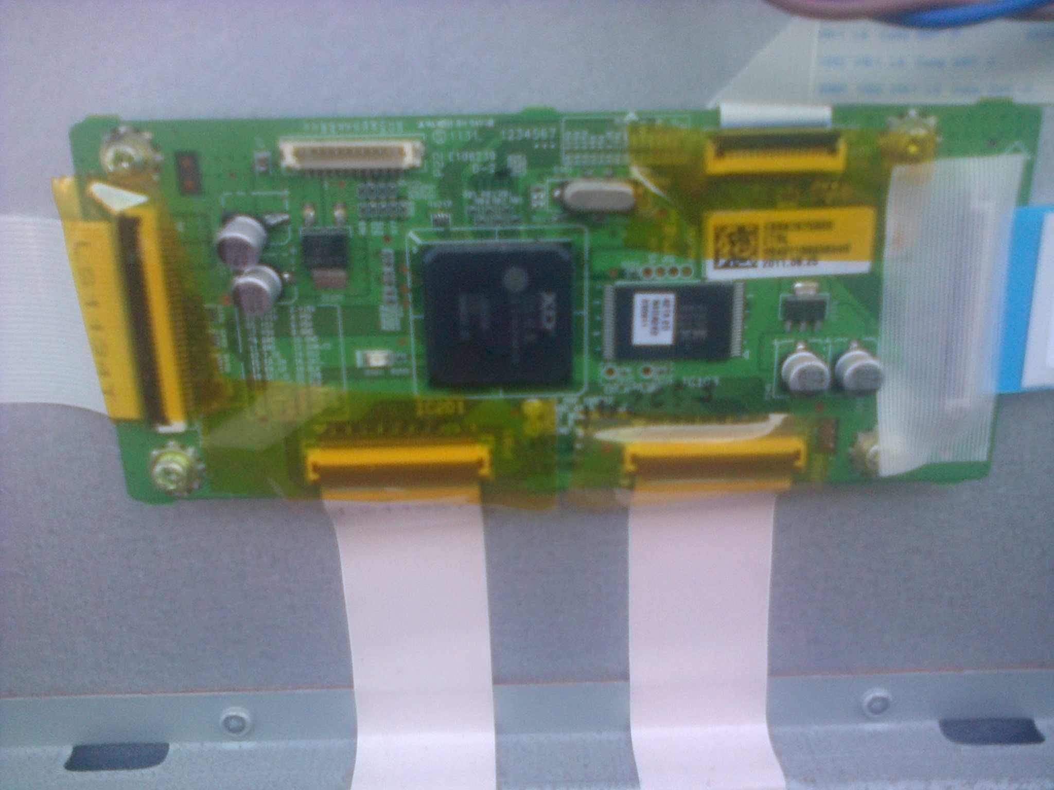

    LG Plasma #42PT250U.
    I am repairing a LG Plasma #42pt250u which does not power on, and when I unplug the ZSUS board the television comes on with sound.I have checked the board and have found 2 shorted transistors Q6 and Q9.I replaced the 2 transistors and after a while the transistors have shorted again.Can anyone
    give a solution for this problem?
