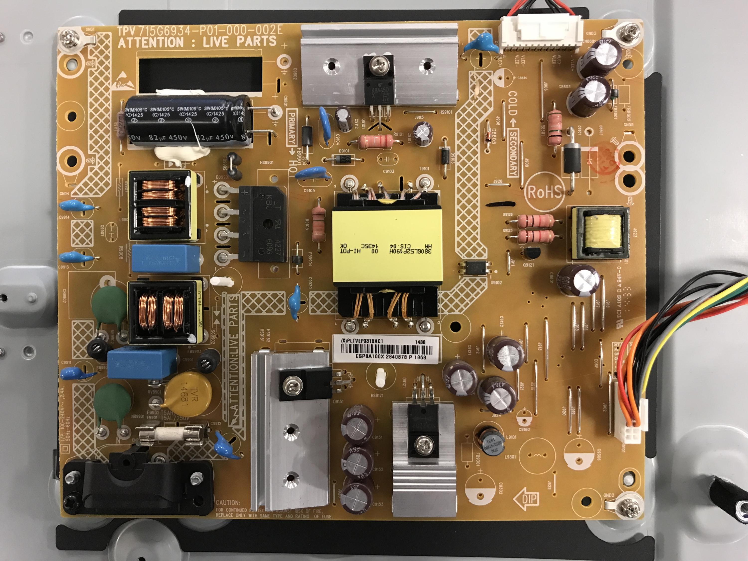

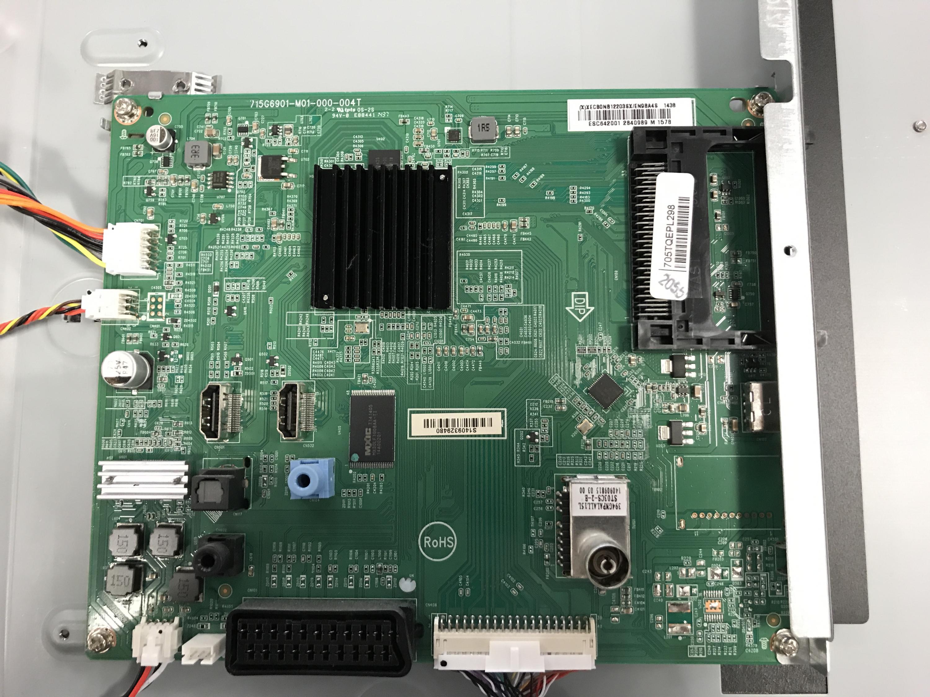

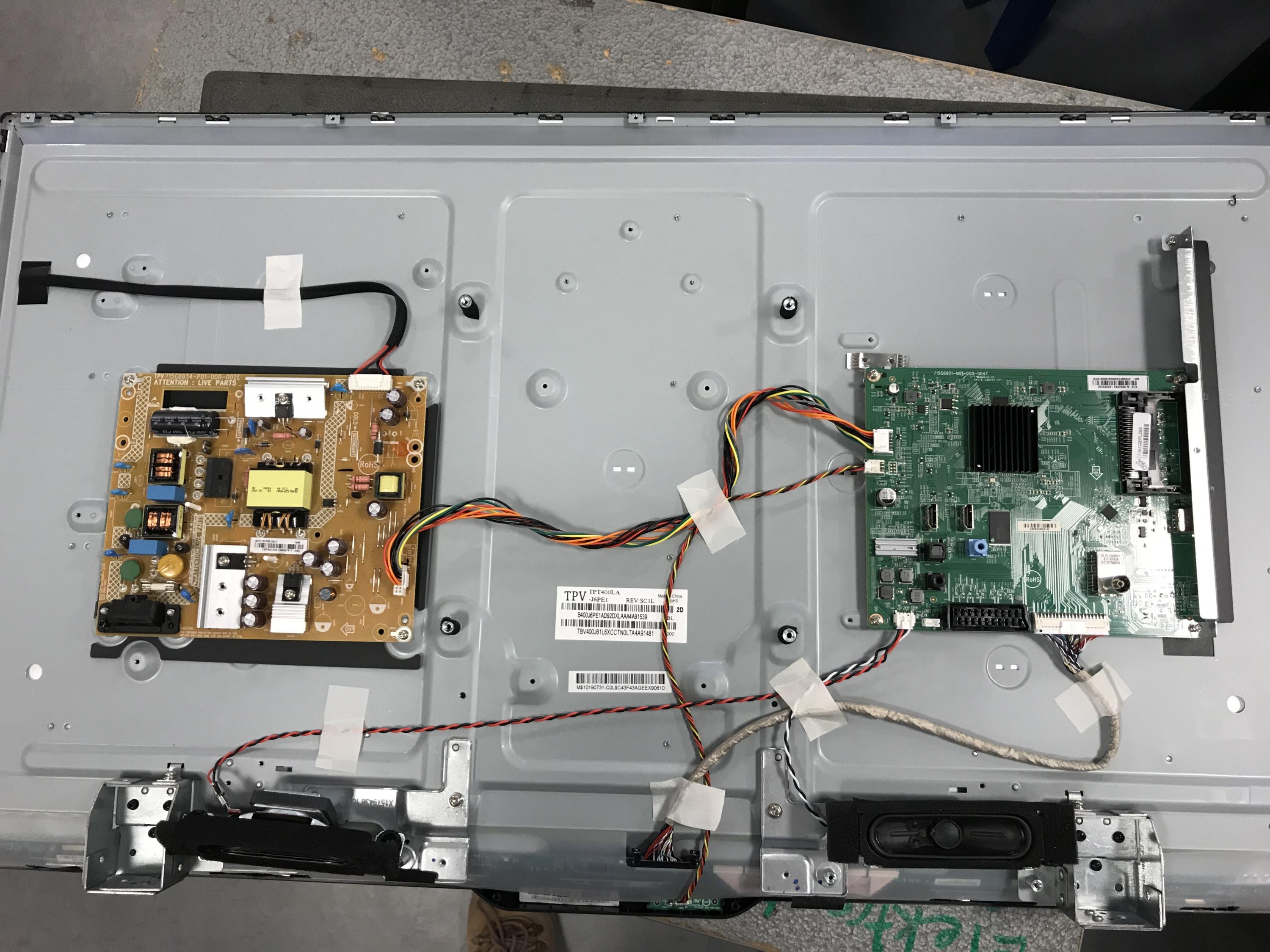

    I have this LED tv that starts as soon as I connect it to a power source.
    Philips logo comes up every 25 seconds. TV keeps restarting. Any ideas?
    Re: Philips 40PFT4009/12 - Boot/restart loop with Philips logo
    sounds like a main board problem to me.
      I have a SHARP LED TV doing the same thing. I am waiting on delivery of a new Main Bd. I couldn't figure what or where the problem lie. My guess is BGA chip. Too difficult to replace. So yes...you do have a Main Bd problem
        Update firmware using the usb slot or the service slot
