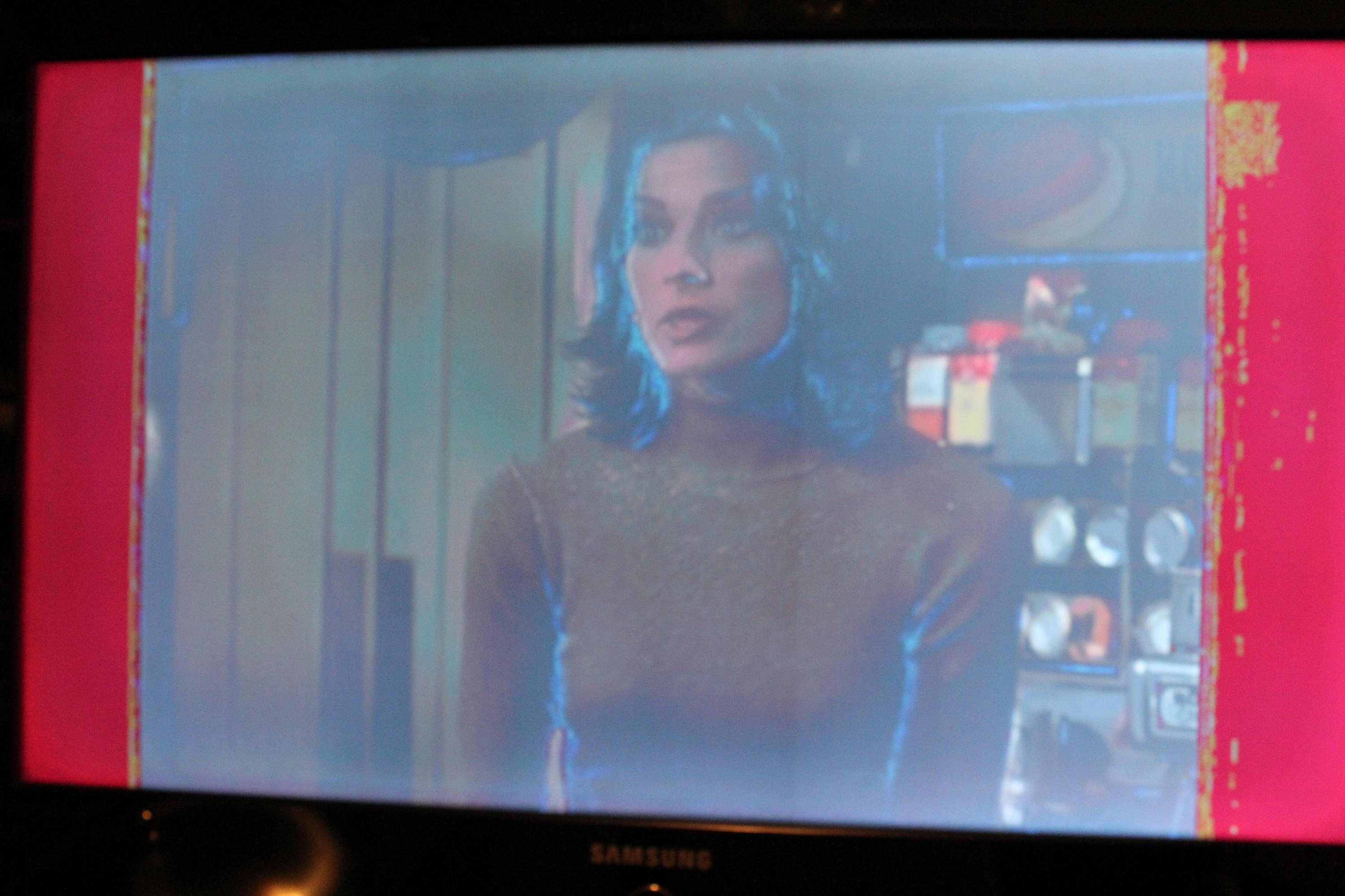

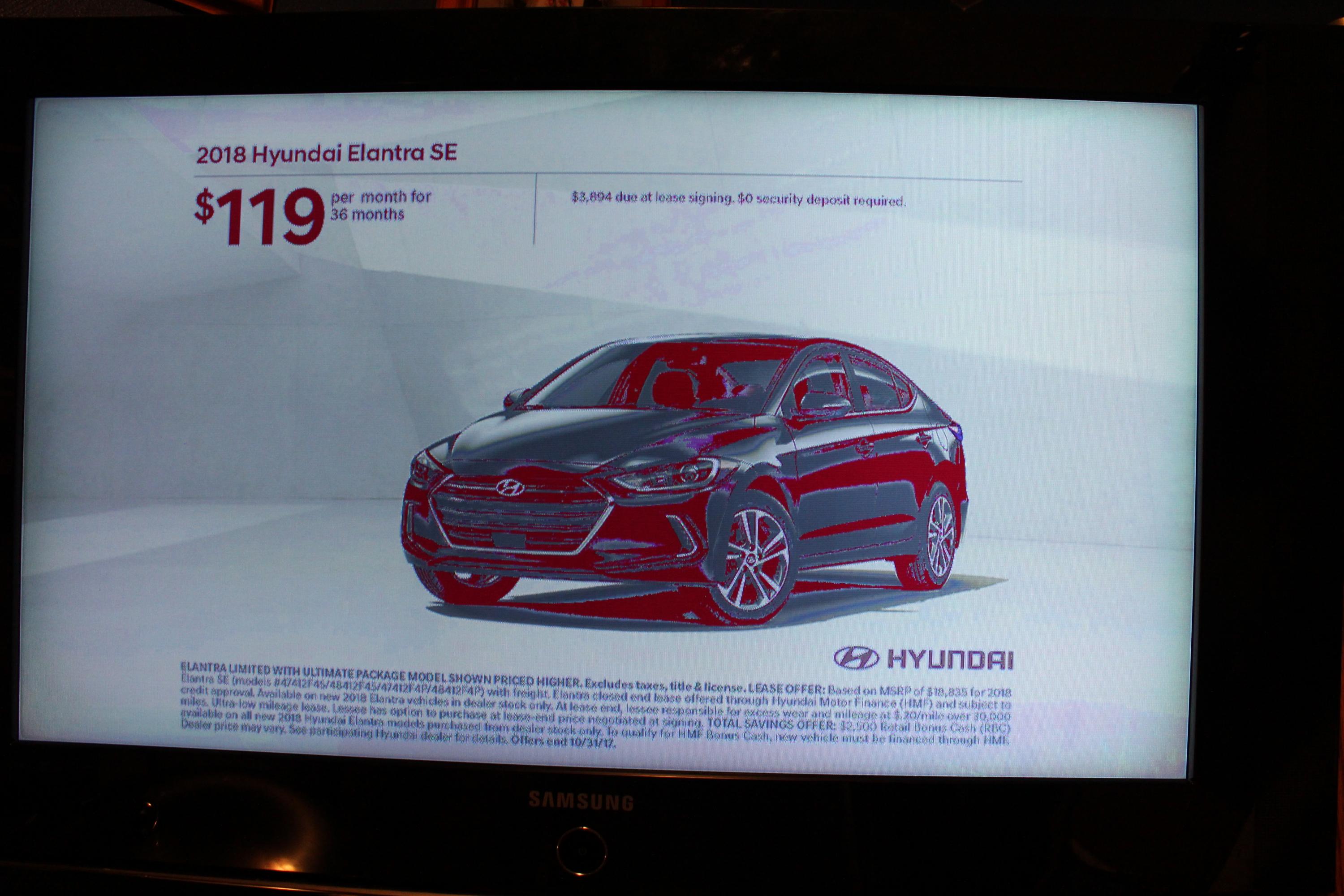

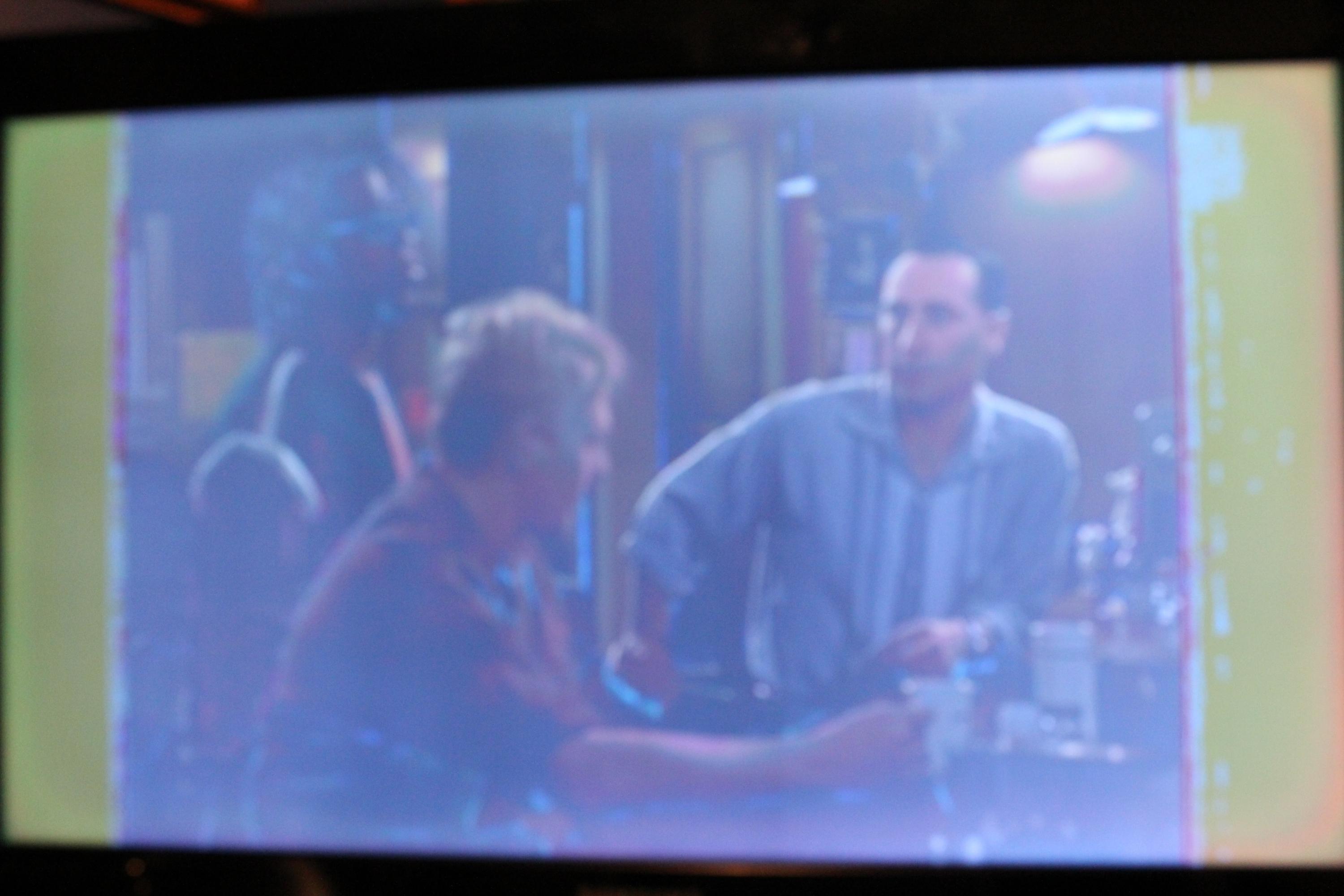

    Hello! I've done a search for related issue and did not find anything comparable so here I go (hope this is okay). My subject Samsung has display issues (images uploaded). I've replaced what appeared to be swollen caps (2-1000uf) to no avail - the problem remains. This unit does not appear to have the T-CON board (if that's possible). The power board model is BN44-00156A. Any help would be greatly appreciated.

    Could that model number be a LN-T3242H? If it is shopjimmy shows a T-con board, Maybe post a picture of the back of the tv with the rear cover removed

        You're correct - it is the LN-T3242H. So from the pics would you diagnose the T-CON board? I'm working on getting a pic of the unit w\ rear cover removed. Helping a bud w\o internet service so it will be a few. The only two boards that were visible when I looked at the TV were the power supply unit and what I figured was the audio portion. Is there another panel that covers the T-CON board?
          Re: LN3242H Display Issue
          You have GAMMA Voltages problem in your T-CON board.
          http://www.shopjimmy.com/catalogsear...t/?q=LN-T3242H.
          There are more than one LCD panel supplier for this model, so look under the metal shield to see what T-CON you have in your TV.
