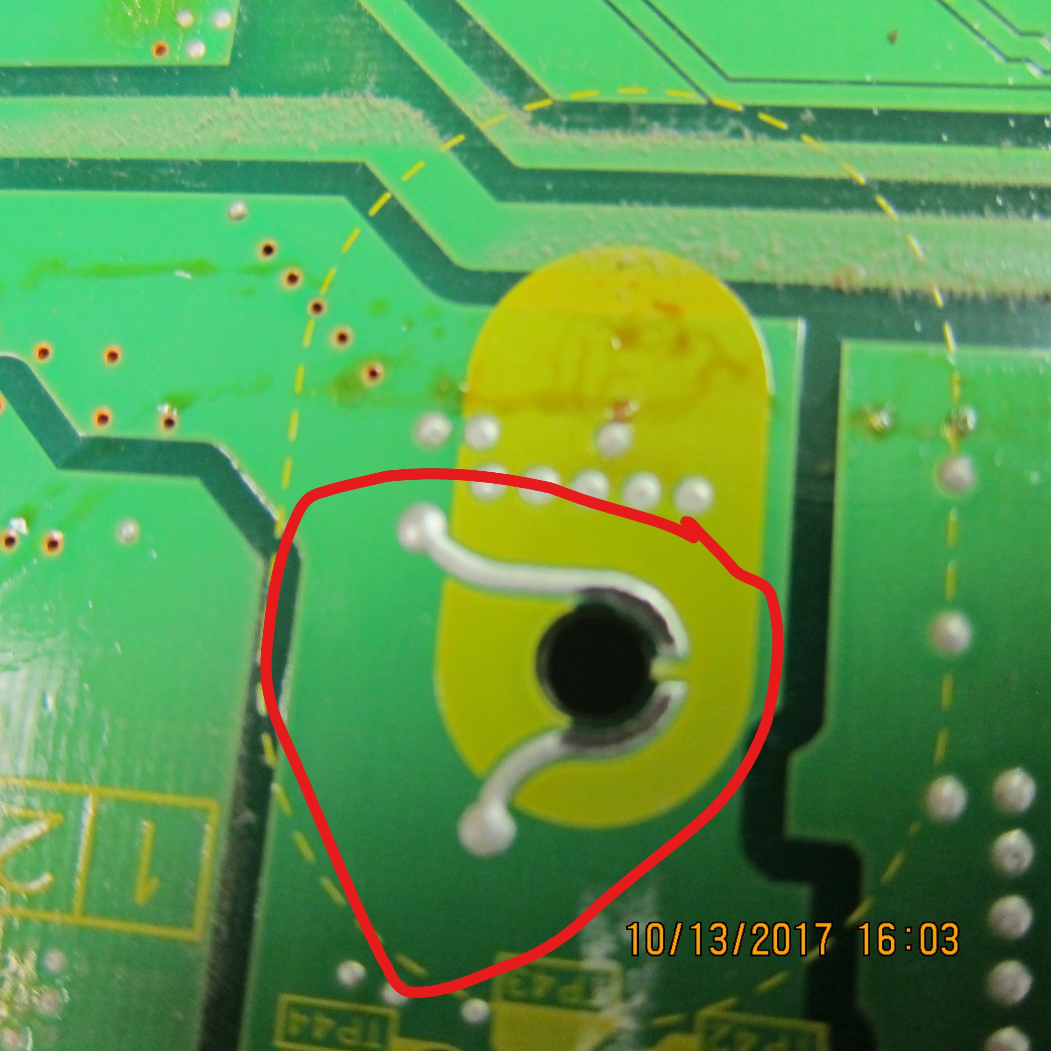

Panasonic TC-P55VT30 went out, 7 blinking lights

    While watching this TV tonight it just suddenly went off. I've read a few threads, no buzzing beforehand, to my memory I don't have the contrast set at a high level but I do have 7 blinking lights. I read that it may indicate a bad SC board, however I don't know what an SC board is and I don't have a service manual although I'm sure I could obtain one but not being able to read a schematic it might be a waste of $. I'm not a bench tech but I'm comfortable with a VOM and soldering irons, I'd feel comfortable removing and replacing boards but maybe not replacing components on today's tightly packed boards. At one time I was an installer at a marine electronics retailer in LA and some years later I sold and installed satellite TV systems so I'm not afraid to open the hood so to speak but I am limited. Is it most certainly an SC board? How would I determine this or do I even need to? I read a post indicating someone sent their SC board off for repair. Could someone direct me to who the repair shop is? I also read something about it's screws loosening over time and that replacement screws are advised. Given my lack of knowledge/skills is it advisable that I attempt to remove the SC board and have it repaired or should I just take the set to a qualified shop? About what is the cost to repair the SC board at the referenced shop assuming it's the culprit? At this point and it's age is it worth repairing or is it about to experience some other failure in the near future? I like the set and would rather not spend the $ to buy a new comparable set and given plasma's are no longer available, the time it would take auditioning sets to find what I might like.

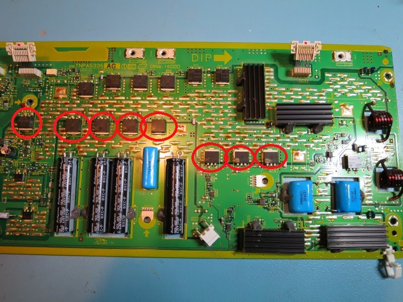

    Check the attached file.
    It is most likely the sc board and its fixable if you can solder! You need at least 85W solder iron or a good solder station.
    Put your meter in diode/continuity mode and measure the outer pins of the fets on the SC board. They are labeled with Q6... and it says 30F131 on top. If you got a beep then replace all 6.
    The parts with the red circle need to be replaced. Not all on the pictrure just the 30F131 and RJP30H2A. ( 6 parts starting with Q6... )
    The RF1501 ( diode ) and DAF30A read short because the other parts are short. If you got them in the repair kit then simply replace them also.
    Replace all 6 fets with FGD4536TM or search for repair kit on ebay from GTVWatford.
    http://www.ebay.nl/itm/PANASONIC-TNP...UAAOxy4t1SgROx
    This will fix your tv 100% if you got a beep on 30F131.
    Please report back with your findings

      Ps , the reason is indeed the screws on the sc board that are loose. Over time they got more loose because of the board getting warm/cold/warm/cold ....the board extends a bit and cools down which causes the arching between the board and the panel.
      You can replace them with lockwasher screws but make sure the replacement screws are not to long or you will reach the back of the plasma panel. ( Happened to me once )
      If you are good in soldering then also reflow the solder pads on the back of the sc board. You will see the pads are black because of arching.
      After the repair tighten all screws on all boards and your tv will be as new!

            I don't see any arcing on the screw points, well perhaps a very little on a couple but it could also be just rubbing marks but not clearly arcing marks. I did go through the whole set and tighten all the screws. Are the SC board screws long enough for me to add a lock washer to them when I re-install the board? Or can i use a spot of Loc-tight on them?

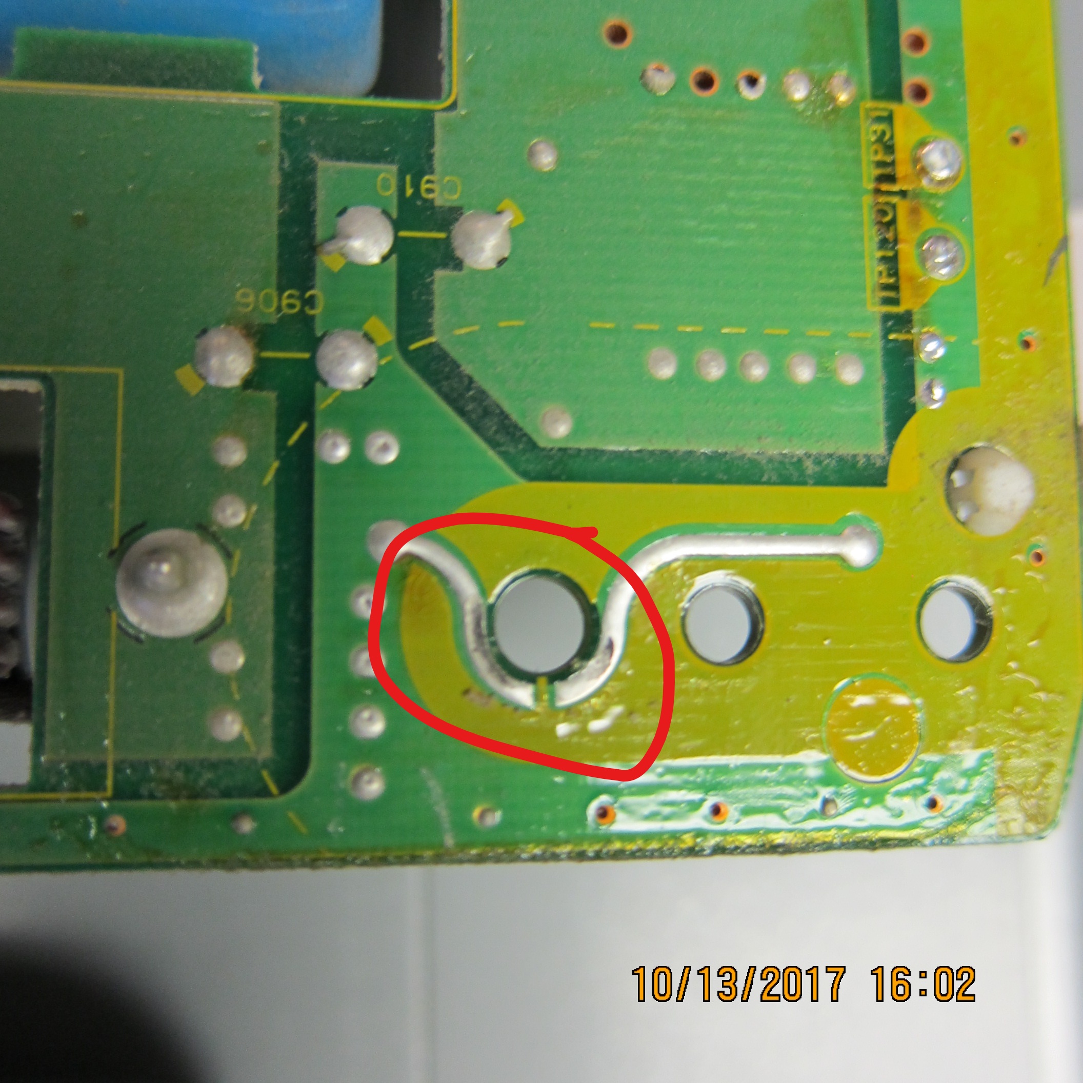

              I t would be rare that there is no evidence of burning or arcing around the screw holes of the board. Look at the rear of the panel where it was mounted. Black spots, won't clean off, that's arcing. If none then so be it. important thing is to try and clean it all up and securely tighten the boards preferably with bolts and spring washers but ensure the thread length is no longer otherwise it may go through the panel. I've read of someone doing that, must have been long bolts.

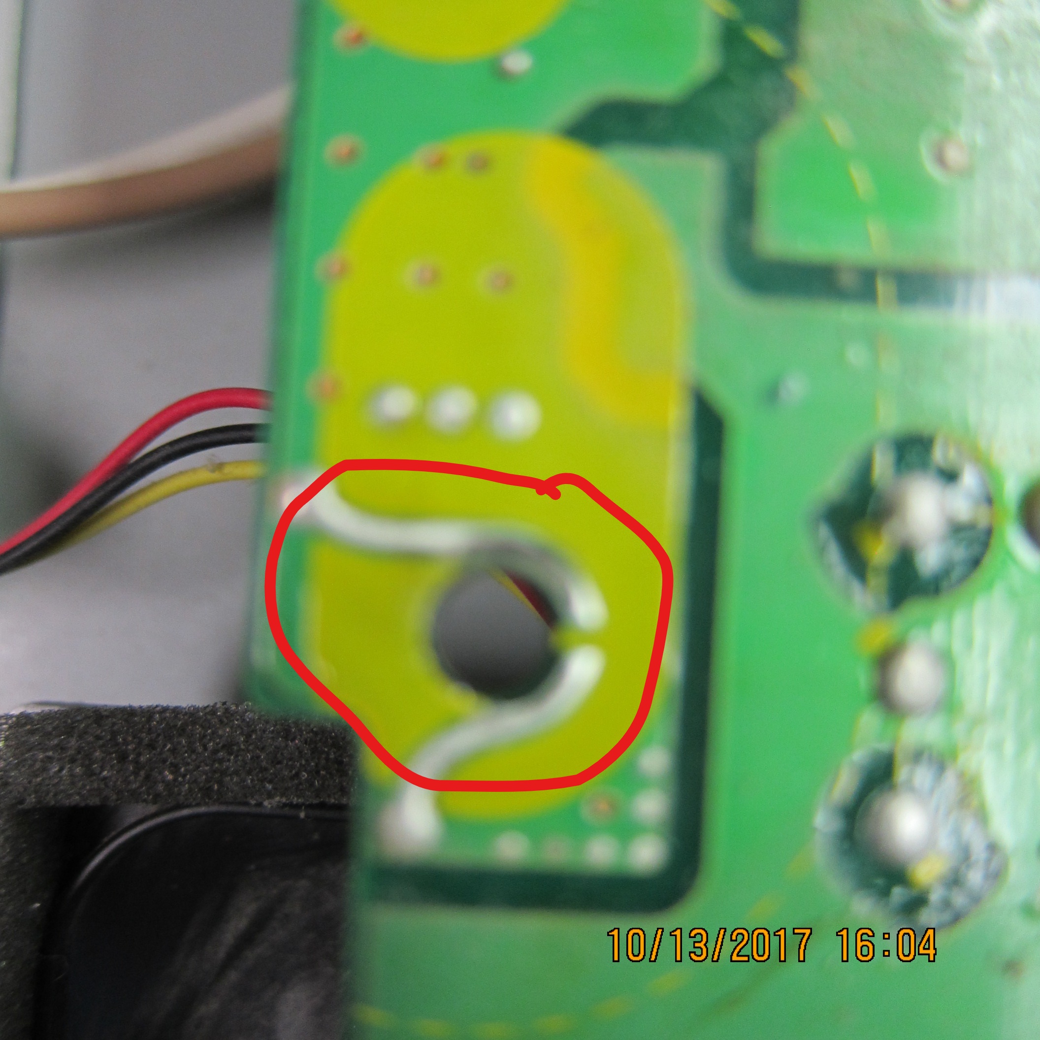

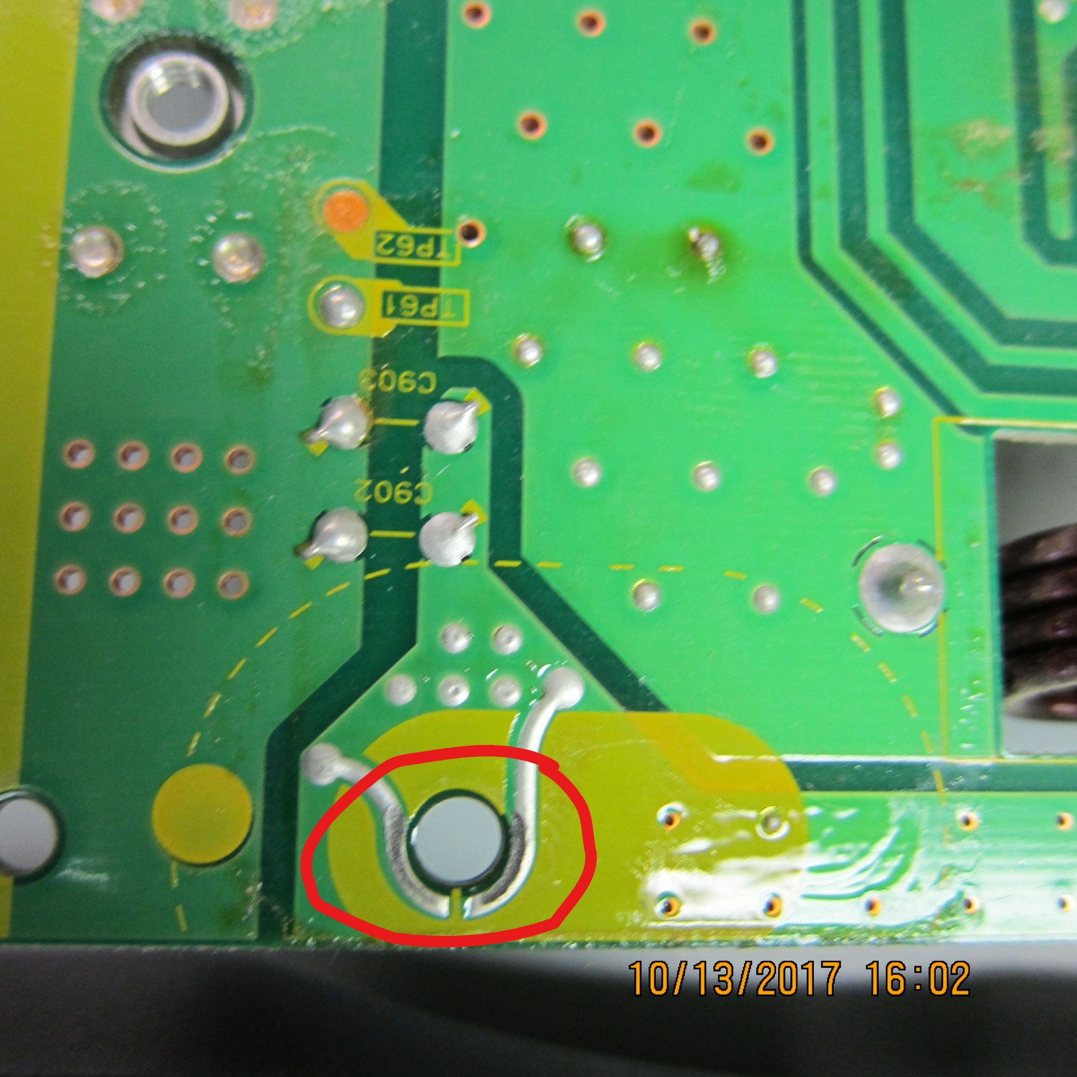

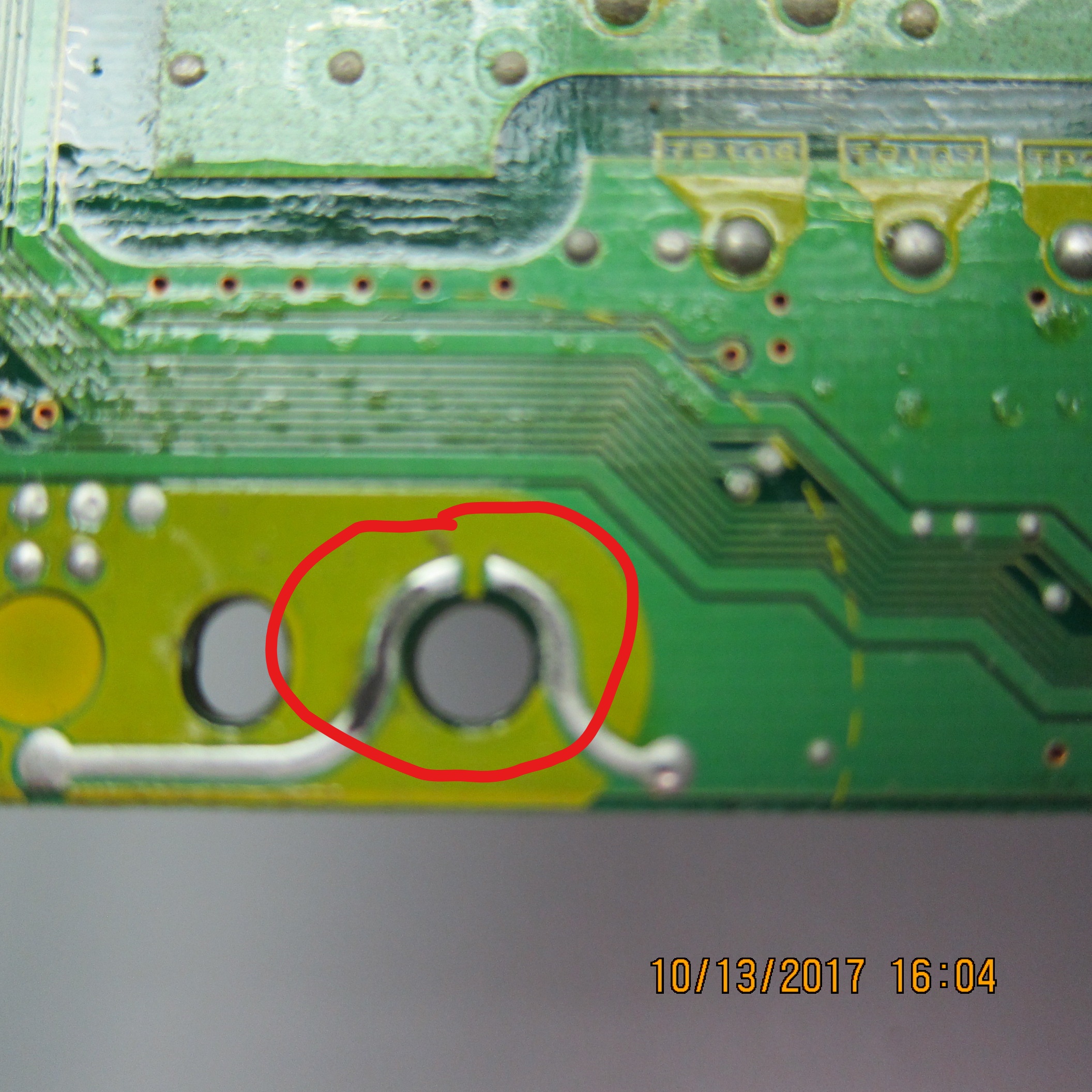

                Q102 on the SS board measures 46.8 ohms so I assume it's OK?. I didn't disconnect the SS board before measuring. Was it OK to do it that way?
                I've attached pics of the connection points that that I now see arking evidence on. Easier to see in the pics than it was with a magnifying glass. These I feel I can reflow.

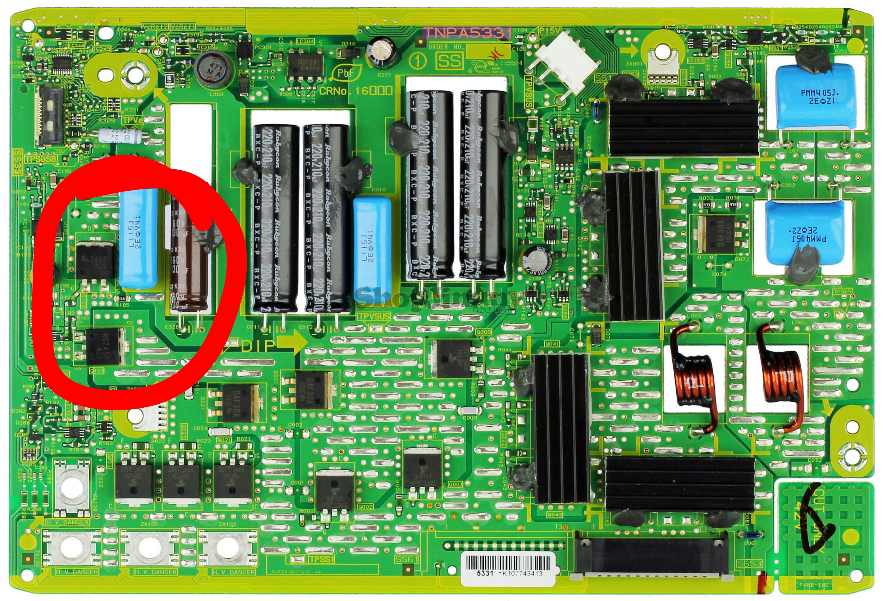

                              8 would be the SS board.check q101 and q102. you might have to lift the legs of the parts to get a reading you can trust.

                                    Have you checked the SS? At least half of the TVs I've touched had a shorted FET, Q102, that went out in sympathy of the SC. check it out
                                    How do I test/measure Q102 to see if it also failed?

                                      You can lift one leg of those fets and check again. One ,or both is shorted. Tw2005 said 48k ohms is good,48 is short.
