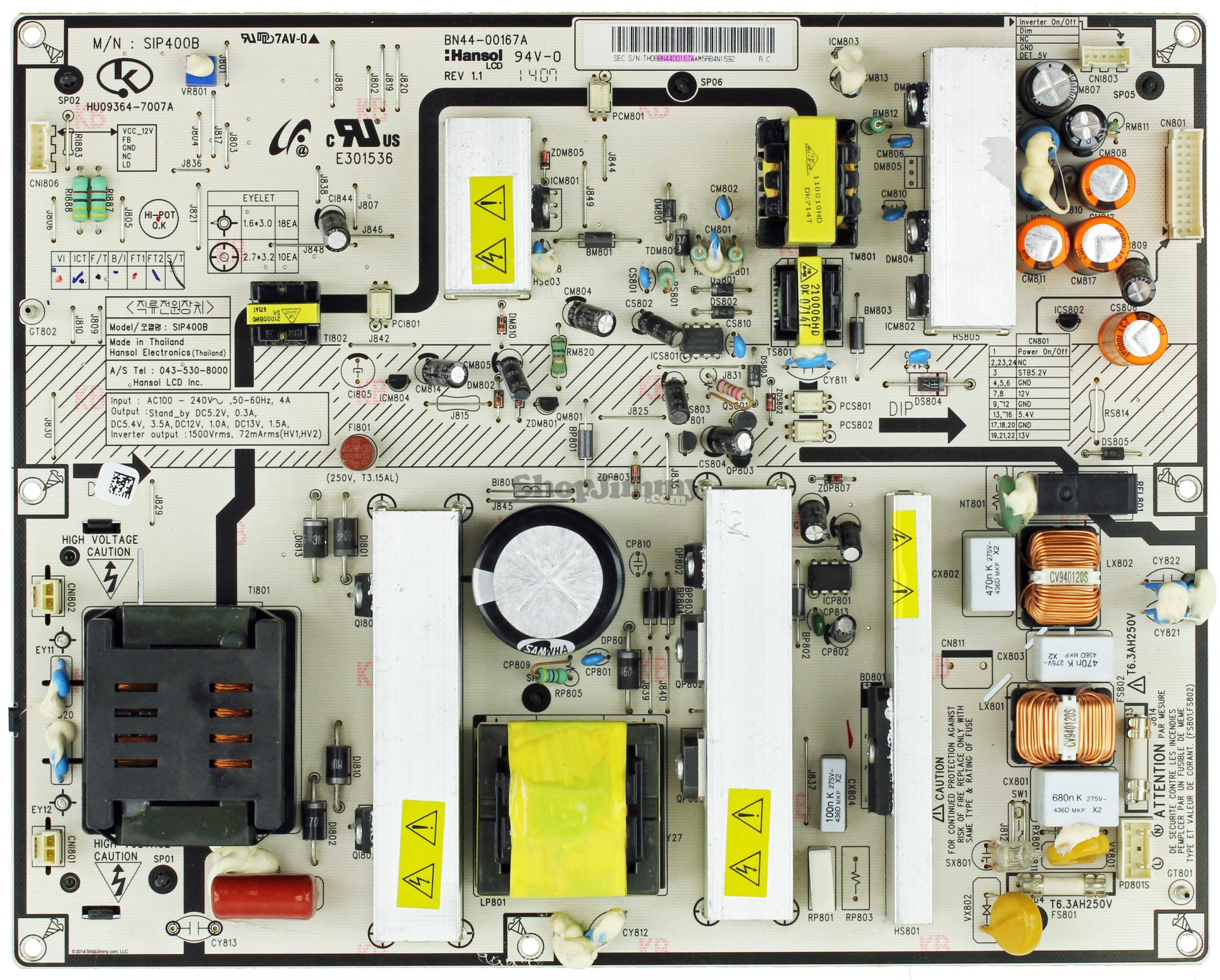

    Hi all working on this set 40". it was brought to me with the typical clicking and nothing. I was told it used to click constantly till it warmed up and then it stayed on. They pushed it till that didn't work anymore. Now it just clicks and nothing.
    Tore it apart sure enough bad caps on top right of power board. Replaced those with rubycons and panasonics. STILL just clicks and nothing. I am afraid something else was damaged due to pushing it. I will update with voltage readings and anything else i find. Has anyone dealt with this problem? There is absolutely no backlights not even a flash.
    Re: Samsung LN-T4042H
    Power supply board P/N? BN44-?????
      The power supply repair kit contains 9 capacitors. Have you changed them all?
        power supply board p/n? Bn44-?????
        bn44-00167a (sip400b)

          Replaced 7 of them. Wonder the last 2. Kit on S.J.?

              Wonder what caps are in the kits it doesn't say. Must be one of the little start caps. Will probably go ahead and replace those from digikey. Going to check voltages soon here.

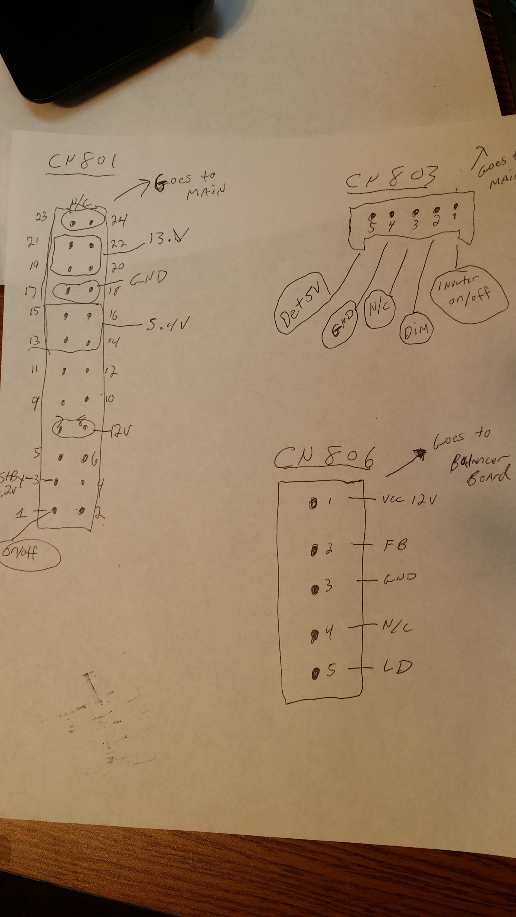

                    connector above cn801 can't find legend to name of connector. goes from main to power supply not seeing names to the pins.... Will look around might be on backside. OK edit, found connector name is CN803
                    On /Off
                    Pin 1 .036 .020
                    pin2 N/C
                    pin3 N/C
                    pin4
                    pin5 5.35v 0v

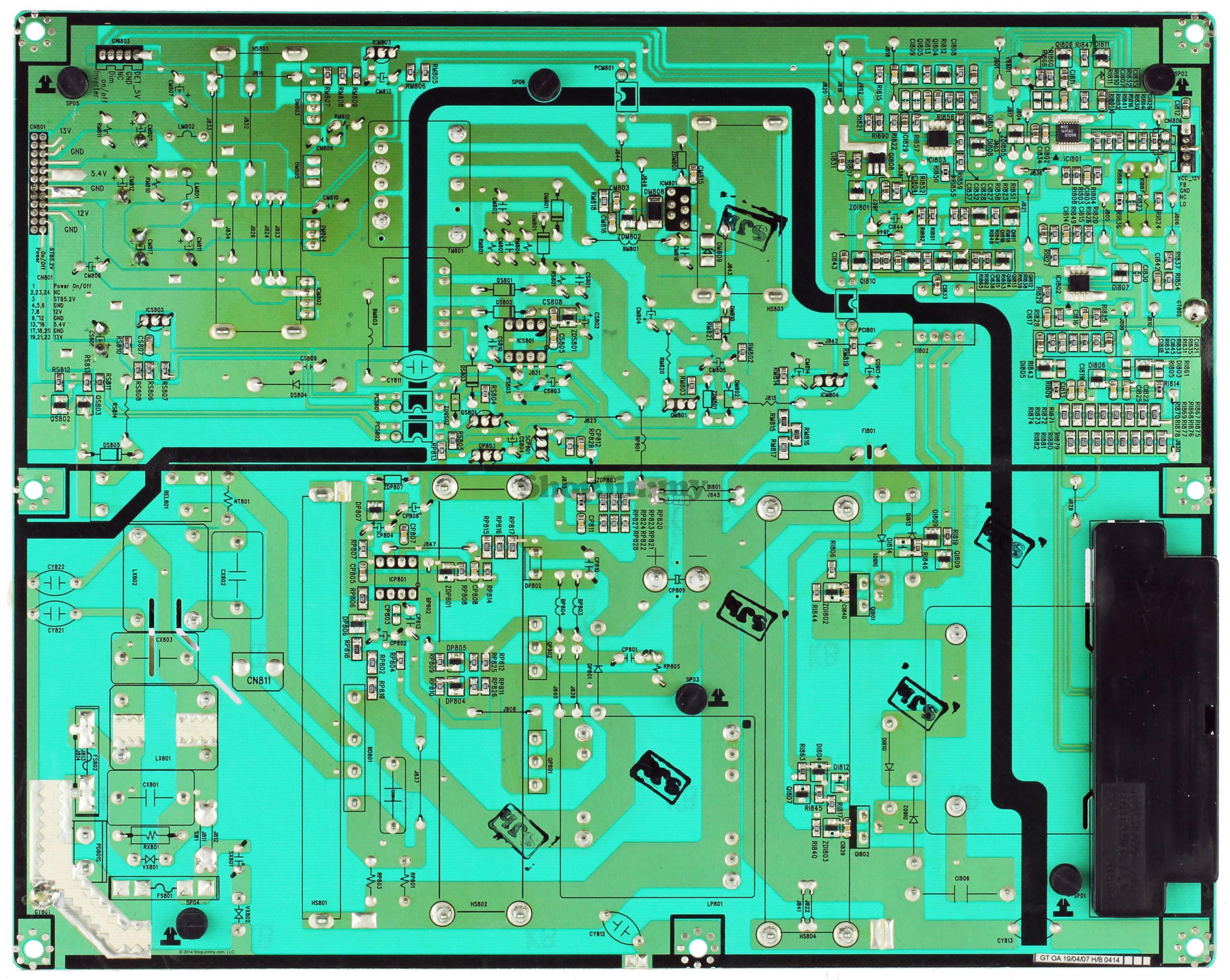

                      Pics provided by shop jimmy top and bottom view

                            pin layout and names, ignore above voltage readings earlier in thread will relist correct voltage pin names etc. stay tuned.

                                CN801 voltages are good we have all voltages on this connector and correct.
                                Cn803 needs attention voltage as follows
                                pin 1 inv/on/off reads .036volts
                                pin 2 dim reads 3.46 volts
                                pin3 n/c
                                pin 4 ground
                                pin 5 is detect reads 5.36v
                                cn806 reads
                                pin 1 VCC12V reads 12.18v
                                pin2 FB reads .001v
                                pin3 ground
                                pin4 N/C
                                pin 5 is LD reads 10.33v
                                  Main board is not sending the signal to turn on the Inverter circuit, you can disconnect the INV going back to the main board first and then try forcing on the inverter using the resistor, if the only problem you have is the bad INV ON/OFF then you should see backlights, pictures, sound, and all the TV function should work normally.

                                    Ok i jumped 5volts with resistor to inv and yes the backlight came on on first try of relay click however thats all it does no picture, no response via remote. After 60 seconds er so it turns itself off and back on but still no response. so it's safe to say main is cooked. i removed the heat sheild and found the the ati graphics chips has been very hot before and some voltage regulators output tabs are shorted to ground.
