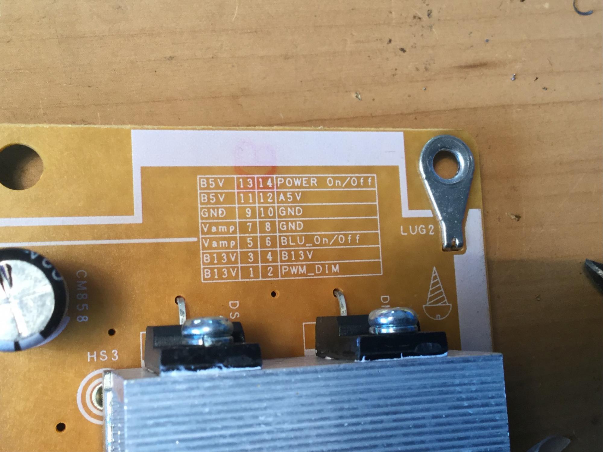

    Q2. How does the power pins work? Is it to ground or to 5v? And with a resistor
    Q3. Whats the difference between "power on/off" and " BLU_on/off"

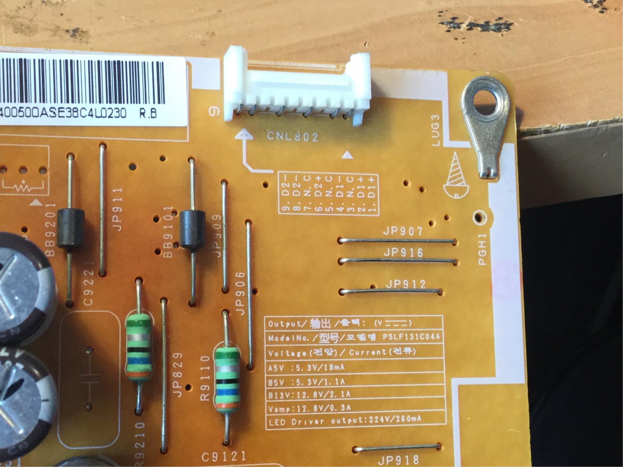

    And here is the pin layout for the cable.
    Oh also my guess for this problem is a dodgy transistor, before it was stuck close and now it is stuck open?

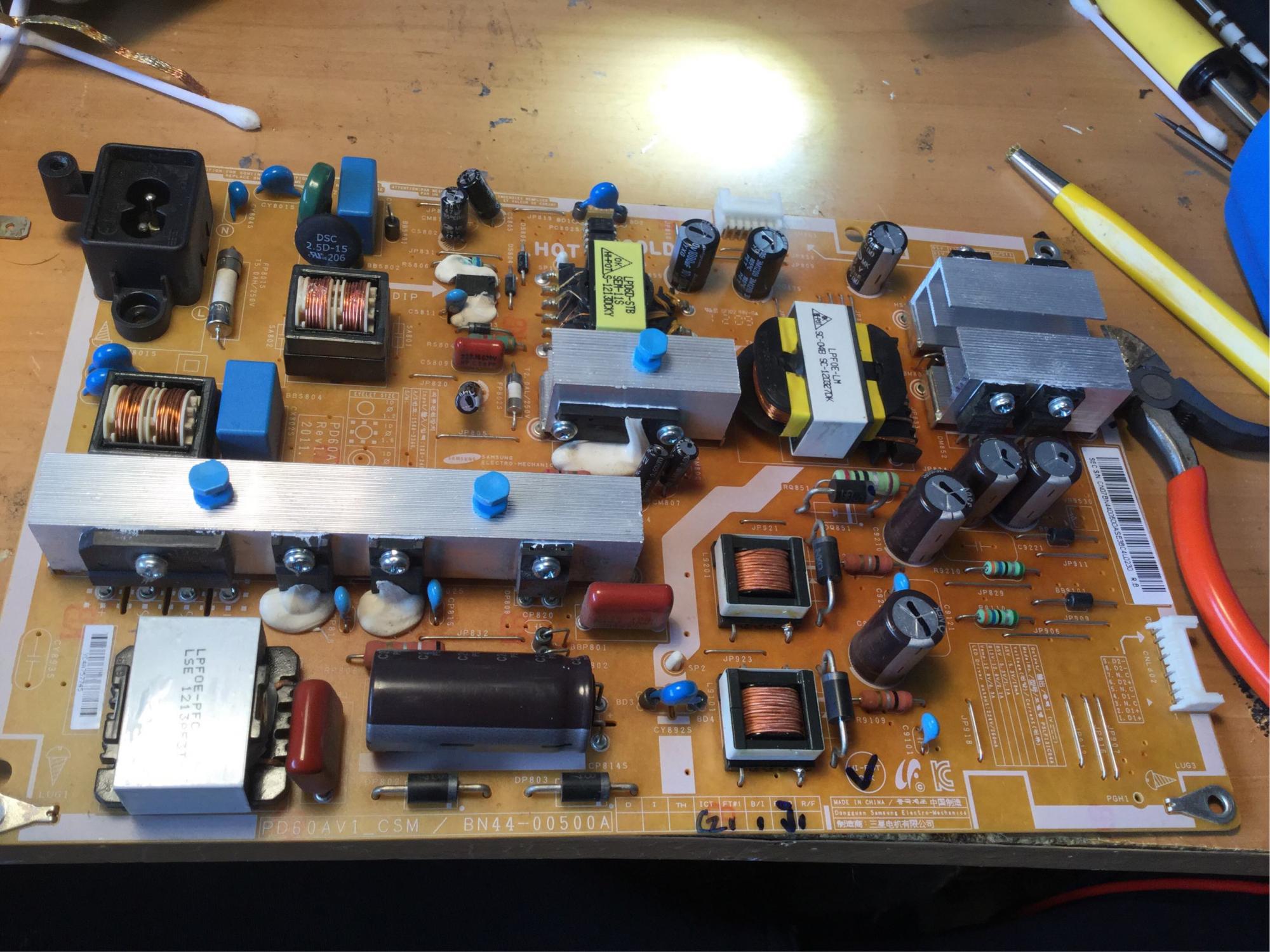

        So let me get this straight, if you disconnect the cable between the power supply/LED driver board BN44-00500A and the main board then apply AC you will the get the backlights to come on right away and backlights stay on as long as the TV is plugged into the AC outlet?
        If that is the case then your power supply board is OK, this power supply probably has pull-up resistors for doing the self test.

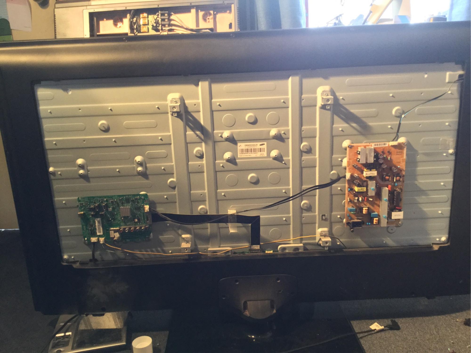

        We also need good clear pictures of the whole back side of the TV so we can see how all the boards are connected together.
        "power on/off" = PS-ON/OFF
        " BLU_on/off" = BL-ON/OFF = Backlights ON/OFF

          Picture included

            The pull-up resistors are for simulating the ON command signal from the main board so the tech can easily isolate the problem in the field instead of using resistor between STBY power supply and the PS-ON pin and the BL-ON pin while trying to service the TV. They did not do that in the earlier version of the TVs so you have to do the force on yourself with the resistors.
            Sounds like you have problem in the main board. You can record the DC V on the PWR ON/OFF pin and the BLU-ON/OFF pins as they are right now without the main board connected and the compare them to the readings when all boards are connected and the TV is not working so you can see what are missing.

                  Re: Samsung UA60EH600 weird startup
                  Well, I did resolder a couple of startup capacitors on the primamry side of the main transformer curcuit, and its been running 2 hours non stop. Still i have my doubts..... Guess it was a dry join, Time will tell.

                    when re soldering the capacitors on the power supply the heat may of lowered the esr on them hence the set is now starting up ok if it fails too start again just replace the capacitors with Panasonic brand
                      I would also re-solder all the transformer legs and all the legs of the components that are mounted to the heatsink, especially the one with through rivets.
