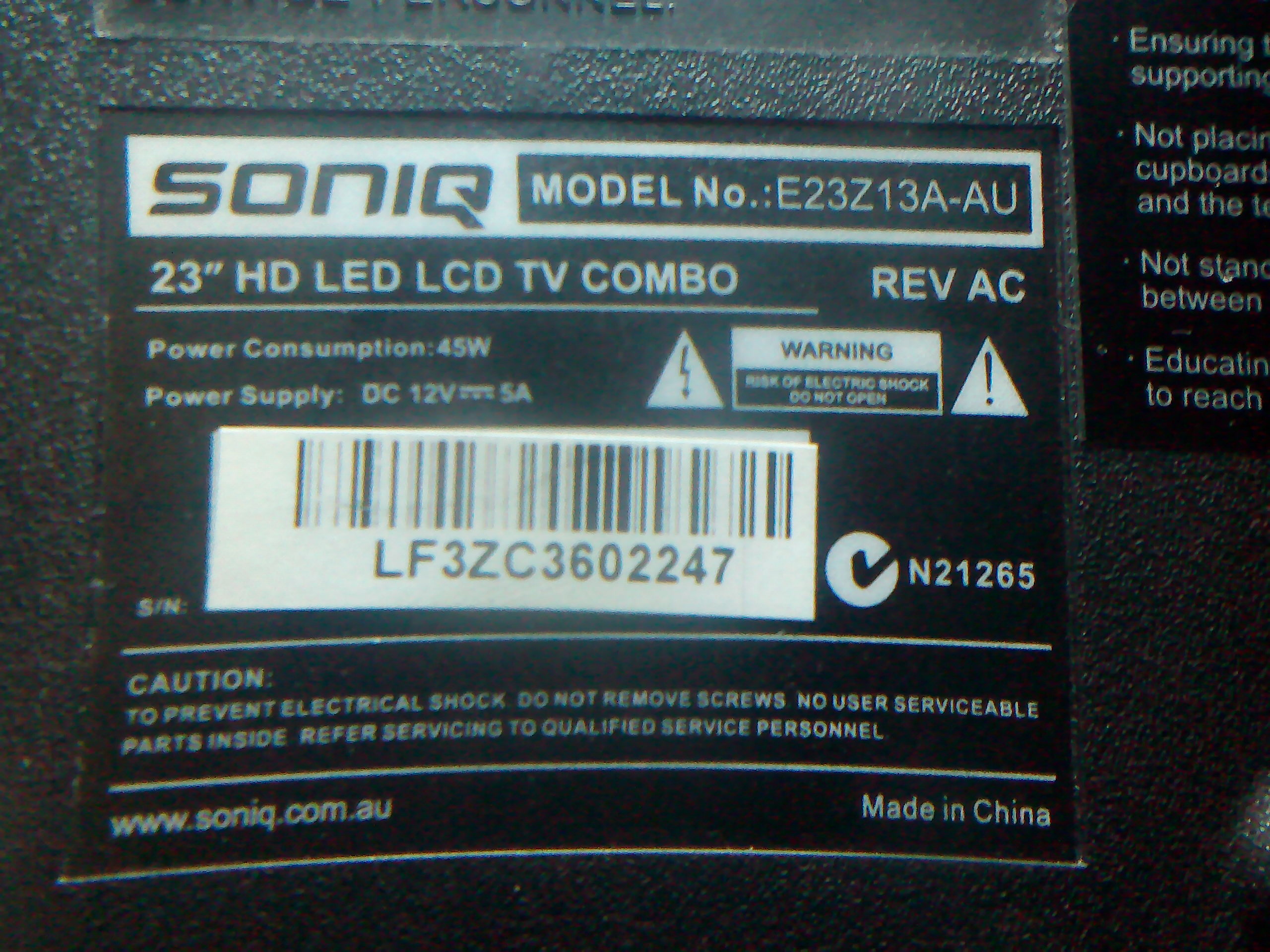

Soniq e23z13a-au
  • koka0011
    • Apr 2013
    • 30
    • Sri Lanka

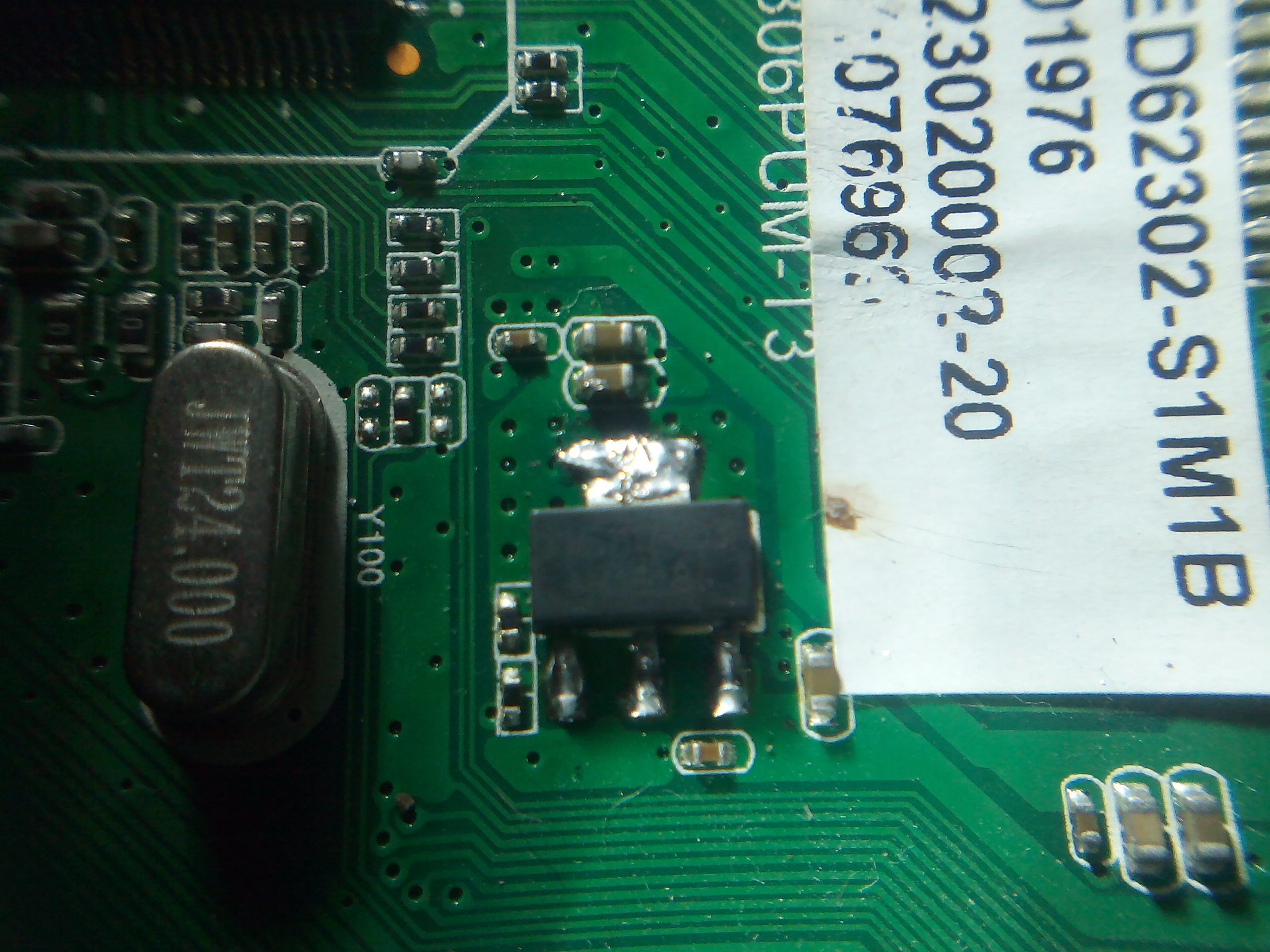

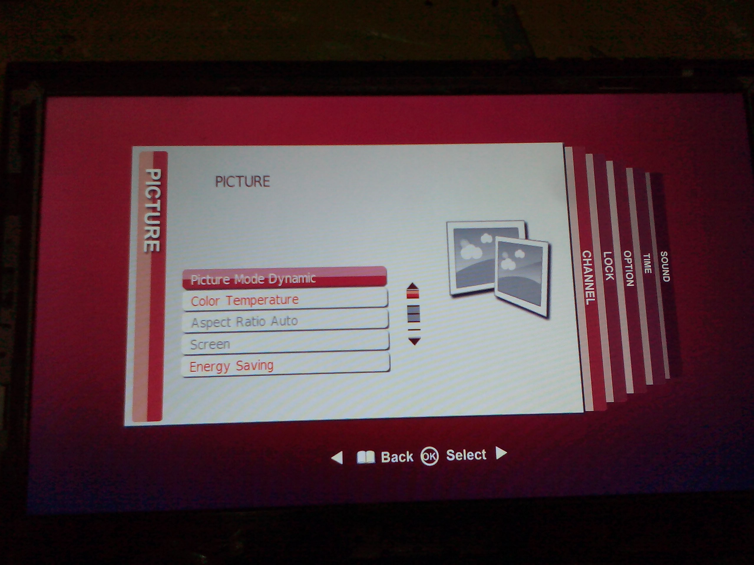

    Soniq e23z13a-au
    Stuck in stand-by mode.
    Checked all the regulators 3.3v ok. Found 1117 adj regulator output voltage drops to 1.3v.it must be 1.5v in this tv.changed the regulator now tv works fine.
