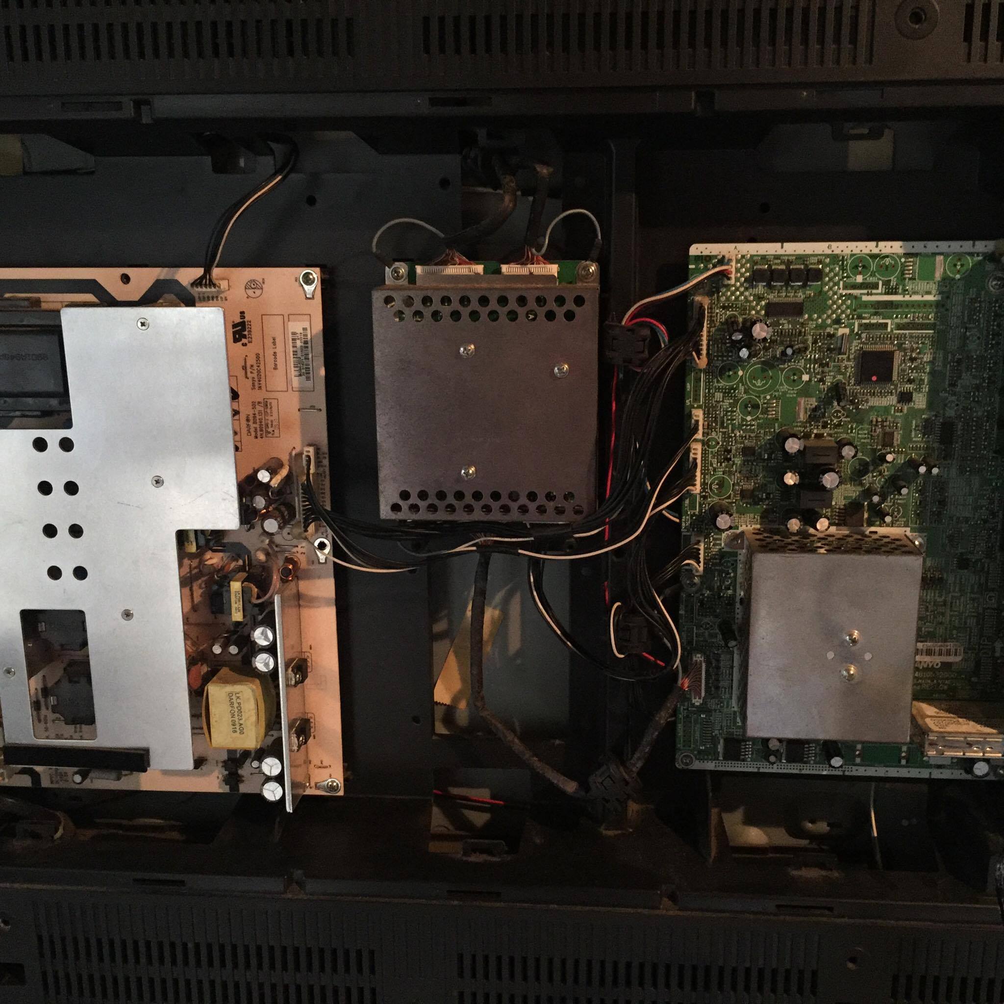

    I just have a question and need some advice. I have a Sanyo DP52449 Tv and can get audio but no picture. I have checked the voltages from the power supply board(please see pic) and the 5v is there but the 12 or 15v is not there. The screen is only like a bluish color nothing else. I connected tv cable and was able to get audio. My main question is could power board be some bad and not all the way dead? You know like I could still get audio but no video. I have also replaced the Tconn board. Please reply soon with any advice you may can give.

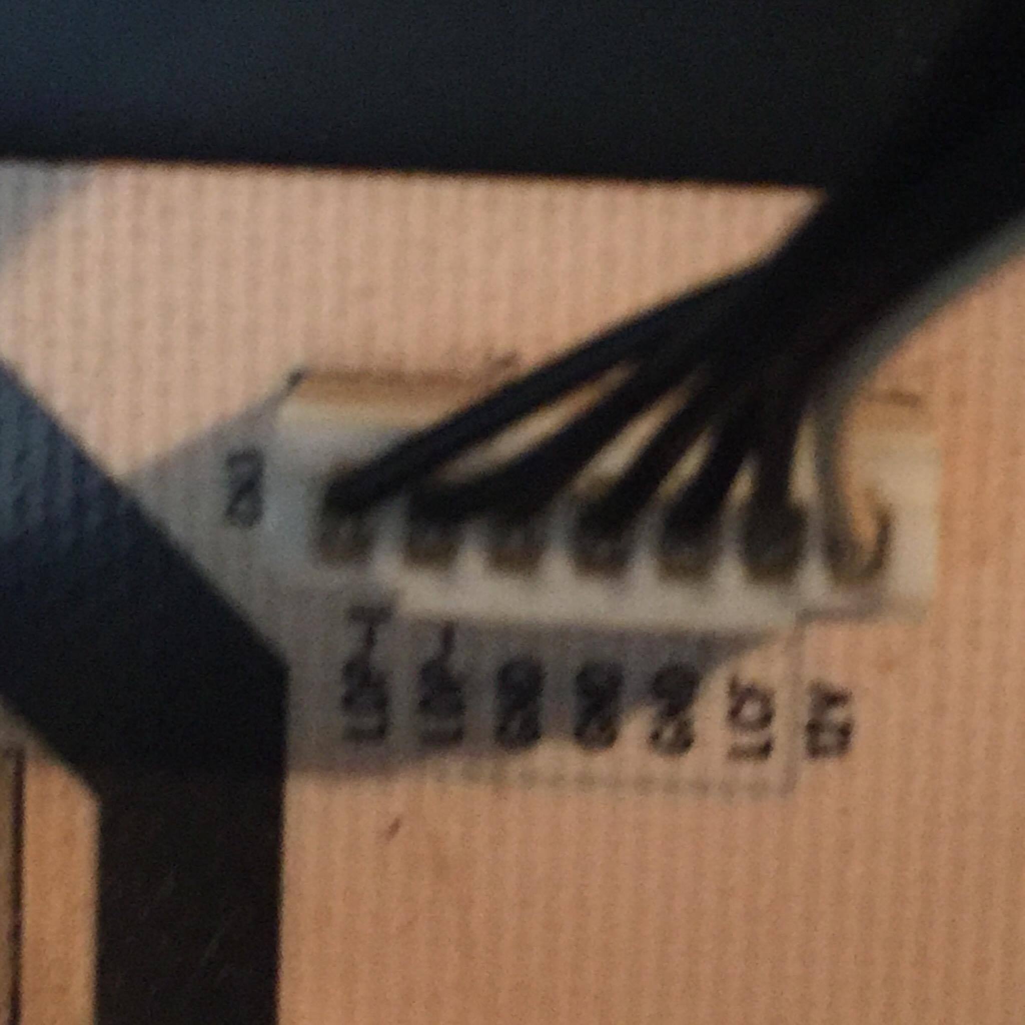

              Re: Sanyo DP52449 audio no video

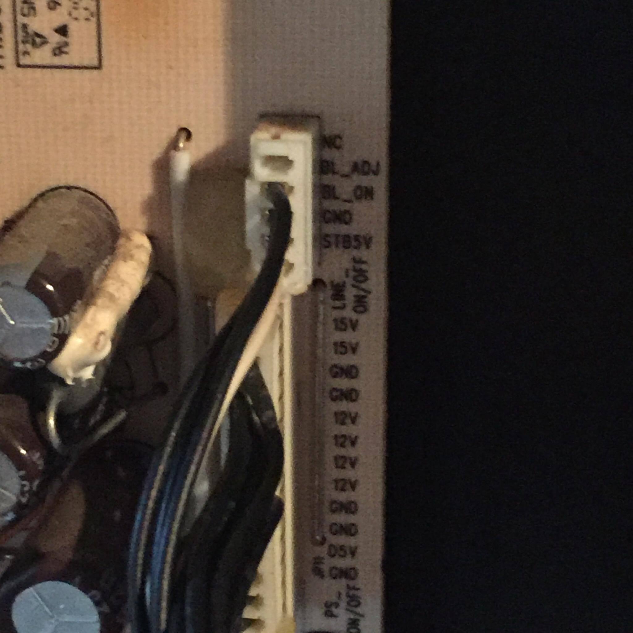

              Ok I checked all the voltages with everything connected and tv on. The results are not good I dont think
              Small White Connector on Power board=
              LDP-1= 010v
              LDP-1= 010v
              gGND
              GND
              GND
              LCF= 0v
              12v= 011v
              Small connecter next to main board connector on power board
              NC
              BL_ADJ=002
              BL_ON=002
              GND
              STB5V=004
              Main board connector to power supply
              Line/Off=0
              15v=0
              15v=0
              GND
              GND
              12v=0
              12v=0
              12v=0
              12v=0
              GND
              GND
              D5V=0
              PS on/off=0
              That is the best I could do. May pick up a new battery for the tester and double check again shortly.

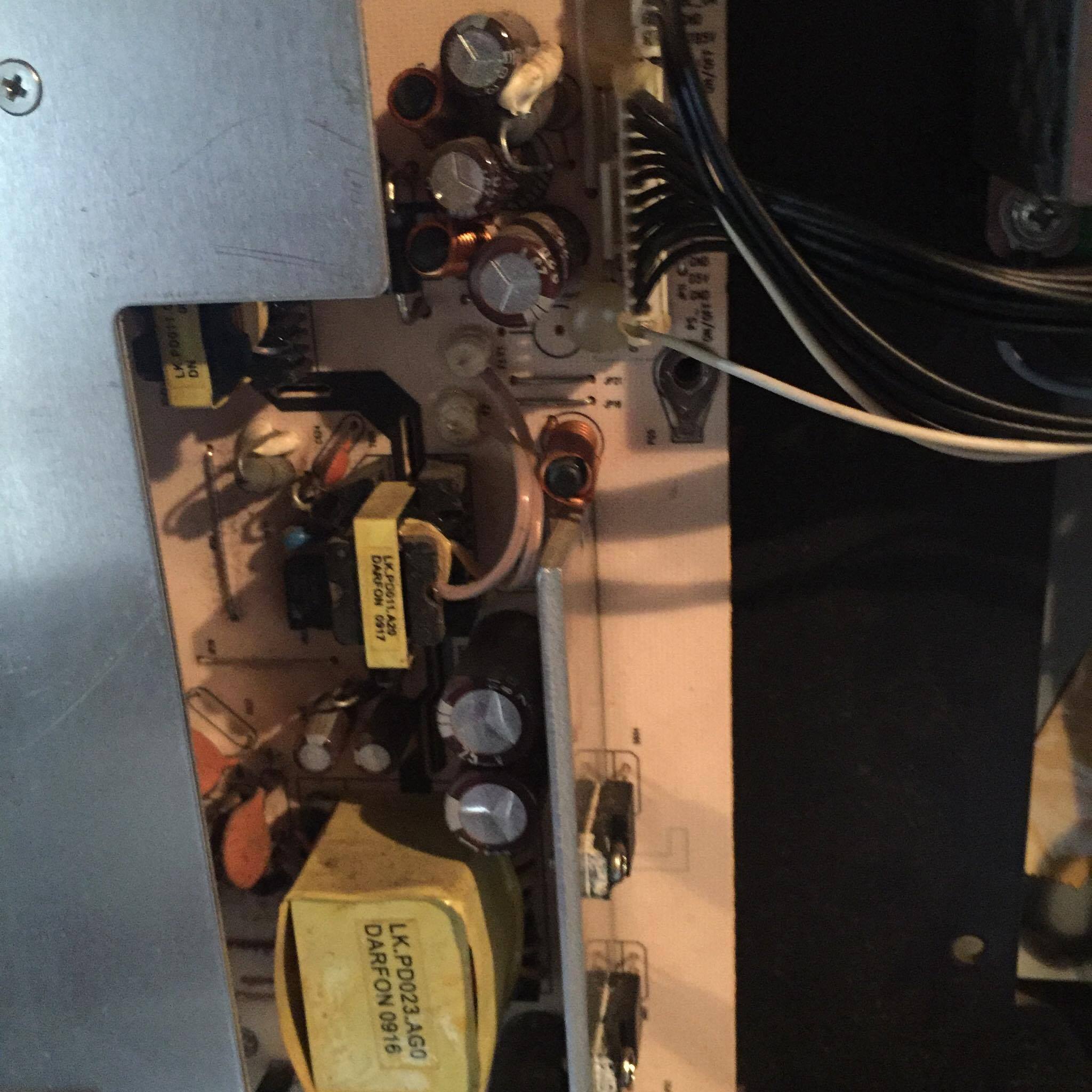

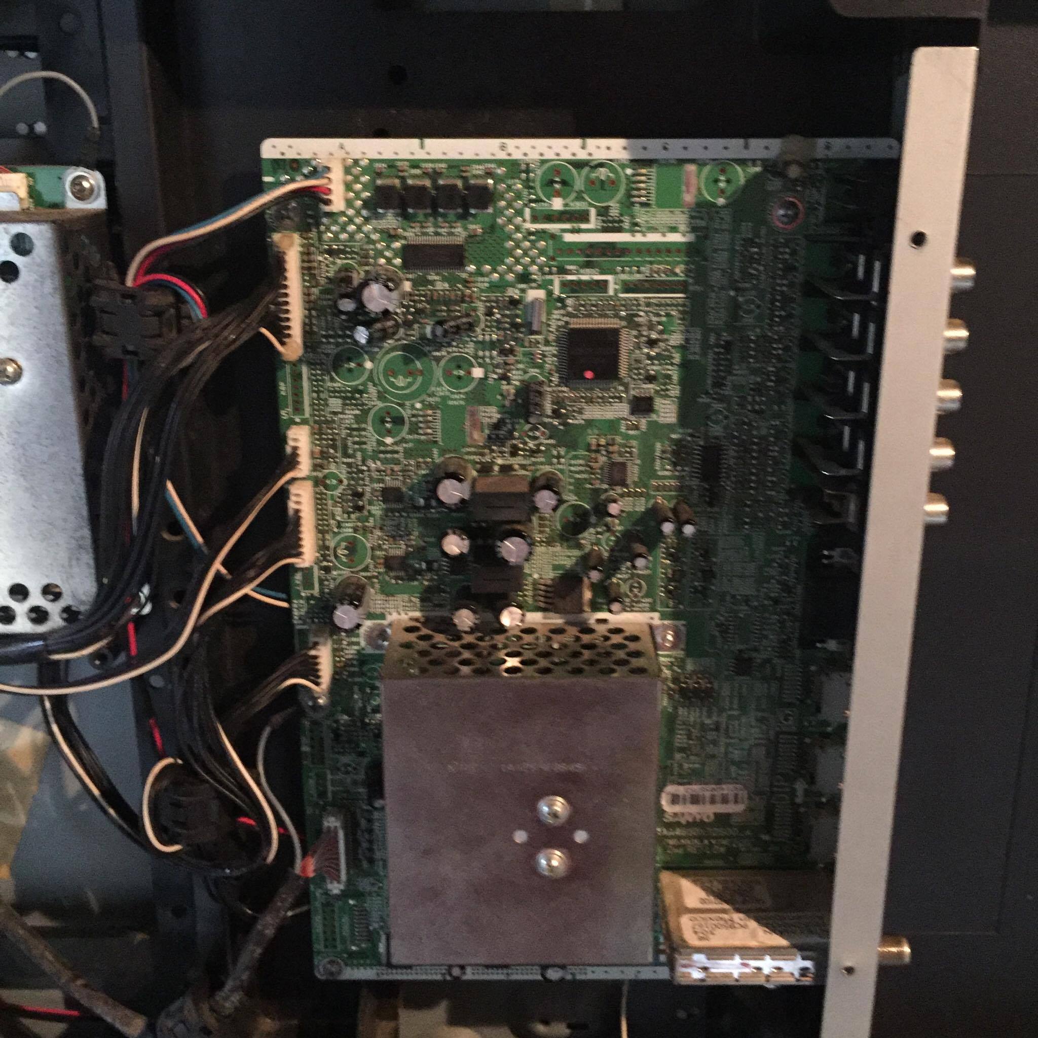

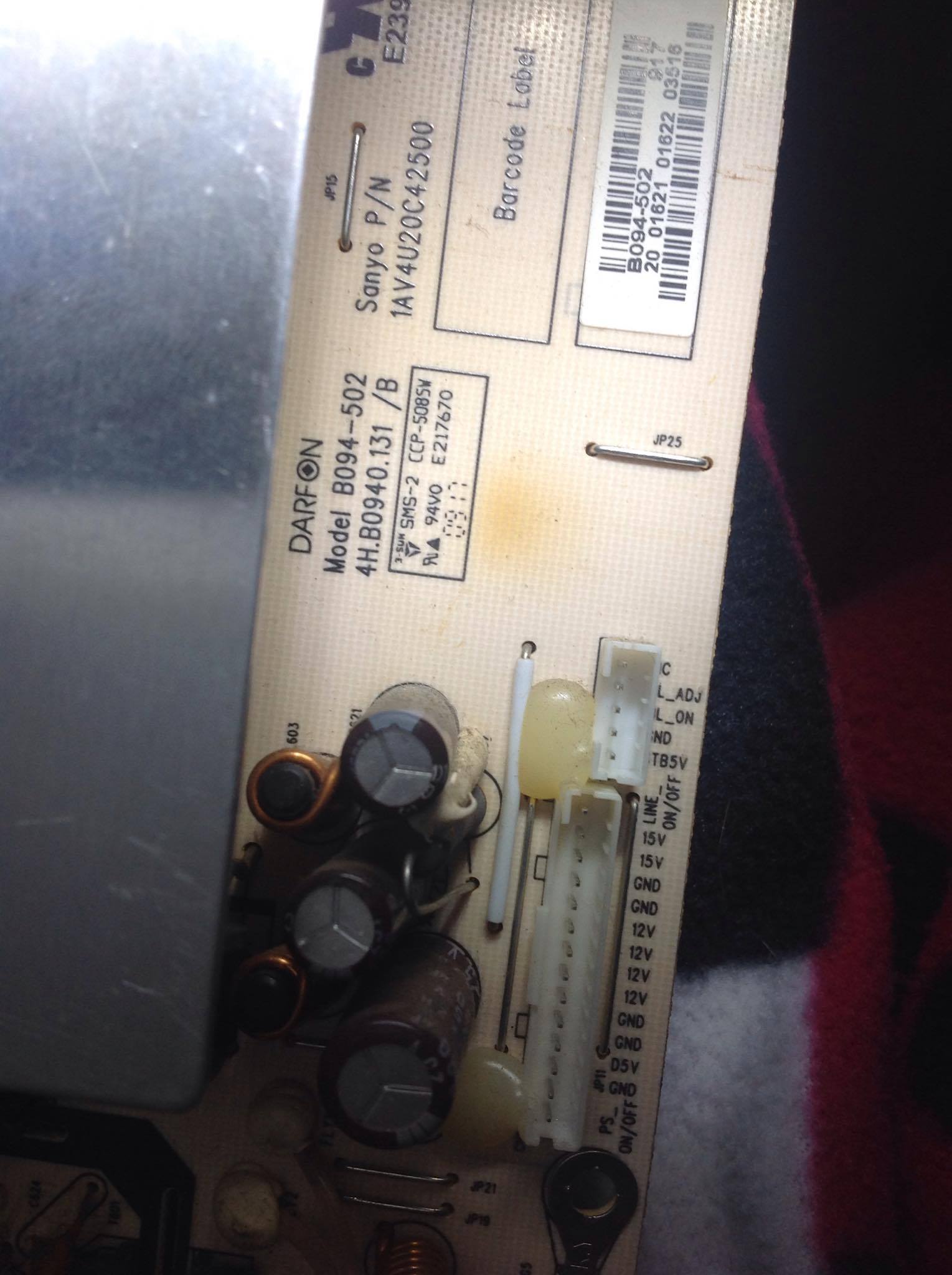

              Here is some pics
              Also the audio is choppy like with out the cable connected.

                What Voltage scale are you using? It looks like you are using too high of the Voltage scale that is why it is showing 004V, you should use 20V (19.99V resolution) scale.
                But the bottom line is that the main board is not sending the PS-ON ti turn on the rest of the power supplies.
                            Where is the PS_ON/OFF?
                            So now your STB5V=5.03 instead of 4V on the meter with high scale setting.
                            BL_ADJ=2.93: The main board is sending the Backlight level command as it should
                            BL_ON=3.29: The main board is sending the Backlights on command as it should, that is why your backlights are on.
                            12v= 0.33 off 12.19 on: The switched 12V is working and it is being turned on the main board which means the PS-ON command from the main board is preset but you did not list he Voltage from that pin.
                            Where is the 15V pins reading per your post 7?
                            Where is D5V per post 7?
                            So as far as we know now is that the backlights (lights source) are working but you are no seeing the images on the screen.
                            No image can be due to main board or T-CON board.
                                New readings after probing a little harder.
                                Line on/off = 4.97
                                15v = 15.74
                                15v = 15.74
                                GND = 0.00
                                GND = 0.00
                                12v = 12.18 on 0.49 off
                                12v = 12.18 on 0.43 off
                                12v = 12.18 on 0.40 off
                                GND = 0.00
                                GND = 0.00
                                D5V = 5.01 on 5.01 off
                                GND = 0.00
                                PS on/off = 4.99 on 0.00 off
                                So what now? I did check the voltage of a big canister that had 400v on it and with power on it only went to 44v. That was on the power board. Can not find a exact main board no where.

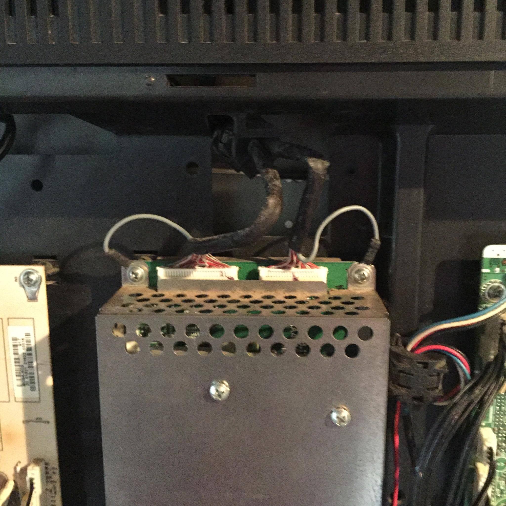

                                  That looks good, you do have backlights so that is also good. The next thing to check is to find out if the T-con board is getting the 12VDC on both end of the fuse with reference to GND or not.
                                  • joeshannallie
                                    • Dec 2013
                                    • 103
                                    • usa
                                    Could you possibly tell me how to do that?
                                      Your TV is going to be easy, see that metal box in the middle between the power supply board? The is the FRC (Frame Rate Conversion board) which get the signals from the main board then it has two output connectors that go down the plastic chassis of the TV to the T-con board on the LCD panel, so the problem can be the FRC board or T-CON board. It can be that the FRC board is not getting the power.
                                      http://www.shopjimmy.com/catalogsear...=Sanyo+DP52449
                                      The connectors on the FRC board has no labels for the pins. We will need to find the service manual for this TV to make it easier to test the Voltages.
