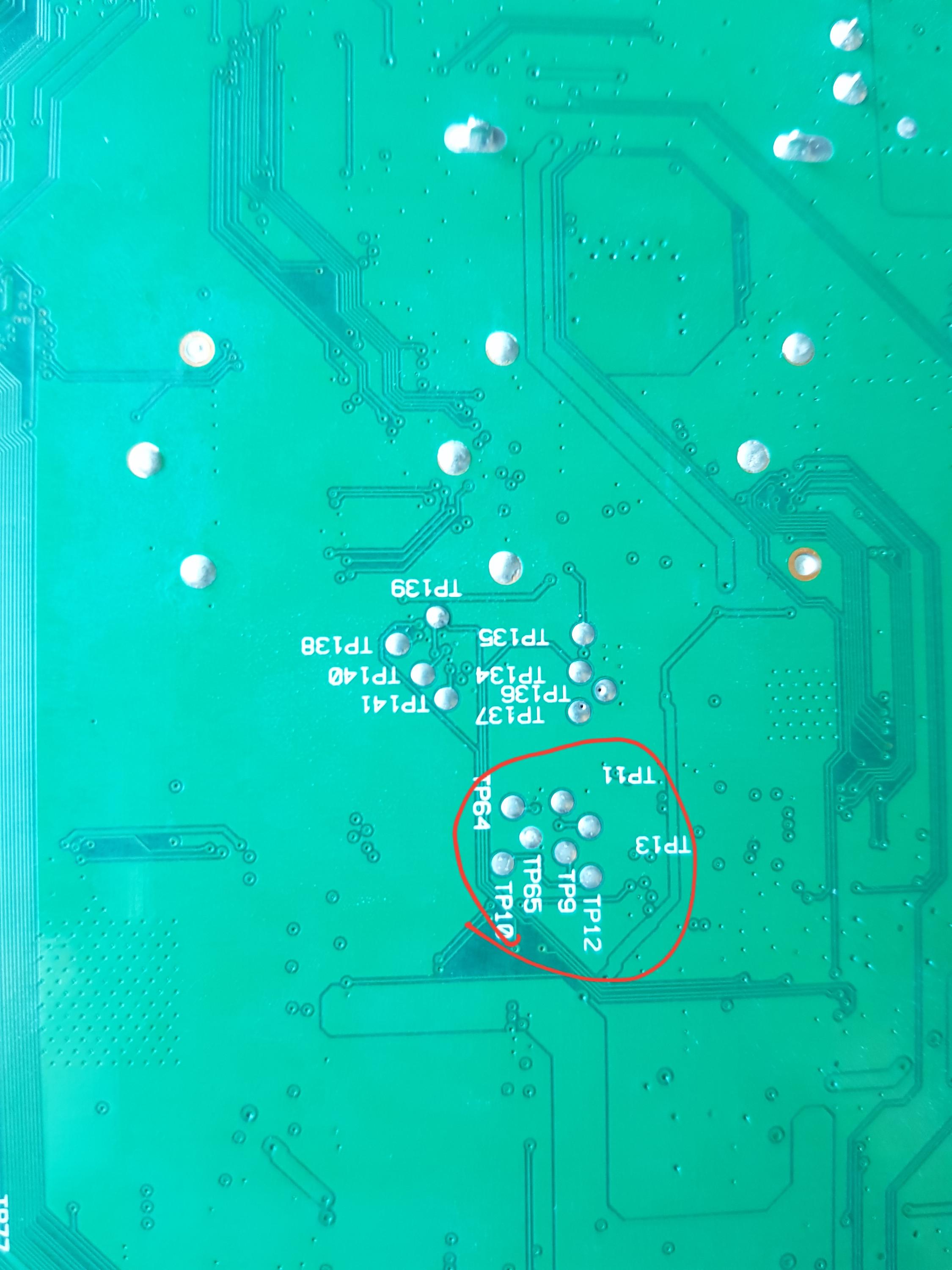

                                    Also one last question. Can you use these points here in the attatched image to program the chip without desoldering? These seem to be right behind the chip but I have to get my hands on a programmer to write to it anyway.
                                    Fixed the attatched picture. There's only 7 points but I assume the other is probably ground I'll have to check with a multimeter.
                                      Re: Vestel 17mb61-2 I screwed up my TV
                                      I have no idea. You would need to check the schematic as to what they refer to. Quite possibly you can.

                                        It's an I2C programmer for programming the likes of bios chips I need right? This is only for experimenting anyway now as I ordered a new board but I might get some money back by selling these on cheap if I get them booting or even just keep them as spare just in case.
                                        I'll look for the schematics anyhow.
