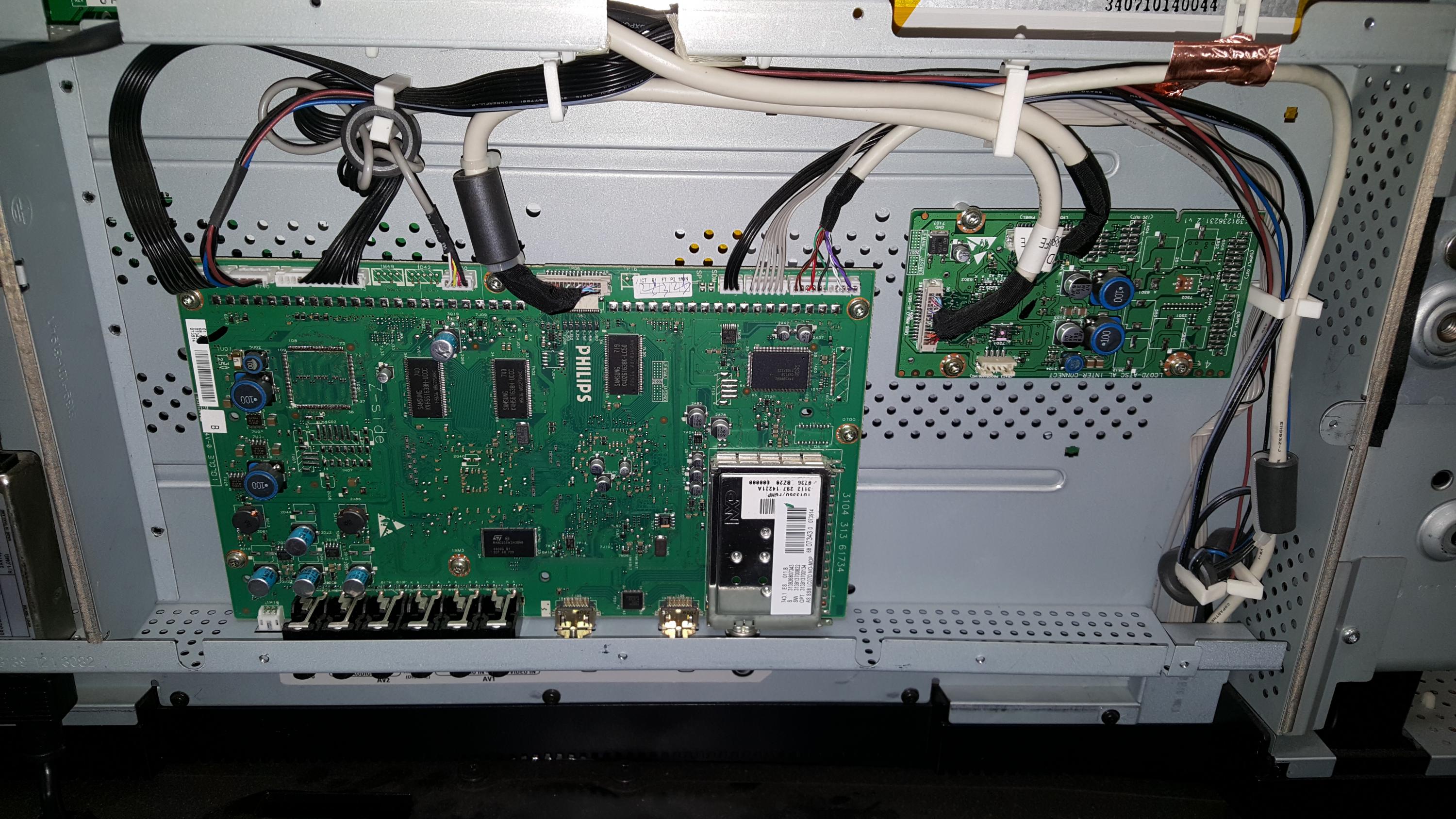

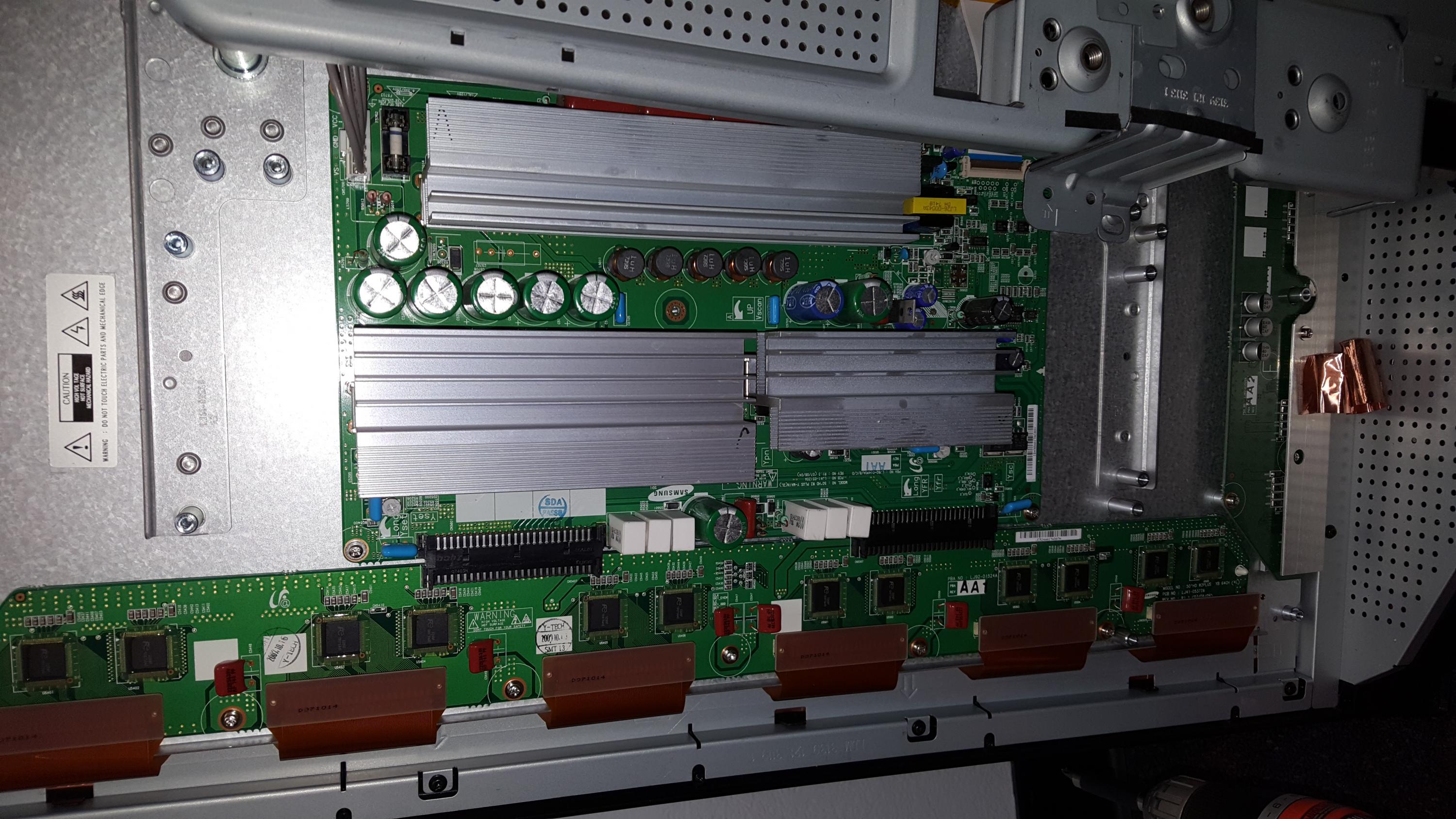

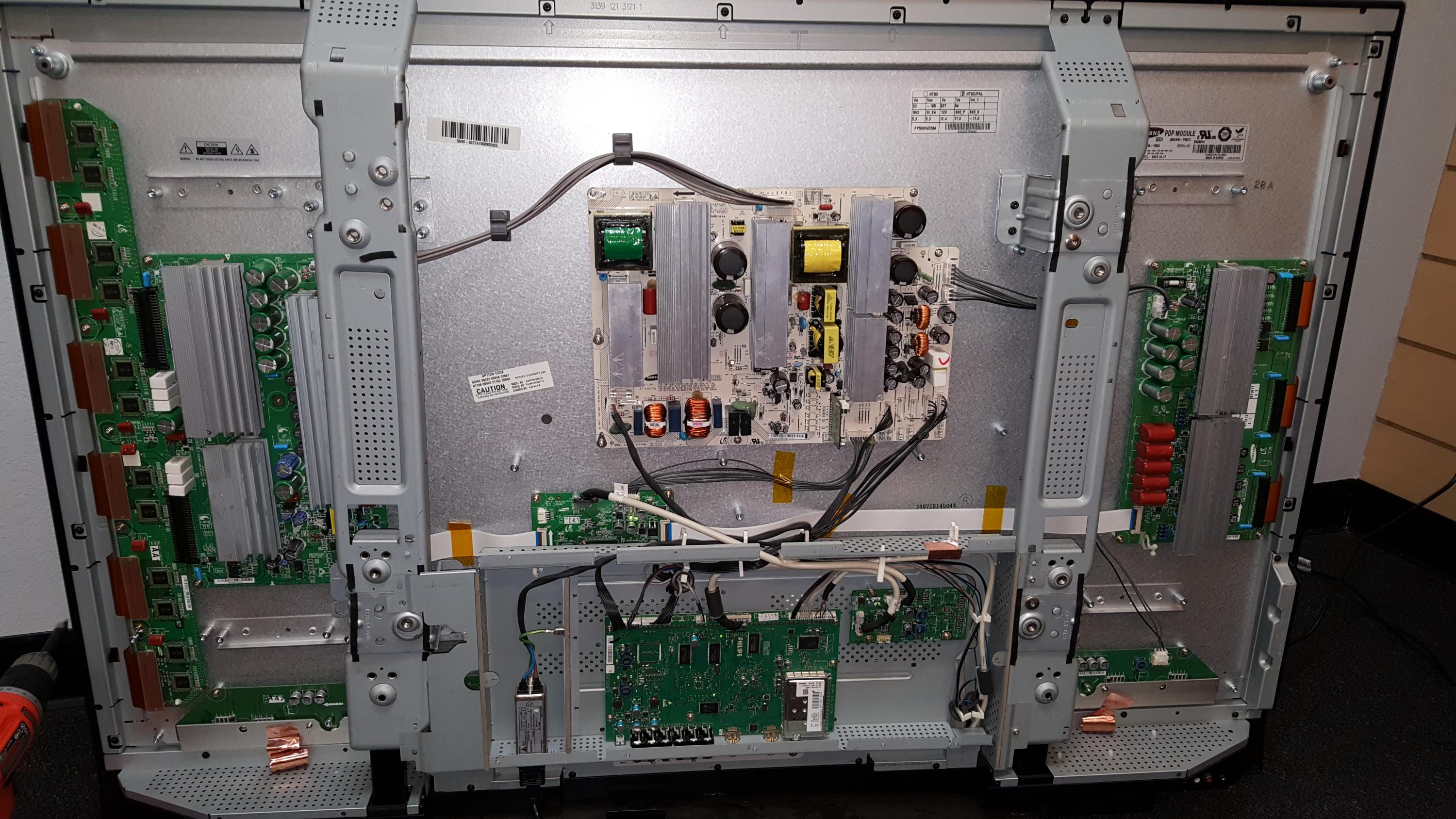

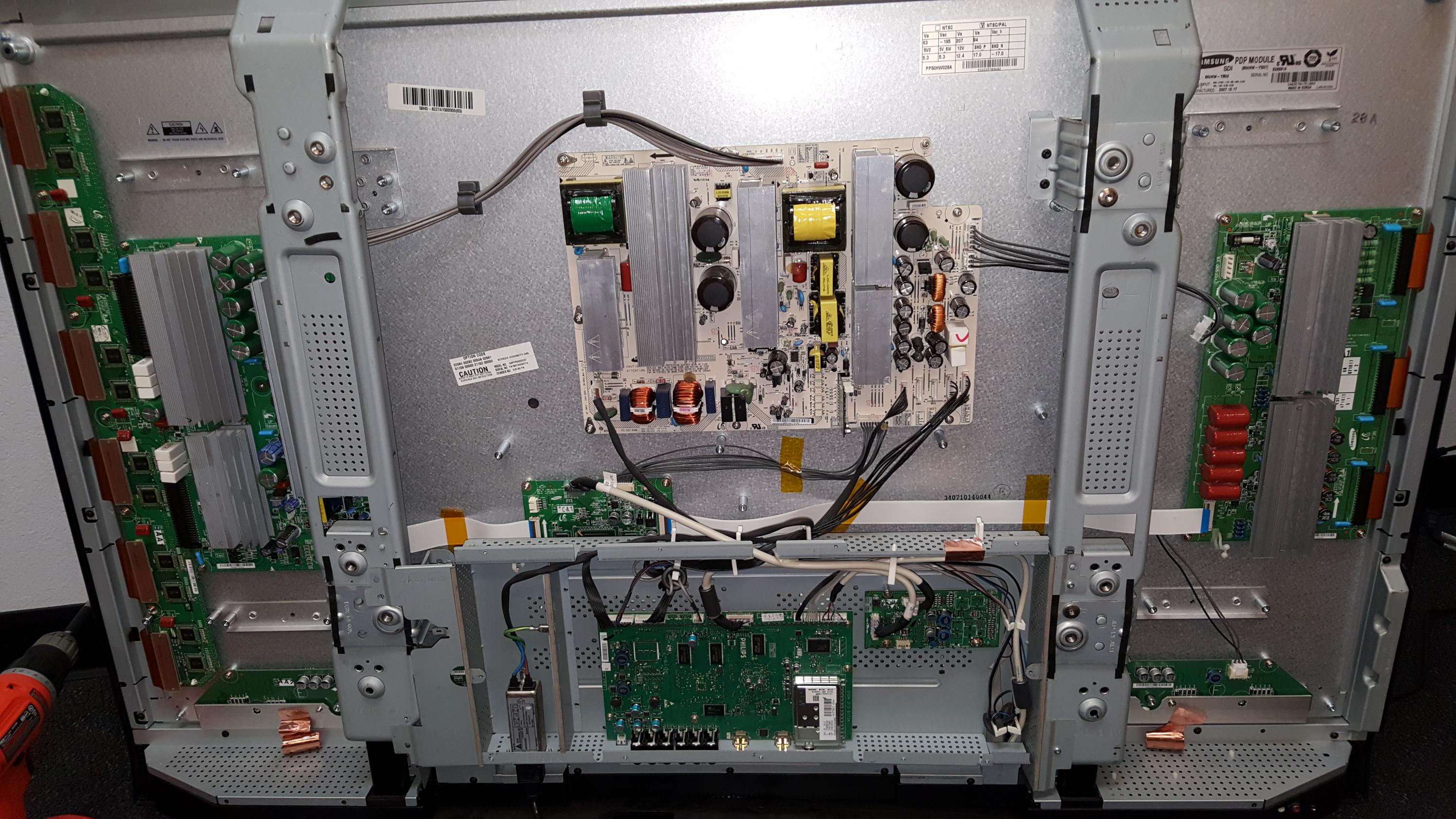

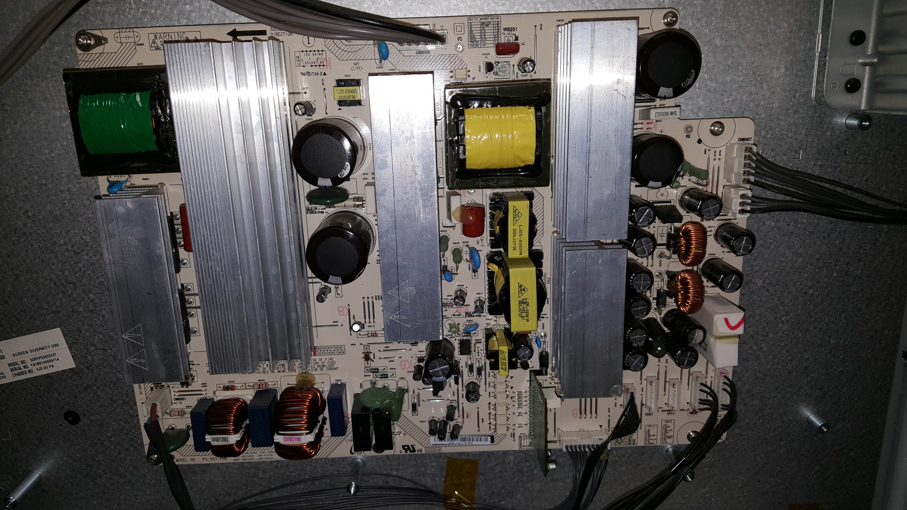

    Hi guys. Back again, this time with a Phillips plasma HDTV. Symptoms are no picture, but has sound. TV does power on with blue power light and I can hear the relays click and a slight buzzing sound from the Y-Buffer/Main area. LED on Y-Main stays solid while LED marked LED2002 on Main Logic Control board blinks endlessly in no specific pattern.
    I have already searched the forum for other cases and have found multiple cases of the same scenario, but sadly, most of those threads never were updated or the repair was abandoned before a solid repair was found.

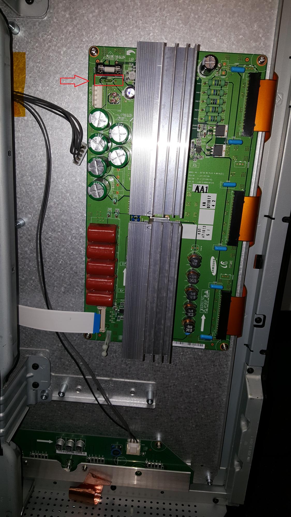

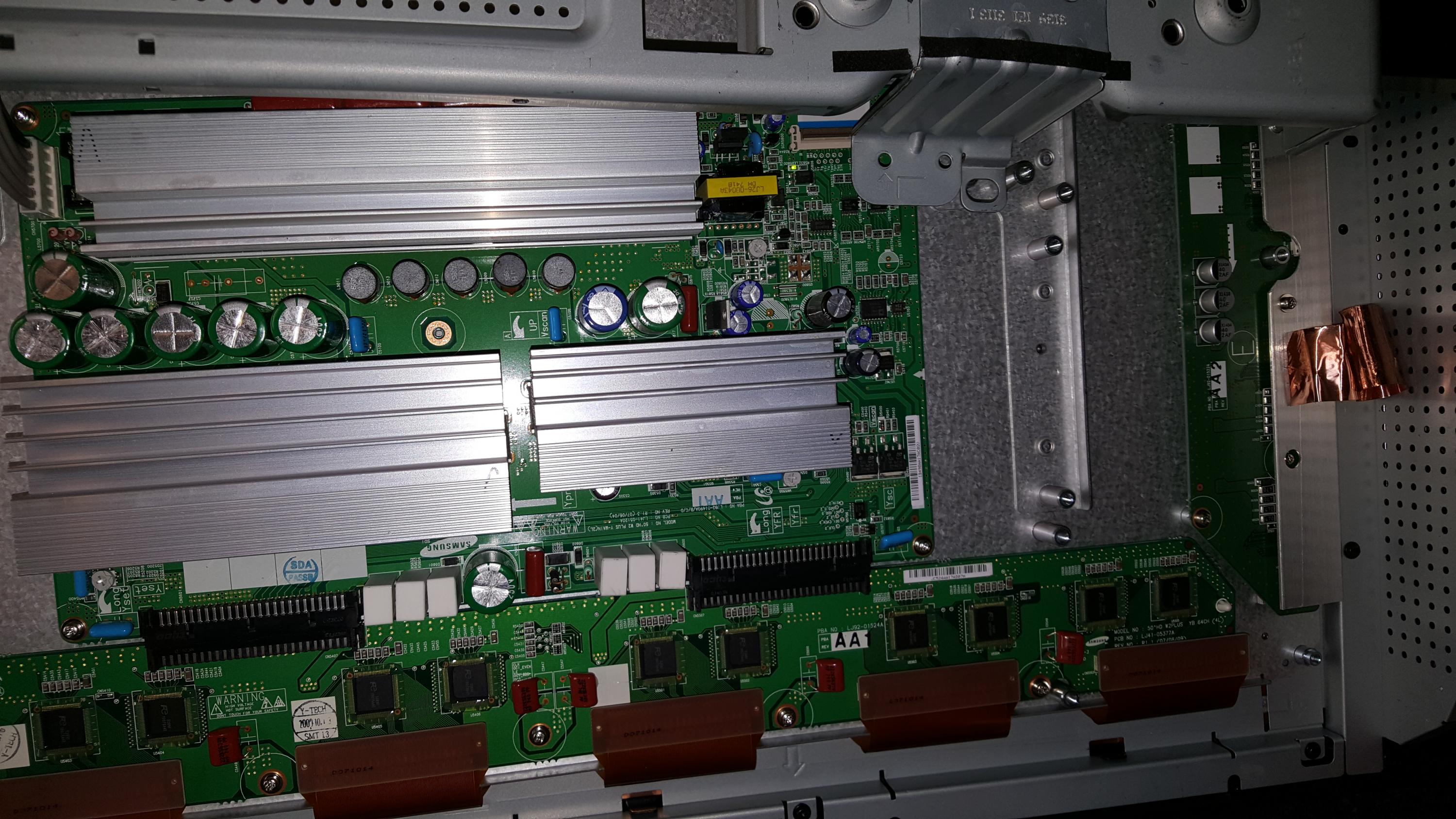

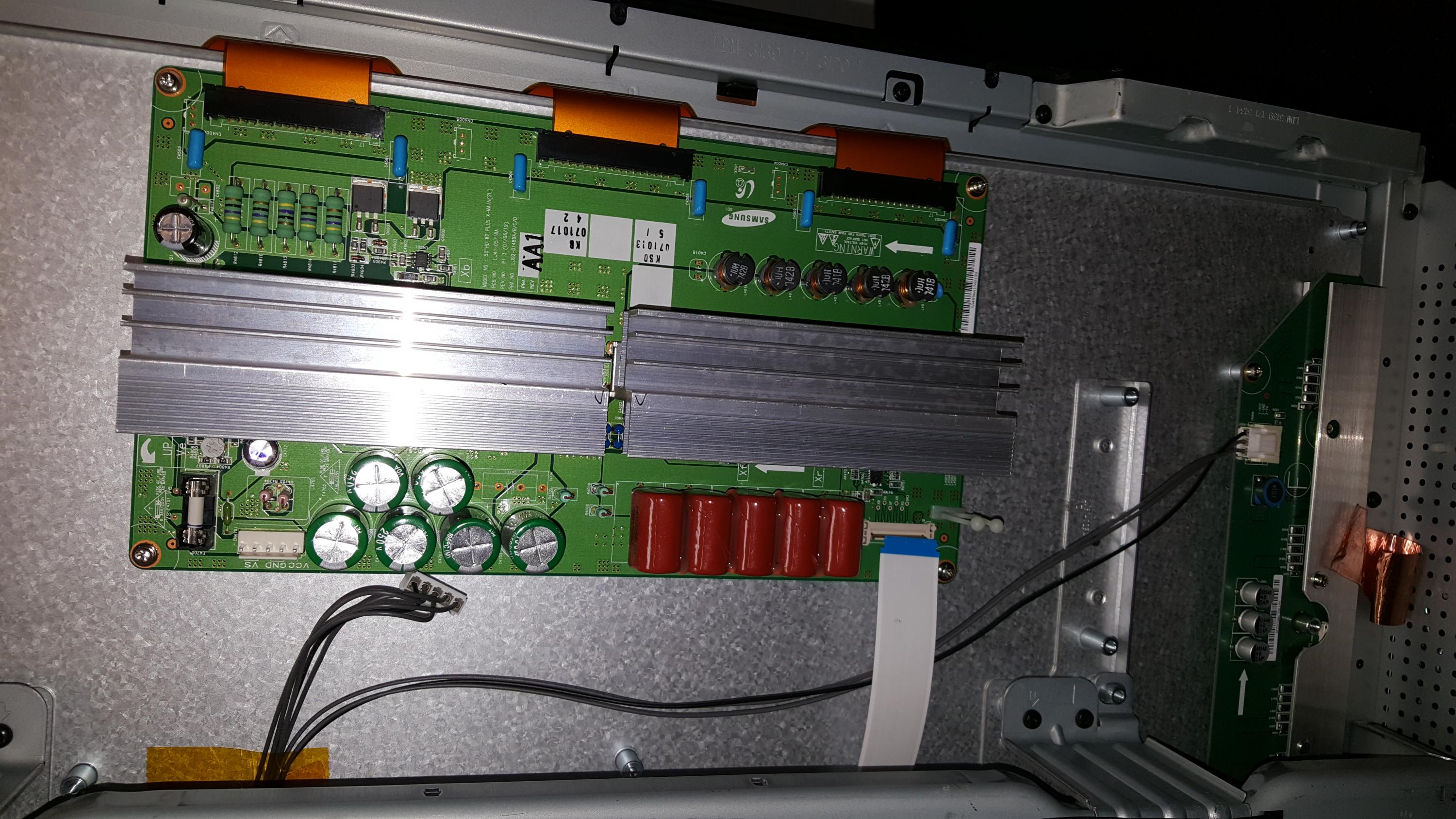

    I found 2 bad caps on the Y-Main and one on the X boards, totalling 3. After replacement, the TV showed no improvement. Same symptoms.
    I have also tried unplugging Y/X individually to see if the TV responds any differently and it doesn't. Same symptoms.
    I took readings from all of the power connectors on the main power board and all of the voltages are within range according to what is printed on the board, so that seems to be ok. I also tested all of the fuses, and they checked good.
    Any suggestions on where I should go from here? Attached are some pics and I can get more if need be. Thanks a lot guys,

              Alright, so after reading through this service manual, I have replaced the Y-Main board. The new board no longer shows the Y-Main protection fault light. I was still not receiving a display, so I took a second look at the X-Main board and found a fuse that was bad. I replaced it with a working fuse. (see attached image for location)
              Now, the TV is actually trying to produce an image! I'm getting the snowy-static, but the image seems to be coming in and out. So it will go black and then back to snow/static, and then back in about 2 second intervals.
              What should I do now? I'm close!

                Can you post a picture of this snowy static? It sounds like an X-main problem if you are getting that.

                    Verify all the voltages on page 65 of that document. In particular Ve is very important as low Ve can cause a poor image.

                          Ok. I tested Ve and it reads 114V and the sticker on the back of the panel says it should be 94V. 10v higher than it should be. Also, the TV has stopped flickering like it was and is now without an image at all again.
                          • grimacelord
                            • Jan 2017
                            • 354
                            Re: Phillips 50PFP5332D/37 Plasma HDTV - No Picture, Has Sound
                            Also, I tested all of my other voltages AGAIN and they are all within range except for Ve and 5Vsw on the connector leading to the main board. That pin reads 6.93V instead of 5.3V.
                            I'm not sure what to do here, guys. Totally stumped. I don't want to start blindly replacing boards and my customer is growing rather impatient with me, but I can't seem to find a solution. Any (more) help would be appreciated before I'll be forced to abandon the project.
