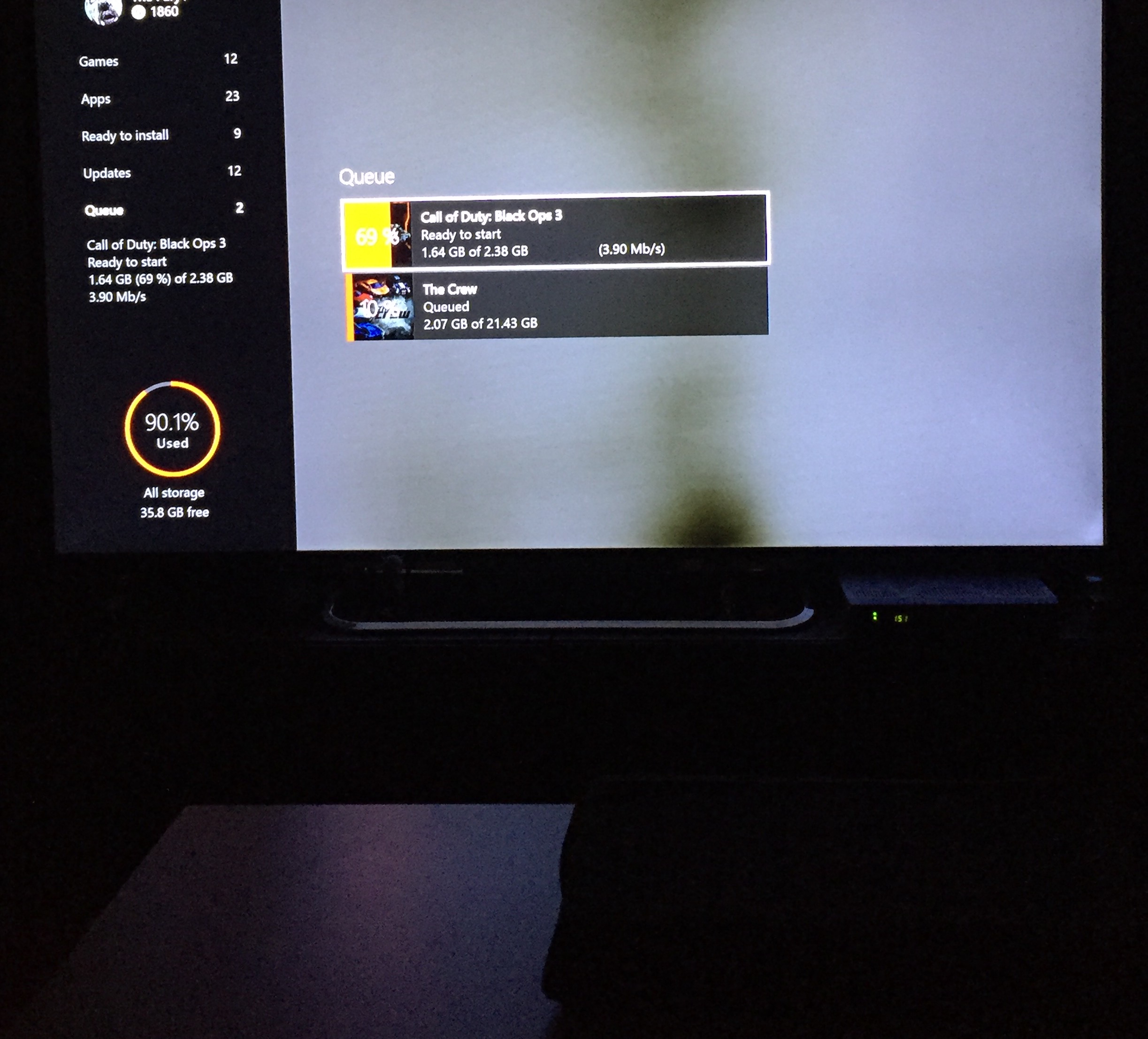

    Got this TV back in 2013, it started forming a dark shadow vertically in the middle of the screen (see the attached pic).
    Any ideas what this could be?

    It looks like bad backlight led, I suspect a couple are shorted keeping the rest of the led's in the string on

      Is that fixable? or is a panel replacement needed?

        It's fixable but it means disassembly of the panel to get to the LED strip. This can then be replaced or the individual LED replaced.

          Okay thanks, will take a look. anything else I should be looking for?
