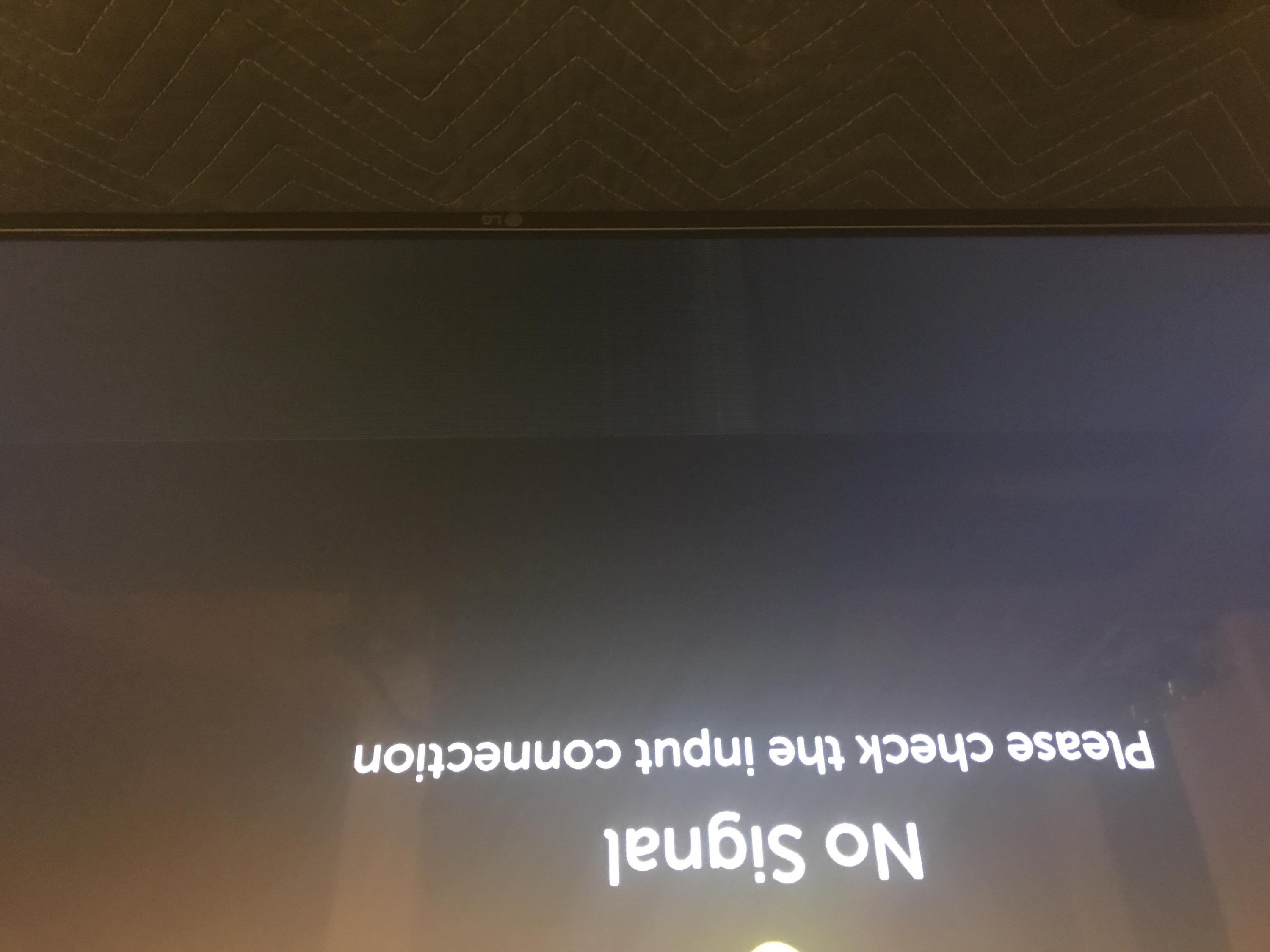

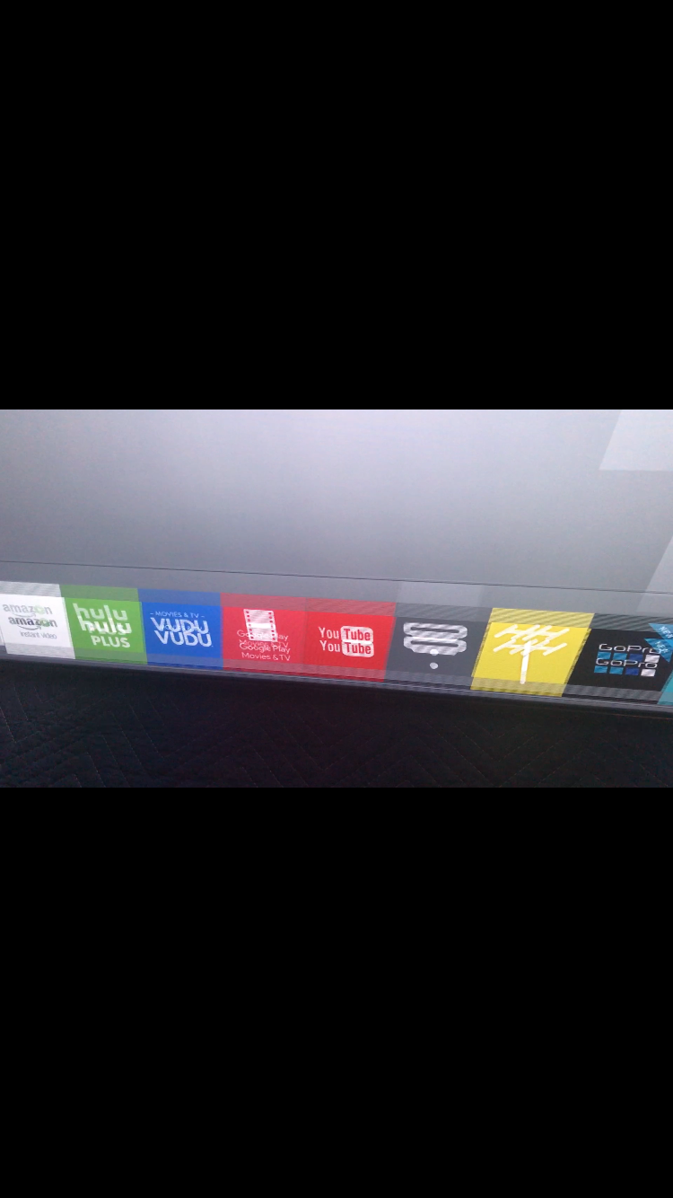

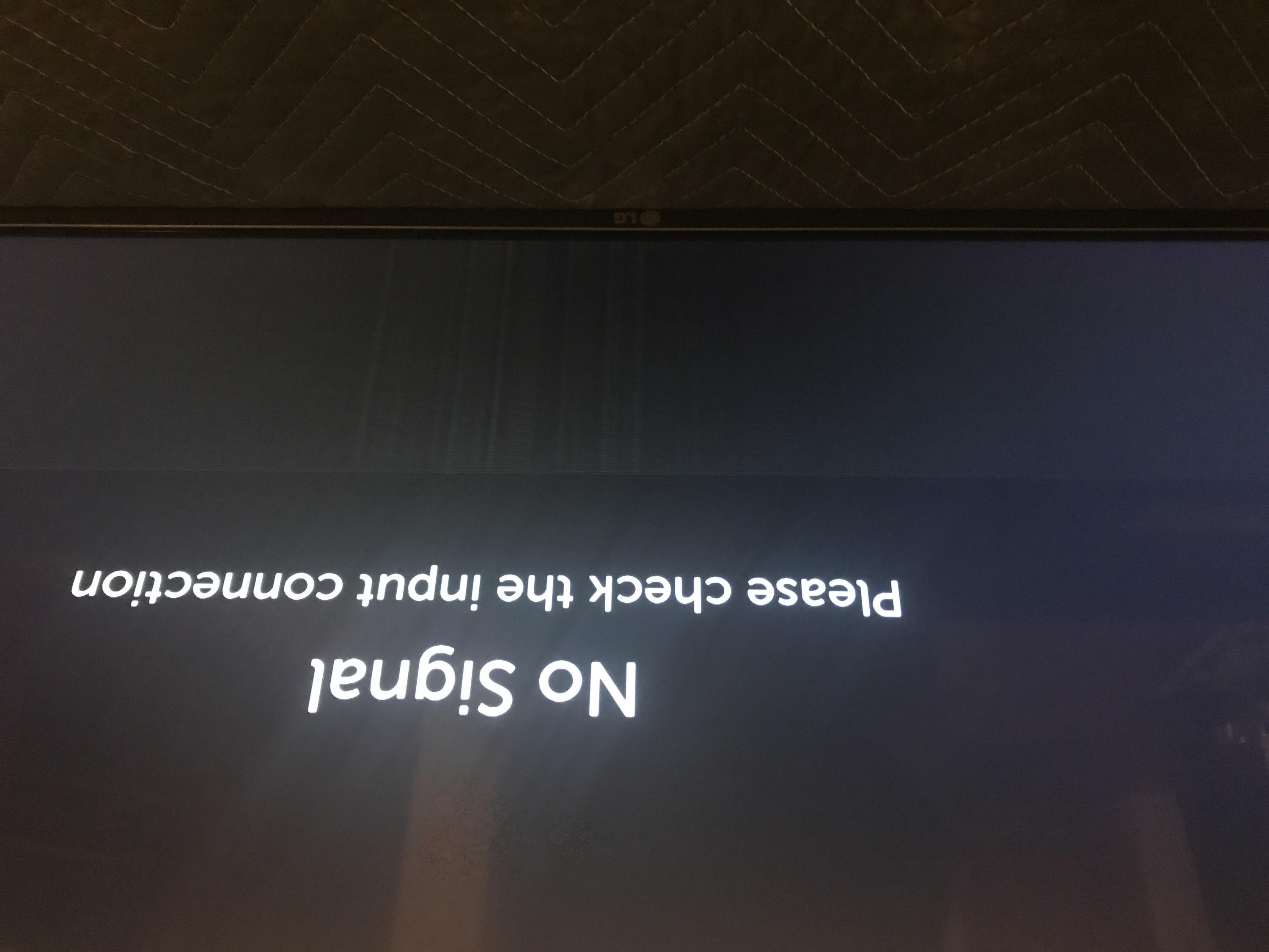

    LG 49UF6430 flickering Horizontal Line at bottom of screen
    Tv isn't even 2 years old. Started having this issue yesterday. A flickering horizontal bar has appeared at the bottom of the screen producing a double or ghosted image. Does this no matter what input channel I am on. Have removed the rear cover and disconnected and reconnected all cables. Didn't notice any change when I did this. Cheapest place to start I guess is T-Con board replacement. I also ordered a LG service remote for testing. A Greatly appreciate any ideas or suggestions.
  • dskall
    • Oct 2016
    • 2905
    • usa
    Re: LG 49UF6430 flickering Horizontal Line at bottom of screen
    I think you have bad panel
      I would agree, unfortunately this is not a repairable fault. It will need a new screen. Which is to say, buy a new TV, I guess. Sorry.
