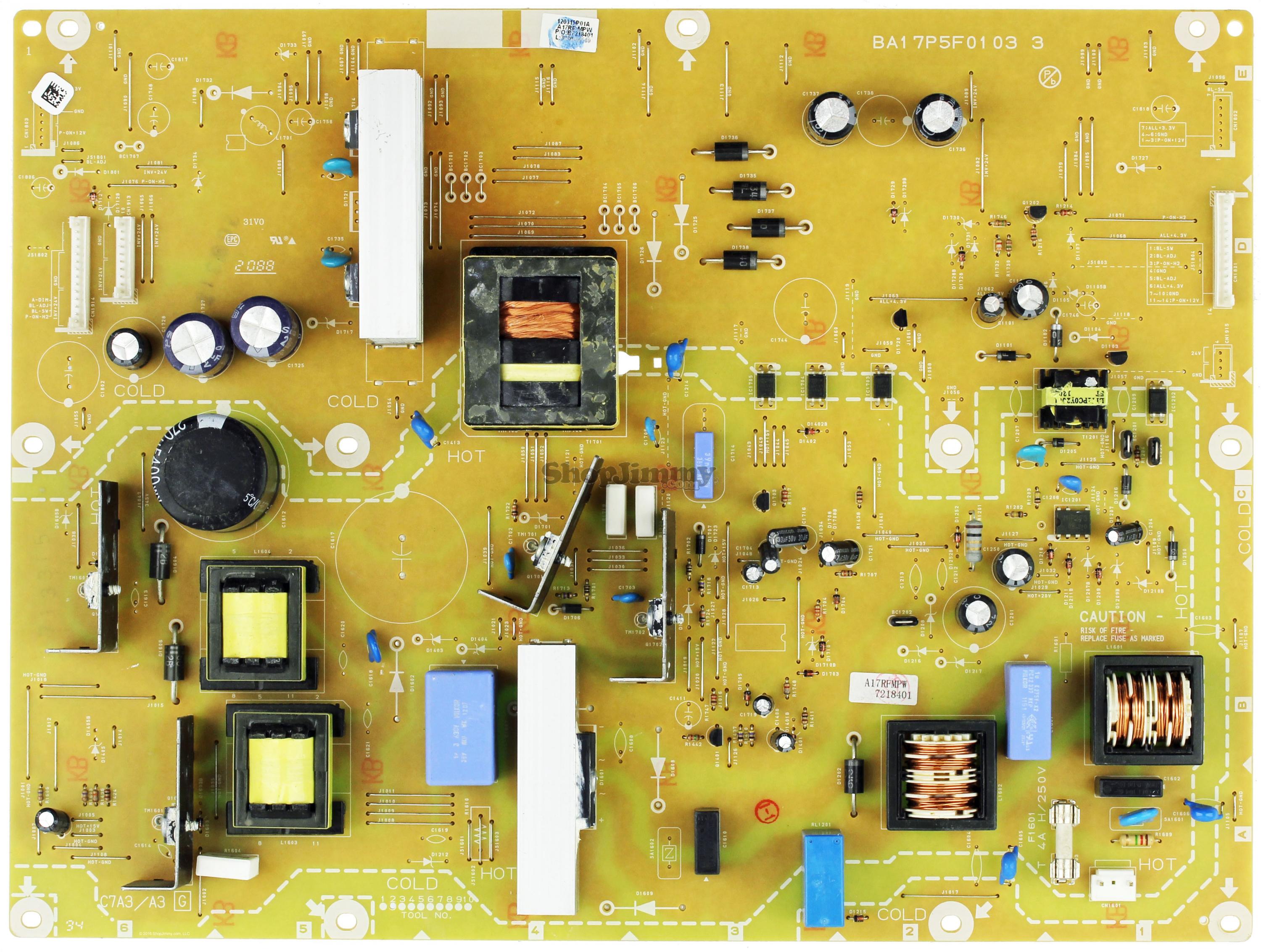

    When plugged in to the mains I hear the relay click and that is all, no standby LED, no response from power button or remote.
    Can't find a power supply for this one anywhere as everywhere it's sold out even eBay does't have one, so I have to try and repair this one if it indeed the power supply.
    I have attached a picture of the power supply
    anyone know what I should check?
    no caps are bulged
    The only voltage i could get is 4.3 Volts on the pin that says ALL which is pin 6
    everything else is dead on the connectors
    Any Ideas?

          disconect the power supply CN801, then connect about a 1K resistor between ALL +4.3V and P-ON-H2, (on the power board) see if you get your +12 & inverter +24 (backlight might even light)
          I see shopjimmy lists a repair kit for this board with about 35 parts

            Try turning on the PSU on its own like the last guy suggested: connect the only voltage source, that "ALL" pin to ON H2 pin 3 and see if the other rails come on. If not, I suggest checking the diodes - those large DO-201 diodes (D1735 thru D1738) after the switching transformer are usually the prime suspects when a PSU appears dead but the fuse is fine.

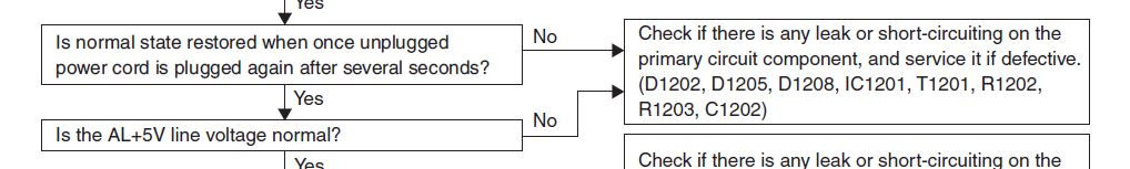

                        thanks I already have found it. according to the troubleshooting flow chart its saying the ps is at fault for a dead condition.

                          Pin 6 of connector CN3101 as shown in the schematic attached above should be at 5V (AL+5V) so 4.3V is low and I would look to see why.

                            Yes, testing diodes in circuit is possible (I do it all the time): since diodes fail shorted, the meter should beep when in continuity mode if the diode is faulty. If it doesn't beep, the diode is most likely fine.
                            I like to use a small value resistor between the standby rail and the PS_ON pin when "tricking" PSUs into turning on like this, just to be on the safe side, although it COULD be done directly (I did it a lot before learning about the resistor and never had any damage).

                                      well guys I just tried this now as I have been away and the backlights do not come on, but the other rails do have voltage when I jump it, the backlights have 3. something etc the 12volt is showing a reading, but much lower than 12volts so I don't know what to think now any ideas? I do not see any 24volts from backlights not sure what pin that's supposed to be on because all the backlights are 3. something volts they measure at. how should I proceed?
                                      • sfernandes
                                        • Oct 2013
                                        • 229
                                        Re: Philips 55PFL3907/F7 Dead, No Standby LED, Nothing, Please Help
                                        Ok well I did more intelligent testing looking at the service manual and this is what I get with forcing the power supply on by jumping it. Keep in mind without forcing the power supply on all these rails are dead. Nothing is plugged into the PS during these measurements, its just the ps on it's own with everything disconnected from it. How should I proceed? Please help.
                                        CN1801
                                        - Pins 1 to 5 should be 12 Volts, but I'm only getting 1.734 Volts.
                                        CN1913
                                        - Pins 1 to 5 should be 24 Volts, but I'm only getting 5.126 Volts.
                                        CN1914
