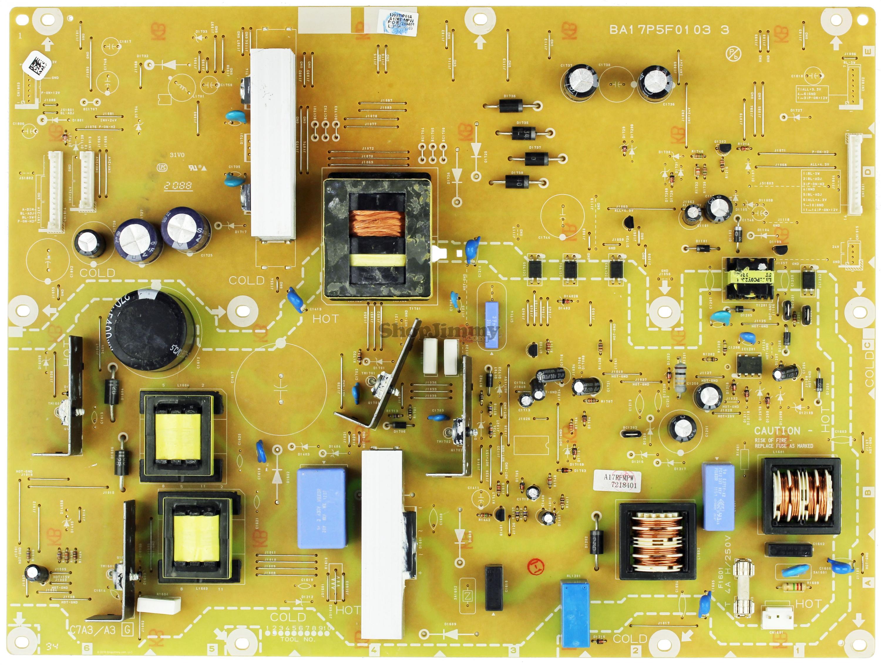

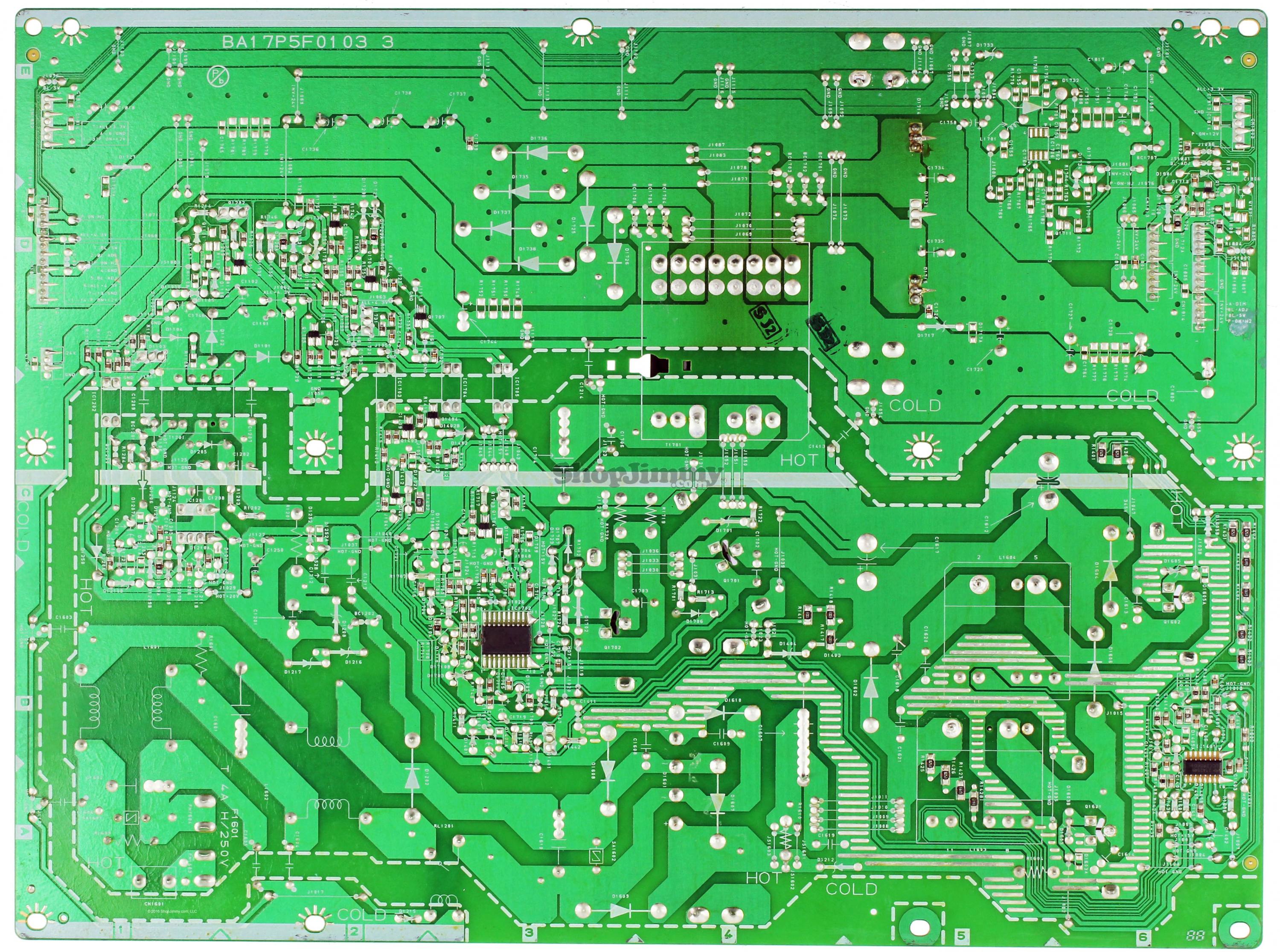

    Take a picture of the bottom of the board too. What do you get on the main filter cap ? Be very careful when measuring this - DANGEROUS !
    Wattevah...
    • sfernandes
      • Oct 2013
      • 229
      Re: Philips 55PFL3907/F7 Dead, No Standby LED, Nothing, Please Help
      that's the big huge cap correct? should I put the meter in AC or DC when measuring? and what should I know in terms of safety? do I measure it with power going to the board or not? what's the proper way to test it? do I put the negative probe on the negative side of the cap and positive to the positive side or do I put the black to the chassis ground of the TV and touch the red probe to the positive side of the cap? I attached a picture of the bottom of the PS board as well as a top shot again.
        Correct
        DC of course
        Well OK, I may have exaggerated a bit, it's just common sense at the end of the day. Very high voltages can be present on that cap. It's got a booster circuit as well from what I can tell, so it can reach 380v easily - not something you want to touch. You touch 12v or 24v on the secondary...ok, not so bad - may feel an uncomfortable tingle, but 380v will definitely hurt. I experienced it myself and it was NOT fun, especially since I somehow grabbed the board in such way that it went through my chest (one hand was touching +, the other hand was on ground or chassis somewhere).
        You'll have to measure it live, while plugged in that is, hence the warning I gave above. *Crash course on power supplies*: a SMPS (switch-mode power supply) is divided into two halves: a HOT (or primary) side and a COLD (or isolated/secondary side). These will be clearly marked out and labeled on all but the cheapest, dirtiest boards (Notice how there's a dotted line separating the two halves). As the name "isolated" suggests, the secondary side is isolated from the mains, thus each side has its own ground point, so there will be a HOT ground and a COLD ground. The chassis will never be connected to HOT ground due to obvious safety reasons - it will be connected to COLD ground. Your main reservoir capacitor is on the HOT side, therefore you'll want to measure it with respect to HOT ground, which is the - of the bridge rectifier, the - of the cap itself and the - of any other components located on the HOT side. Give it a shot: place your red probe on the cap's + leg and the negative probe on its negative leg or on the - leg of the bridge rectifier (all on the HOT side). You'll have to do this on the bottom of the board so make sure your hands or probes don't slip - you may end up with a blown fuse and a jump-scare
