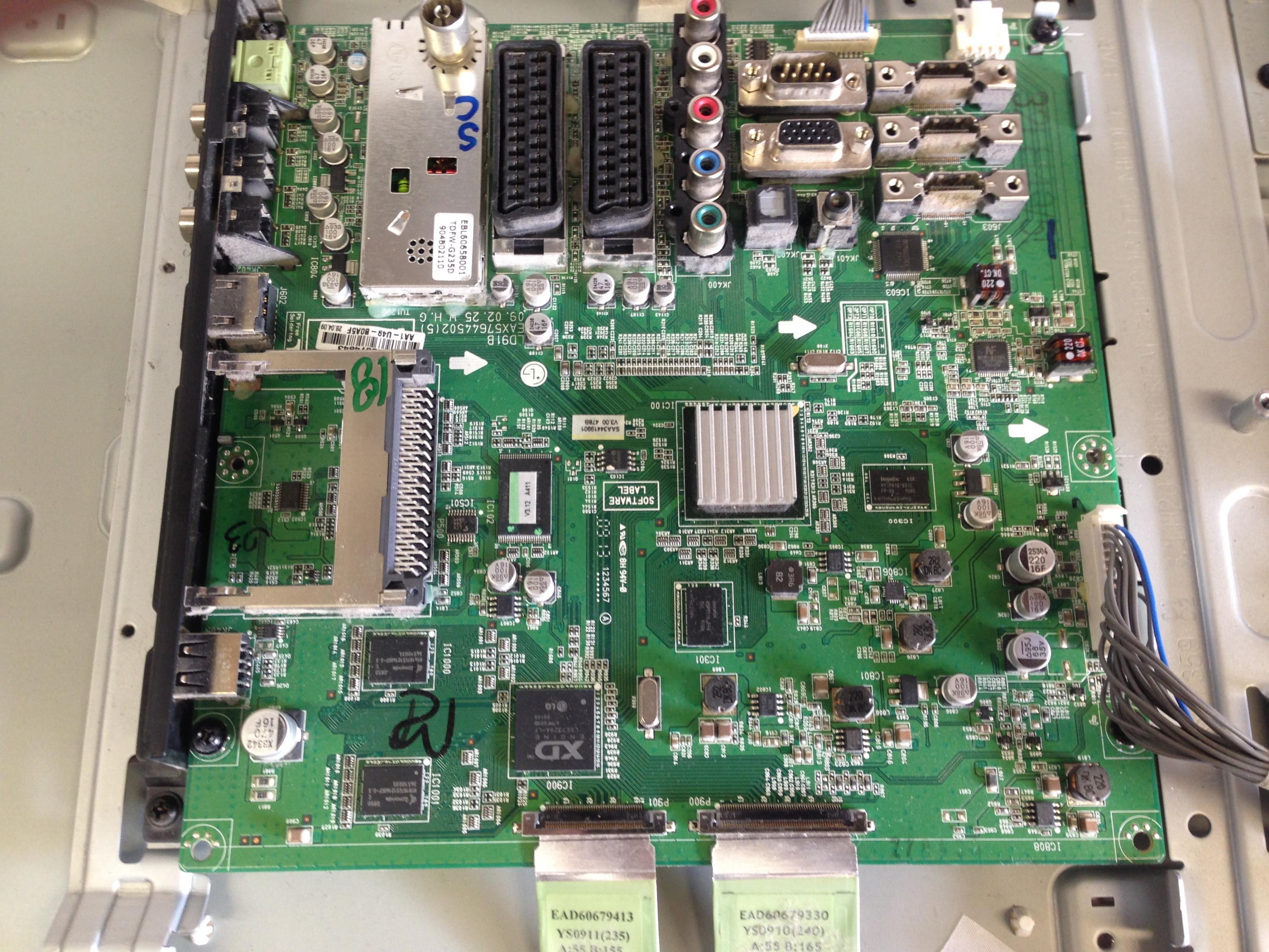

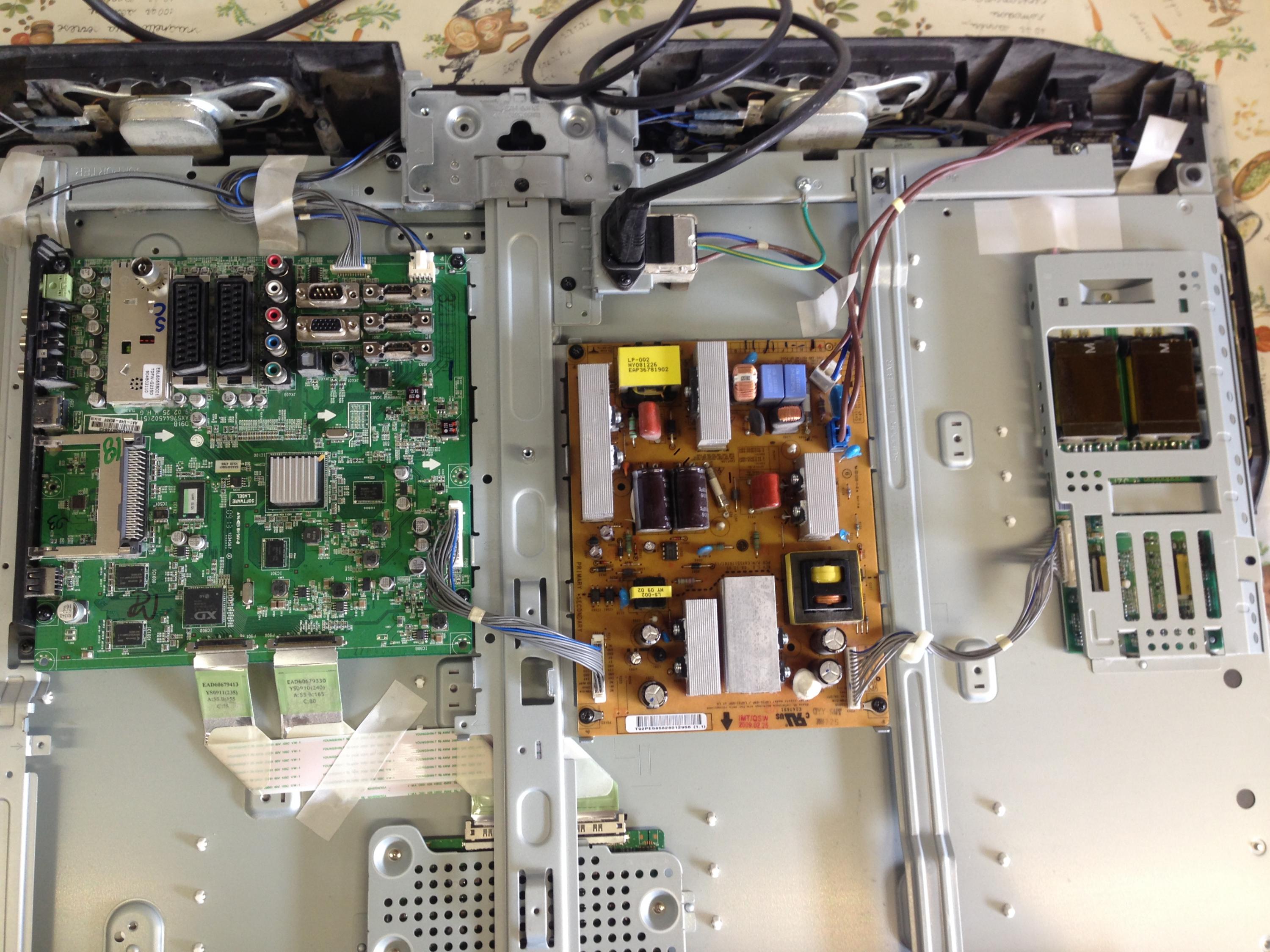

    Lg 32LH500 not powering on.
    The LED on the front turns on.
    I'm getting the 5VDC from the PSU but nothing else.
    The ON push button relays the signal to the main board but nothing else happens. None of the other supplies or signals become active.
    Any ideas please?
    Thanks!

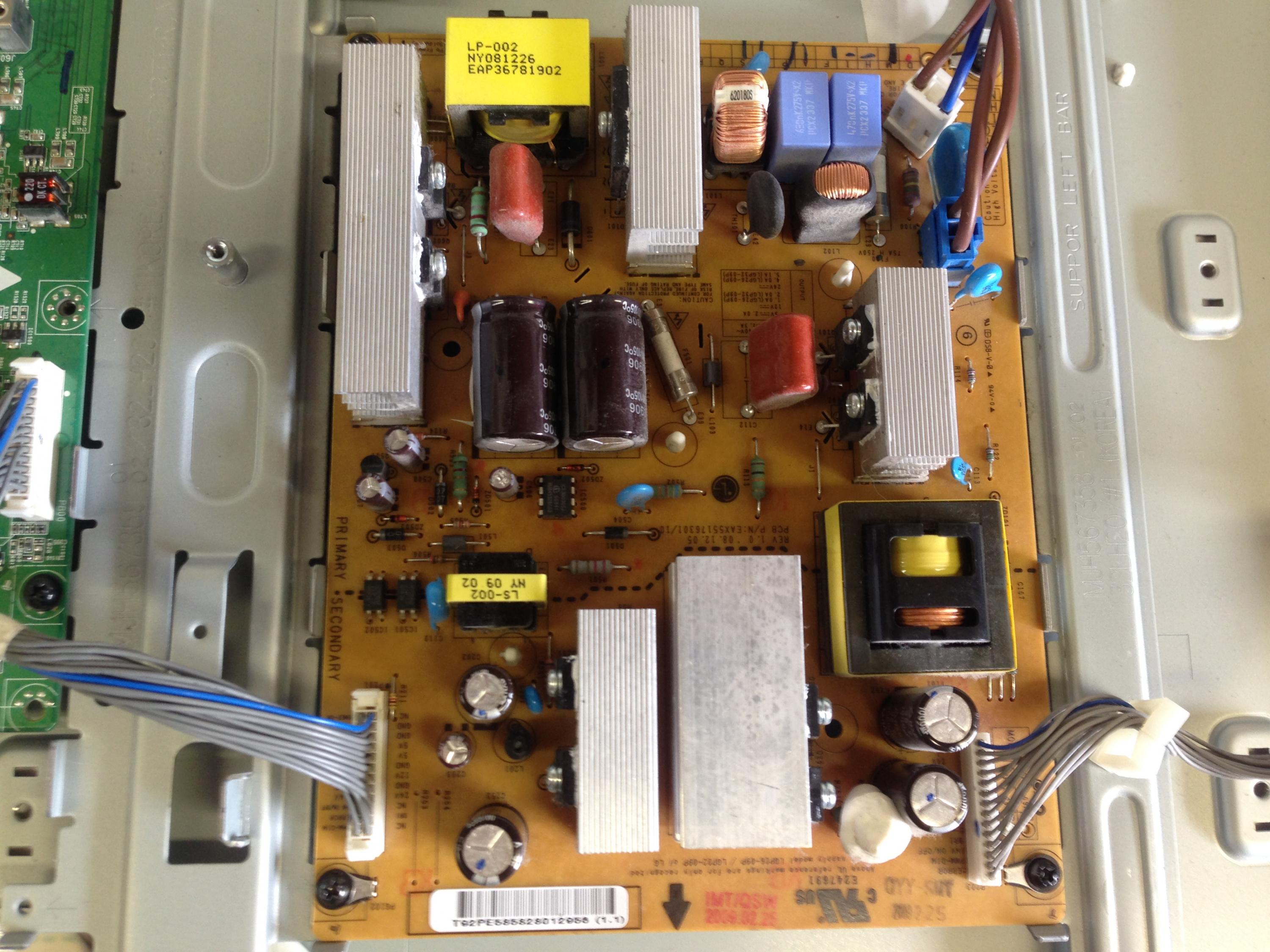

      Re: Lg 32LH500 not powering on.
      Separate the main board and use a 1K resistor to jumper between Power_ON and 5V stby on the power supply connections then check you have all the secondary dc supplies i.e. 12V & 24V.
      You can also jumper 5V stby to INVOn/Off using a second 1K resistor and check your backlights come on.
            Done that. DC supplies come active and the backlights turn on.
            So I assume my main board is gone.
            Can this be baked?
            I've been reading a bit about that lately.
            Thanks.....
