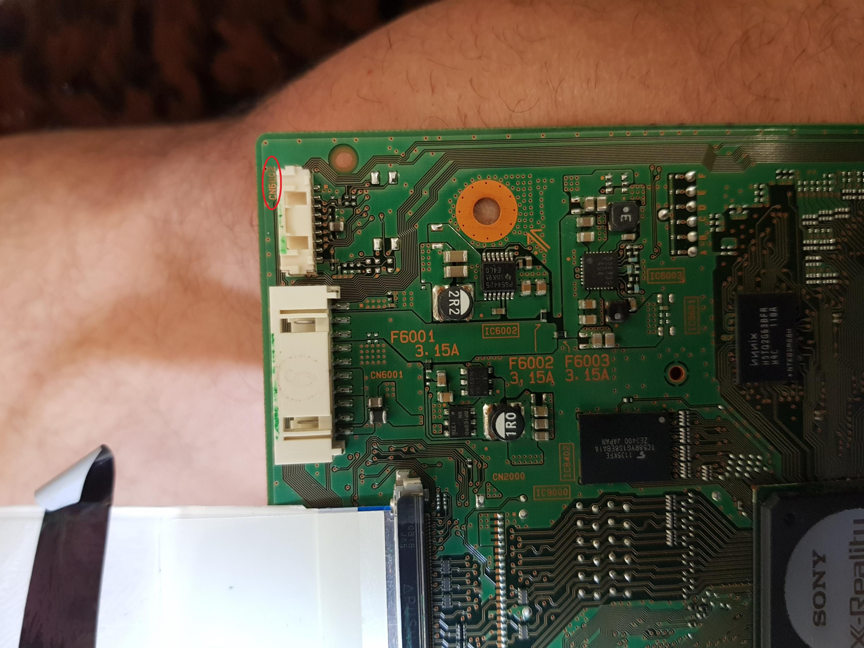

    Can anyone please help me identify where is the pin7 of CN6002 to test and how?
    pin 7 and grnd?
    I saw the label CN6002 but not sure which pin should I be testing. Thanks!

    "Please update your account to enable 3rd part hosting" is what your picture shows?

      PLease see attached image

        Go to page 16 of the manual. Use your meter to check which end of the connector is ground and then you know it's pin 1.
          Re: KDL55EX720 Batv - CN6002 4 blink code
          https://www.badcaps.net/forum/attach...8&d=1502700182
          The top pin is PIN 1 which is GND as you can see, it is connected to the ground plane.
