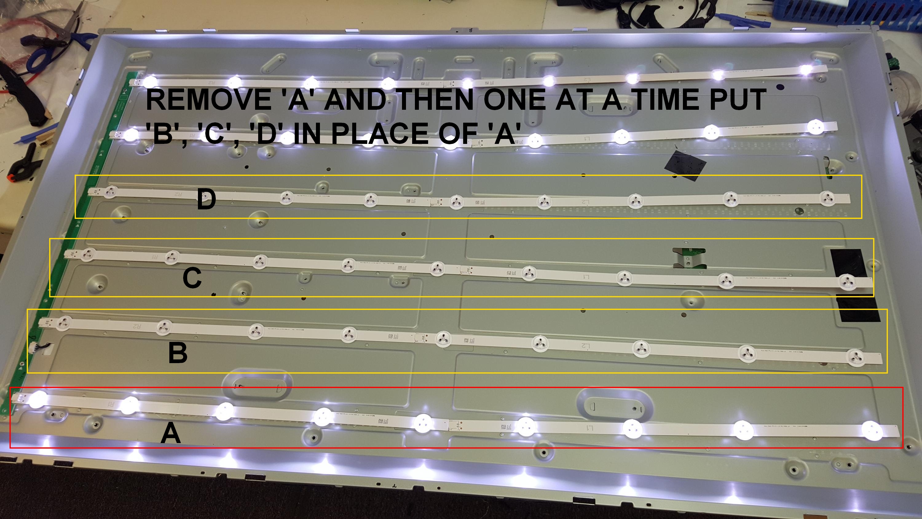

    I have a feeling one or more LED strip has open circuit...
    Thanks for getting me this far, budm! What should I do next now that we've come to this point?
      Re: Vizio E470i-AO - Backlight LED Problem
      So one or more of those three strip (each strip has two sub LED strip) may have open circuit at the connectors or open LED, so it is a matter of finding out which one.
        Alright. So I'm still checking for continuity and basically go through those strips and sub strips at each connector and LEDs themselves until I find an open circuit?
          What you can do is to remove one of the three working strip (one strip contains two sub strips) and replaced it with one of three dead strip at a time to find out which one of the 3 strip is bad. One caution, those SMD connectors are very fragile so the solder connection gets broken easily and you have already removed and installed the strips many time so be real gentle with them, I usually re-solder them all for precaution.
          This where LED tester come in handy.

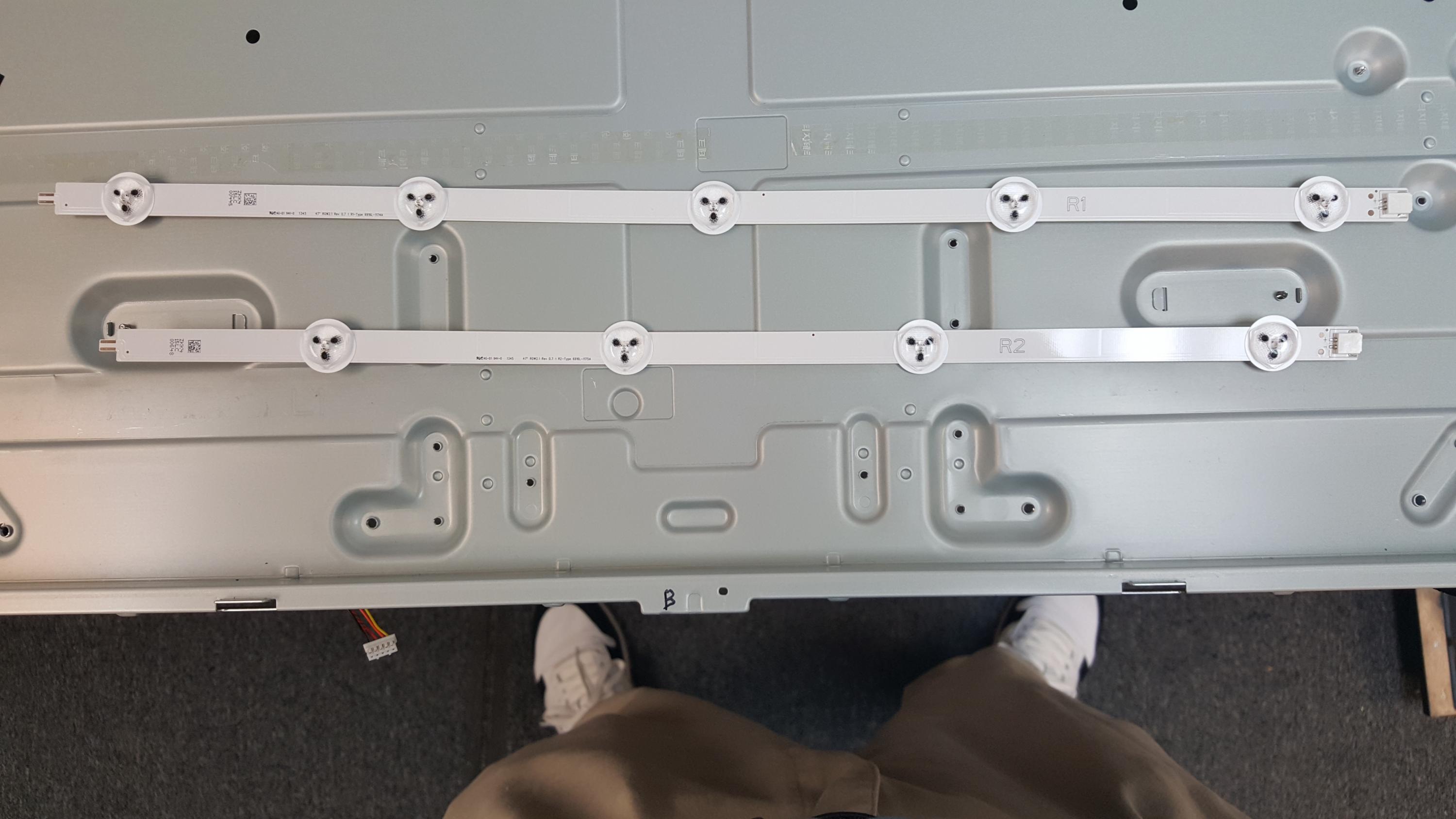

            Ok, awesome! Using this method, I have identified two sub-strips that cause the set of 3 to not light. All of the other sub-strips work fine. It's only these two sub-strips. Each are an end that would connect into the green bar first and then another sub-strip would connect into these strips to finish the strip out.
            I suppose, and correct me if I am wrong, one or more of these LEDs on these sub-strips has an open circuit and is preventing the rest of the set from working, right? I just have to identify which one. I have replacement LEDs handy. I could just replace ALL of them, since I don't have an LED tester unless you have any other suggestions?
              Pic of bad sub-strips for reference:

                That is correct, you should find out which LED has open circuit, which one may have shorted circuit. Replacing them all may be the best choice.
                BTW, look at the bottom side of the strip to see if any of them has brown spot due to over heat.

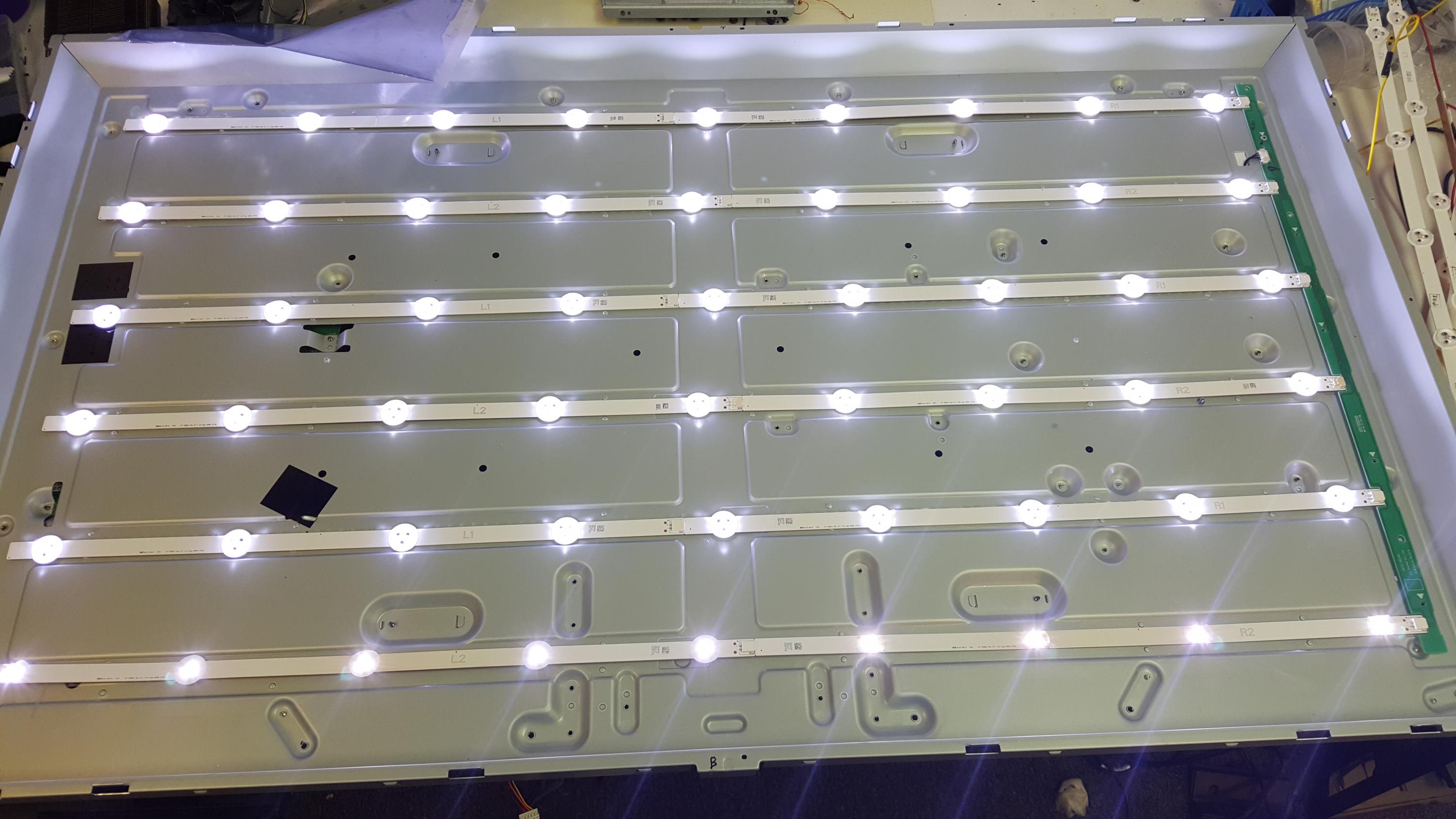

                        So, I wanted to post back an update. I was able to desolder the LEDs from the LED strips I mistakenly bought and solder them onto the original LEDs strips for just ONE of the strips. The others didn't seem to want to work. In the interest of time, I purchased the remaining strips I needed and just received them. I connected them all back together, and now all of the strips are fully illuminated!
                        So now I will begin reassembly and I will show the final working product (hopefully!)
                        Thanks for all the help and hopefully reassembly is without problems. Attached a picture of fully illuminated LED strips for reference.

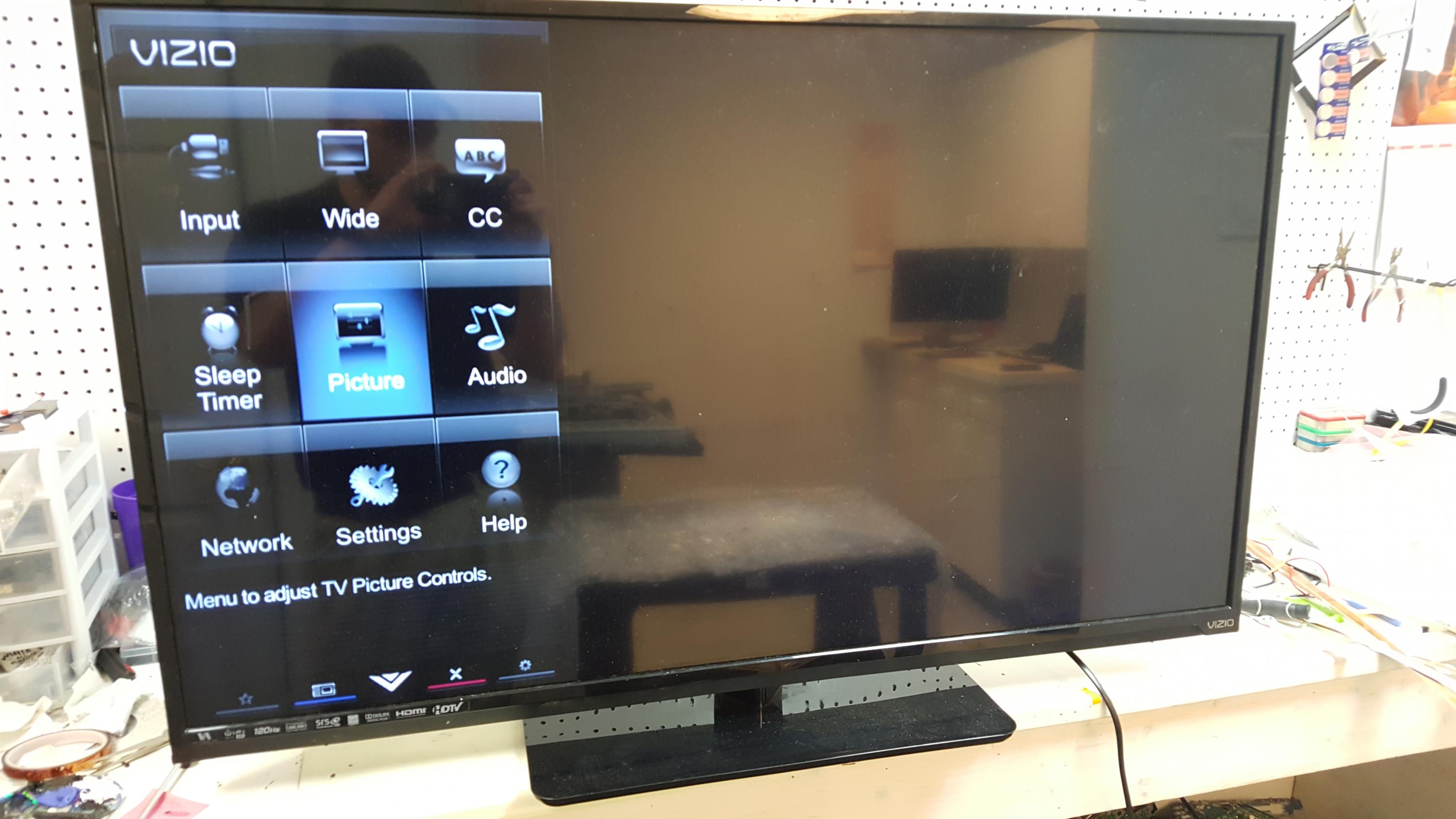

                          Awesome! Works! Thanks a ton, budm! I've learned quite a bit more about how these TV's operate from reading your posts and throughout this exercise! I'm sure I'll ask for help again in the future.
                          Attached pic of working TV for reference.
