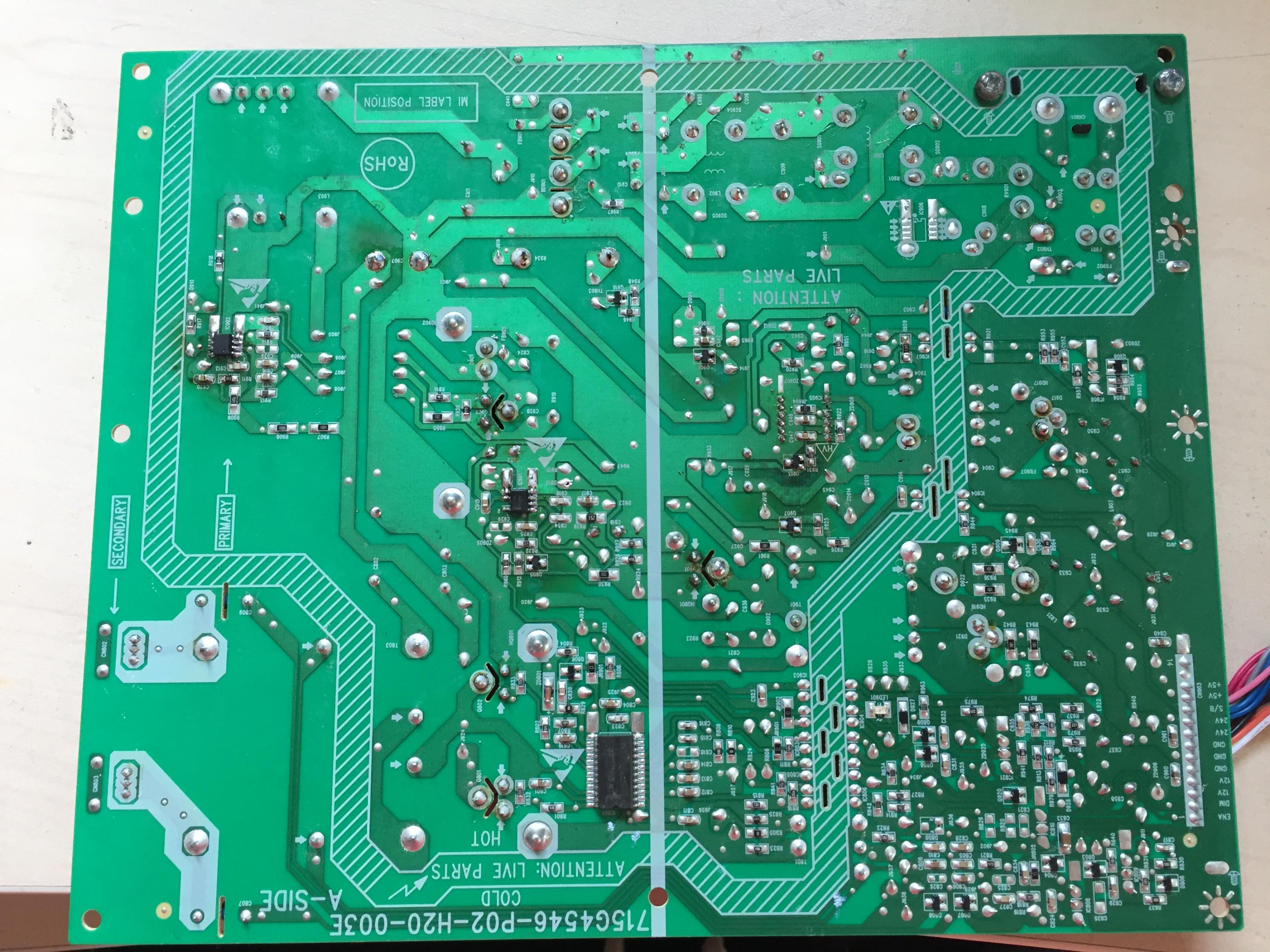

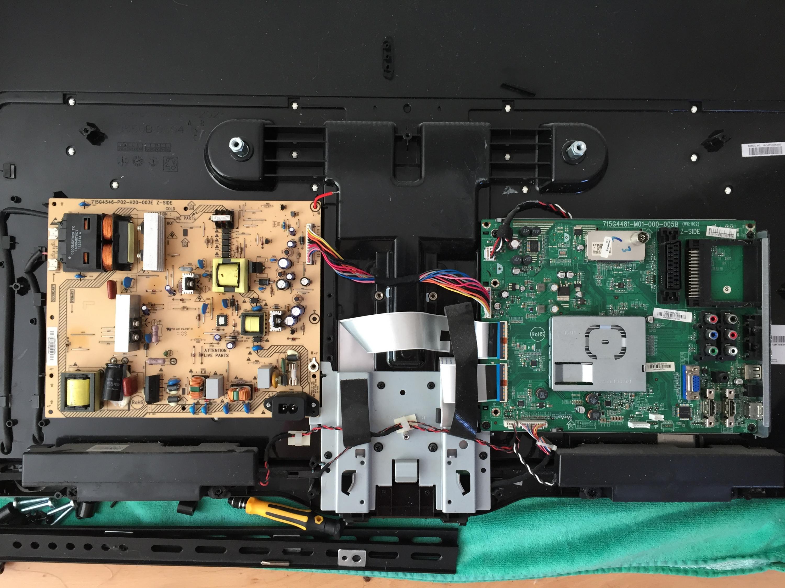

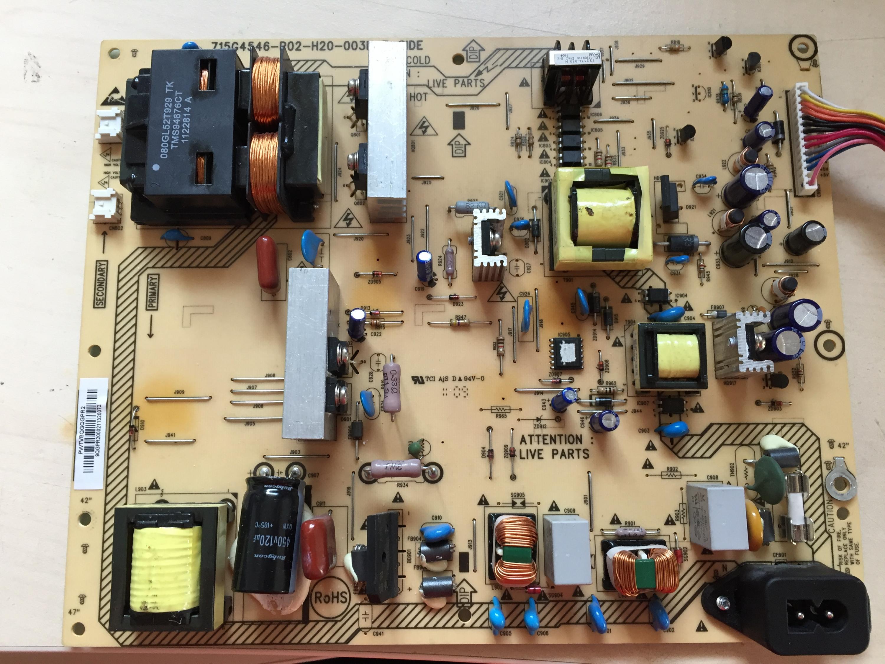

          Re: Philips 42PFL3605 no power and power LED
          Can we see good clear pictures of the whole backside of the TV showing all the boards and good clear straight shot pictures of the top and the bottom side of this power supply board?
          • sandem
            • Jul 2017
            • 6
            • Nederland
            Found the difference, my tv is number 42pfl4606h/12. See the attachement for the pictures. Stil no standby power working
