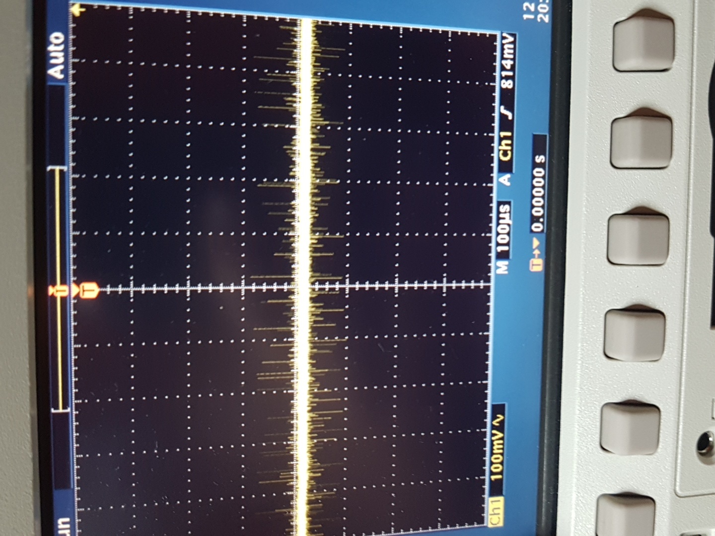

                    Yep. I even reached out to the guy who made the video asking him for his $.02 on the issue. He said if the caps were bad they would throw ~1v of hash on the scope set on AC coupling at 1/10 volt. None of my caps did that at all. In fact the ones that I changed had noise in them, nut only a slight amount and they still do with the new ones. I tried to use that as a clue to go back through the circuit but I didn't get anywhere.

                      This is all the noise I saw on the "bad caps"

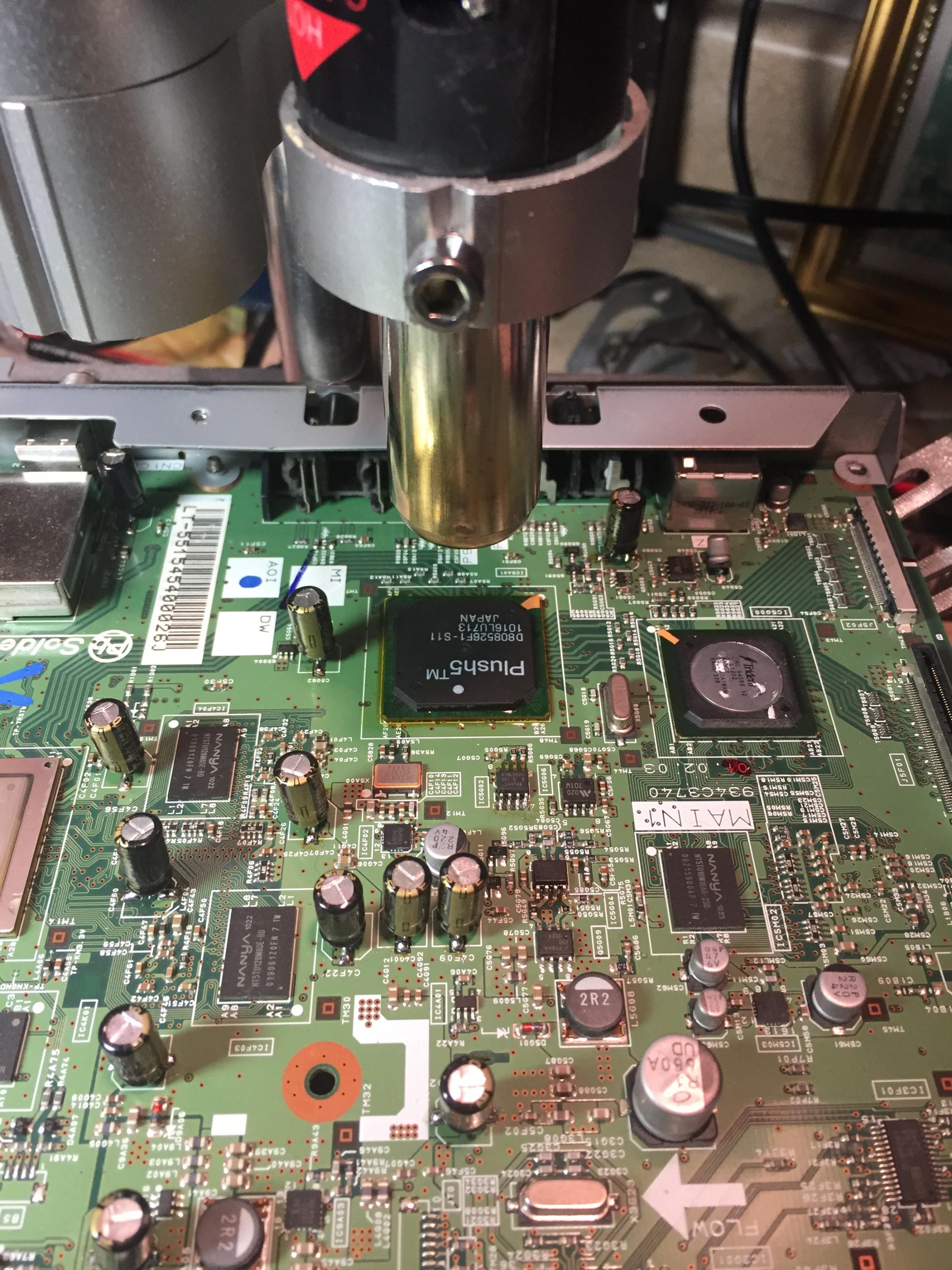

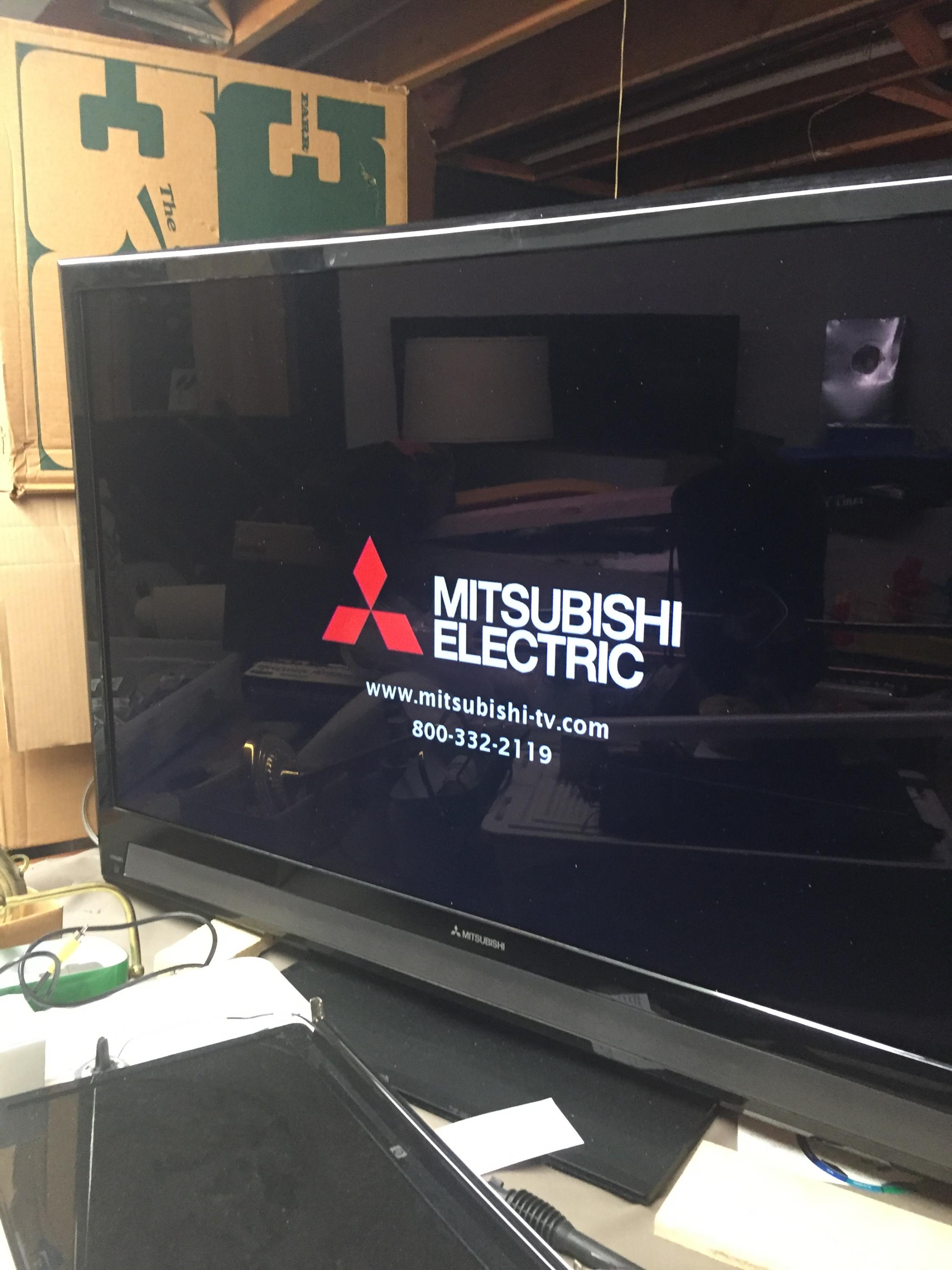

                              Finally Fixed my Mitsubishi LT-55154. The Failure was identified by Nyjetfan21
                              so lets be sure to give credit where credit is do. I Reflowed the surface mounted GPU on the Mainboard. The suspect chips are under the heat sinks.
                              The Rig I used was originally used to reflow GPUs on Laptop Motherboards.
