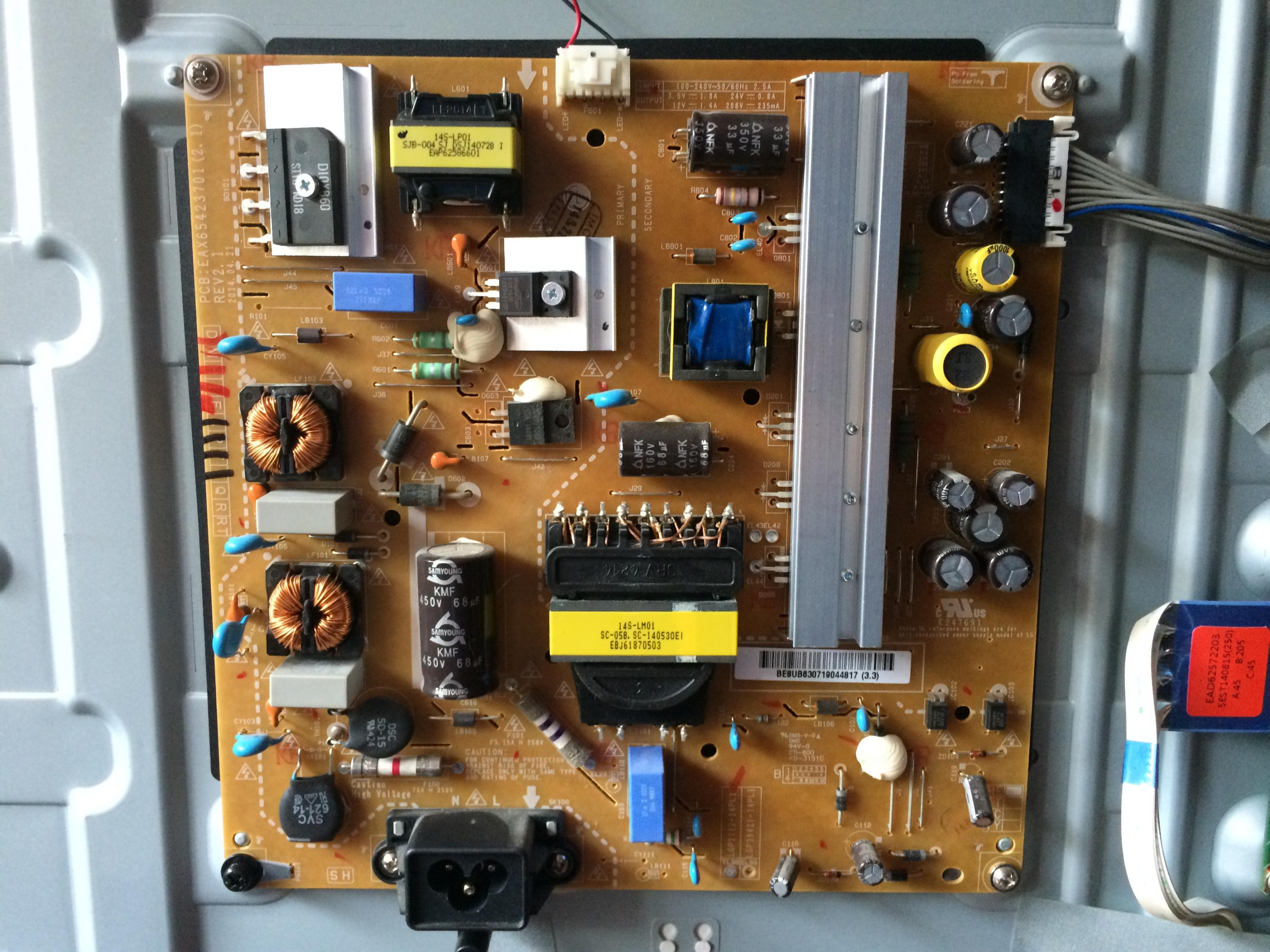

    I have an LG 42LB5600-UZ. When I connect the TV to a video source I can hear sound and I can see an image when I do the flashlight test. If I open the TV and measure the voltage coming from the power board to the LEDs I get nothing. I'm pretty sure I have a bad power board.
    So, here are my questions:
    Is there any way I can test the back light before ordering parts?
    Is there a way I might be able to repair the board? The fact that the backlight has absolutely no power yet the rest of the TV works fine leads me to believe that it might just be one bad component that needs to be swapped out.

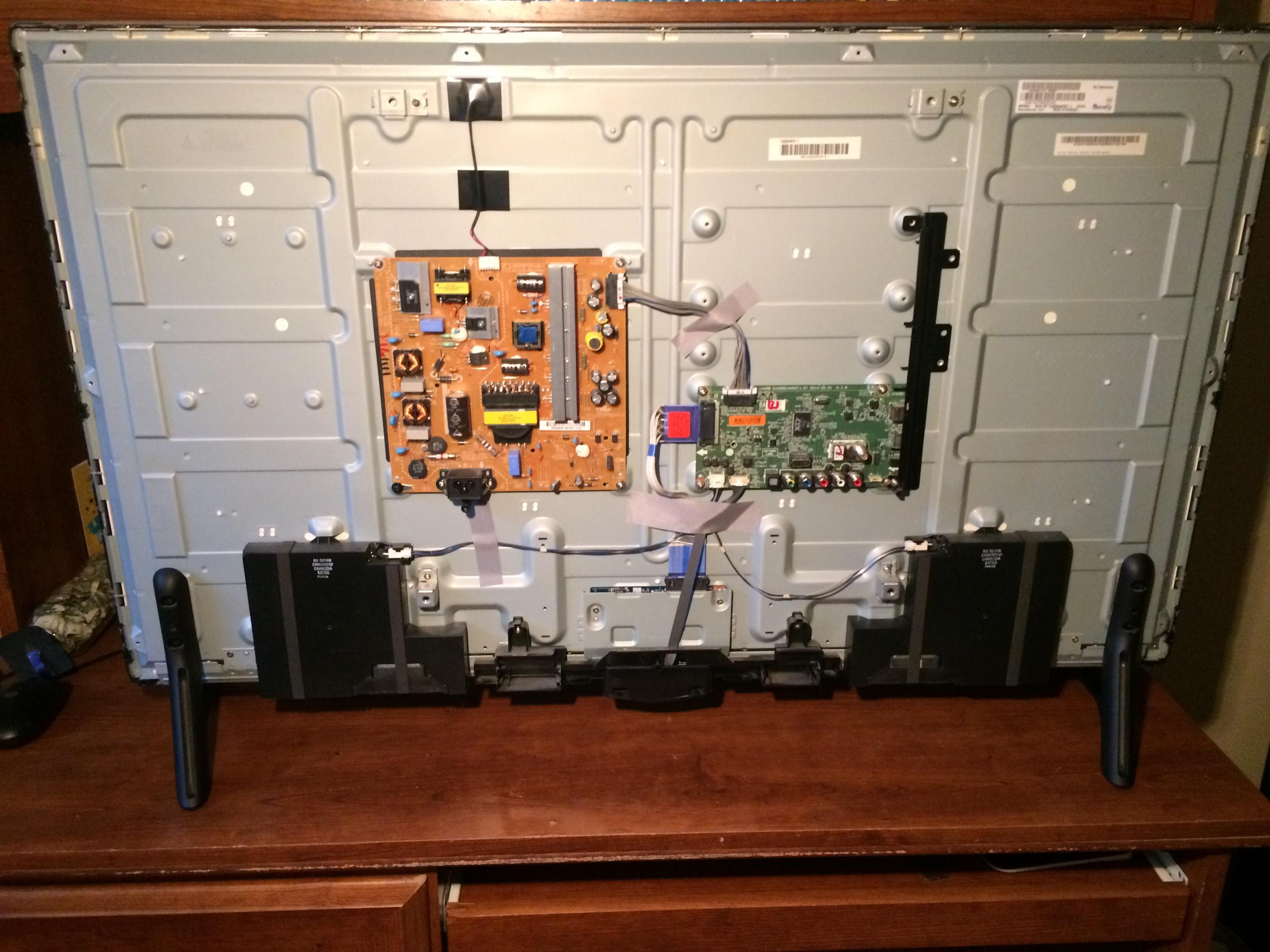

    Assume led's. Not enough pictures to see. You have no 24v

      Whats pictures do you need? I can add more if you want.

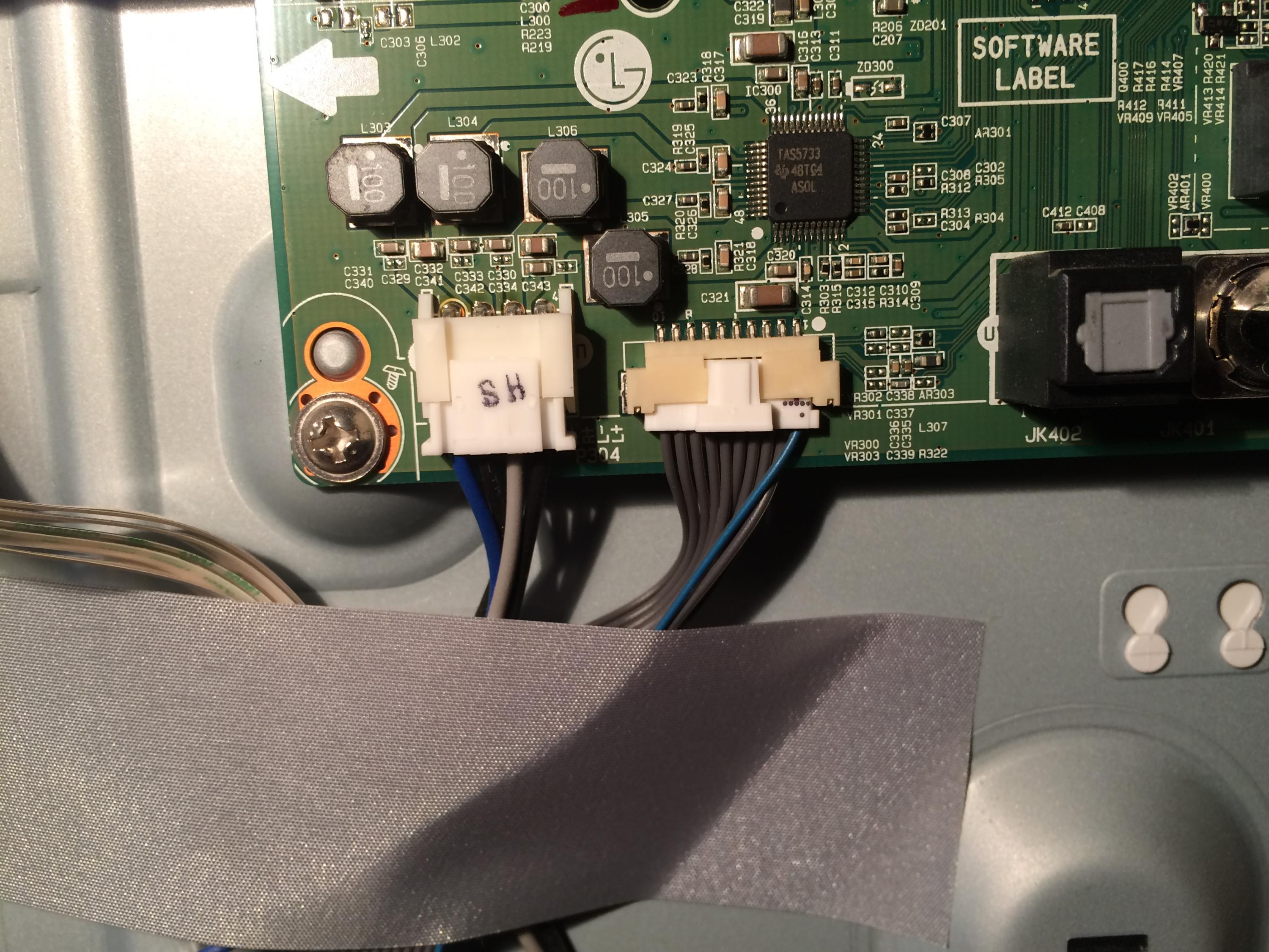

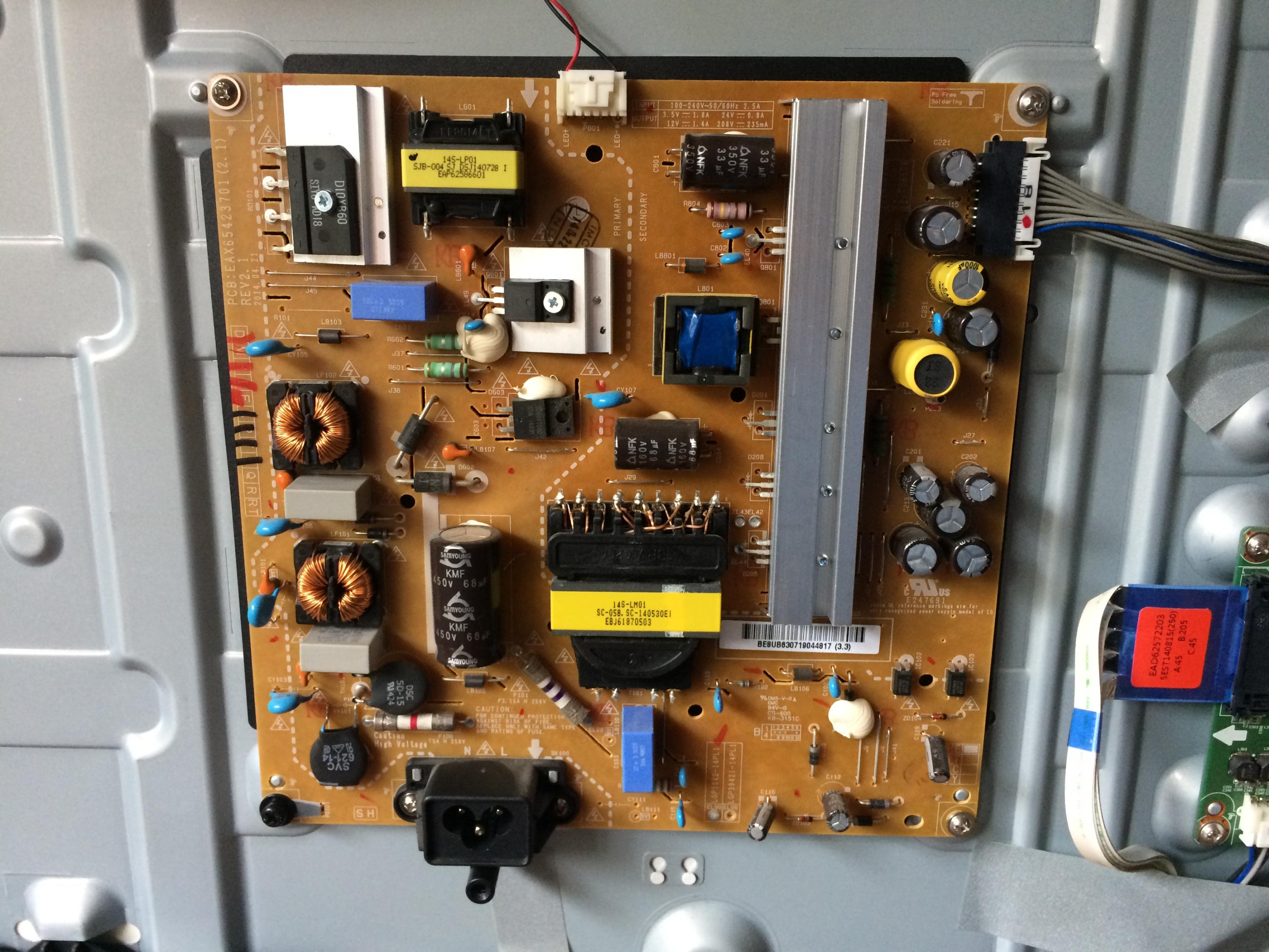

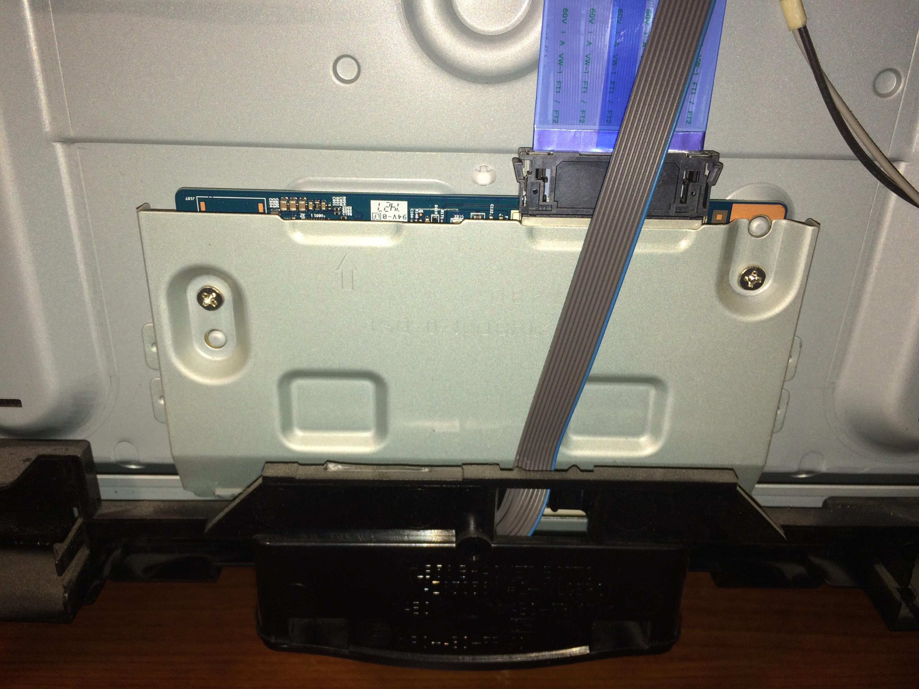

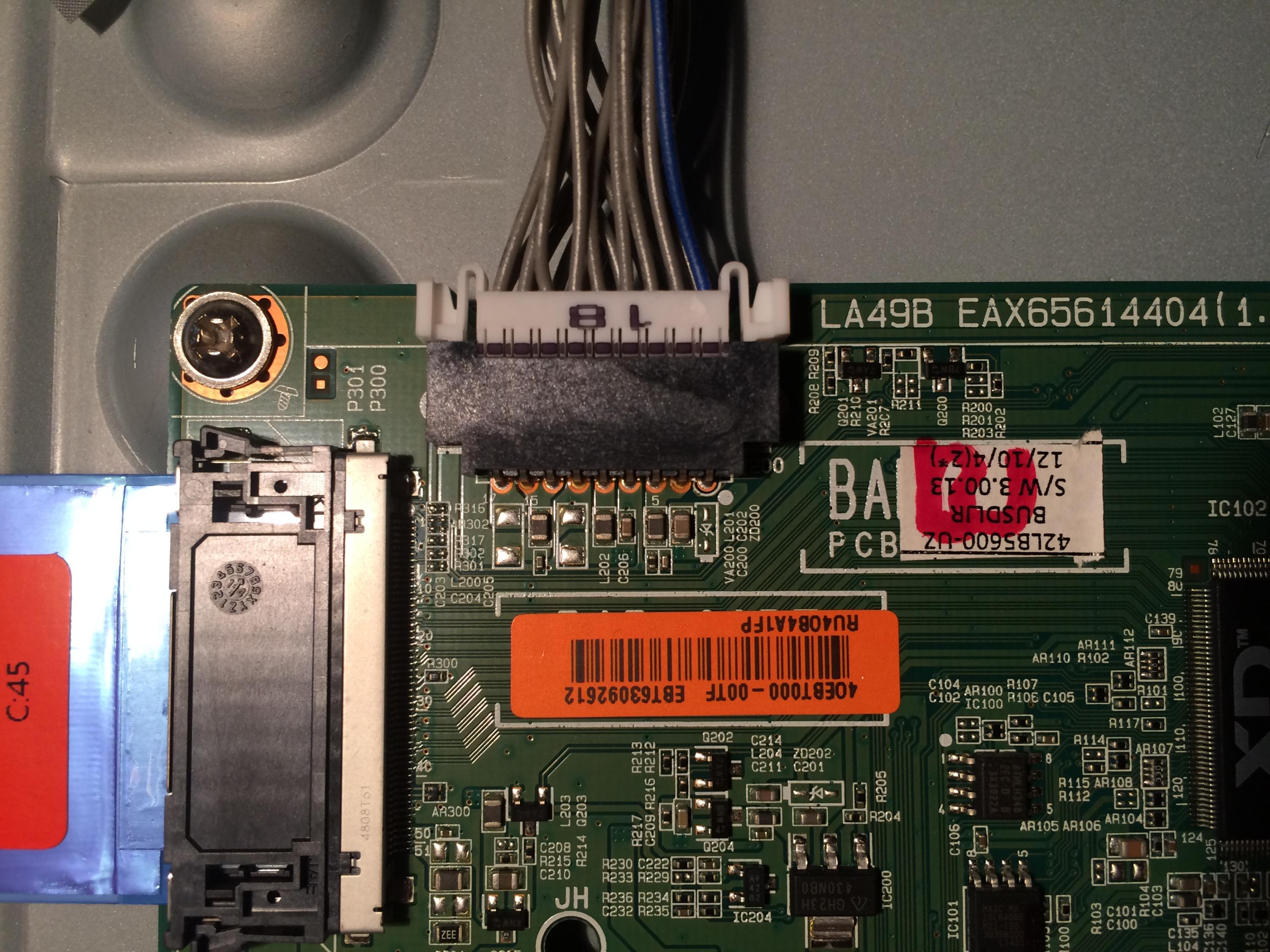

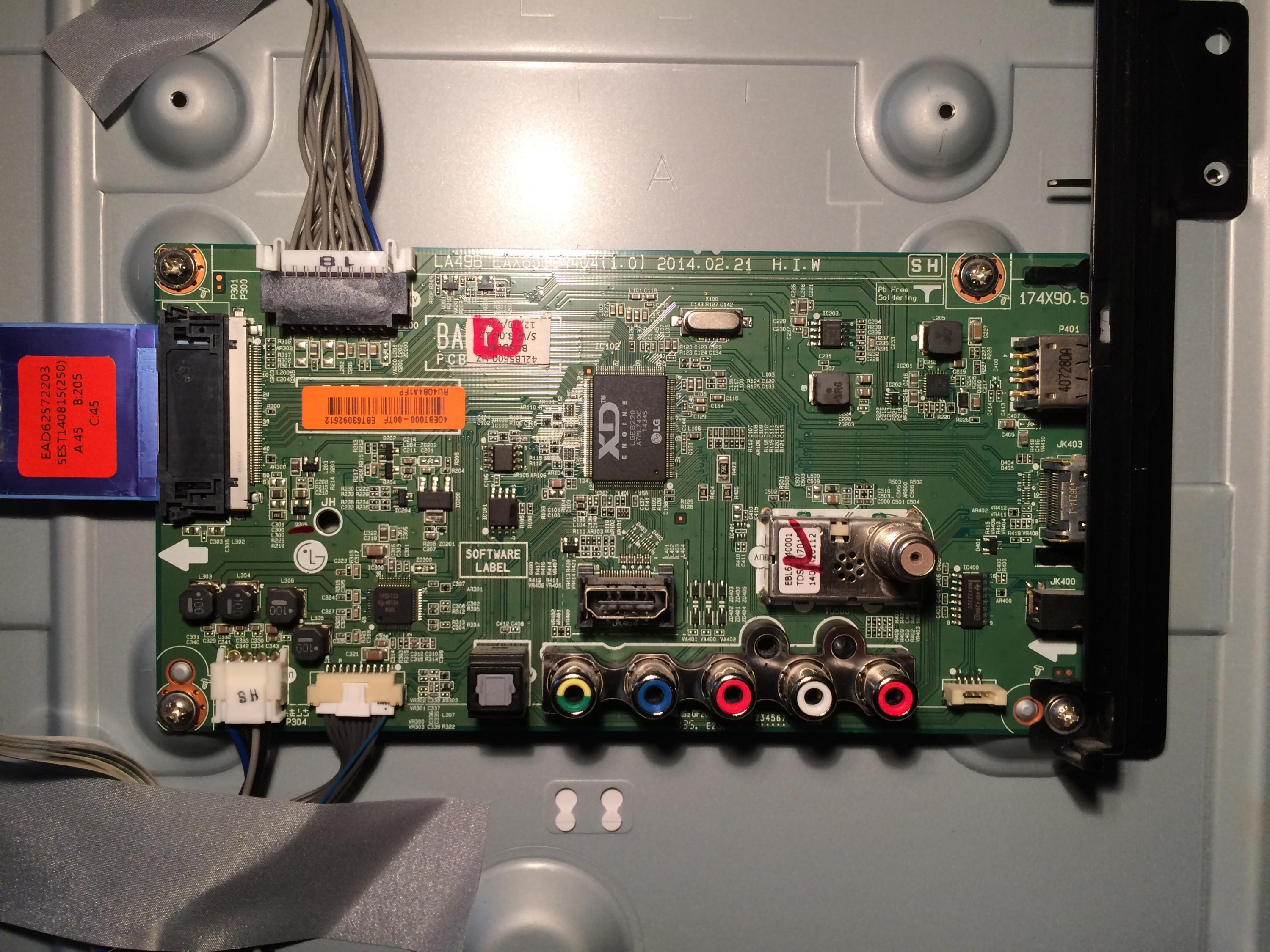

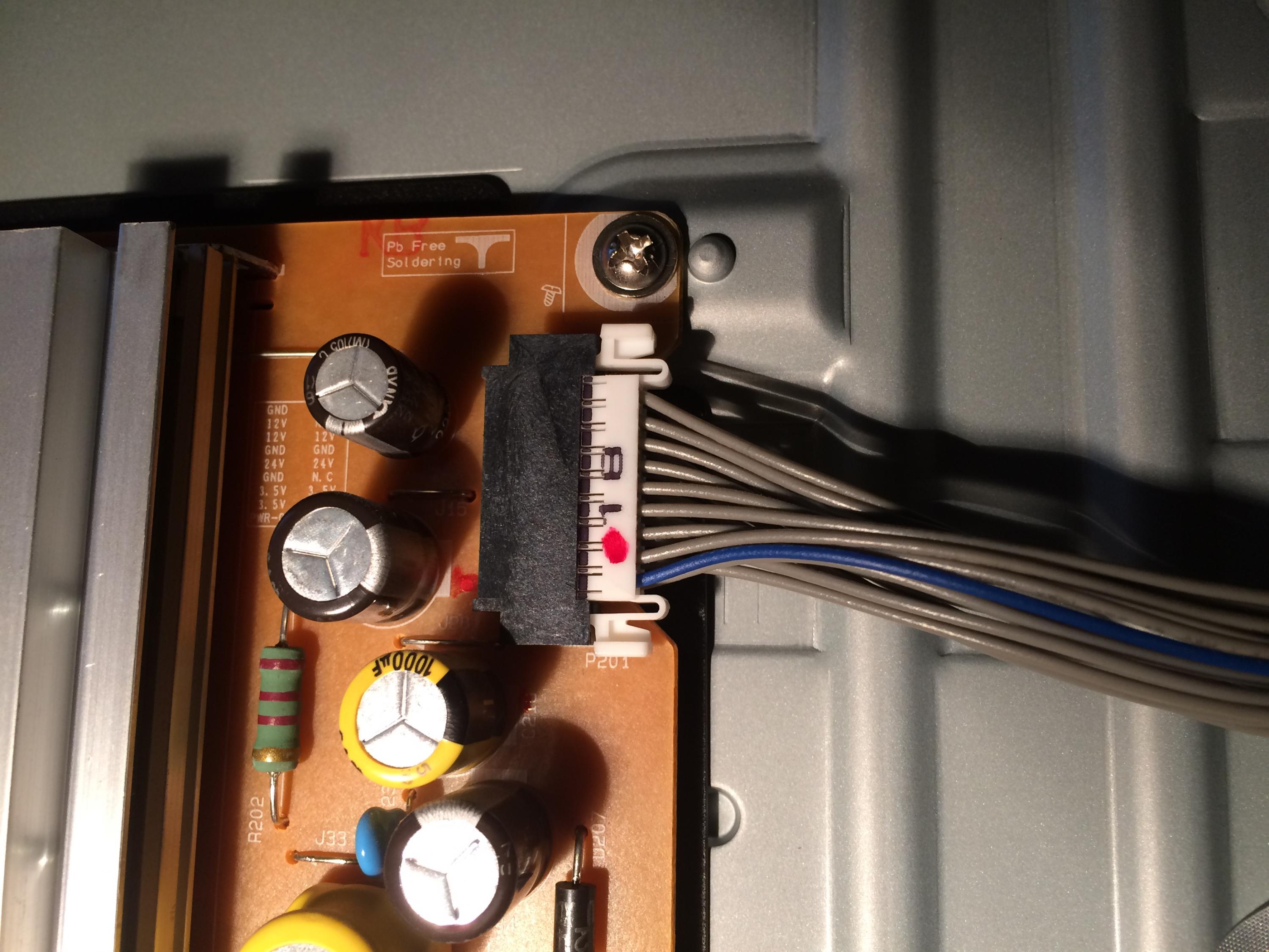

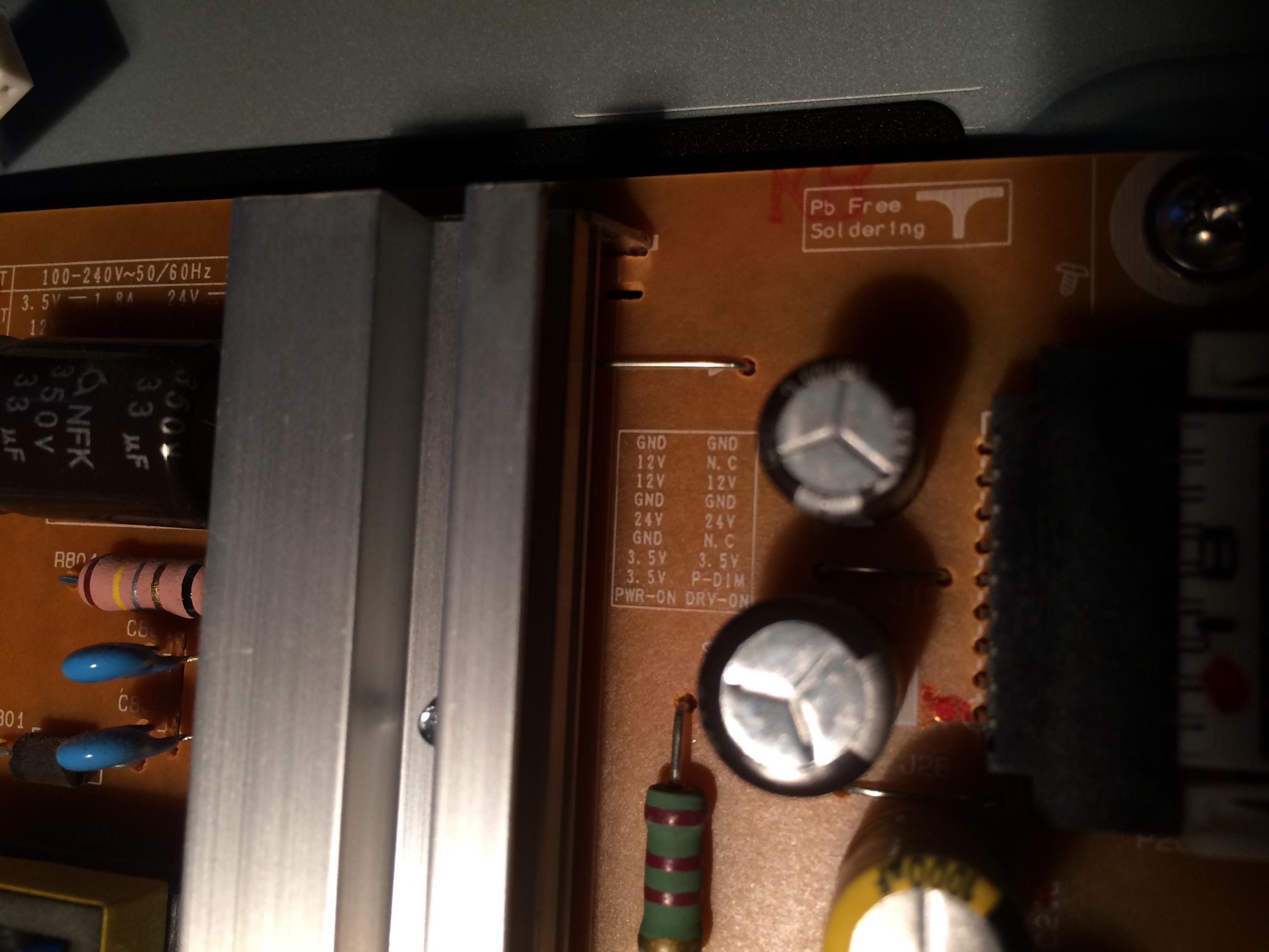

        Whole back of tv. The rest of the boards. Close up of connectors

          Here are the pictures you asked for.

            since you have a pic on screen but no backlights, you are looking at an led failure unless there is no voltage on led+, but it is an lg and will almost always be led failure in this situation.

              I have no voltage on LED+, hence my suspicion that the power supply is bad. I did some research on this model and it seems like replacing the power supply is a common fix for this model.
                Re: LG 42LB5600-UZ sound but no backlight
                Turn TV off, set DCV meter to 600VDC range, then put DCV meter's black probe on the chassis and red probe of the meter on the LED+ pin of the LED connector, keep an eye on the meter then turn on the TV to see how high the Voltage goes up to then wait about 5 seconds to see how low it goes down to.
                https://www.badcaps.net/forum/attach...1&d=1499898761

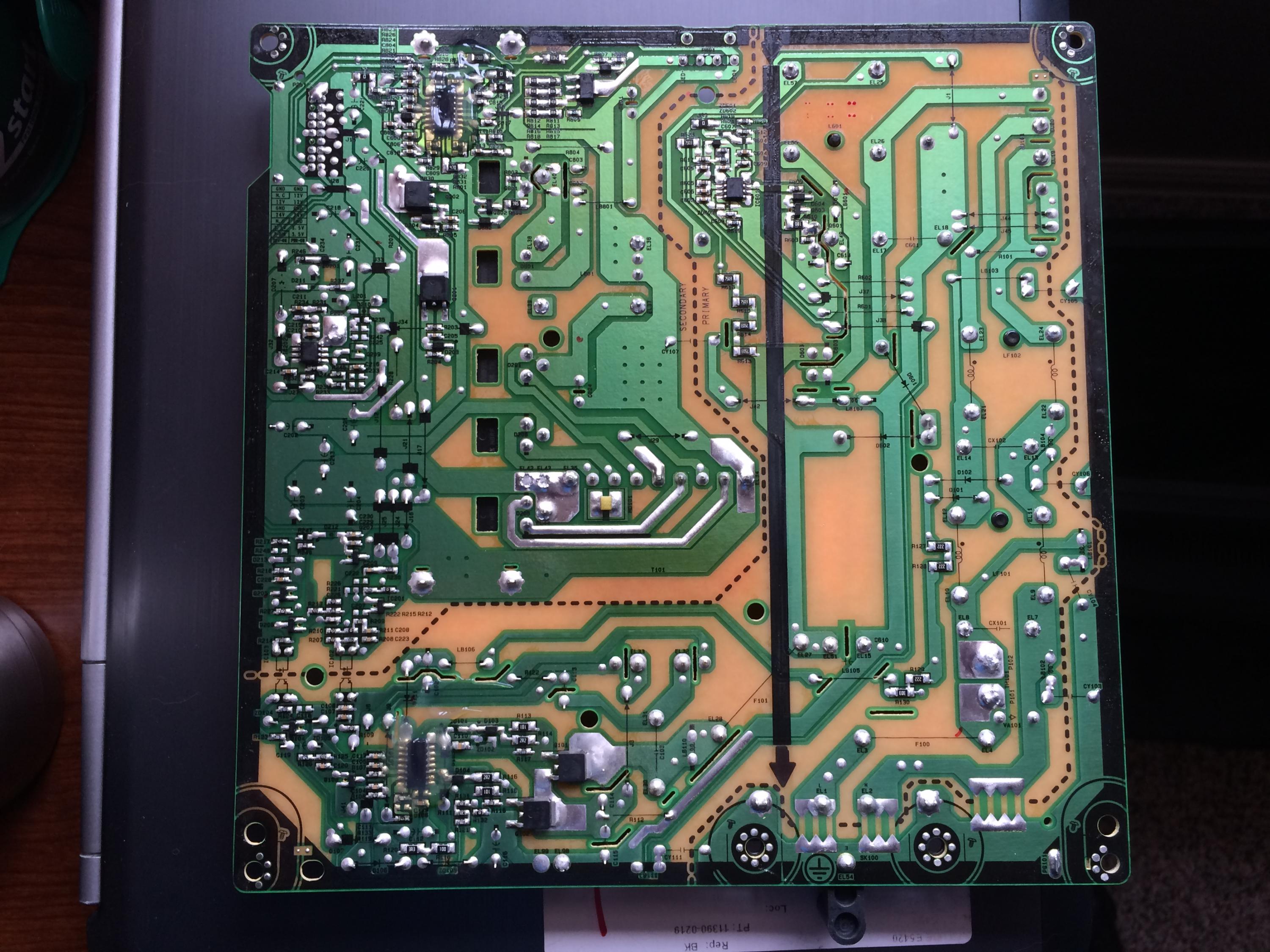

                BTW, the solder joints for D201 (this one supplies the B+ to the Voltage boost converter for the LED power supply section), D208 do not look good, you can see small ring around the legs. I would re-solder all the transformer legs and all the legs of the devices that are mounted to the heatsink too.
                LG EAY63071904 Power Supply / LED Board.
                http://www.shopjimmy.com/lg-eay63071...led-board.htm#

                  Need voltages from connector that goes from power supply board to main board. Will need pin#- PIN DESCRIPTION -Pin voltage in standby-Pin voltage when pushing power button and picture of connector on power supply board.
                  Format:
                  Pin# - Pin Description - Pin Voltage standby - Pin voltage power on
                  1 - XXXXXXX - XXv - XXXv
                  2 - XXXXXXX - XXXv - XXXv
                  3 - XXXXXXX - XXXv - XXXv
                  4 - etc.

                    Sorry I didn't reply until now. I just went ahead and ordered a new power supply, something came up and I don't have time to work on the TV anymore. Tomorrow I might take a look at the power supply and re-solder those connections if I have the time.
