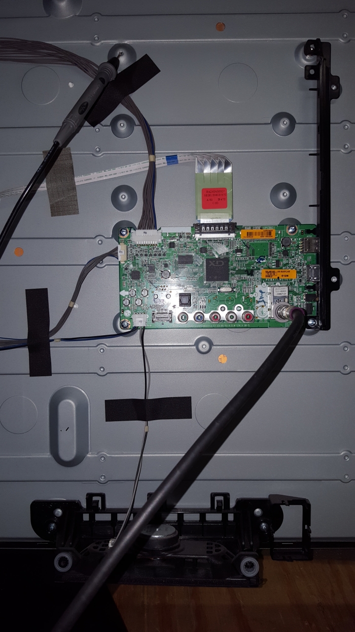

    I noticed a few threads for same issues on this model. I decided to repair this one for the experience. It is another trash rescue.. (bring me your garbage LOL) but I'll be glad to keep it out of the ground water. Thanks for any input to help me keep things moving along faster.

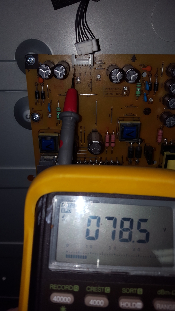

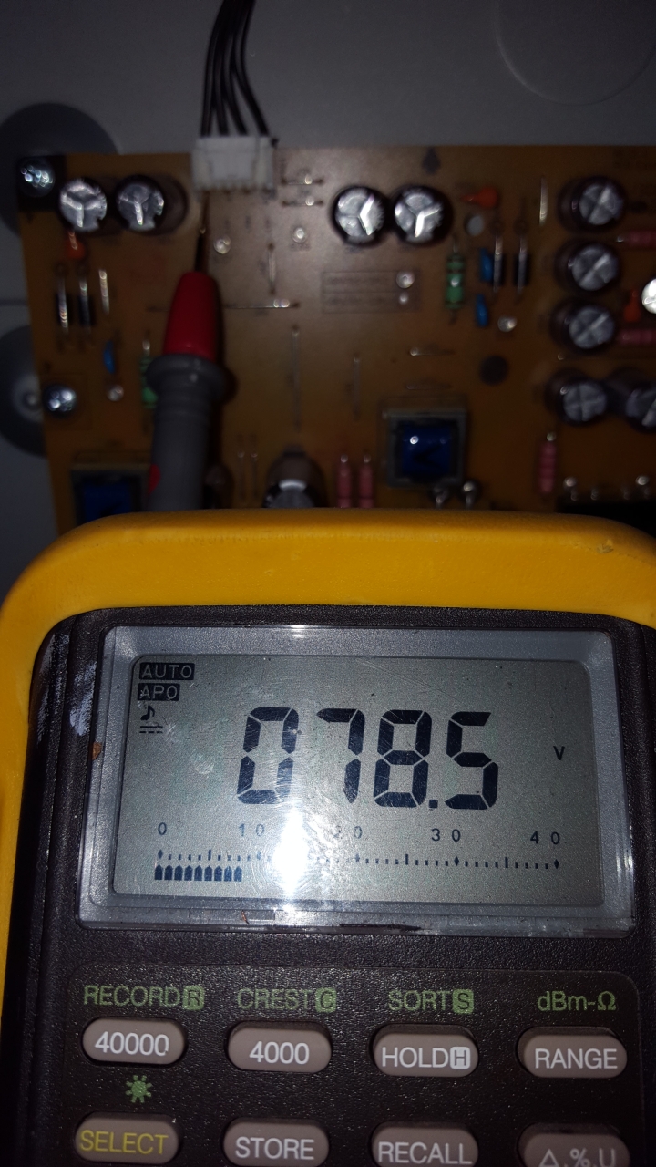

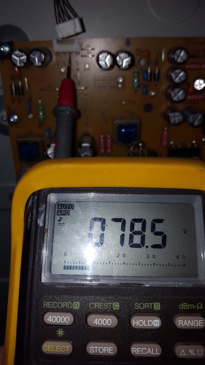

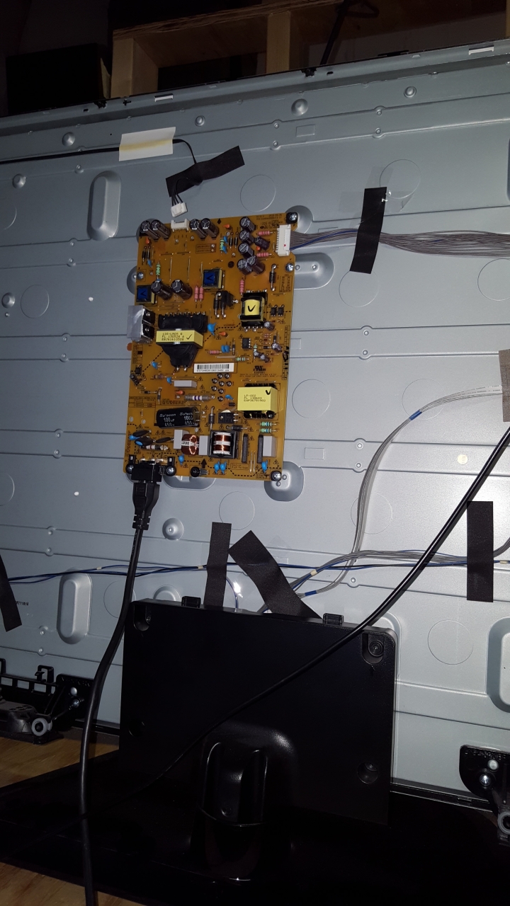

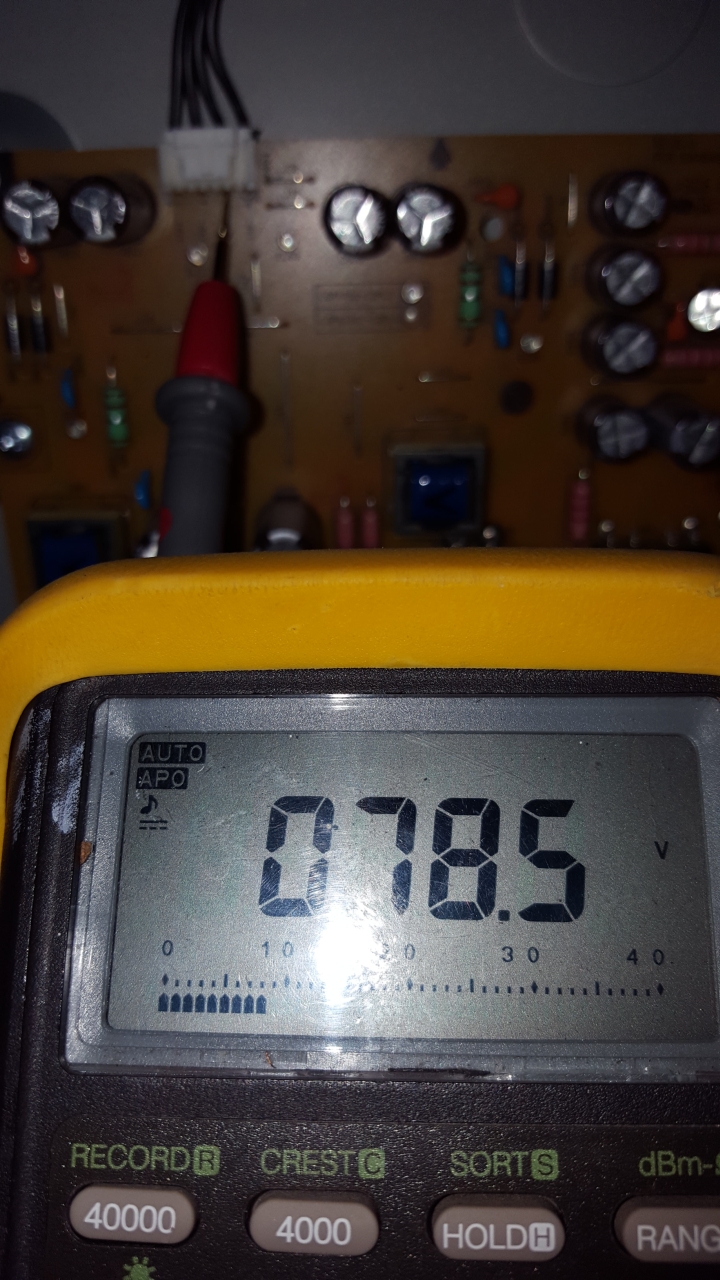

    OK voltages are steady and perfect. 78.5v whether back light is connected or not. Note to the strange.. I have a cheap little LED back light tester that when connected to the led it lighted, both side one at a time... After I connected the leds back to the power supply it came on and worked beautifully for about 30 min then it blacked out again.
    I now suspect a component failure on the led control/ connector strip or a bad solder joint on an led itself. The voltage pull did not change at all, ready steady 78.5v.
    I will photo document this one for future guests....

    Your led tester does not test under a high load. Only about 30ma, but when driven from the tv they are driven a lot harder. You could connect tester and move connections to see if bad strip connection. Answer to your question. There are numerous ways to remove lcd panel but anyway you do it the panel has to come off. Whether you lay it face down, face up or on it's edge
      Re: LG 50LN5100-UB LED Back light Out / Repair

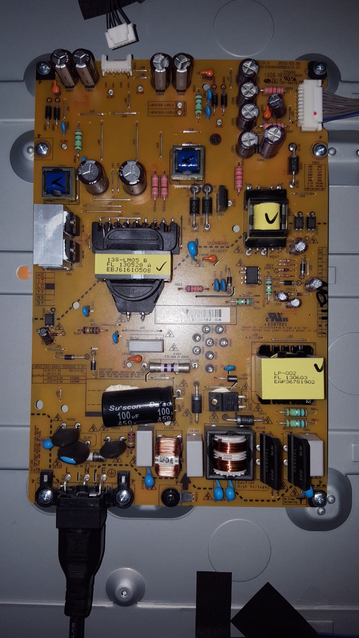

      That 78V reading on the LED connector is reading you are getting after the LED Voltage boost converter went into shutdown mode so you are only seeing the feeding Voltage to the boost converter.
      If you put black probe on the chassis and red probe on the LED+, keep the probes there then turn on the TV then you should see the Voltage jumps up to over 120Vdc for seconds and then drops back down to 78VDC.
      The drive Voltage for the LED with load is 110VDc as printed on the board.

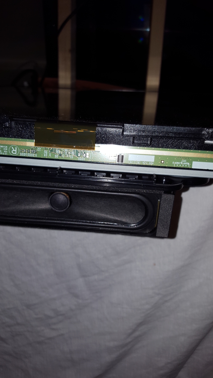

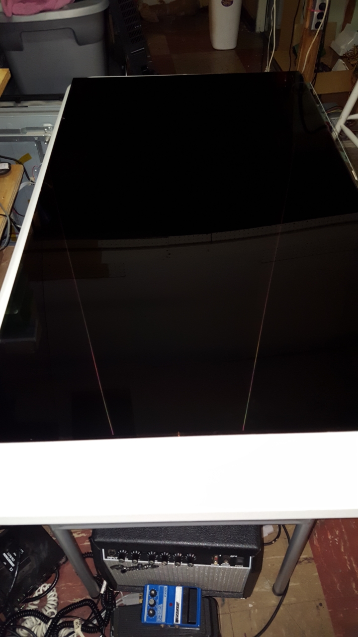

          Hey thanks guys. Familiar with the term FUBAR? LOL I'm glad this was a trash pic. Here's how I screwed it up good. I took off the screen down to the LED's. Soldered the LED back and got it working. HOWEVER.... in the process of taking the screen apart I stupidly (hope others learn from my screw up) took the screen apart in two pieces, removing the narrow circuit boards from the frame and then the screen. I then removed the remaining panels together. Apparently in this process I screwed up the screen.
          2 issues I didn't realize:
          1 I should have just un-snapped the secondary plastic frame that had the thin circuit strips and the screen in it and then removed it as a whole unit.
          2 I think i may have let the screen bend too much in the whole process.
          Either way i have a great back light and a streaked up jacked up screen. (to make me sicker it had a perfect picture when it worked for the short time i mentioned earlier.
          I wish I had gotten these posts earlier or had waited but hey I was in a hurry...
          I now see how Charleyd method could have worked just fine and i would now had a sweet picture instead of just audio and streaks.. sorry to be a disappointment to you guys but live and learn right? I may try some things or just wait for another one like it to show up.

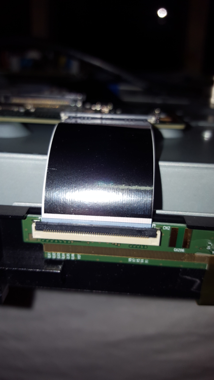

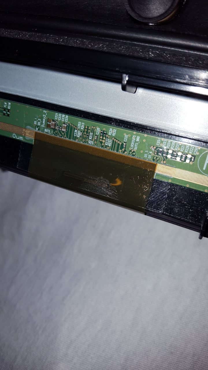

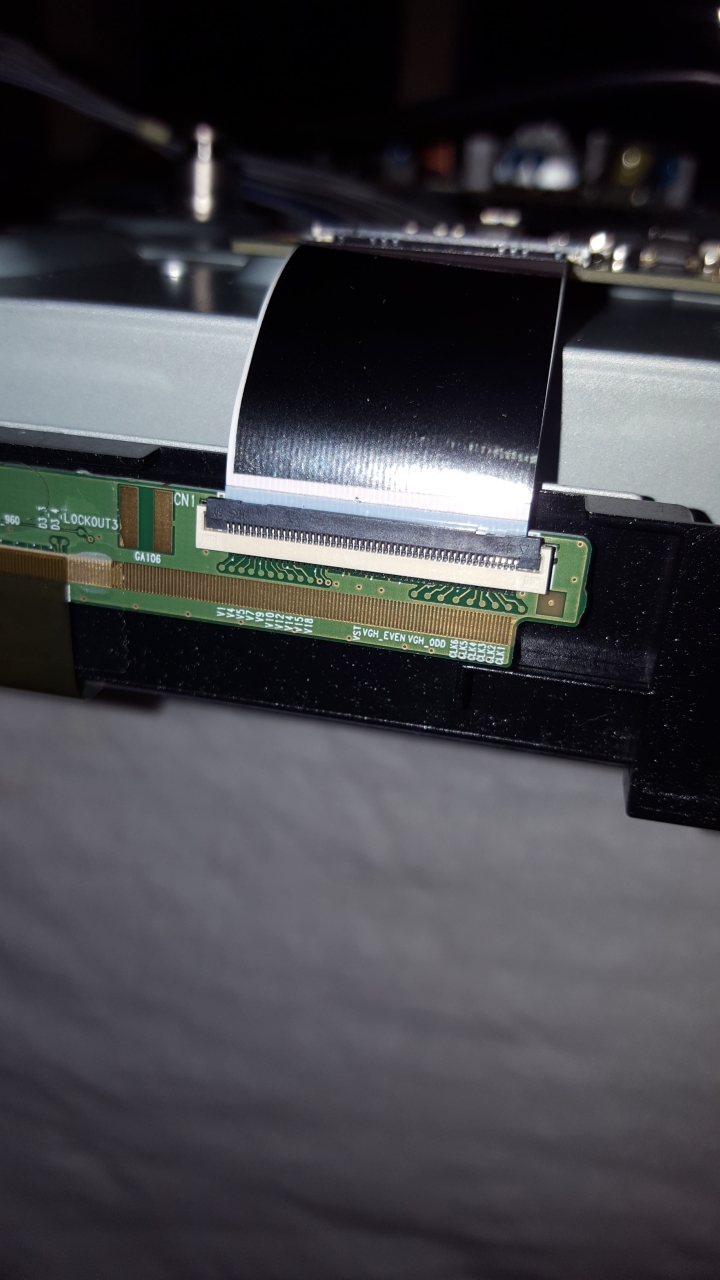

              UPDATE ON SCREEN:
              I took the plastic molding front back off and then the bottom metal strip so I could get at the ribbon boards. I simply ran my finger along each ribbon where it joins the board and VIOLA when i tested I had my beautiful picture back. So I shut it back down and put some scotch tape over each one.
              Wow what a learning experience this is turning out to be. LOL
              Will post pics if it works when reassembled.
              • Doc38343
                • Apr 2015
                • 402

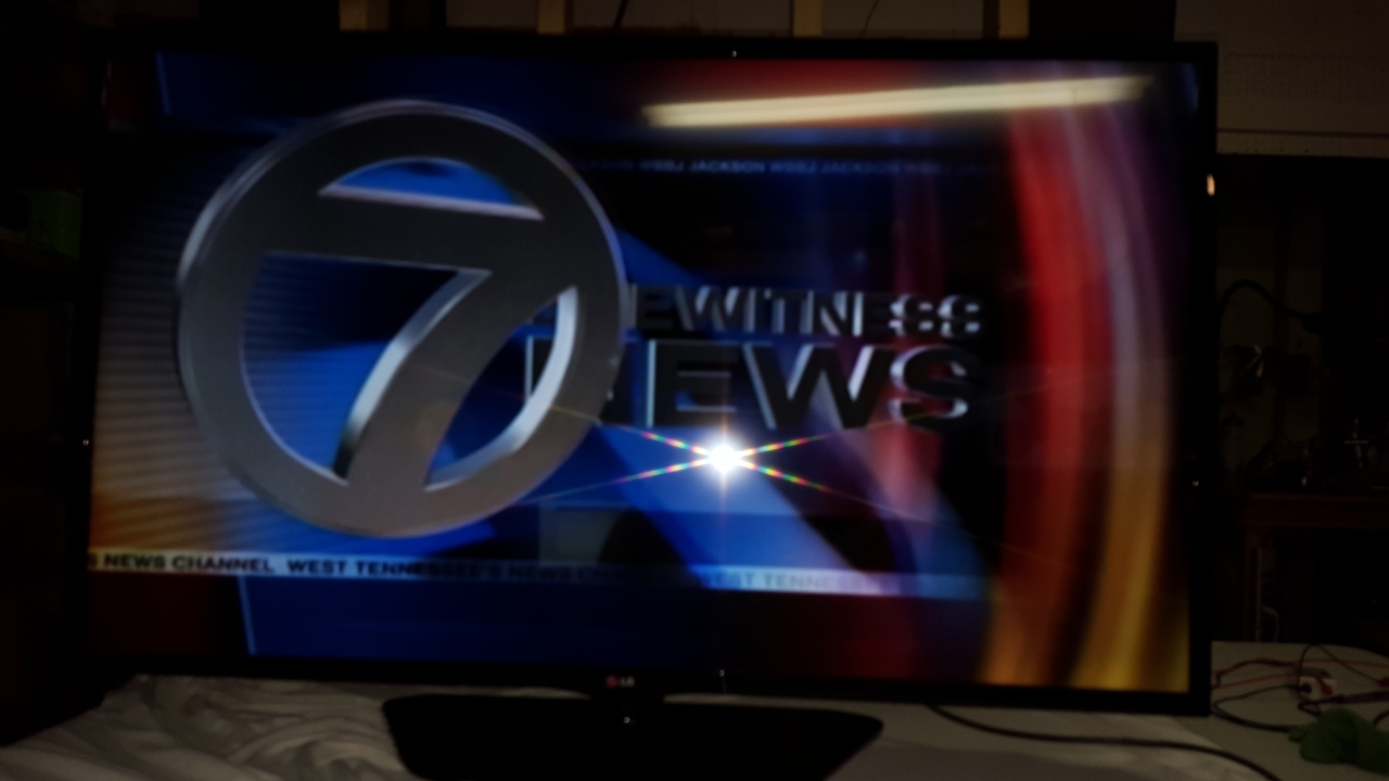

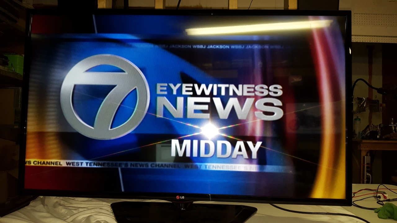

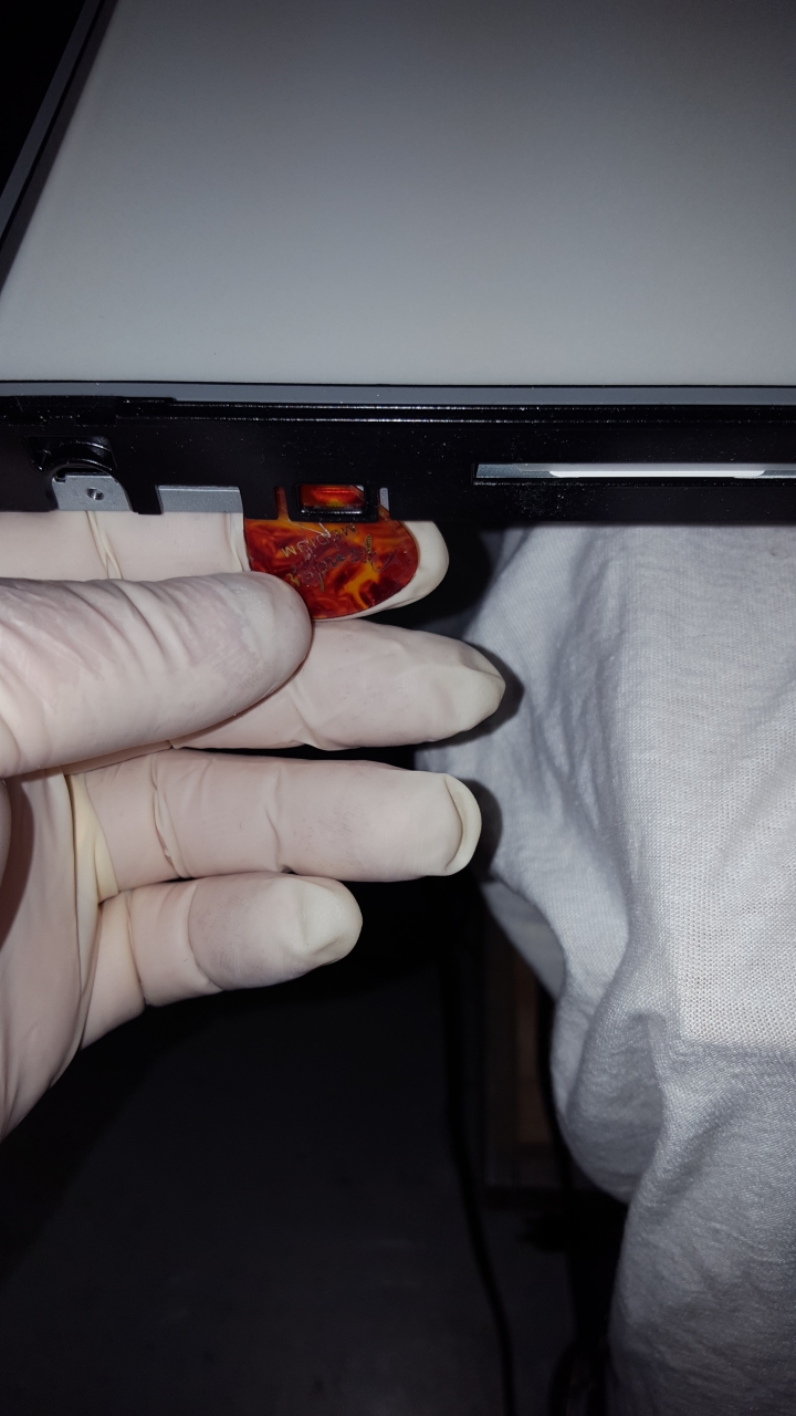

                OK final update... SUCCESS!
                OK what it turned out to be was as follows. I put the tape on and then put the metal strip back and tested.. it was screwed up again. I took the metal strip back off and it was still messed up so i tried touching each strip to see if any changes. Then I pushed in on the clip where the ribbon cable goes in on the left side one facing back and it changed so I fiddled with it some and it kicked in good but then messed up when i let go. Now I had already cleaned and examined the ribbon cable so i took a magnifier and looked down into the clip jack it self and there was a speck of foil or a tiny piece of solder. I blew the jack out and re-seated the ribbon cable and it works fine now.
                I did include pictures. I am very happy to have this success, I couldn't sleep last night for thinking about how i ruined a sorta good 50 inch TV... LOL
                It was stubborn but I am more stubborn.
                Included a few more pics. I hope all this helps someone else in the future.

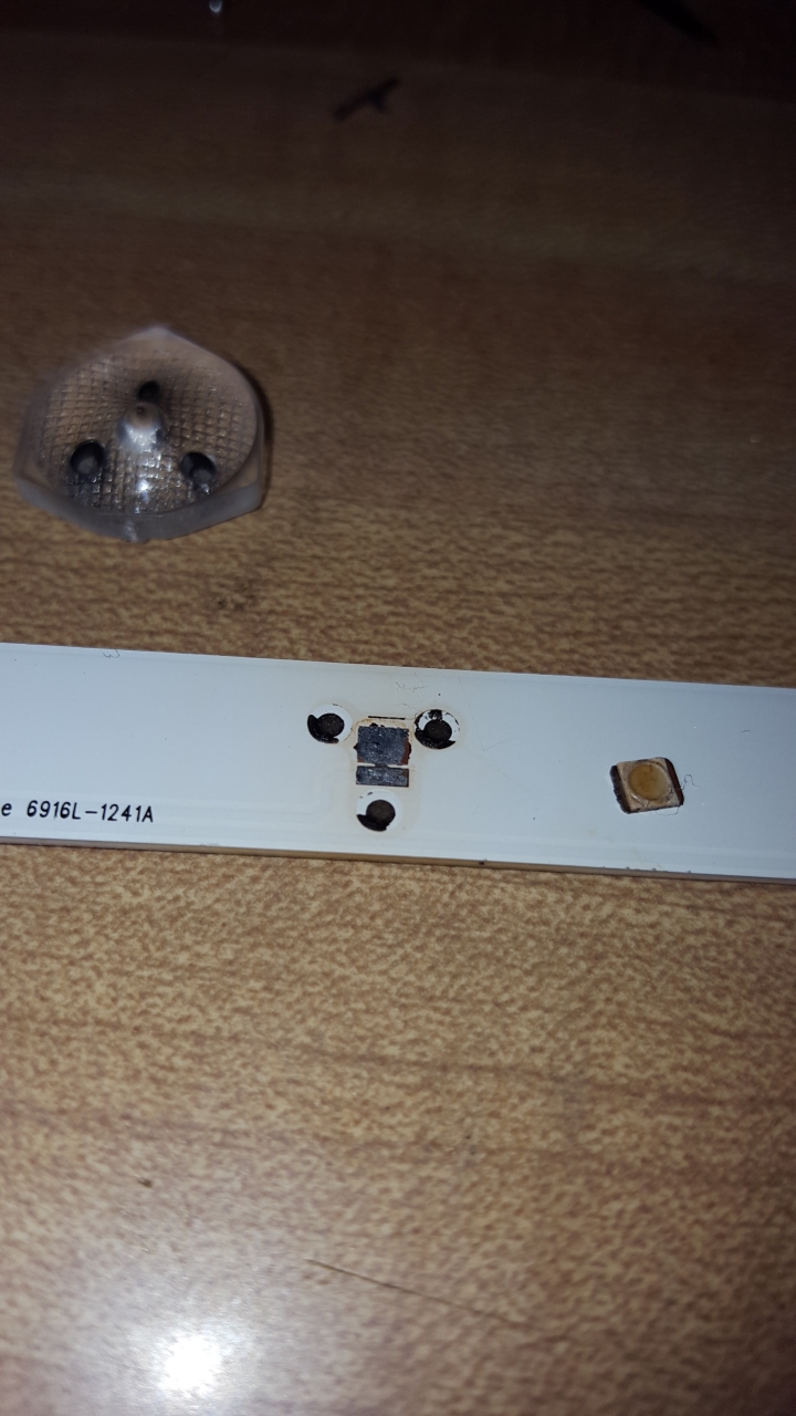

                    Hi everyone. New on here. I have the same TV and issue. I originally replaced the single LED and had to use jump wires to complete the strip because it was so burnt. It was the last led on (R1). TV worked for 5 Mins. I had the menu up and then it went black. I then went and bought a brand new strip (R1). Turned on TV. It just flashed and didn't even come on. Any idea?

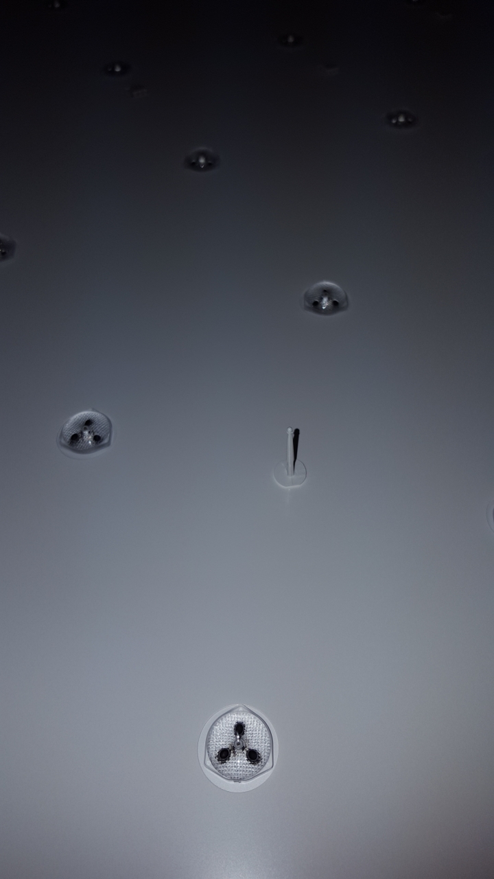

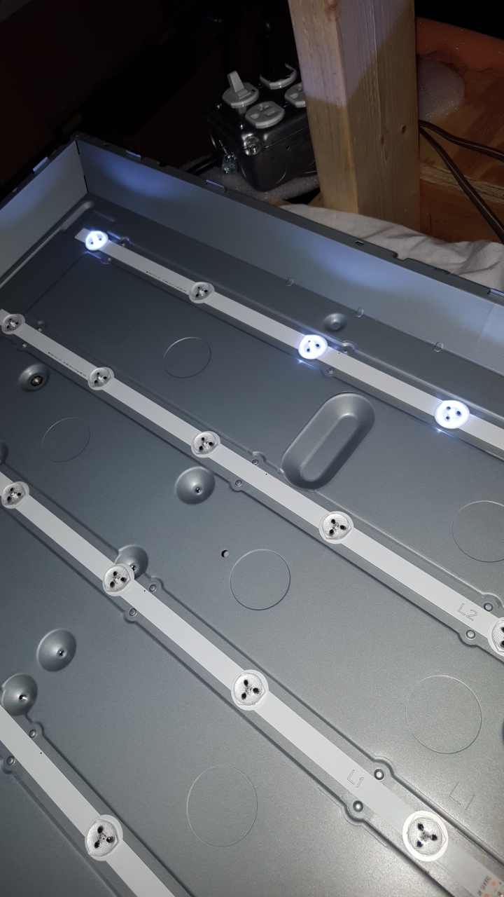

                            Ok. So i got it up and running. After testing each LED on every strip, I found there were a couple other (3) leds that where no good also. I didnt have enough R/L strips to cover all of them. I replace the actual LED and then glued the lens back on. Only problem is i now have one hot spot on the screen.
                            Lens back on wrong or its the only new led in that are. Im not sure. I hate to keep tearing this thing apart. afraid the screen is going to break . especially those ribbon strips.

                              If the hot spot is a concentrated dot on the screen the diffuser lens probably fell off. Hear anything rolling around in the bottom of the screen/display area?
                              I did backlights in a 47ln5600 once where I glued the diffuser lens down with Krazy Glue, put it back together and had a hot spot appear over the next 30 minutes. Turns out, with the legs of the diffuser being close to the center the KG was outgassing in to the center of the diffuser and clouding it up, causing the hot spot. I now use epoxy for this reason.
                              After re-gluing diffuser lenses I place the diffusion sheets back in the TV and turn it on. Just make sure the FFC cables are not installed in the T-CON, if they touch chassis ground it's bad. This way you can get everything re-adjusted and check to make sure its right before you put the display panel back in.

                                I would say its a cloudy whiter spot maybe 4-5 inches in Dia. I dont hear anything rattling around. I need to see them without the screen i guess. I wasn't sure how to test with the screen off. Last time i couldnt see them. The led's would not come on unless i plugged some wires in. I thought the T-con had to be plugged into the screen for some crazy reason. Anyhow thanks for the tip. I might disassemble it one more time. LOL.
