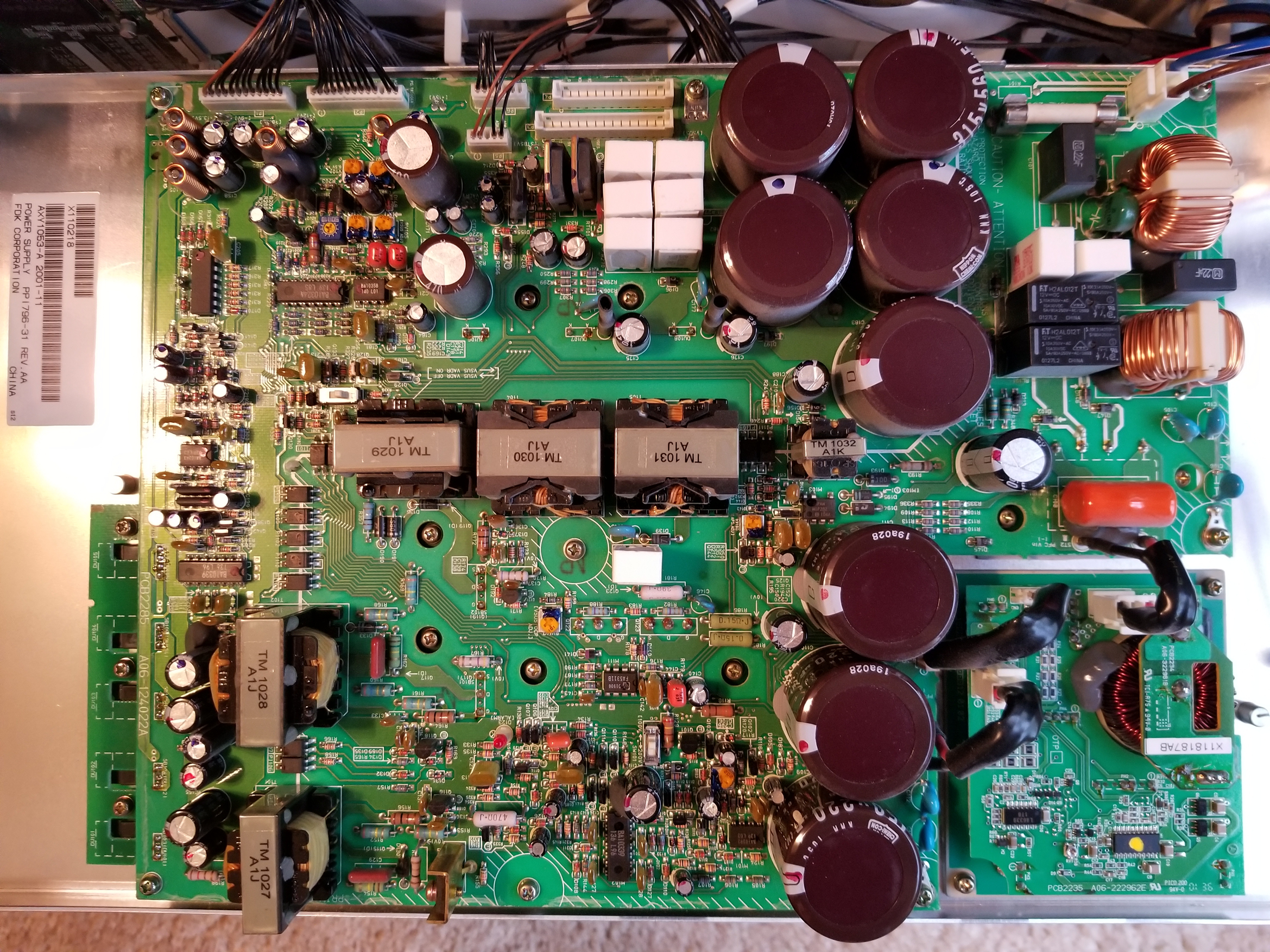

    can you please share a picture of the power supply?
      Re: Pioneer PDP-503cmx won't power on
      Hi-res Power Supply photo attached.

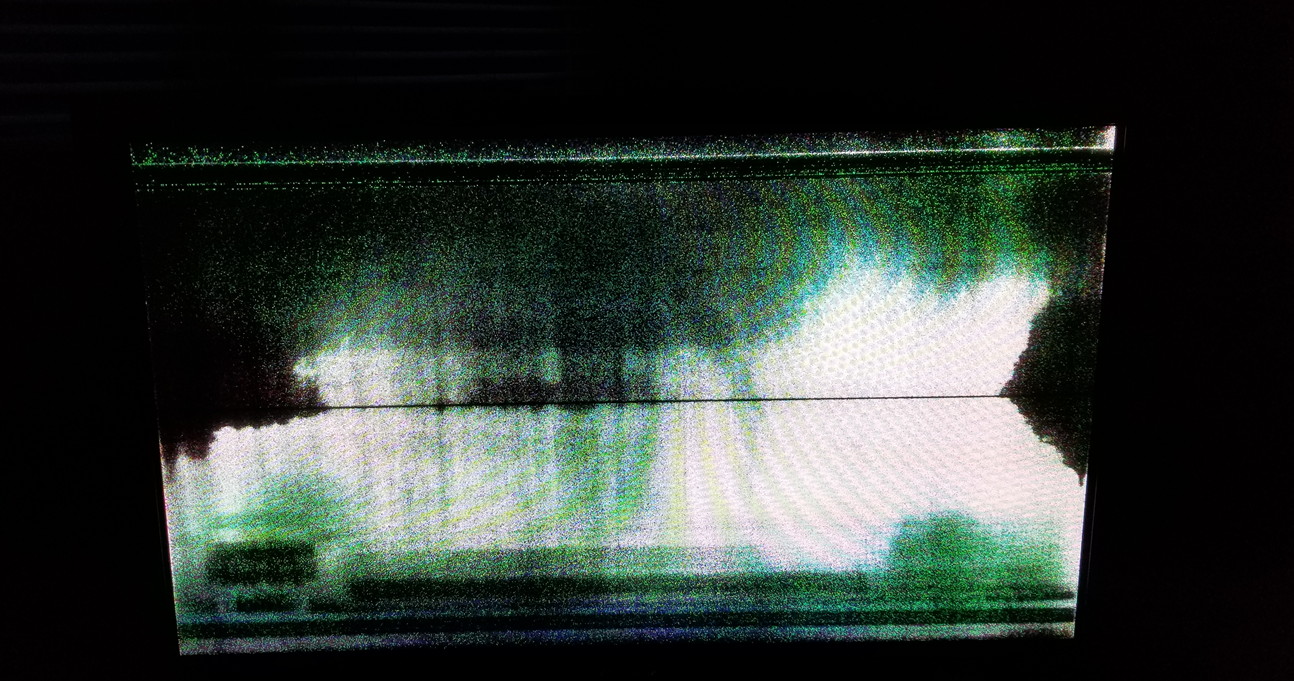

                          Got back around to looking at this set. Replaced the power supply (found one on eBay for $18) and it no longer goes into Power Down mode (protection). Now I get an ugly looking raster display - See attached picture. Is the panel shot or is this some kind of issue with the buffer?
                          Still not getting any blink codes at all (just solid Red LED in Standby and solid Green LED when turned On) and I was not able to successfully read anything via RS232 with my cobbled together USB>RS232 cable and adapters. There was no signal present on any connector when I took this picture.
                            Those destincive "lines" in the screen worry me to thinking buffer board fault. Is this the panel that has the drive cables fused to the buffer boards?
                            What is your y scan reading? Is Vsus coreect? How about Vadr?
                              Not sure, I'm going to dig into it tomorrow. The buffer boards sit under part of the frame, I'll have some disassembly to do to get at them. Between the Y drive board and the buffer boards there are two semi-flex cables that are more like sets of bent wires. No idea what's beyond that yet. Will post back.
                                After I removed the frame and gained access to the buffer boards, I can confirm that the buffers are indeed bonded to the panel.
                                The set is buzzing pretty loud when the raster is on the display so I didn't leave it on for long - I turned the set on, quickly took 2-3 measurements and then turned it off again.
