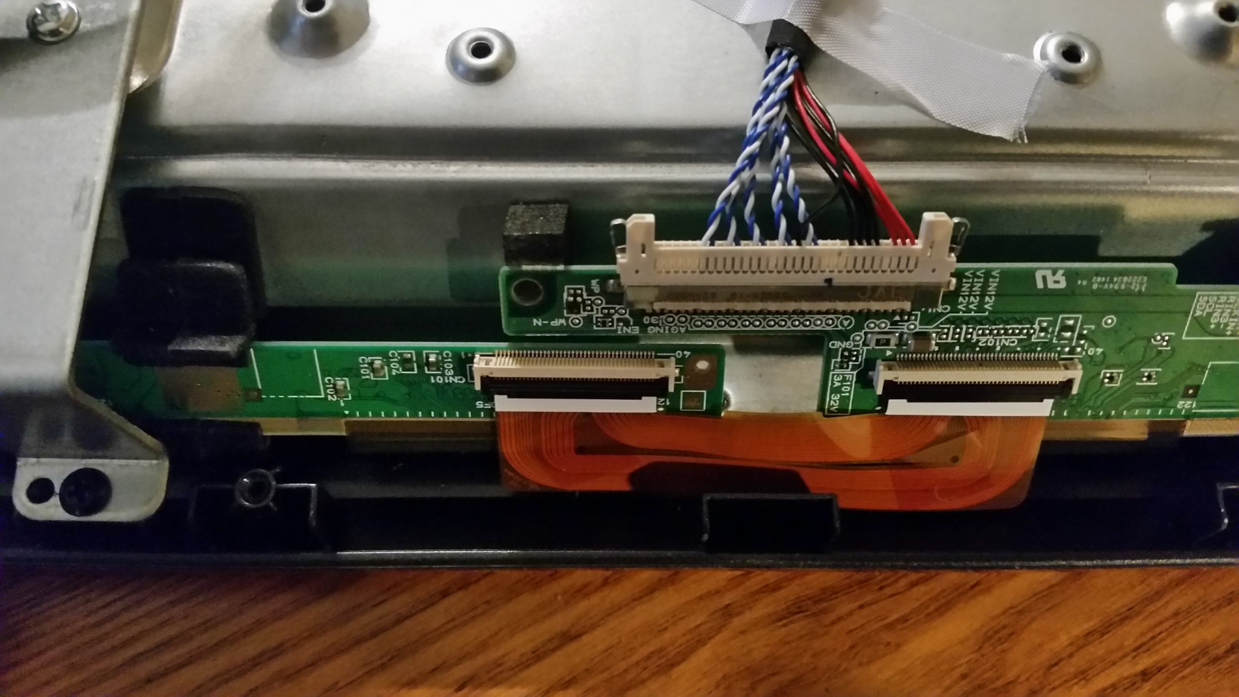

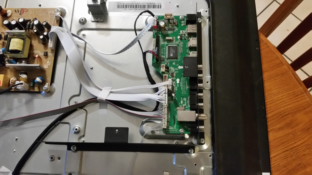

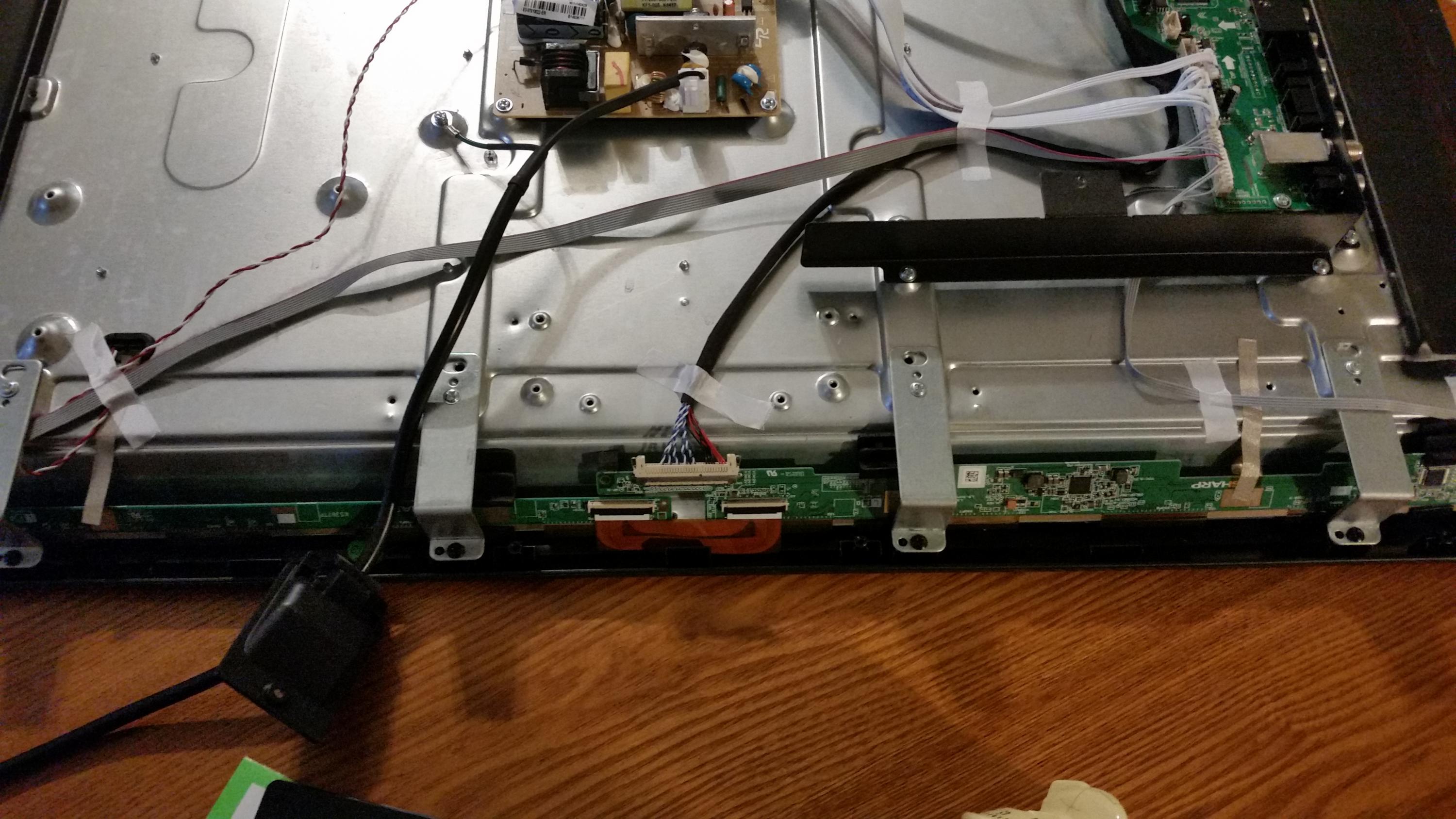

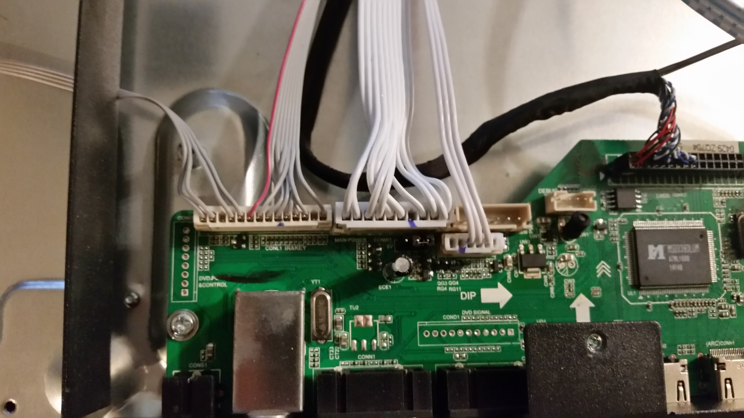

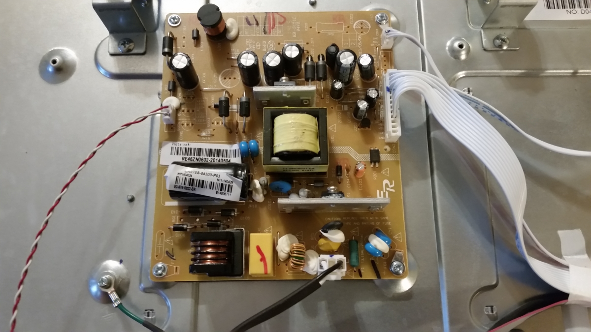

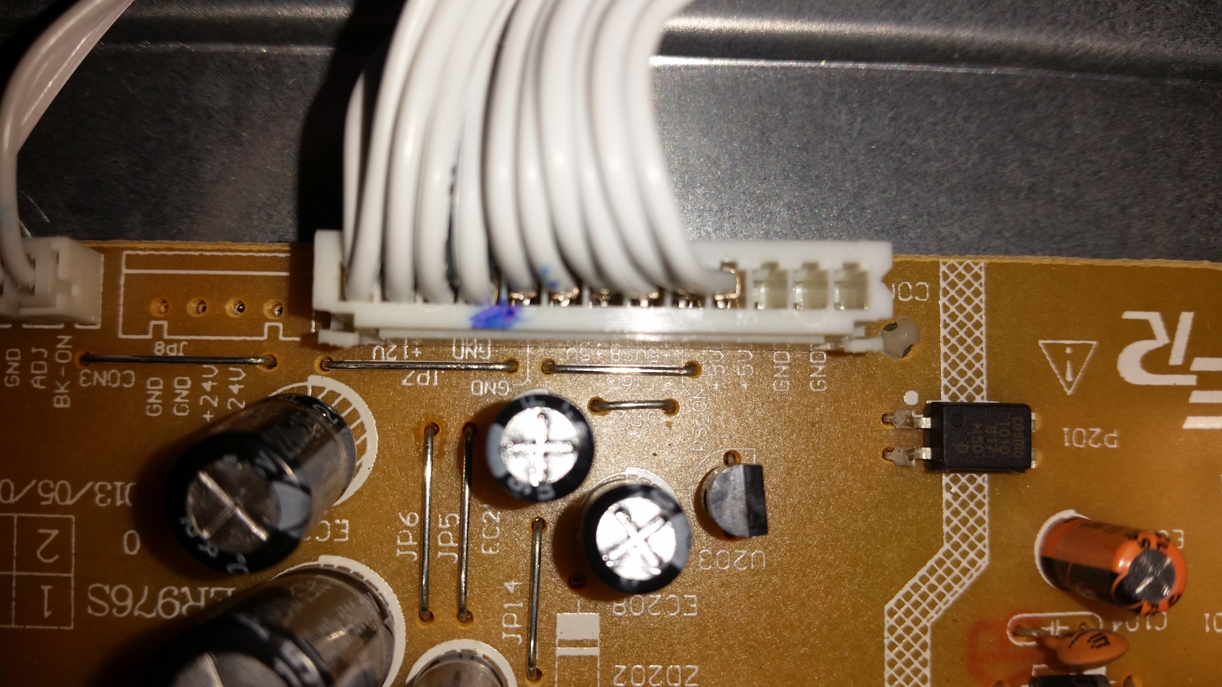

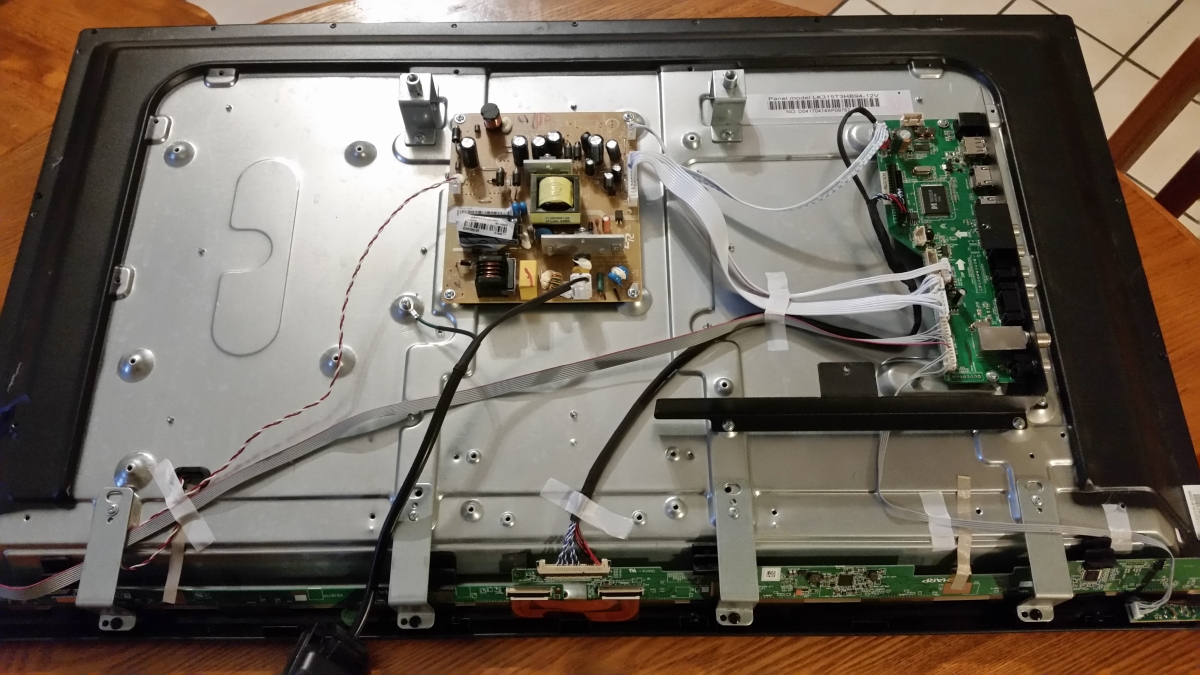

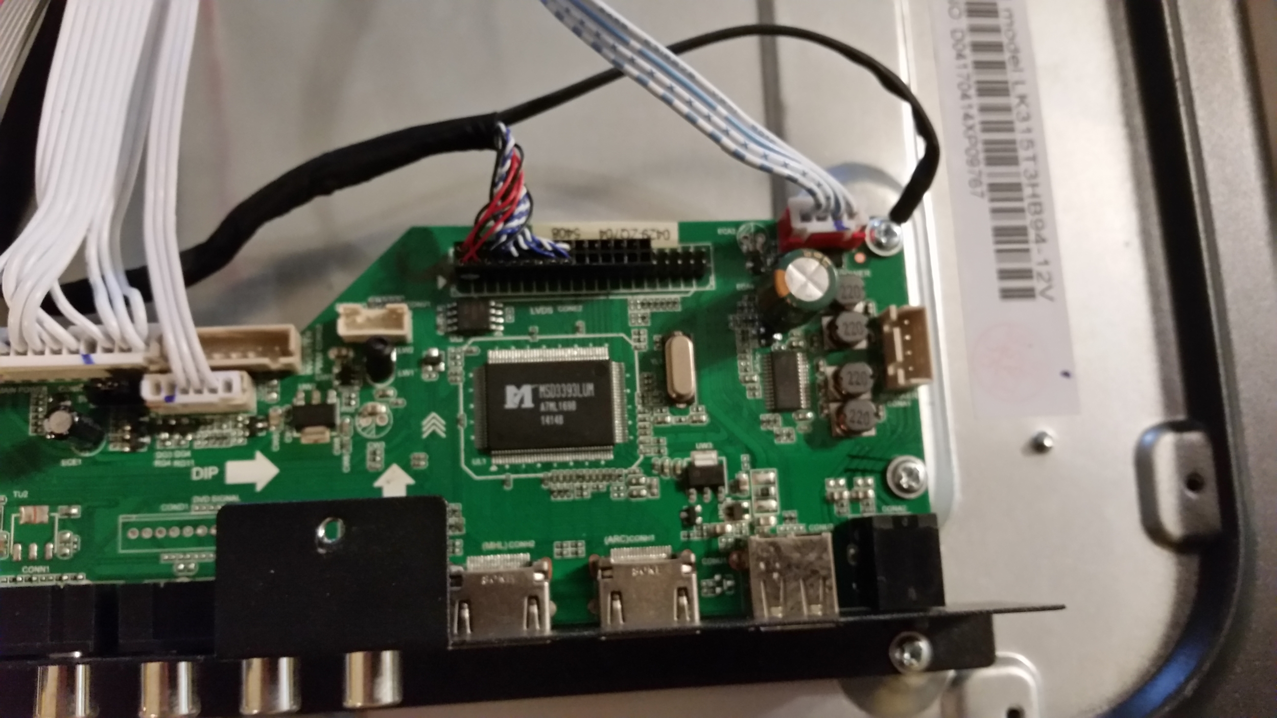

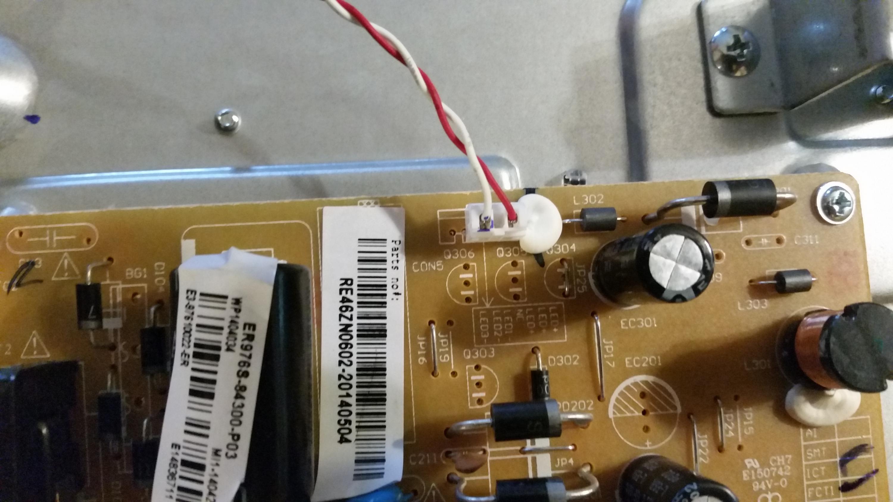

      Hi. I got pictures of the boards layout and the connections. Hope this helps.

        Here are my voltages for CON 2 , CON 3, and CON 4.
        For CON 2 (PIN 1, GND=-0.003) (PIN 2, GND=-0.003) (PIN 3, +5V=5.102) (PIN 4, +5V=5.101) (PIN 5, PS ON=4.538) (PIN 6, +5VSB=5.091) (PIN 7, +5V=5.102) (PIN 8, +5V=5.102) (PIN 9, GND=-0.003) (PIN 10, GND=0.001) (PIN 11, GND=0.001) (PIN 12, +12V=0.001) (PIN 13, +12V=0.001)
        For CON 3 (+24V=0.000), (+24V=0.000), (GND=0.000), (GND=0.000)
        For CON 4 (BK ON=0.08), (ADJ=4.858)
        So I'm not getting anything on my +12V or +24V pins. Where do I go from here?

                        Yeah. I think so too because I get voltages from PS ON and +5V SB. So what do you think could be wrong with the main board, EEPROM or an IC? What do I check now if it's not too much trouble. I'm cheap, I wanna fix the board, rather than buy another one.

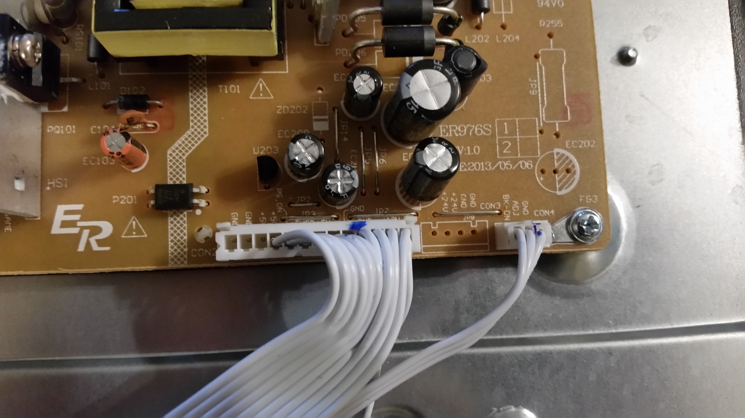

                            Hi. I don't know if I'm getting the labels of the pins right because there is a lot cramed together on this little board. I know I got the number of the pins right though. Here is a close up of CON 2 again, if anyone can tell me what the correct name for each pin 1-13 on CON 2.
