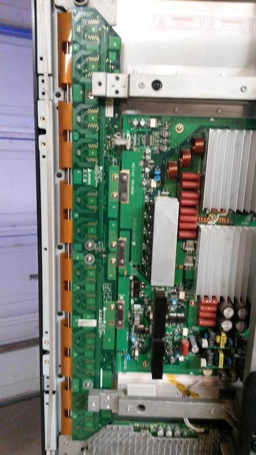

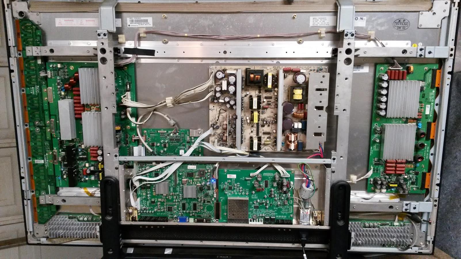

    Ok, I have been messing with this off and on for awhile. When I first got this tv it would not turn on.

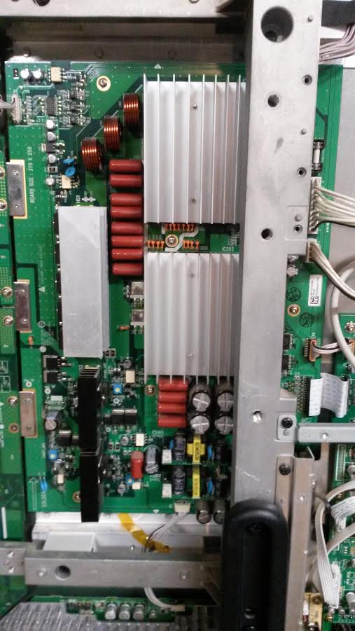

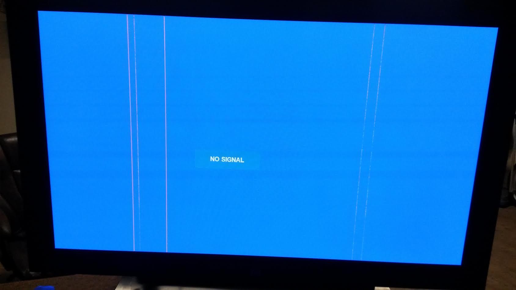

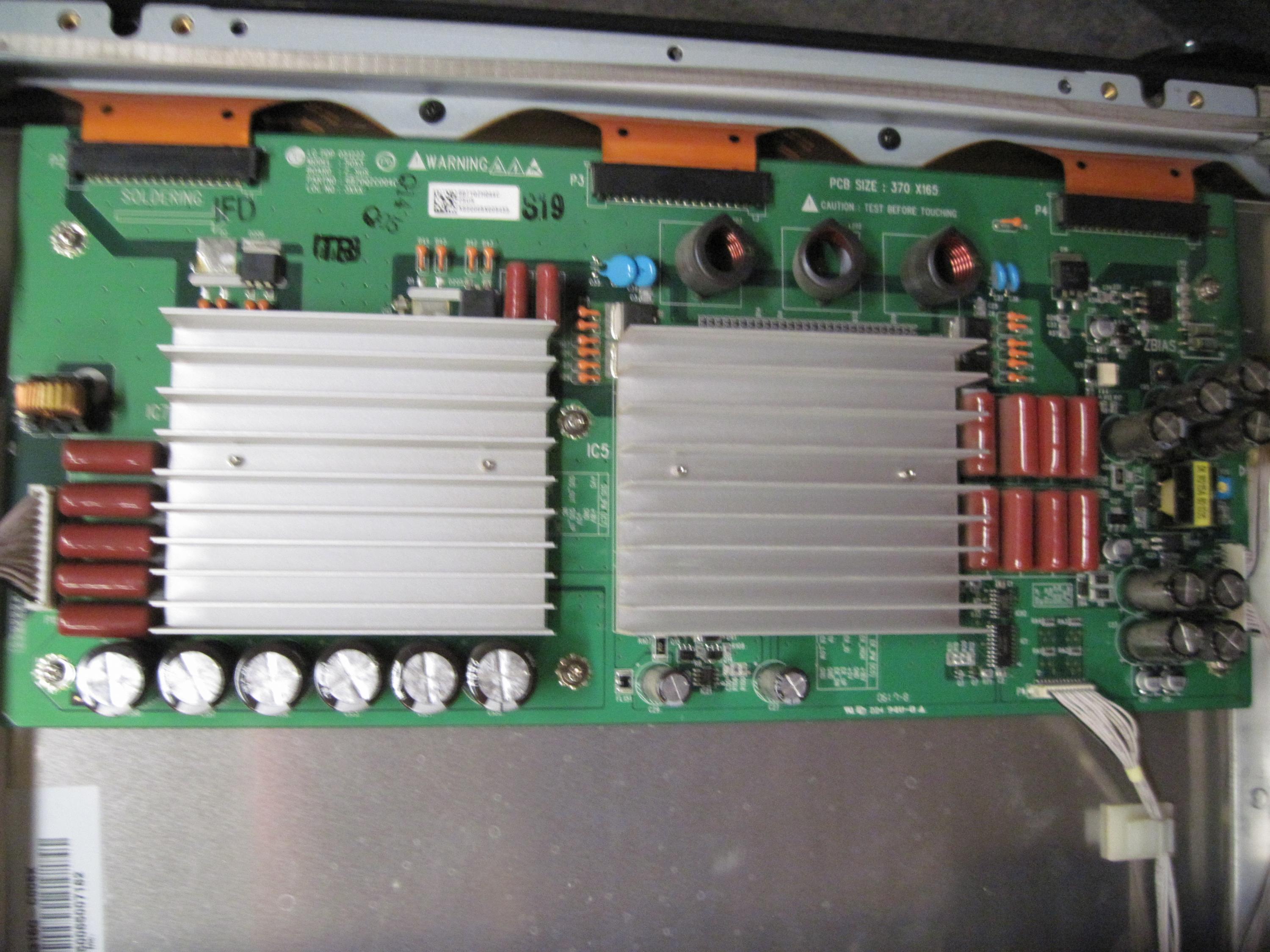

    I replaced the top IPM on the YSUS board, and a blown fet on the bottom Y Driver board. When I first powered it on everthing was fine. After a couple of minutes vertical lines appeared on the screen. The number of lines changes. Sometimes there are 4, then 6, then 8, then 5, etc. The lines kinda flicker. In the pic below there are 5 lines. Next time I fire it up there may be 4 lines, or 8 lines.

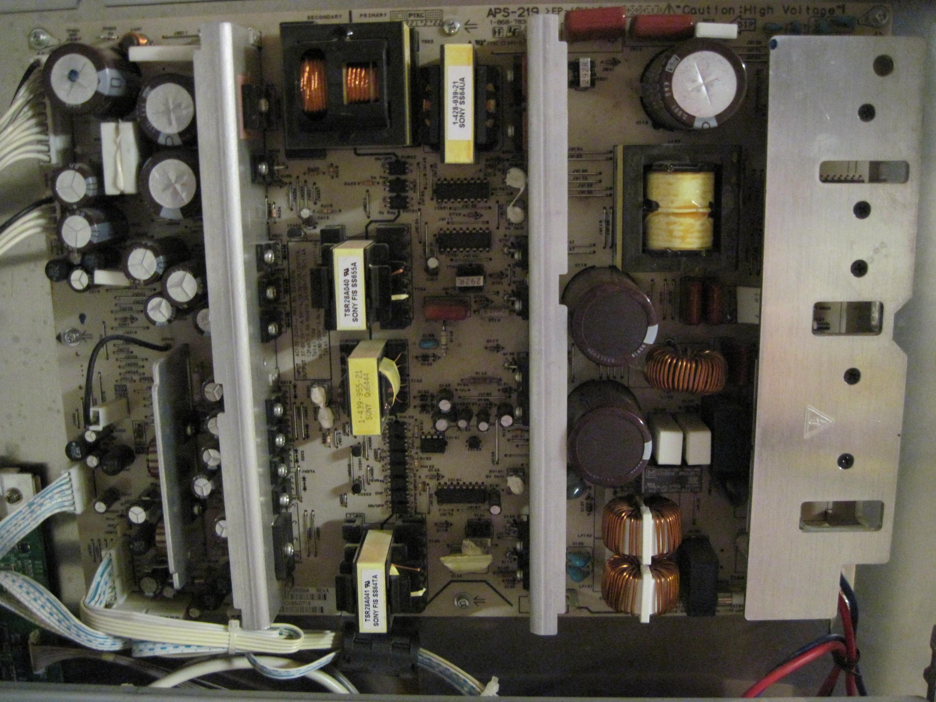

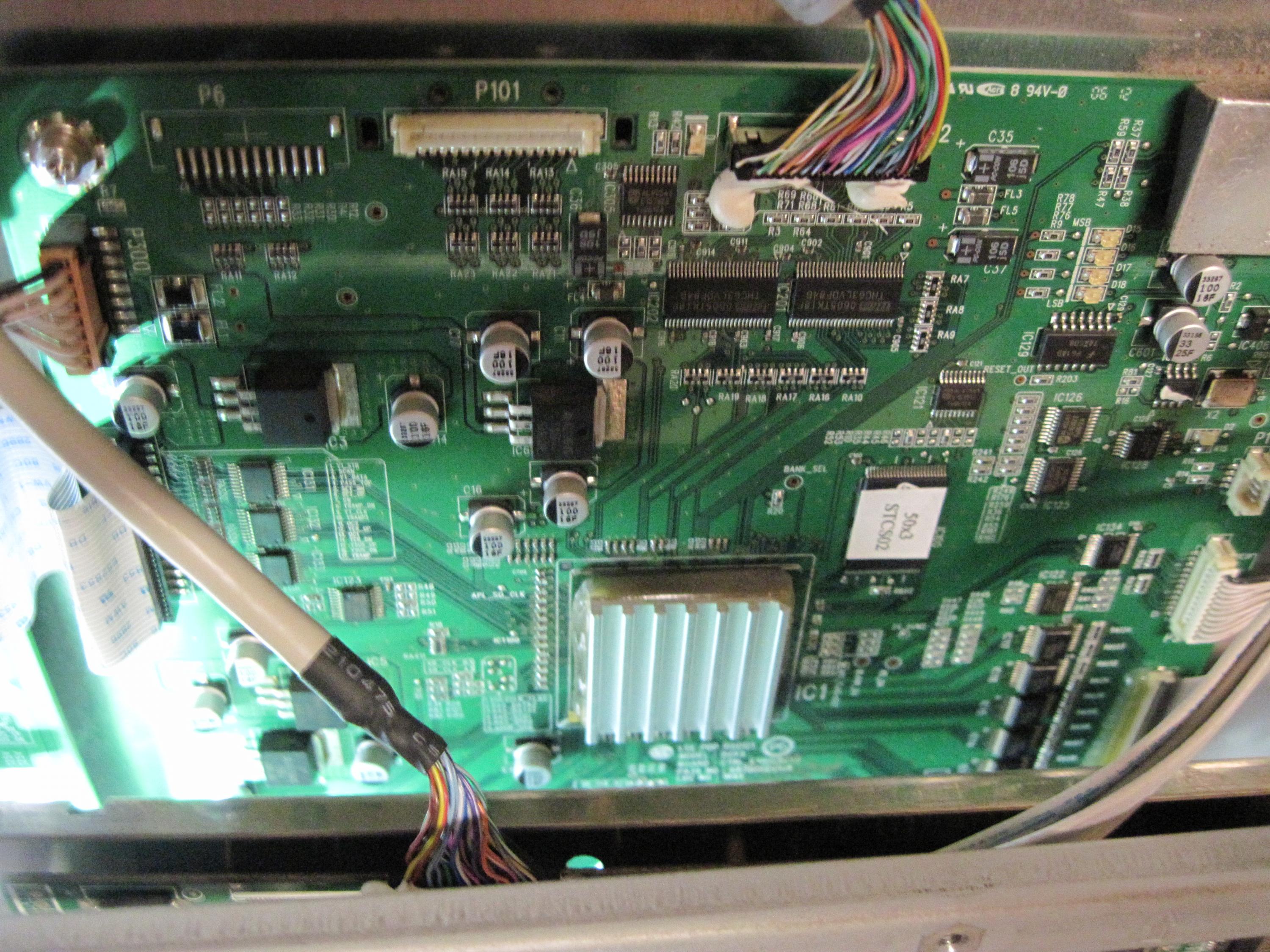

    I have checked all the voltages, and they are good. I cleaned all the connections. Cleaned all the ribbon cables that run from board to board. Cleaned all the ribbon cables on the XL, XC, and XR boards. Used freeze spray on just about everything on every board, and heated just about everything on every board with a hair dryer.
    I am now at a loss of what it could be. Any suggestions?

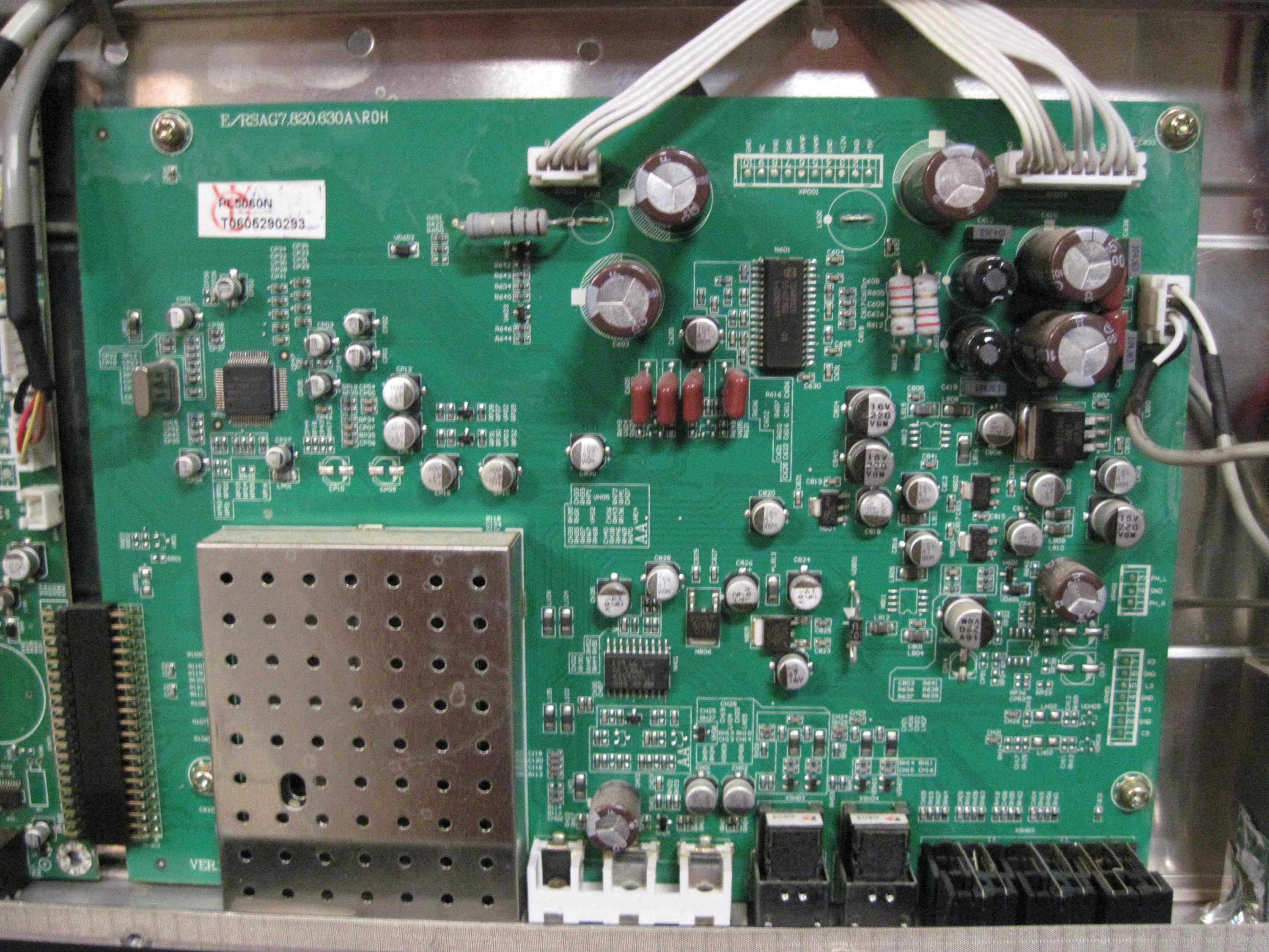

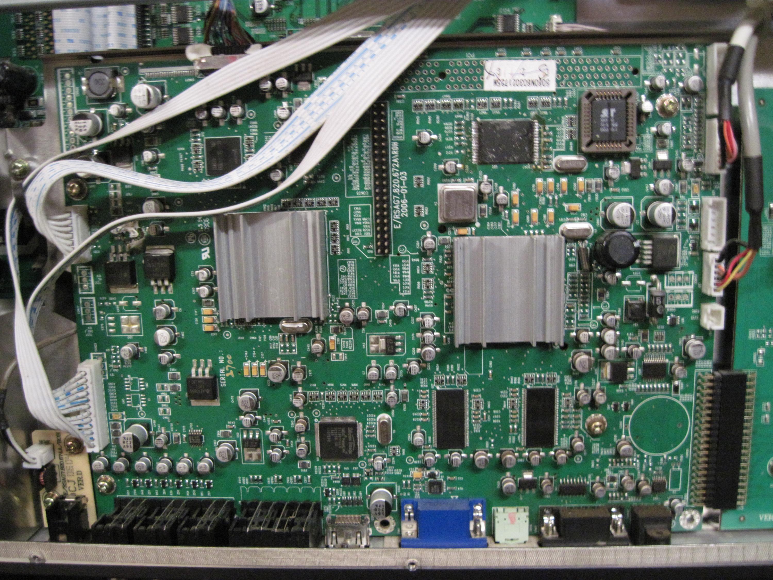

    If you need better pics of any of the boards, let me know, and I will get them.
    Thanks for any help.
  • Fisher77
    • Feb 2016
    • 229
    Re: HP PL5060N Lines On Screen

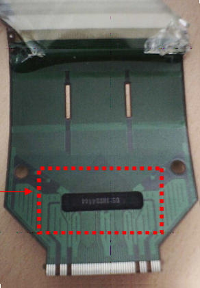

    Ok, I did some more checking and found that two of the TCP IC's are running hot right where the lines are.
