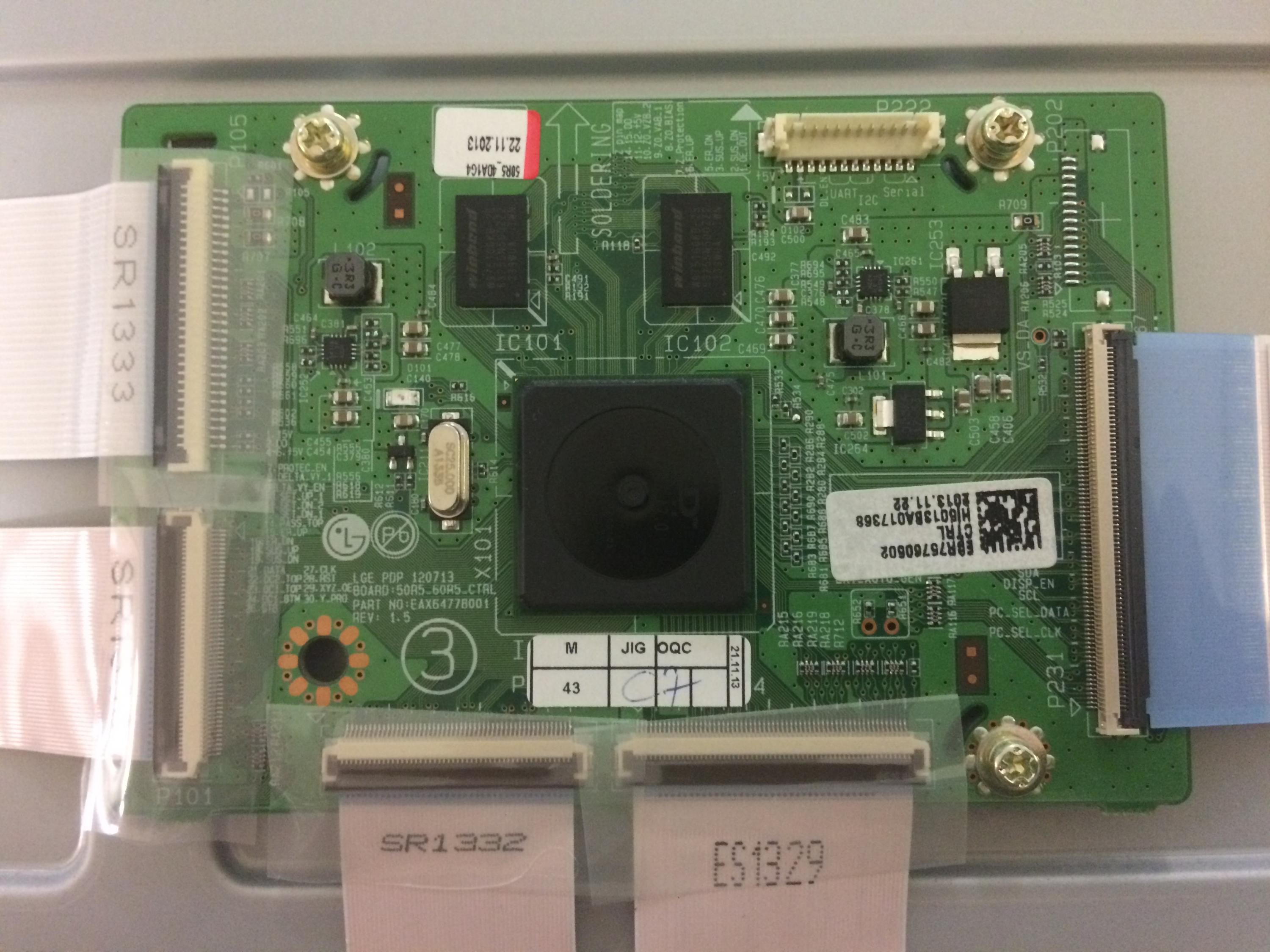

    This plasma LG 50PN650T start up with a white screen but goes black after one second.
    VS and VA stays on, sound is OK.
    I need either a service manual or info how to activate logic board test pattern.

    If my memory serves me correctly, shorting the 2 pads by R51/R52 and with the ribbon cable removed from the mainboard to run the self test.

        I could not get it to enter logic test mode by shorting those pins and removing ribbon from mainboard.
        The green led on logic board flashes in a special pattern possibly indicating a failure.
        So for now I cannot tell if the failure is logic and/or Y-SUS.
        The symptom looks like the classic 50PK650 failure with the open 22R power resistors. In this case, it's not the same chassis nor the same kind of powersupply. And in this set, VA and VS stays on.
        A bad Y-SUS tend to not produce any picture at all, this turns white directly after start-up, but is shut down the moment after.

          Since the Va and Vs are constant we could say the PSU is OK. Since the Vs is good then I would think the Y-sus and Z-sus are OK. The Logic Bd in my mind is your fault. Replace the Bd and your set will work again.

              Re: LG 50PN650T sound but no picture
              Logic board replaced, issue remains.
              Could not activate testmode, probably another procedure.

                Is it the correct Logic board. I cannot quite read the EBR number from your photo but the last few digits look like 60602
                Spares2Repair list the last digits as 60502
                https://spares2repair.co.uk/lg-50pn6...50r5-60r5-ctrl
                • PowerAmpFreak
                  • 982
                  • Sweden
                  Yes, both P/N match. They both are EBR75760502

                    Do you have the other supplies Vsc, -Vy, Z_Bias and is +5V on the Logic board

                        +5V is present on logic. I guess this fault is somewhere on Y-SUS and I will dig into the supplies to see all are up.
                        It seems like Y-SUS itself are turning off due to some protection.

                          Success!
                          I found a shorted UF4006 diode on the YSUS board in the floating supply section.
                          Now works nice again!
