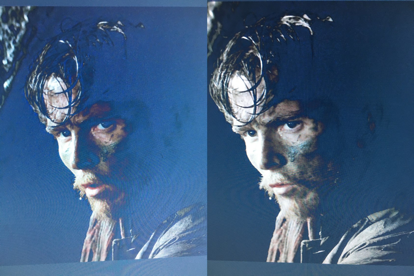

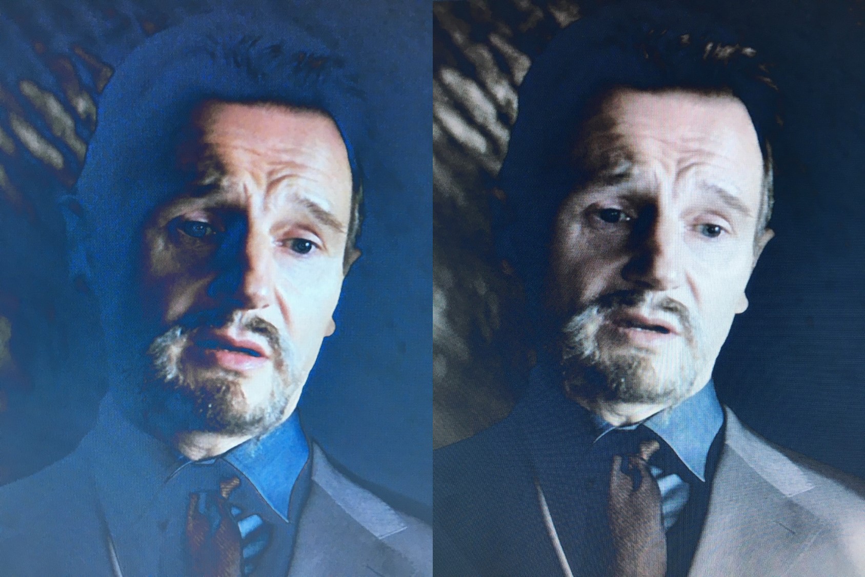

    So I "acquired" one of these for free the other day and it's working but has a pretty bad picture. I put a blu ray movie to it using HDMI and skin tones look reasonable but the shadows / darker areas not so much... Attached are two images. Left on each is with all settings at 50% and right is with contrast cranked to 100%. I noticed on the settings menu that there's all sorts of pre-set (cinema, soft, bright) and the "bright" seems to look the "best" but is still off.
    I'll get the back off and begin a visual inspection tonight but in the mean time had a general question about what area the signal processing would go bad like this.
    Thanks as always for your guidance.

    Re: Polaroid TLX-04244B Image Quality Question
    Gamma problem. Pretty sure your t-con board has the as-15 chip which is a common failure. You can replace chip or t-con depending on your skill level.

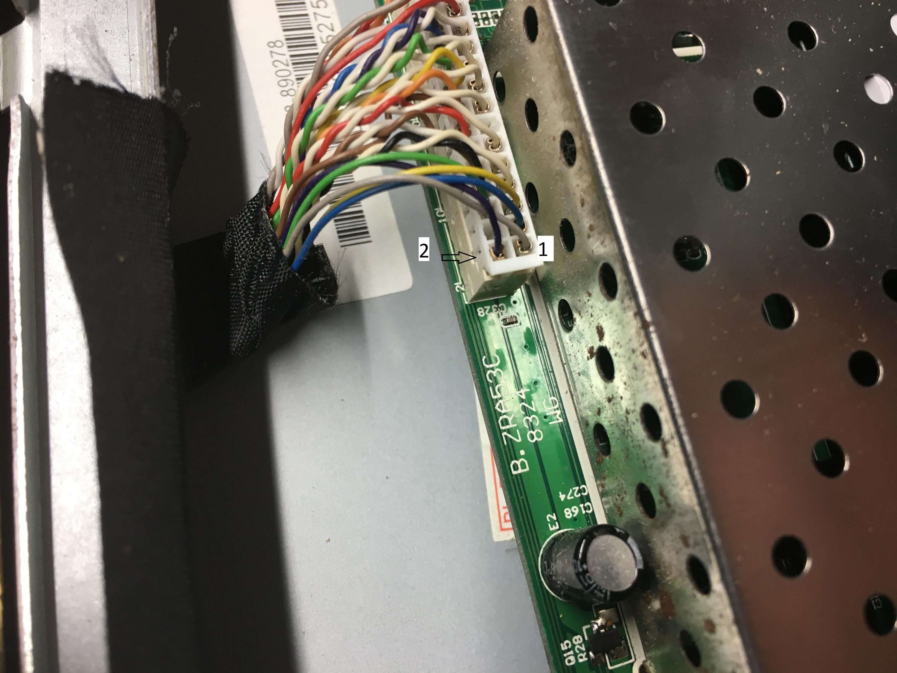

              Okay I hope I've got this right... see close up of connector. I marked up what seems to be pin 1 and it looks like they go back and forth from side to side instead of up one side and down the other...
              01 = 12.01
              02 = 12.01
              03 = 12.01
              04 = 0.007 (there's no wire there?)
              05 = 0.007
              06 = 0.007
              07 = 1.491
              08 = 1.115
              09 = 1.531
              10 = 1.144
              11 = 1.443
              12 = 1.146
              13 = 0.008 (there's no wire there?)
              14 = 0.008
              15 = 1.279
              16 = 1.332
              17 = 1.495
              18 = 1.098
              19 = 1.511
              20 = 1.127
              21 = 1.517
              22 = 1.128
              23 = 1.463
              24 = 1.170
              25 = 0.009
              26 = 0.009 (there's no wire there?)
              27 = 1.247
              28 = 1.302
              29 = 1.503
              30 = 1.118 (No connector over these)
              31 = 0.003 (No connector over these)
              32 = 0.003 (No connector over these)
              33 = 3.28 (No connector over these)
              34 = 0.001 (No connector over these)
              35 = 3.31 (No connector over these)
              36 = 3.30 (No connector over these)
              37 = 0.001 (No connector over these)
              38 = 0.001 (No connector over these)
              39 = 0.001 (No connector over these)
              40 = 0.001 (No connector over these)

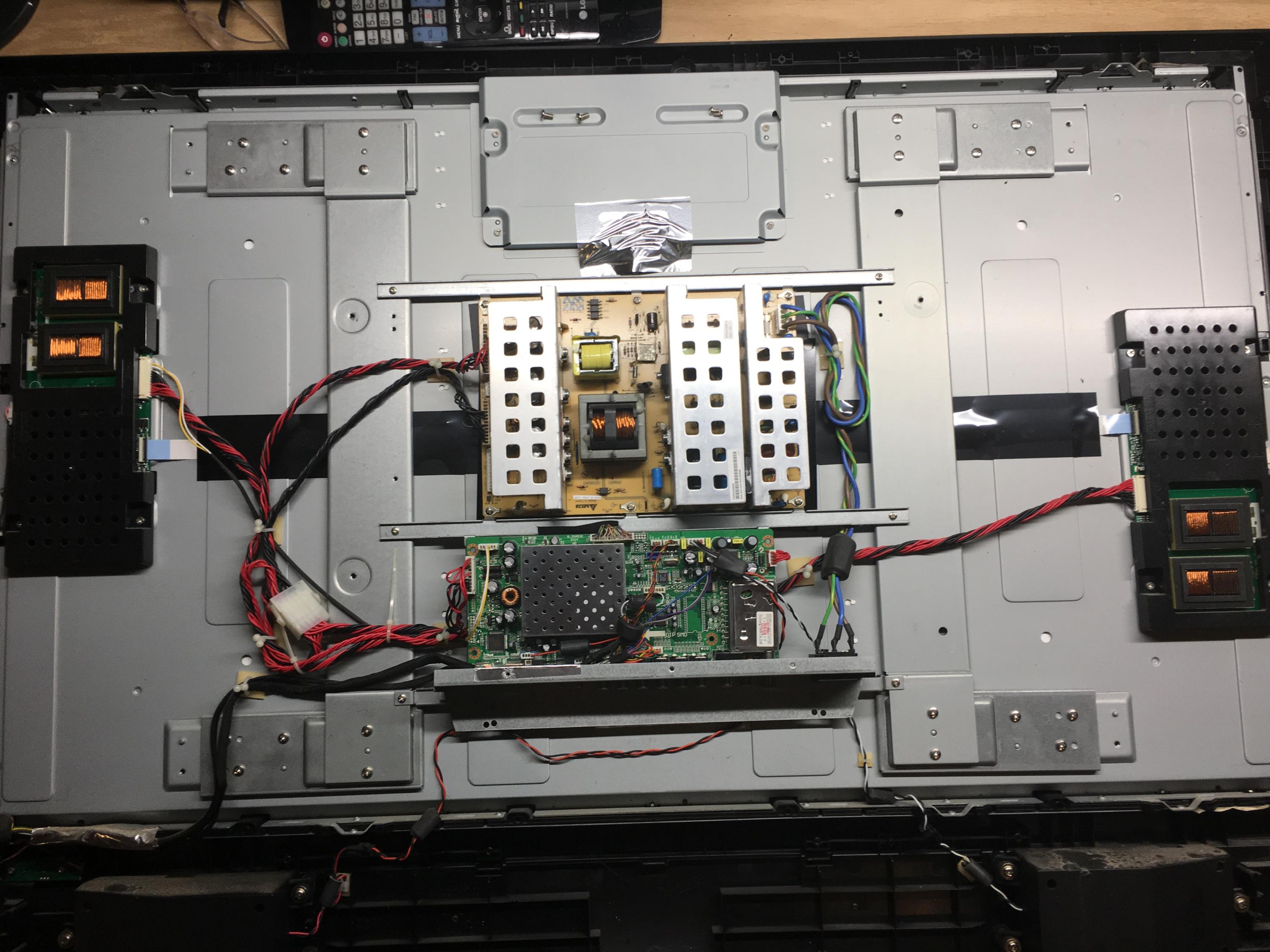

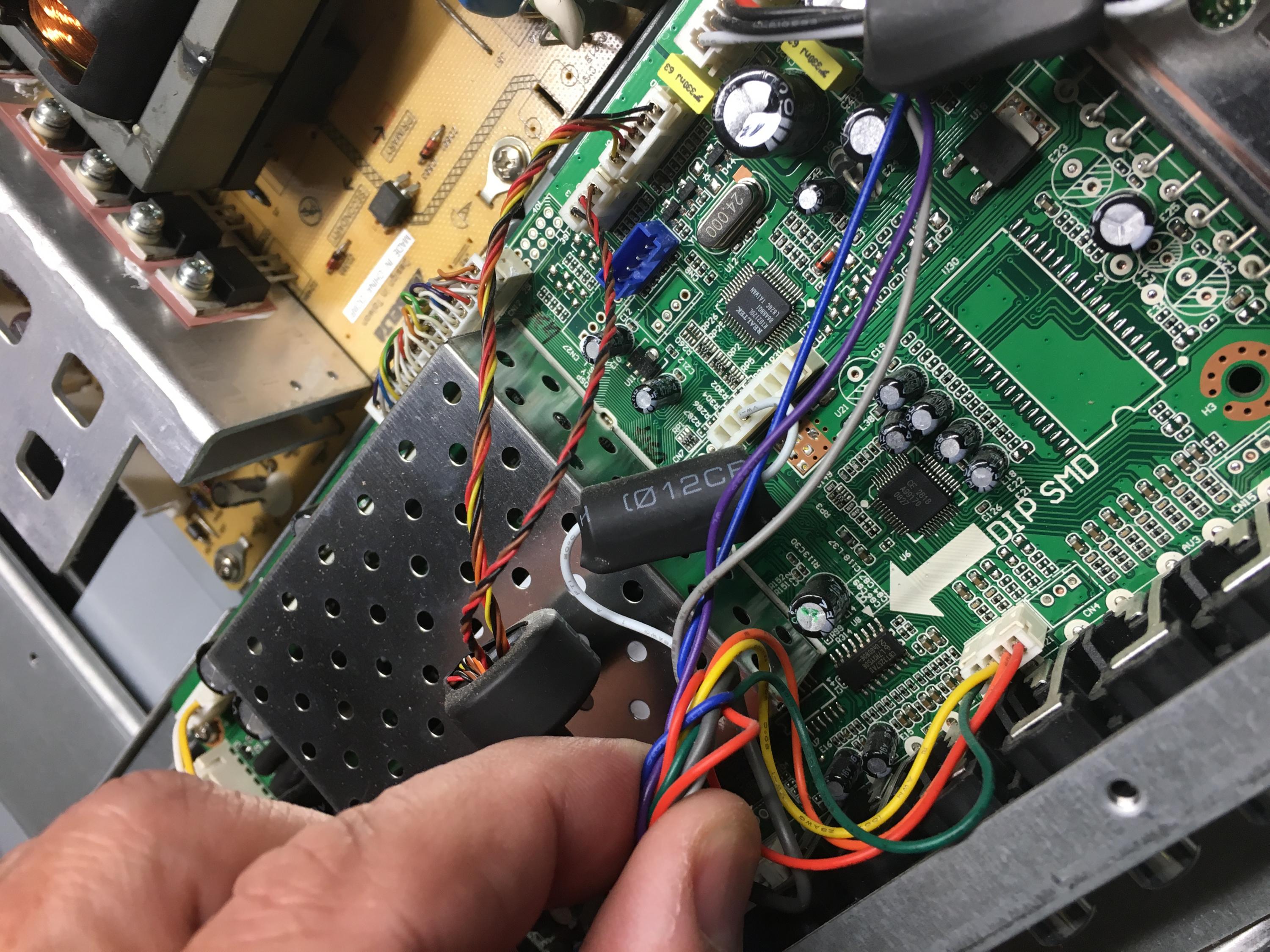

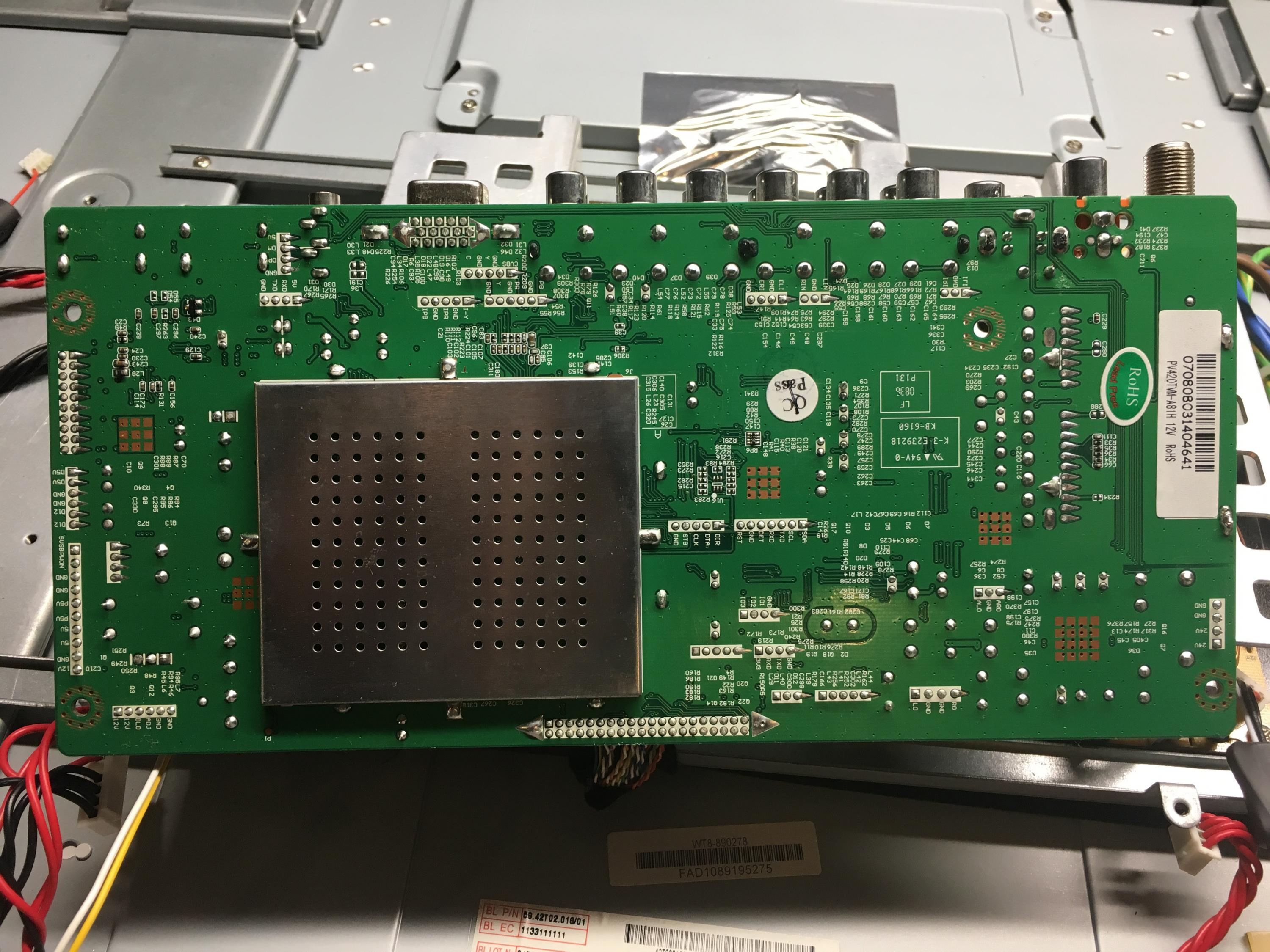

              Pic's are:
              Overview
              Close ups of main board including mark up of connector and what I think ya'll are calling the AS-15... tell me it's not the one under the heat sink rubber thing on the Control board please (anyway that one had no markings on it).

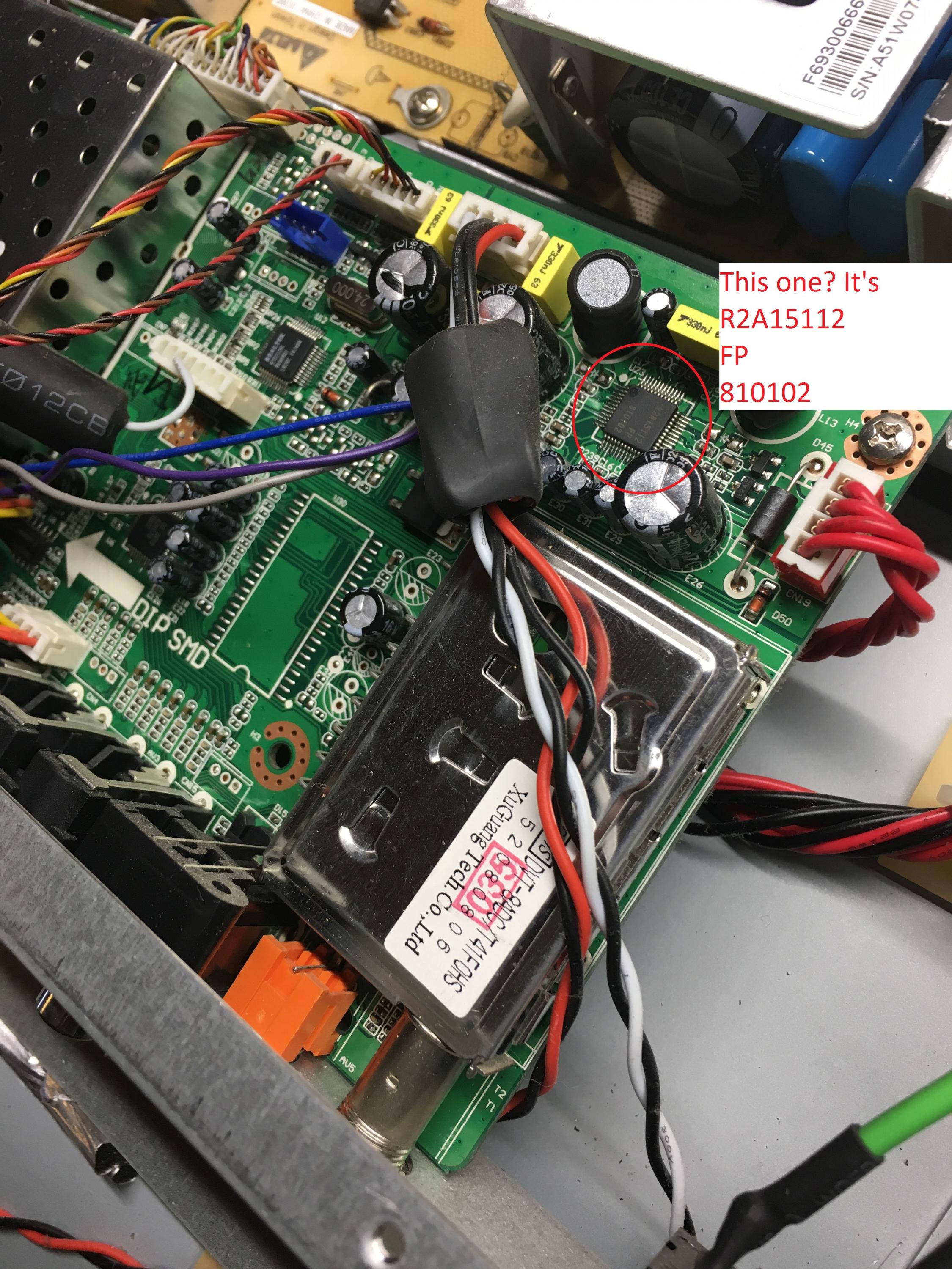

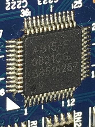

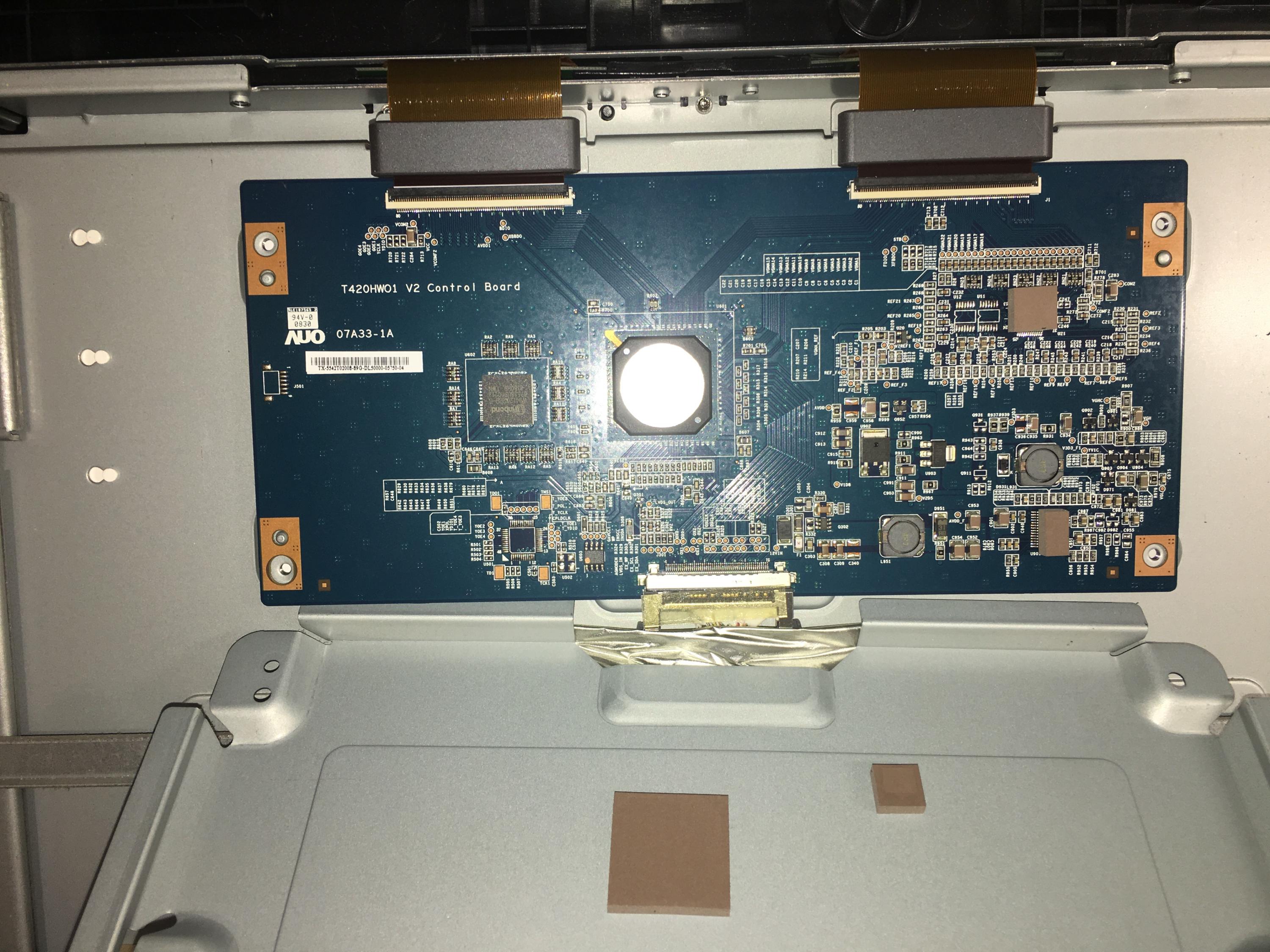

                Last picture t-con board. Upper right under brown heat sink material. What is that chip number? Also right there you have about 22vgma test points. Need all those in order. Or you can plug them in here
                • jwillifixit
                  • Apr 2017
                  • 113
                  • usa
                  As15-f
                  0831cg
                  b8516257
                  1 = 14.05
                  2 = 13.90
                  3 = 13.75
                  4 = 11..07
                  5 = 10.90
                  6 = 9.95
                  7 = 9.40
                  8 = 9.13
                  9 = 11.70
                  10 = 12.00
                  11 = 6.85
                  12 = 6.20
                  13 = 6.10
                  14 = 5.90
                  15 = 4.41
                  16 = 4.16
                  17 = 3.83
                  18 = 2.86
                  19 = 2.19
                  20 = 0.53
                  21 = 0.43
                  22 = 0.29
                  • dskall
                    • Oct 2016
                    • 2905
                    • usa
                    Looks to me like a bad gamma chip. Readily available if you have the skill to replace it.

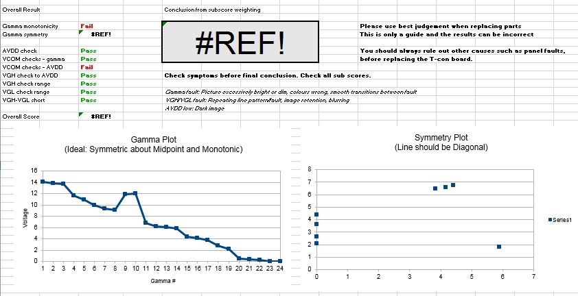

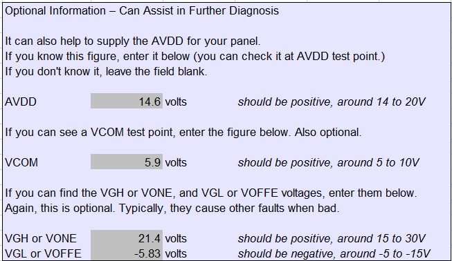

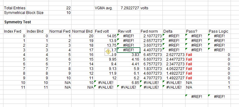

                          I added the "optional information" to the excel file. I couldn't find a test point for VCOM but did find VCOM2.
                          It looks to me like this chip is a Fail but I'm having some issues with the sheet and wonder if others are seeing this same thing. See images...
                          Summary doesn't populate with a Pass or Fail just shows a #Ref
                          Detailed Results shows quite a few #Ref and #Value
                          Thanks... I'm sure looking forward to getting my hot air station.
                          • dskall
                            • Oct 2016
                            • 2905
                            • usa
                            Your basic voltages look good but your gamma voltages are bad giving you the bad picture. If you scroll to top of page it will give results. As they say this is not 100% accurate

                                  pins 9 and 10 look like the faulty area i have never changed one of these ics yet but have a few spare tcons so may have a practice as i do have a hot air station etc
                                  • jwillifixit
                                    • Apr 2017
                                    • 113
                                    • usa
                                    As can be seen in post #9 there clearly were markings on that IC... what kept me from seeing them was the adhesive from the rubber heat sink pad.
                                    Here's a question - the surface of that pad that was "glued" to the IC is now not smooth and flat and also has no "stick" left to it. I assume I can use the thing on the replacement IC by simply turning it over but what type of adhesive should be used to bond it to the IC?
                                    • vinceroger69
                                      • Mar 2012
                                      • 6714
                                      • uk
                                      heat sink compound like used on computer cpus? im not sure but dont see why it wouldnt work
                                      • jwillifixit
                                        • Apr 2017
                                        • 113
                                        • usa
                                        The first reason that comes to my mind is "gravity". Unless this pad is being held in place by compression with the cover shield I'd say it would simply slide off the IC once the TV is stood up.
                                        I think it needs to be some kind of contact cement I just wasn't sure if it needed to be anything "special".
