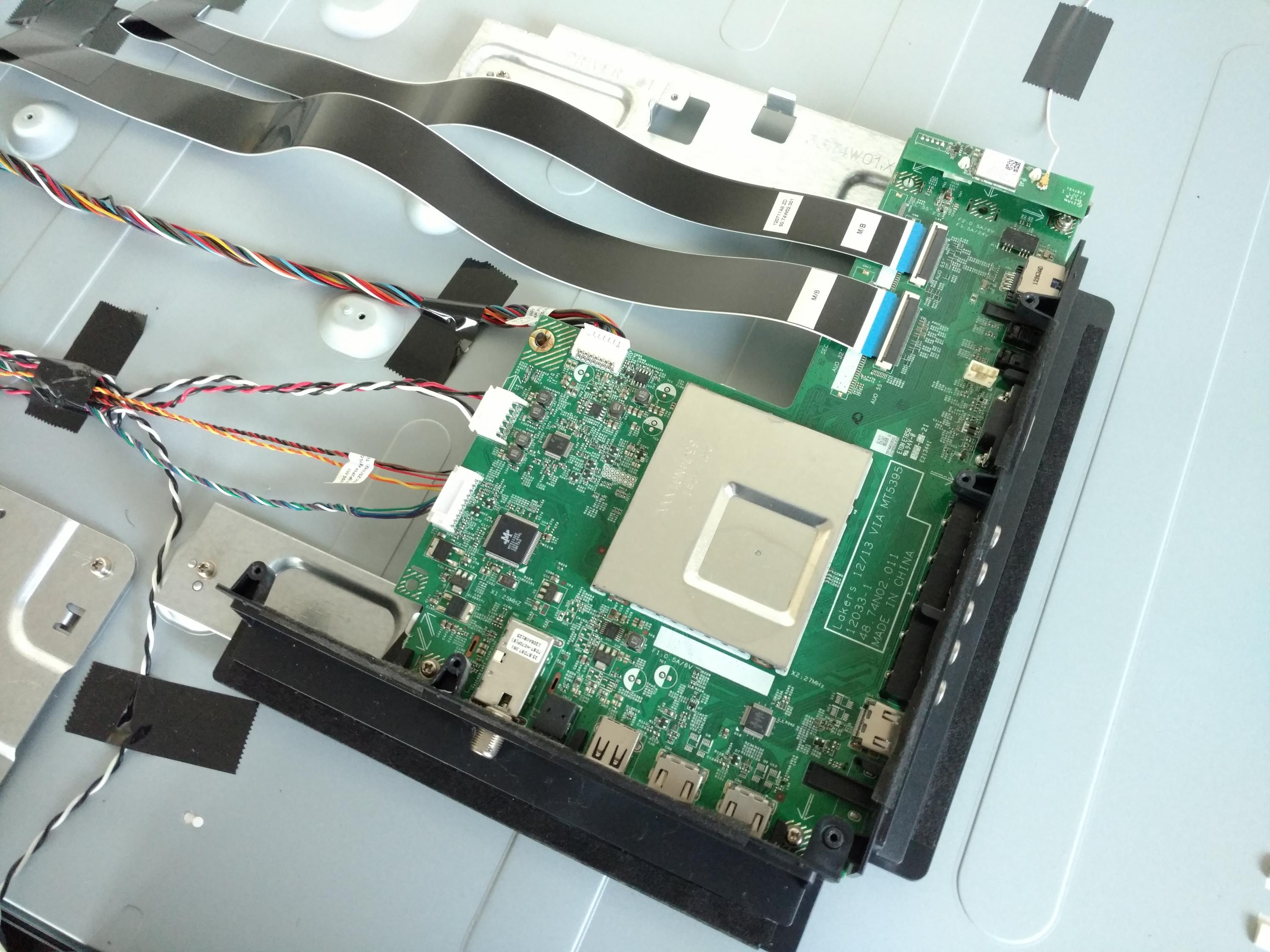

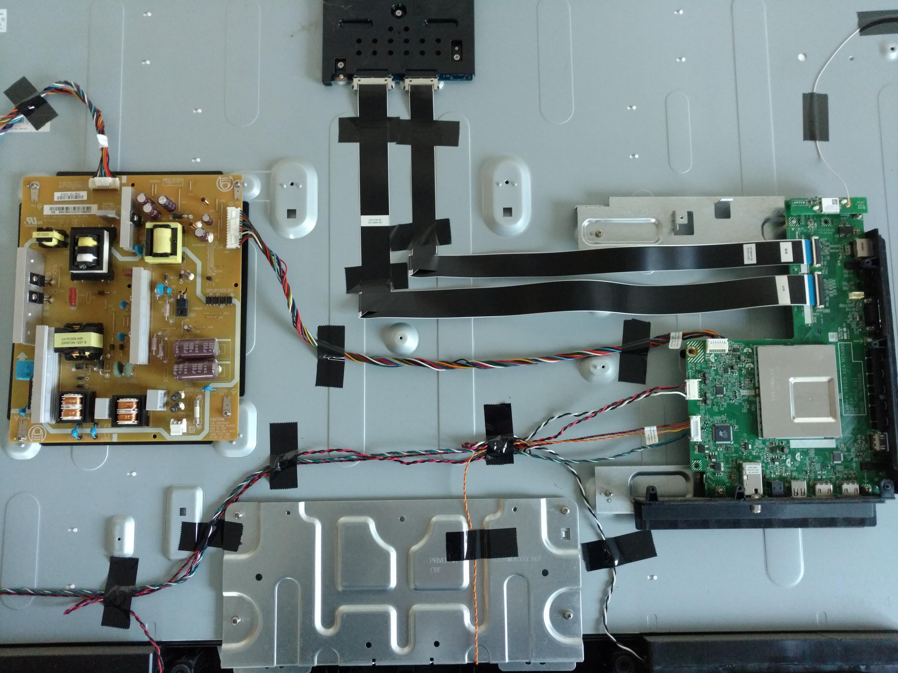

    This is one headache of an LCD. If anybody else is trying to get into one of these things, the stand has to be unscrewed from the bottom and removed before the back panel can come off .
    Anyway, the reason I've cracked into this thing is because it powers on and displays the splash screen, but then the panel and backlights shut off (nothing on screen at all; I checked with a flashlight) after a couple seconds, at which time the VIZIO at the bottom lights up white very brightly. It stays this way until the power button is pressed again, at which point the cycle repeats once more (brief display of splash screen, bright VIZIO).
    Do these models shut themselves off like this if the backlights are bad? If not, what would likely be the problem? What does the bright white VIZIO mean?

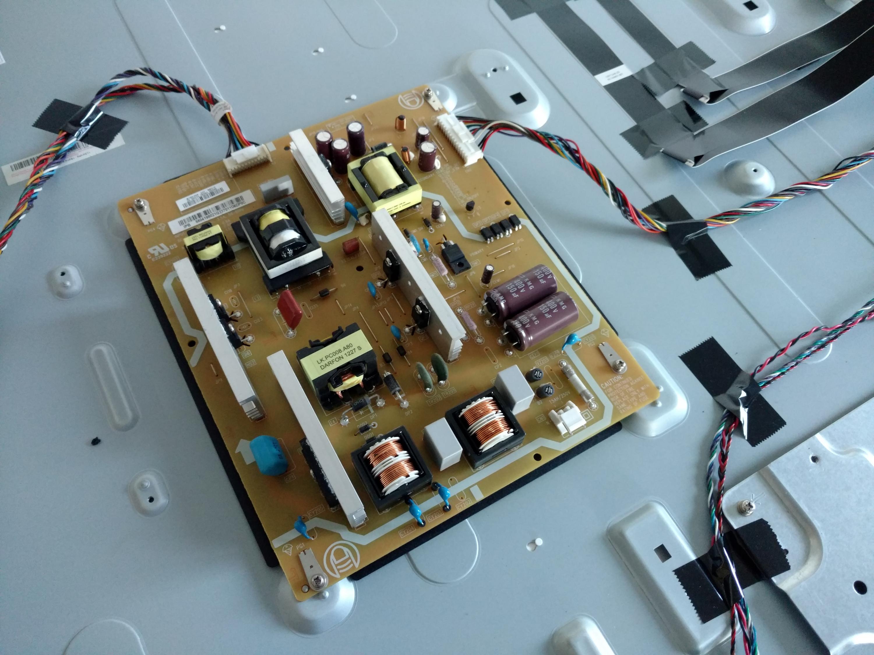

    Have you tried disconnecting the main board and bringing up the leds to ensure you don't have a led fault.

        Mainboard and backlight troubleshooting
        I hadn't. Would it just require the jumpering of some connections on the power supply in order to do this?

          Re: Vizio E502AR LCD television powers on, then shuts off with a bright VIZIO
          With the main board disconnected some power supplies will bring on the backlights when powered up otherise you will need to jumper using 1K resistor STBY_3.3V to PS_On pin and possibly a second 1K from STBY_3.3V to BL_ON/OFF.

            Mainboard replacement fixed the problem!
            Mainboard was indeed the cause of the issue. Everything is back 100% after replacing it.
