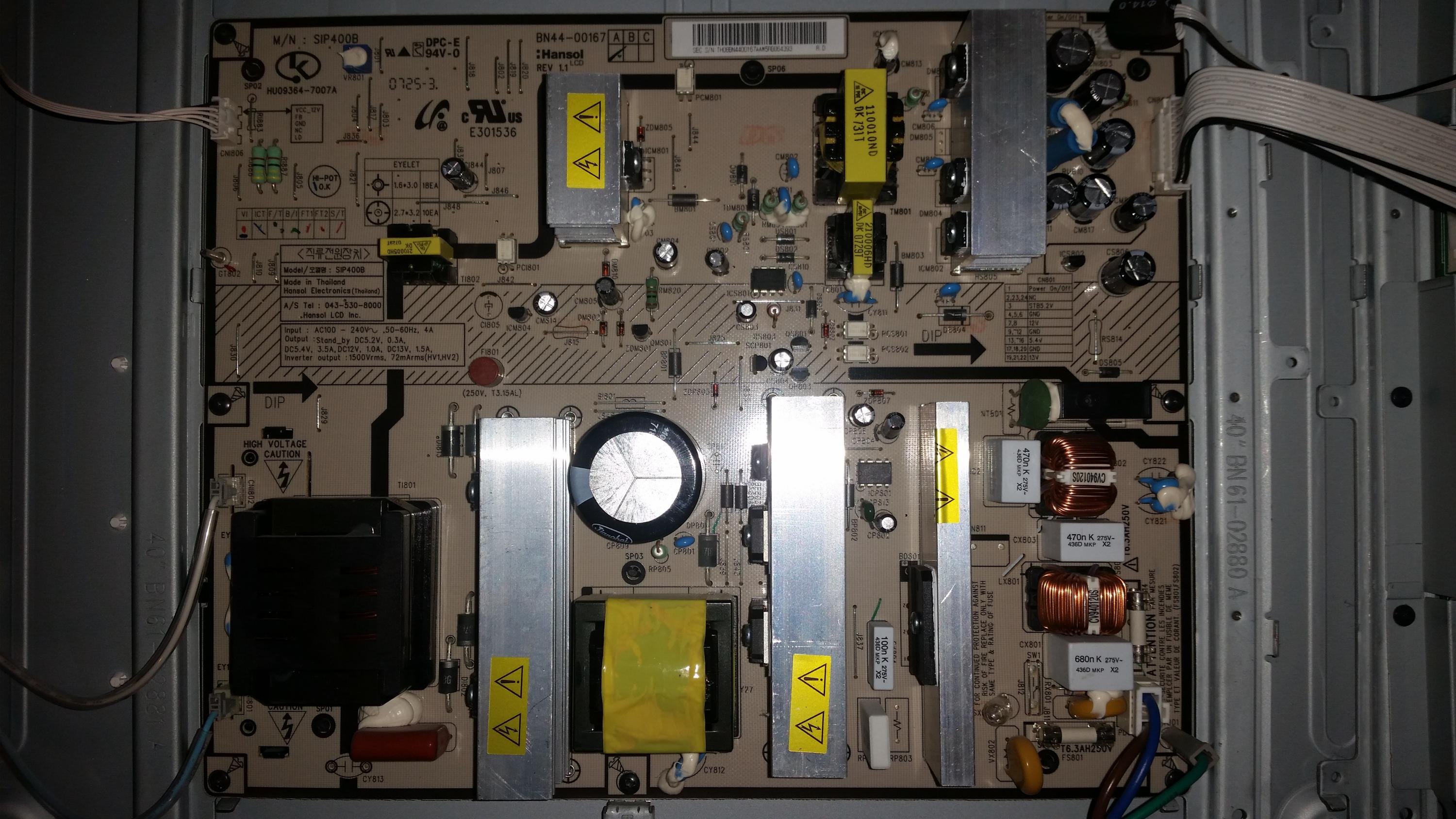

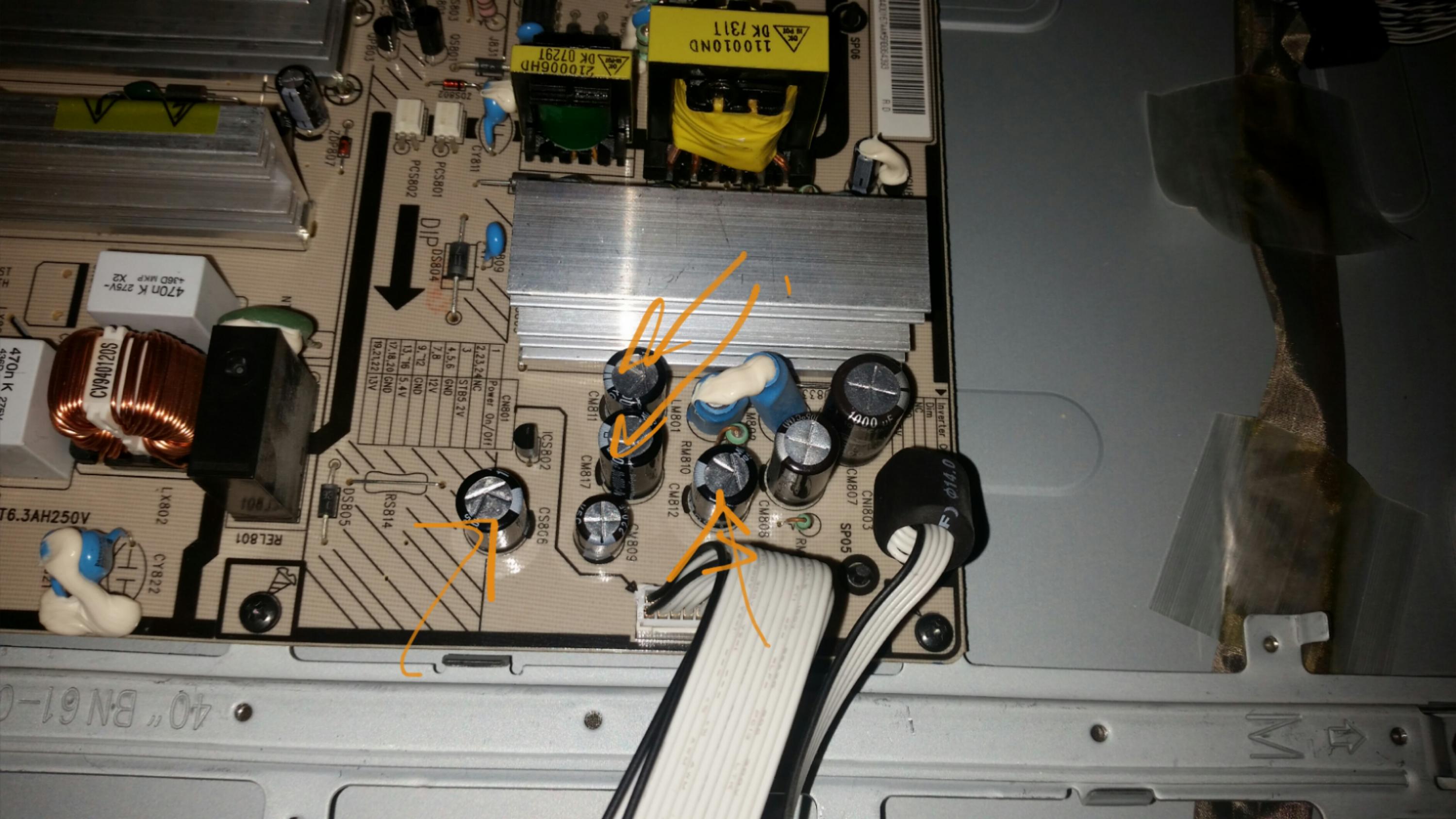

        • engelwood39
          • Mar 2015
          • 93
          Re: Samsung ln-t4061f stuck in rebooting sequence
          When I unplugged the T-con it didn't change anything.

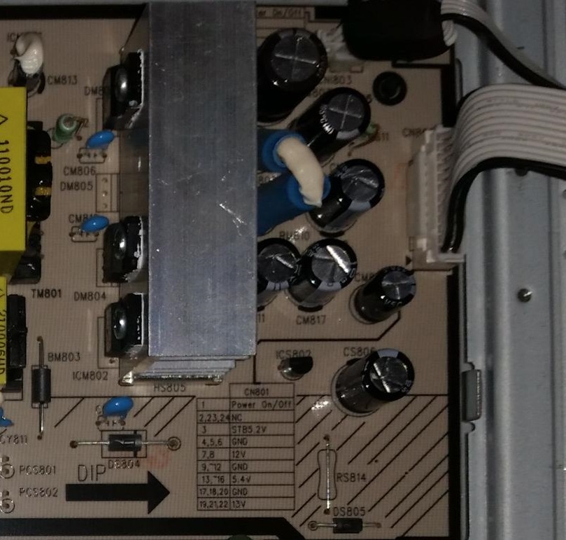

          Here are the pics. I put yellow arrows to the caps that I replaced with these caps:
          http://www.ebay.com/itm/172024725260...%3AMEBIDX%3AIT
            Check rectifiers on cold side around where you changed capacitors

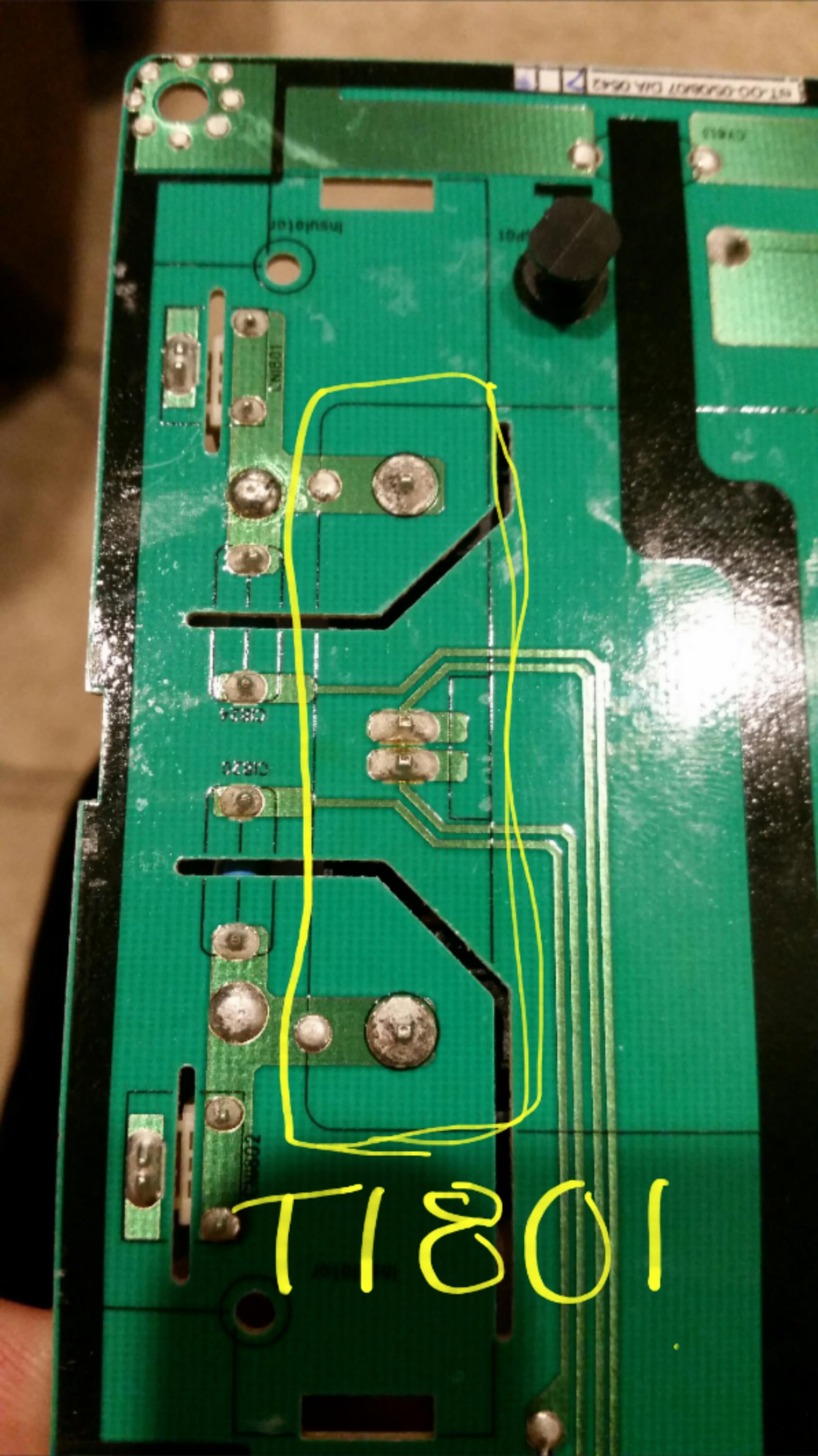

              What voltages do you have on CN801 when it first comes up and when it goes to black.
              Check the soldering on T1801 for poor joints.

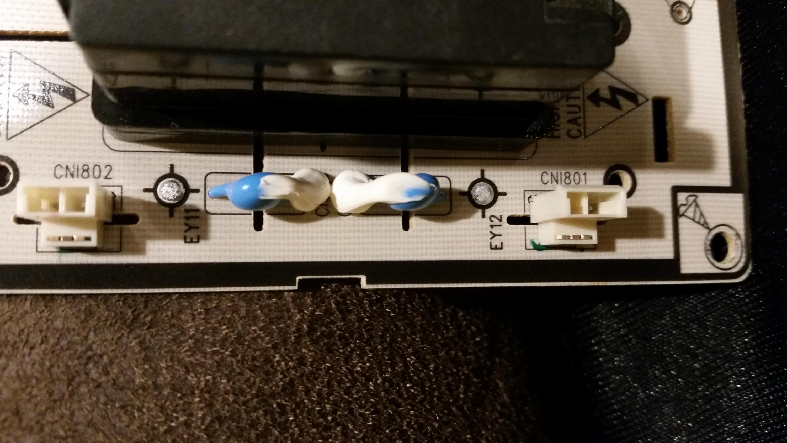

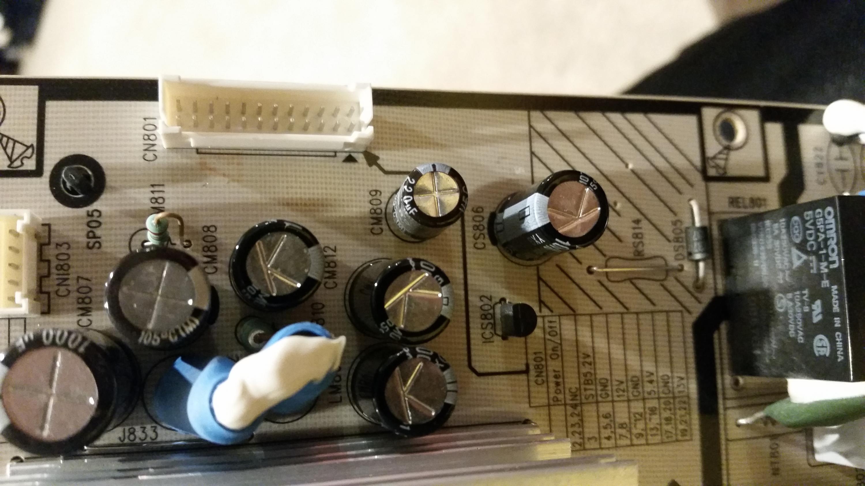

              • engelwood39
                • Mar 2015
                • 93

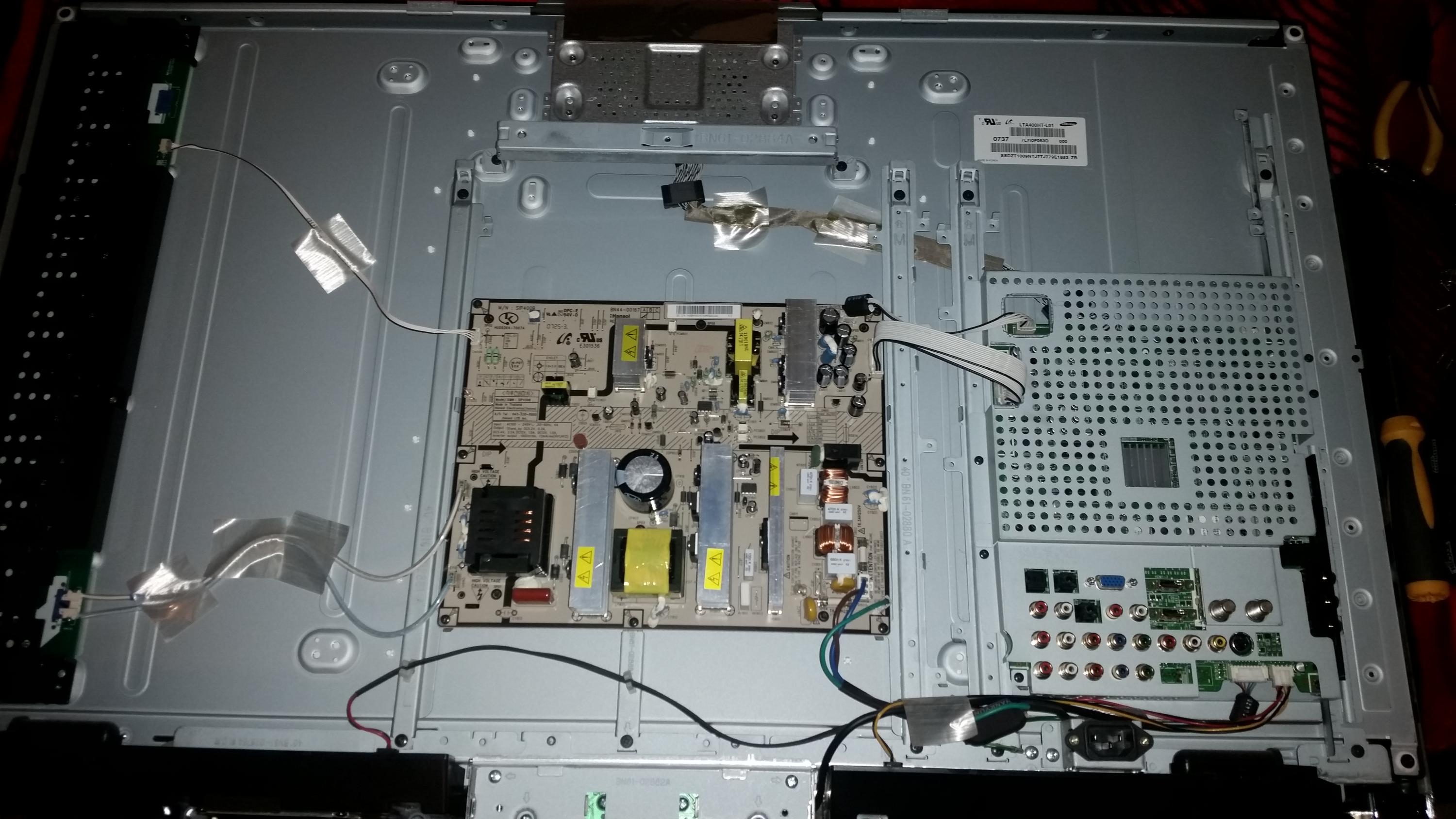

                dick_barton, I sent a picture of the solder joints on T1801. They look pretty good to me.
                I also sent a picture of CN801 (2nd picture). It has a 24 pin connector to it and I'm not sure what you want me to test on it? Also does the ribbon cable need to be plugged in when I make the tests?
                The 3rd Picture is of connector CN1801 and CN1802. I was wondering if that was what you maybe were wanting the voltage on instead of CN801?
                Hey dskall, I am not sure how to test the rectifiers. Could you let me know what I should do to test them and where they are?

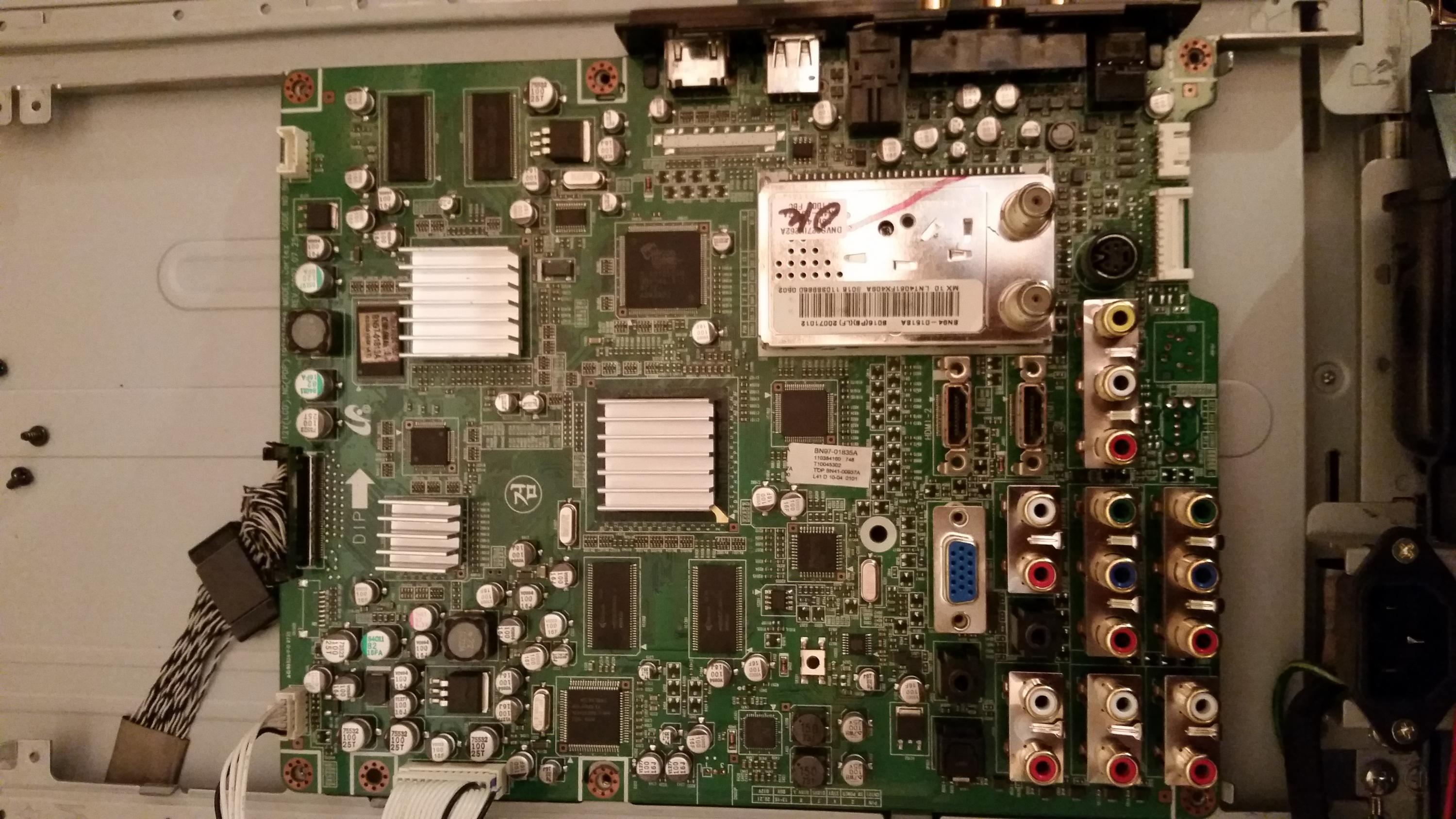

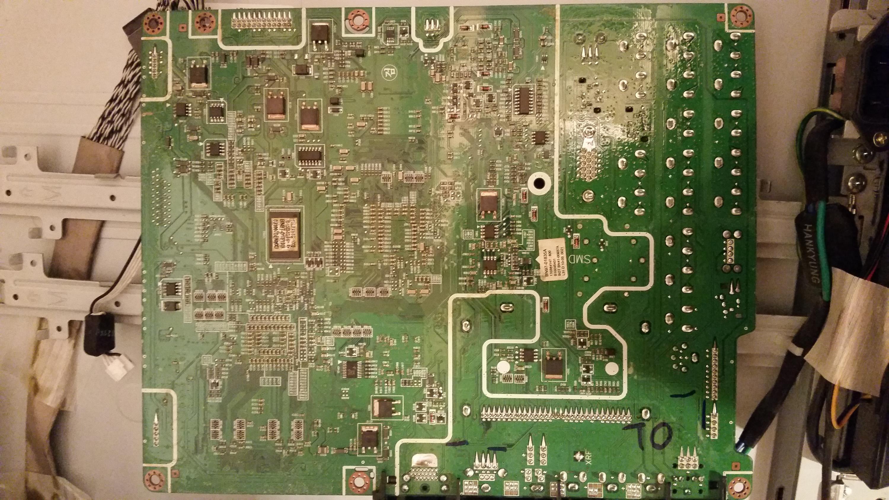

                        Would need good pictures of front and back of mainboard to see if this is board with that problem.

                          • engelwood39
                            • Mar 2015
                            • 93
                            Here are the pics of the main board dskall.
                            Dick Barton, Do you suggest that I replace all the capacitors on the power board? Also were you able to clarify what point you wanted me to test voltage at? Was it the CN1801 or CN801? (The attached pictures with those close up are on the post 6 up from this one)
                              Not a board I am familiar with having bad caps
                                CN801 I think it's marked. There's a legend on the board naming the pin out so if you could provide the voltages alongside could prove useful.
                                http://www.ebay.co.uk/itm/Repair-Kit...-/230579176045
                                You may have an EEPROM problem if the set is rebooting but it's best to check the voltages are correct and caps have not failed first.

                                      Here are the voltages:
                                      Power on/off: 2.78V
                                      STB 5.2V: 5.233V
                                      12V: 11.95V
                                      5.4V: 5.38V
                                      13V: 12.95
                                      Just to clarify what is is doing: It plays a start up tune (i think its a startup tune) and then the backlight comes on with nothing displayed. It stays illuminated for approximately 30 seconds when it shuts down for a couple seconds and then starts the cycle over again back in a loop.
                                      I already ordered the Ebay kit that has all of the caps that are on the board. Not sure it that is a waste of time at this point? Here is the kit:
                                      http://www.ebay.com/itm/330524305728...%3AMEBIDX%3AIT
