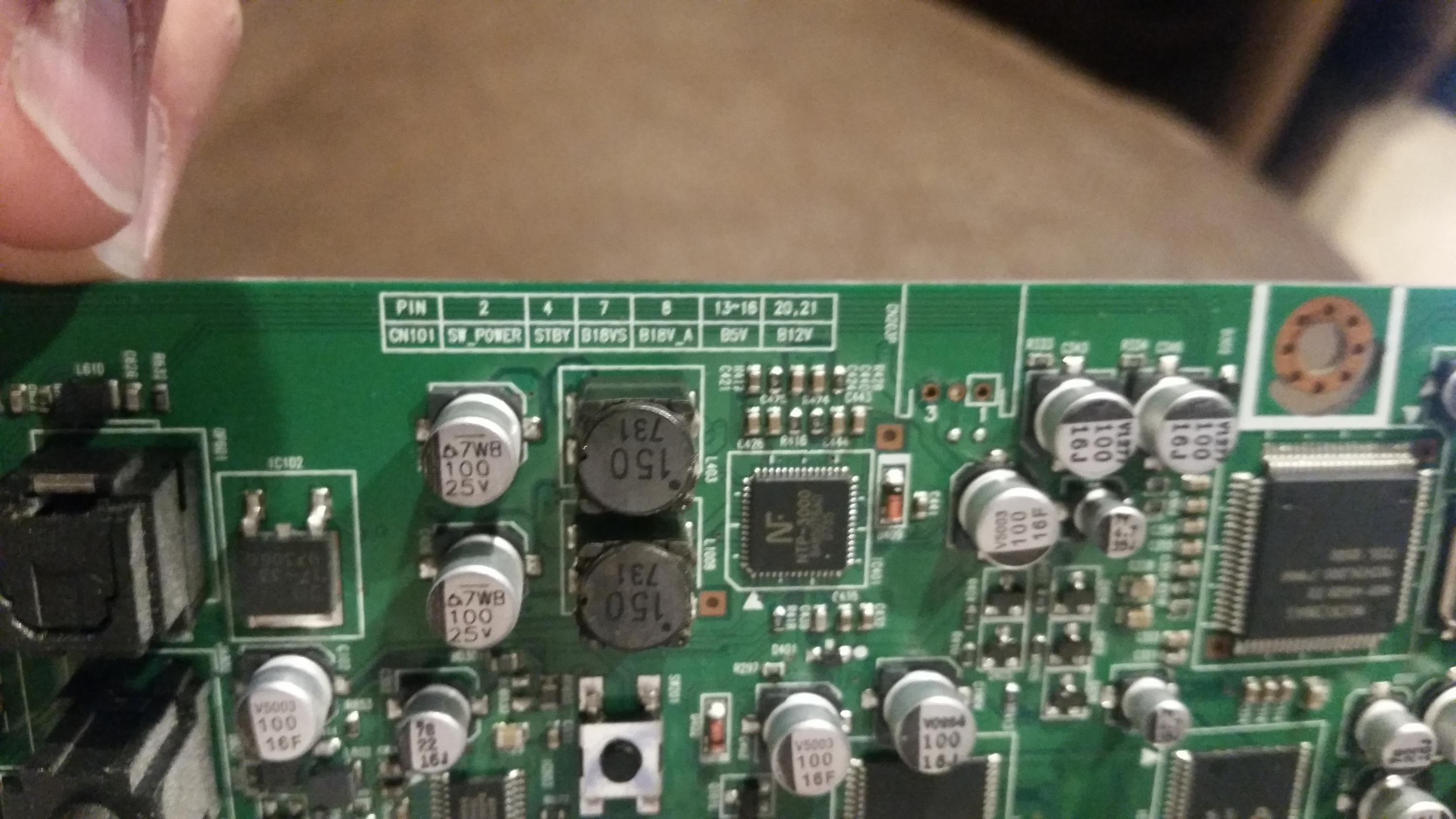

You do have PS-ON (PWR ON/OFF) so all the correct Voltages are present.
So does the PS-ON Voltage go down to < 1VDC when TV goes into shutdown and goes back up by itself?
BTW, there is also anther signal (bl-on) from the main board that turns on the inverter circuit, what is the Voltage of that signal?
