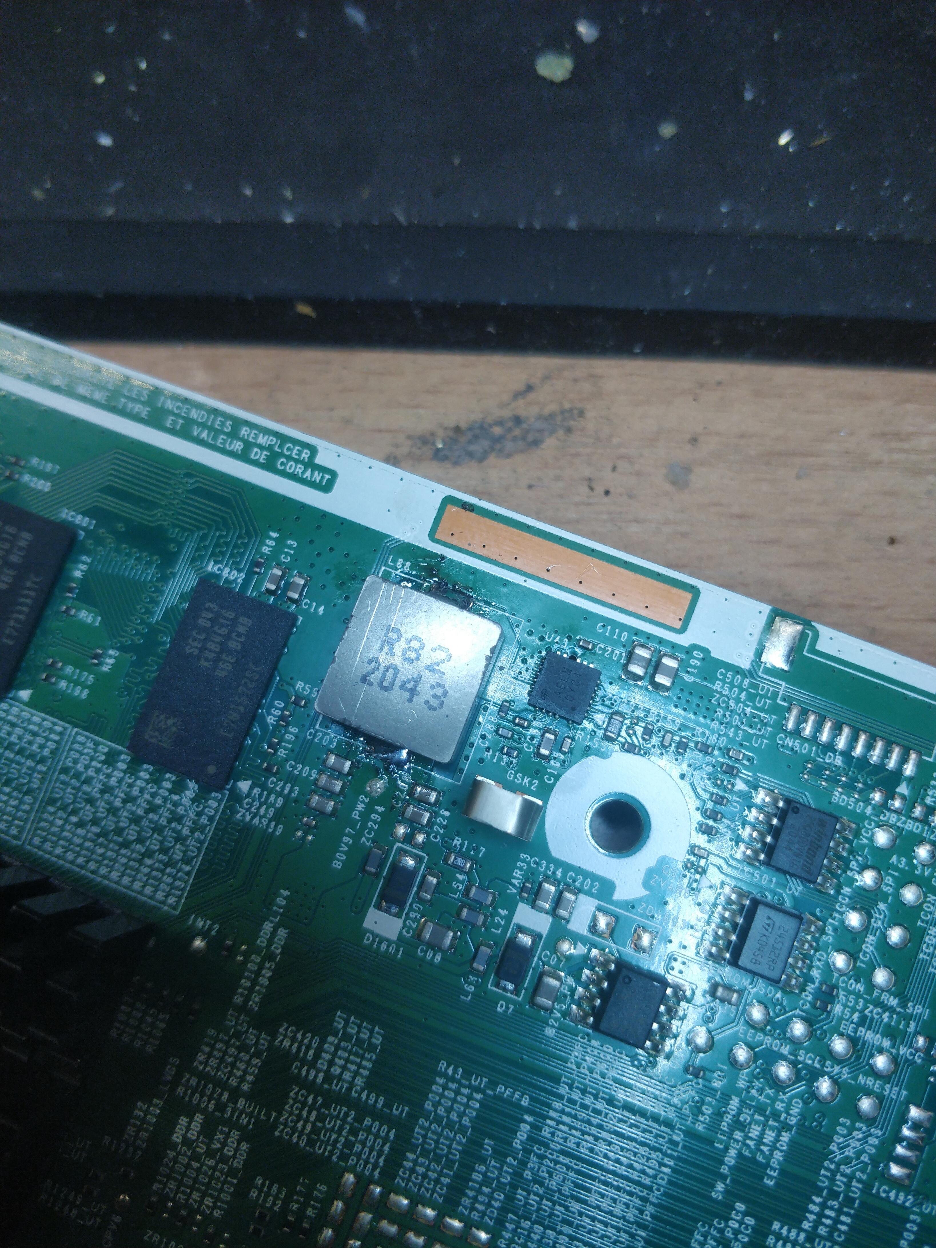

      So I did some measurements on the mainboard and noticed that I have a low resistance to ground (38ohm) on L88.
      The test point is marked BV097_PW2.
      I measure 0.90V on it during startup.
      The Ic next to it is a A0Z2255LQI DC/DC buck regulator and the inductor is connected to the LX pins of it.
      The IC has 12V VCC, which is supplied properly.
      Is this working properly or something is off?

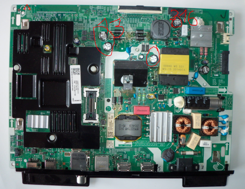

            With the panel disconnected, you need to put a jumper, check these electrolytes...
              I did some measurements based on the photo you made.
              I also made the jumper where you showed.
              Since my board looks different, I don't know where is the middle capacitor is on my board.

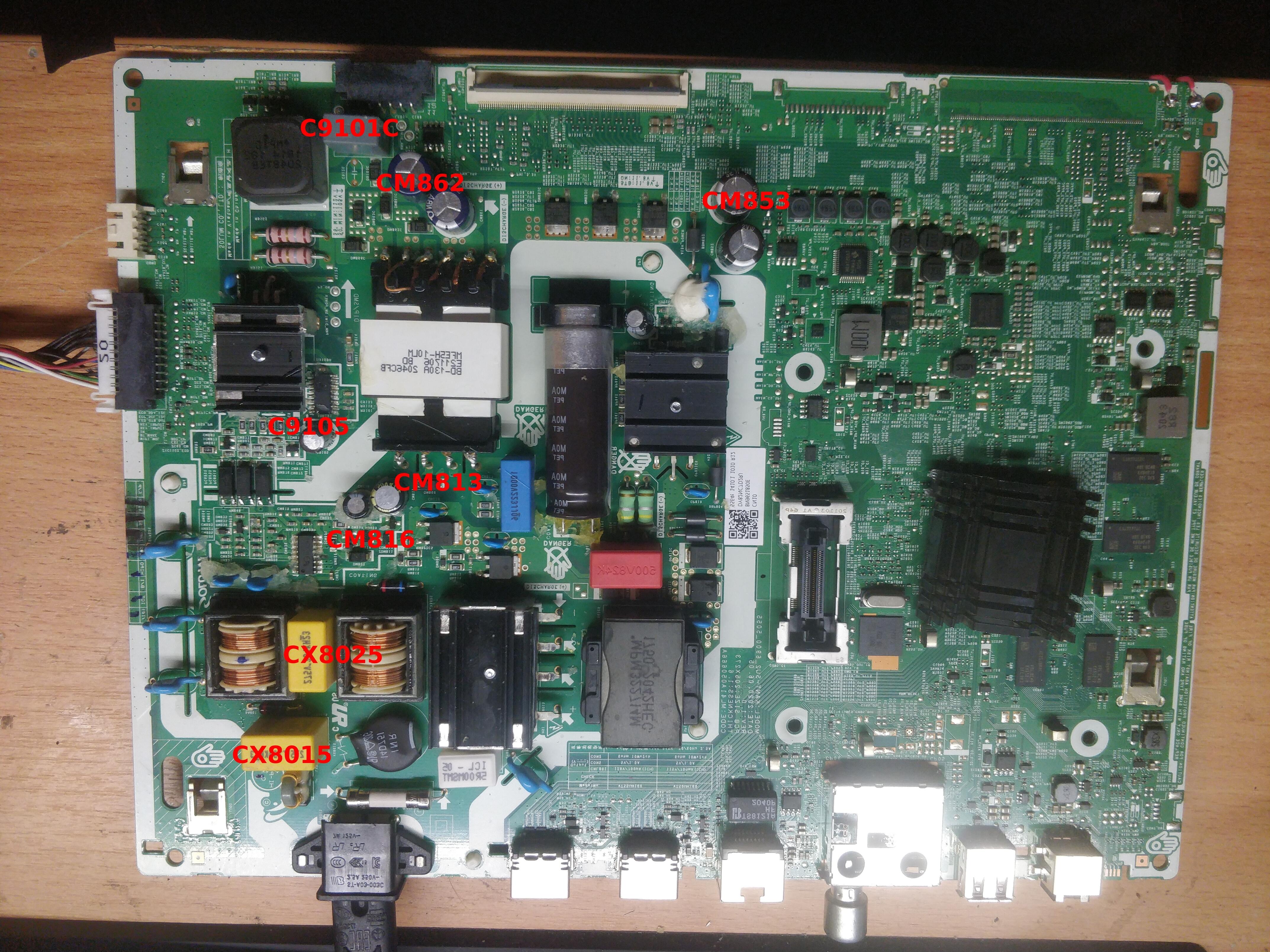

                  Then you don't need to look for the middle capacitor, since the boards are different, check the ones you have and what is the voltage on the power capacitor (PFC) in standby mode and in operating mode?
                  393V on both standby and operating mode.
                  CX8015 - 0v
                  CX8025 -0V
                  CP8015 275V
                  CM816 - 10.43V
                  CM813 - 20V
                  CM862 - 218V
                  CM853 - 12V
                  C9105 - 13V
                  C9101C - 197V
                  Last edited by unimatrix93; 04-10-2025, 08:42 AM. Reason: Added more measurements and photo of board
                  • lotas
                    • Jan 2016
                    • 4803
                    • Russia
                    So your PFC is working, check those capacitors for capacity and esr, with a jumper and the panel disconnected, how does the TV behave?
                    Have you checked the HDMI, USB, and LAN ports for low or short circuits on the signal lines?​

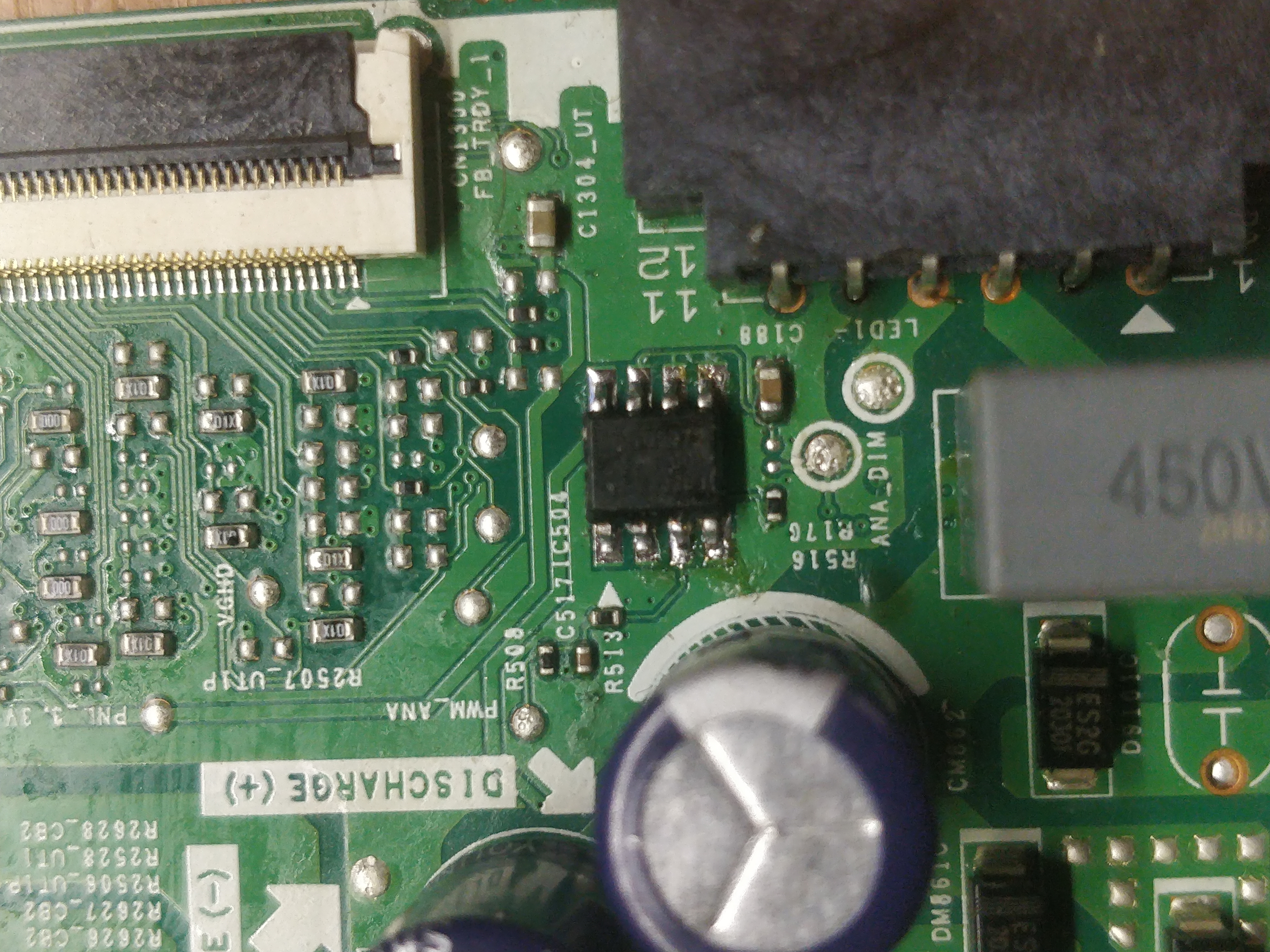

                          Also I found something suspicious:
                          This small ceramic cap is next to the IC marked DI02072 which is right next to the backlight connector.
                          • unimatrix93
                            • Oct 2021
                            • 360
                            • Magyarország

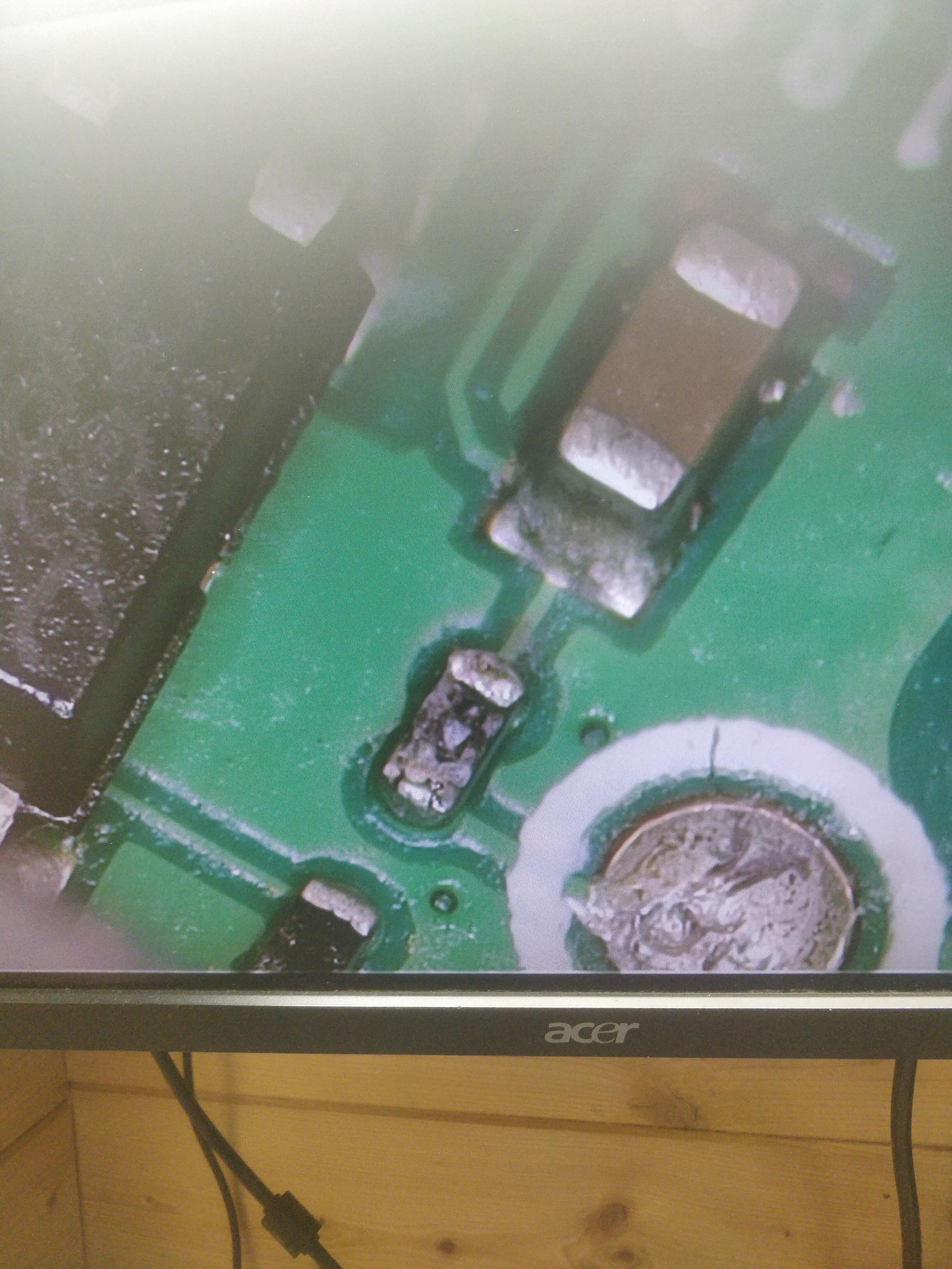

                            I found the schematic of the IC.
                            Also turned out that the burned component is a resistor. I removed it from the circuit and I measure low resistance (53ohm) to ground on all of the non-GND pins of the IC.
                            Could this be the issue?

                              Where is it located, in the backlight chain? You can take a look at a high-quality photo.
                              • unimatrix93
                                • Oct 2021
                                • 360
                                • Magyarország

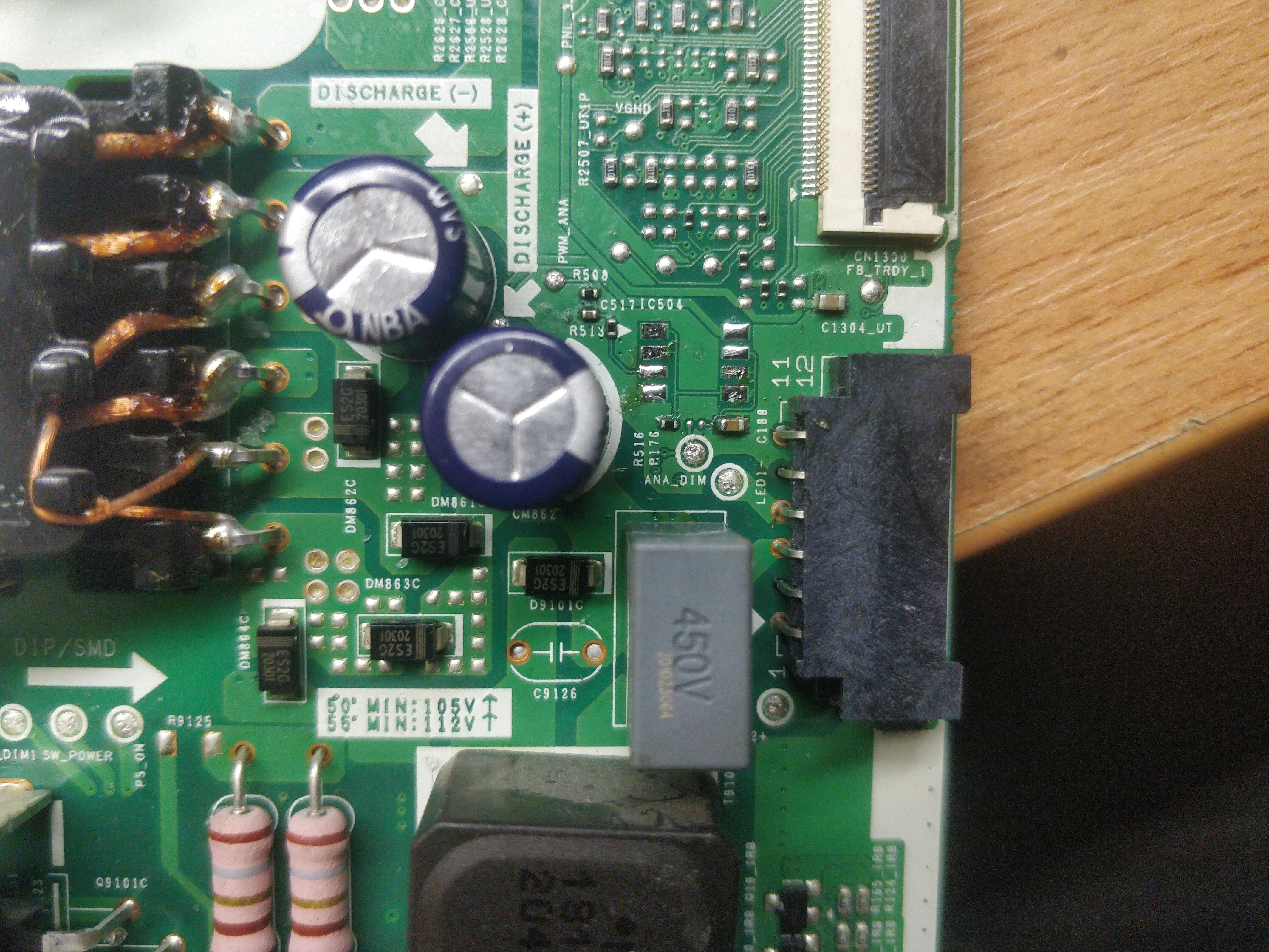

                                As far as I can see, it's part of the backlight. I desoldered the IC to measure it's pins outside of the circuit and indeed the GND leg has 56ohm resistance to all other leg on it.
                                • lotas
                                        You can take a high-quality photo of this microcircuit.
                                        I hope this clear enough.
                                        • lotas
                                          • Jan 2016
                                          • 4803
                                          • Russia
                                          The marking is not visible in the photo, is it DIO2072?
