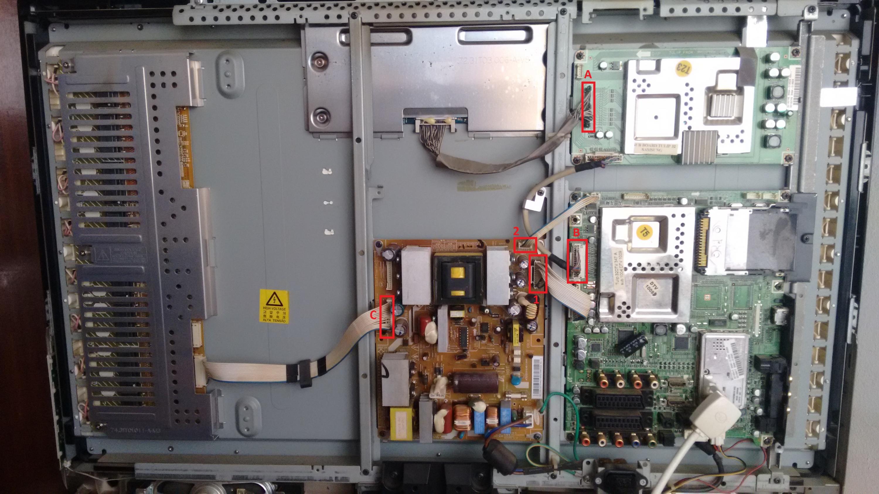

Samsung TV LE32M87BD image issue, turns off by itself, works perfectly after warm up
  • dskall
    replied
    Re: Samsung TV LE32M87BD image issue, turns off by itself, works perfectly after warm
    Originally posted by finntricky
    what a mess that is, get rid of the brown cap and replace with 1000uf 16v and replace the other 1000uf 10v surface mount cap. In red square with 1000uf 16v
    +1
    Leave a comment:
  • Leplus
    replied
    Re: Samsung TV LE32M87BD image issue, turns off by itself, works perfectly after warm
    Originally posted by dskall
    I personally like to stay close to uf rating maybe a little higher. Ok to go up on voltage and temp. I would change the brown and the 1000uf below to 1000uf 16v
    My notes also say for BN41-00988A
    Originally posted by finntricky
    What a mess that is, get rid of the brown cap and replace with 1000uf 16v and replace the other 1000uf 10v surface mount cap. in red square with 1000uf 16v
    Just to confirm, in the service manual posted in the op, both caps are 1000uF 10V
    - C1110 2402-001263 C-AL,SMD;1000uF,20%,10V,WT,SMD,10x10
    - C1177 2402-001263 C-AL,SMD;1000uF,20%,10V,WT,SMD,10x10
    In fact, the black cylindric cap "repaired" was also 1000uF 10V, the current one is 1000uF 36V.
    Just saying as I can't buy them until tomorrow morning
    Leave a comment:
  • finntricky
    replied
    Re: Samsung TV LE32M87BD image issue, turns off by itself, works perfectly after warm
    Originally posted by Leplus
    Haha I know.
    Ok, I'll replace them tomorrow then and post the results here, but, how do you know what to change so especifically? I'm new at this
    because its a common problem with these boards, and there is loads of posts about the these caps.
    Leave a comment:
  • Leplus
    replied
    Re: Samsung TV LE32M87BD image issue, turns off by itself, works perfectly after warm
    Originally posted by finntricky
    What a mess that is, get rid of the brown cap and replace with 1000uf 16v and replace the other 1000uf 10v surface mount cap. in red square with 1000uf 16v
    Haha I know.
    Ok, I'll replace them tomorrow then and post the results here, but, how do you know what to change so especifically? I'm new at this
    Leave a comment:
  • finntricky
    replied
    Re: Samsung TV LE32M87BD image issue, turns off by itself, works perfectly after warm
    Originally posted by Leplus
    You mean, in the picture I'm attaching now, to change the brown and the one in the red square right?
    The one in yellow should leave it there right? Just to confirm.
    And just curiosity, how do you know what to change or not? is there a repair service manual or something?
    And another thing, is it risky for the tv to change the brown cap for another with less capacity or it would only affect to the funcionality? I'll try to look for the diagrams and check its value but i'm down for the change anyway hehe
    And just curiosity, how do you know what to change or not? is there a repair service manual or something?
    the answer is experience over many years, but we still get lost sometimes,
    Leave a comment:
  • finntricky
    replied
    Re: Samsung TV LE32M87BD image issue, turns off by itself, works perfectly after warm
    What a mess that is, get rid of the brown cap and replace with 1000uf 16v and replace the other 1000uf 10v surface mount cap. in red square with 1000uf 16v
    Last edited by finntricky; 04-19-2017, 01:00 PM.
    Leave a comment:
  • Leplus
    replied
    Re: Samsung TV LE32M87BD image issue, turns off by itself, works perfectly after warm
    Originally posted by dskall
    I personally like to stay close to uf rating maybe a little higher. Ok to go up on voltage and temp. I would change the brown and the 1000uf below to 1000uf 16v
    You mean, in the picture I'm attaching now, to change the brown and the one in the red square right?
    The one in yellow should leave it there right? Just to confirm.
    And just curiosity, how do you know what to change or not? is there a repair service manual or something?
    And another thing, is it risky for the tv to change the brown cap for another with less capacity or it would only affect to the funcionality? I'll try to look for the diagrams and check its value but i'm down for the change anyway hehe
    Leave a comment:
  • dskall
    replied
    Re: Samsung TV LE32M87BD image issue, turns off by itself, works perfectly after warm
    I personally like to stay close to uf rating maybe a little higher. Ok to go up on voltage and temp. I would change the brown and the 1000uf below to 1000uf 16v
    My notes also say for BN41-00988A
    Last edited by dskall; 04-19-2017, 12:52 PM.
    Leave a comment:
  • Leplus
    replied
    Re: Samsung TV LE32M87BD image issue, turns off by itself, works perfectly after warm
    Originally posted by dskall
    Someone has already done repairs.
    My notes say replace two 1000uf 10v for mainboard BN41-00813E. Brown cap was probably 1000uf 10v originally.
    Yes, looks like that, but its been working for years. I asked whether it was repaired before, i'm waiting an answer, just to confirm if they bought it like that or not, for my knowledge because it an old model.
    And, if i am not wrong, this is a BN41-00899A.
    See the picture. I dont know whether this changes anything. There are two 1000uF 10v, one under the shield and another just below.
    Edit: and is it possible to change it for the brown with different capacity when they repaired it? Apparently it would be because it's been working until now xD
    Last edited by Leplus; 04-19-2017, 12:09 PM.
    Leave a comment:
  • dskall
    replied
    Re: Samsung TV LE32M87BD image issue, turns off by itself, works perfectly after warm
    Someone has already done repairs.
    My notes say replace two 1000uf 10v for mainboard BN41-00813E. Brown cap was probably 1000uf 10v originally.
    Last edited by dskall; 04-19-2017, 12:00 PM.
    Leave a comment:
  • Leplus
    replied
    Re: Samsung TV LE32M87BD image issue, turns off by itself, works perfectly after warm
    Originally posted by finntricky
    yes thats the one
    I just removed the shield as you can see in the pictures but I can't find those capacitors you mentioned.
    The brown capacitator is 2200uF 16V, and the blue one is 100uF 25V. The rest appear clear in the pictures.
    I only could check the blue one. My meter is up to 200uF and that one is ok, it gave me 130uF, but no idea about the rest.
    Leave a comment:
  • finntricky
    replied
    Re: Samsung TV LE32M87BD image issue, turns off by itself, works perfectly after warm
    Originally posted by Leplus
    You mean the shield labelled as T5 right? I update the post when I remove the shield then.
    yes thats the one
    Leave a comment:
  • Leplus
    replied
    Re: Samsung TV LE32M87BD image issue, turns off by itself, works perfectly after warm
    Originally posted by finntricky
    on the main input board, under the shield there is 2 surface mount caps, 1000uf 16v, change them, and should solve your problem, you don't have to use surface mount caps to replace them as long as the ones you use are small enough to lay down to get the shield back on,
    You mean the shield labelled as T5 right? I update the post when I remove the shield then.
    Leave a comment:
  • finntricky
    replied
    Re: Samsung TV LE32M87BD image issue, turns off by itself, works perfectly after warm
    on the main input board, under the shield there is 2 surface mount caps, 1000uf 16v, change them, and should solve your problem, you don't have to use surface mount caps to replace them as long as the ones you use are small enough to lay down to get the shield back on,
    Leave a comment:
  • Samsung TV LE32M87BD image issue, turns off by itself, works perfectly after warm up
    Hi, I got a TV from a friend to repair but I can't find the issue.
    TV model is Samsung TV LE32M87BD, this is a link to the service manual.
    The problem is shown in the videos below:
    Samsung screen freeze + reboot
    I put the exact moments in the description when the tv fails. After being 12-15 minutes rebooting, the tv works perfectly
    Samsung screen colors issue + reboot
    This is trying with another source via EXT 2 I think. different image issue but same behaviour of rebooting.
    I've added some pictures of the TV as well.
    In the picture of the main board with the T5 yellow label I am pointing a capacitor that I did not repair, I already got it that way, as it look non original, but it has been there for years as my friend told me without knowing it.
    In the picture of the sub board with the T23 yellow label I am showing you another capacitor that I changed one month ago due to another issue very well known in this model, so that capacitor I checked it again and works perfectly.
    And in the general picture of the TV, I am pointing that:
    - Removing connector A (to Tcon), B (to sub board) and C (to inverter), and turning on the TV, the TV still reboots by itself, so I guess is not a problem of any of those boards, but I am not sure.
    - I checked the voltages in 1 (all correct) and in 2 (which are different when working perfectly than when the tv is not able to show any picture, black screen).
    I tried to follow videos on youtube about troubleshooting but I do not what to check, I can't measure capacitors in circuit either, but if you need any voltage of any data with the meter I can give it.
    Any idea?
  • Kjell
    Samsung Series 9 - BIOS issue
    by Kjell
    After installing Linux, I can no longer enter the BIOS of my Samsung Series 9 (NP900X3C) laptop. When pressing [F2] during boot I simply get a black screen. Same thing when pressing [F10] and choosing "Setup" from the "App Menu" tab. Apparently this is a relatively common issue with Samsung laptops of that generation, but unfortunately i haven't been able to resolve the issue (yet).
    Things i've tried so far; reinstalled Windows 10, checked for redundant boot entries, tried to factory reset using the emergency keyhole, attempted to clear the NVRAM by physically...
    08-01-2025, 09:15 AM
    09-07-2024, 05:50 AM
  • Mirenia
    Acer Helios 500 (PH517-51) - unexpected reboots when laptop is warm (cold solder joint issue?)
    by Mirenia
    Hi everyone,
    got an Acer Helios 500 Laptop (PH517-51) for diagnosing with a strange issue:
    The laptop runs for a while (1-2 hours, sometimes less) and then suddenly shuts completely off, like someone pulled the power cord and restarts immediately after on its own.
    If this happened once, then the laptop only runs for a few minutes until restart.
    This happens regardless while staying in windows or uefi or in a linux environment.
    At first I thought of a normal overheating issue, but as I monitored temps with HWInfo64, nothing seems very hot.
    01-05-2025, 05:15 PM
  • Nairolf
    Samsung DM32D – Red LED blinks 5 times, won’t start (possible mainboard issue)
    by Nairolf
    I have a Samsung DM32D display.
    When I try to power it on, the red LED blinks 5 times and nothing happens—the unit won’t start.
    Here’s what I have tried so far:
    1. Disconnected the cable between the mainboard and the power supply → the backlight turns on.
    2. Disconnected the main T-CON ribbon cable → same issue as before, the LED still blinks 5 times.
    3. Disconnected one of the two T-CON ribbons to the panel (tested each one separately) → same issue, the LED blinks 5 times.
    From these tests, I suspect the problem might be on the mainboard. Could anyone...
    08-24-2025, 03:47 AM
  • vincentedel
    Samsung SyncMaster 740n Phase Control Issue
    by vincentedel
    I'm having an issue with the Samsung 740n's phase control setting. When I use the automatic adjustment, it sets the value to around 54 (with a range of 0-100), and the picture looks clear and sharp. However, after some time—like after playing a game—the text starts to look blurry. When I auto-adjust again, it may increase the value to 80, and everything becomes sharp once more. Yet, after a while, whether it's a few hours or a day later, the same blurriness returns, and I have to adjust it again.
    I'm using the Samsung 740n monitor drivers instead of the default plug-and-play...
    04-22-2025, 12:33 AM
