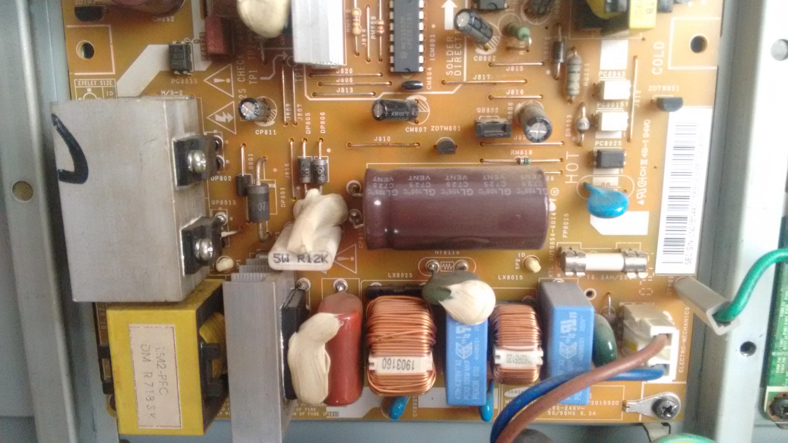

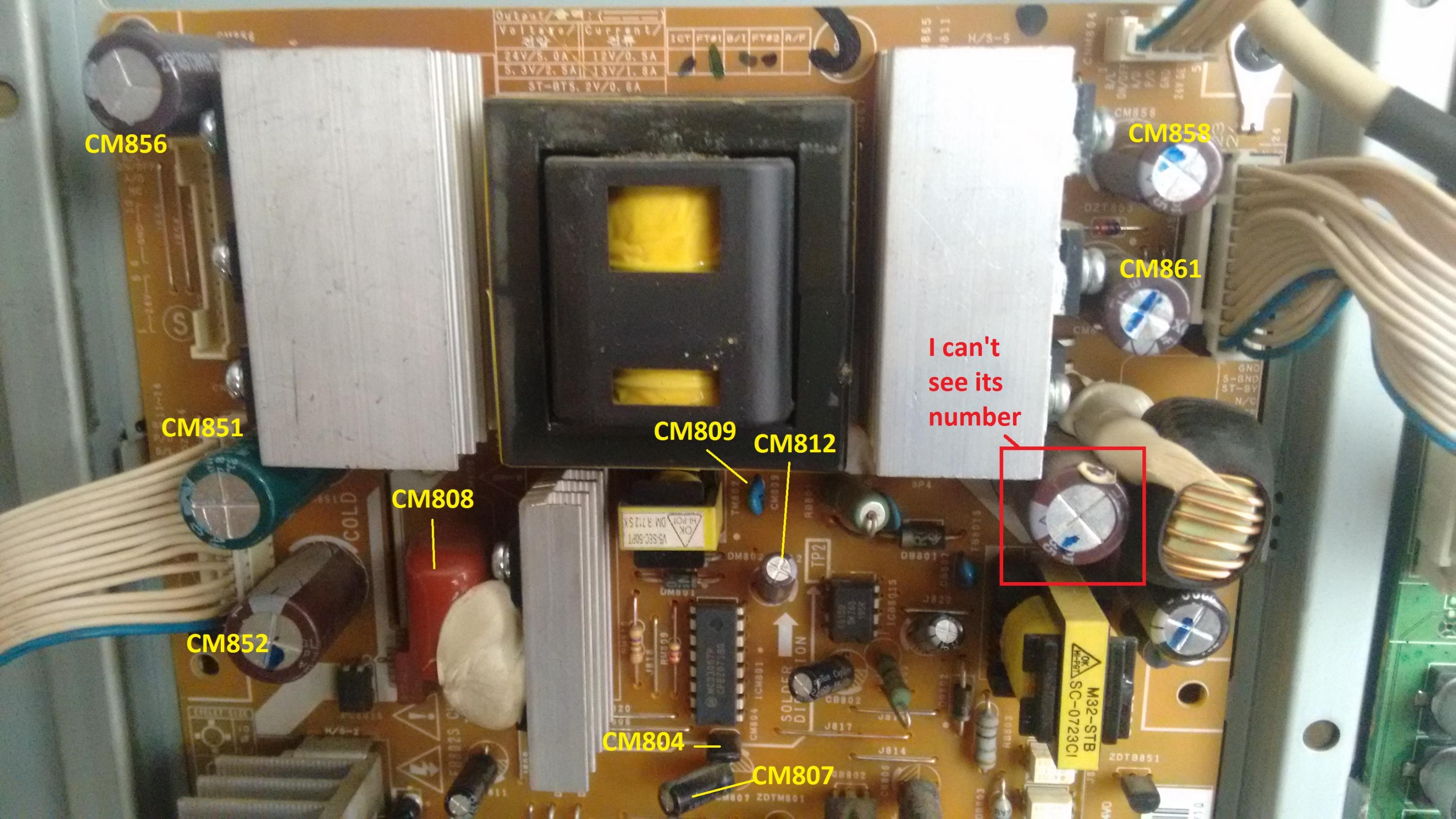

Samsung TV LE32M87BD image issue, turns off by itself, works perfectly after warm up
  • Leplus
    replied
    Re: Samsung TV LE32M87BD image issue, turns off by itself, works perfectly after warm
    Originally posted by dskall
    Need to check main cap with probes across pos and neg of cap. Caution several hundred voltes DCV
    Shit, sorry, I had the probes connected to check capacity of a former measure. Let me check again.
    My meter is to 750 ACV/ 1000 DCV max. Could he die? xD
    Last edited by Leplus; 04-20-2017, 10:46 AM.
    Leave a comment:
  • dskall
    replied
    Re: Samsung TV LE32M87BD image issue, turns off by itself, works perfectly after warm
    Need to check main cap with probes across pos and neg of cap. Caution several hundred voltes DCV
    Leave a comment:
  • Leplus
    replied
    Re: Samsung TV LE32M87BD image issue, turns off by itself, works perfectly after warm
    And also, after rebooting several times, tv kept working on EXT 1 (RGB), then I tried to change it to DTV but screen was black like in the videos, and then began the rebooting cycle.
    Leave a comment:
  • Leplus
    replied
    Re: Samsung TV LE32M87BD image issue, turns off by itself, works perfectly after warm
    Originally posted by dskall
    Voltage of main cap on power board
    Practically 0 (AC)
    Last edited by Leplus; 04-20-2017, 10:37 AM.
    Leave a comment:
  • dskall
    replied
    Re: Samsung TV LE32M87BD image issue, turns off by itself, works perfectly after warm
    Voltage of main cap on power board
    Leave a comment:
  • Leplus
    replied
    Re: Samsung TV LE32M87BD image issue, turns off by itself, works perfectly after warm
    Some more info if it helps:
    - In DTV source, no image and rebooting.
    - In EXT 1 (RGB) perfect image and rebooting.
    - In EXT 2 (AV) image pumping the colors like in the first video and rebooting.
    Leave a comment:
  • Leplus
    replied
    Re: Samsung TV LE32M87BD image issue, turns off by itself, works perfectly after warm
    Originally posted by ducky29
    Just replace the 2 caps that i mentioned and get back with the results
    Nothing, I replaced them but same result about image and rebooting.
    Originally posted by dskall
    I would be checking voltage regulators on mainboard. What is voltage on your main brown cap?
    Mmmm, if you could show me which ones are the voltage regulators because I don't know, let me google it up
    The brown cap was under the shield, could I remove the shield with the tv on? Because there are cooling square "things" xD on top of two chips or whatever those are
    Leave a comment:
  • dskall
    replied
    Re: Samsung TV LE32M87BD image issue, turns off by itself, works perfectly after warm
    I would be checking voltage regulators on mainboard. What is voltage on your main brown cap?
    Leave a comment:
  • ducky29
    replied
    Re: Samsung TV LE32M87BD image issue, turns off by itself, works perfectly after warm
    Just replace the 2 caps that i mentioned and get back with the results
    Leave a comment:
  • Leplus
    replied
    Re: Samsung TV LE32M87BD image issue, turns off by itself, works perfectly after warm
    Caps identified in the first picture. There is one that I can't see its number.
    Leave a comment:
  • Leplus
    replied
    Re: Samsung TV LE32M87BD image issue, turns off by itself, works perfectly after warm
    Originally posted by ducky29
    Replace 52 and 58
    Ok, haha, I have to go to buy them now.
    I can upload detailed pictures of the power supply if you need. Give me a moment.
    Leave a comment:
  • ducky29
    replied
    Re: Samsung TV LE32M87BD image issue, turns off by itself, works perfectly after warm
    Replace 52 and 58
    Leave a comment:
  • Leplus
    replied
    Re: Samsung TV LE32M87BD image issue, turns off by itself, works perfectly after warm
    Originally posted by ducky29
    Can you list all the components in the power supply that start with CM?
    (Caps starts with C, Resistors with R etc)
    There you go, I think I'm not missing anyone else.
    CM851
    CM852
    CM856
    CM858
    CM861
    CM804
    CM807
    CM808
    CM809
    CM812
    Leave a comment:
  • vinceroger69
    replied
    Re: Samsung TV LE32M87BD image issue, turns off by itself, works perfectly after warm
    yes try heating the mainboard from cold for a good few minutes see if set turns straight on if not try doing the same to the power supply i have had good success in fault finding with this method.
    Leave a comment:
  • ducky29
    replied
    Re: Samsung TV LE32M87BD image issue, turns off by itself, works perfectly after warm
    Originally posted by Leplus
    I already replaced the caps mentioned before but no change, tv is still failing.
    Any other idea?
    Can you list all the components in the power supply that start with CM?
    (Caps starts with C, Resistors with R etc)
    Leave a comment:
  • Leplus
    replied
    Re: Samsung TV LE32M87BD image issue, turns off by itself, works perfectly after warm
    try heating/cooling the mainboard and see if you can make fault appear quicker then narrow down the area your heating/cooling.
    Yep, I tried that at the beginning but I didn't get anything clear, I'll try again heating from tv cold, I don't have anything to cool it down, just wait and blowing xD
    Leave a comment:
  • Leplus
    replied
    Re: Samsung TV LE32M87BD image issue, turns off by itself, works perfectly after warm
    Originally posted by ducky29
    This is not even related to the caps. Anyways get back with the results after you finish replacing all the caps that everyone mentioned above, so then I can help you.
    I already replaced the caps mentioned before but no change, tv is still failing.
    Any other idea?
    Leave a comment:
  • ducky29
    replied
    Re: Samsung TV LE32M87BD image issue, turns off by itself, works perfectly after warm
    This is related to the caps. Anyways get back with the results after you finish replacing all the caps that everyone mentioned above, so then I can help you.
    Last edited by ducky29; 04-20-2017, 08:34 AM.
    Leave a comment:
  • vinceroger69
    replied
    Re: Samsung TV LE32M87BD image issue, turns off by itself, works perfectly after warm
    try heating/cooling the mainboard and see if you can make fault appear quicker then narrow down the area your heating/cooling.
    Leave a comment:
  • Leplus
    replied
    Re: Samsung TV LE32M87BD image issue, turns off by itself, works perfectly after warm
    Originally posted by finntricky
    because its a common problem with these boards, and there is loads of posts about the these caps.
    Originally posted by dskall
    +1
    Nah, I changed both caps but the problem remains, same behaviour like in the videos.
    It sucks because at first tv works always, so I have to wait for a couple of minutes to know whether the changes worked or not haha, but then it fails.
    Another thing, my friend told me that the night that the tv began to fail, tv turned on by itself two times in the middle of the night until he plugged it out. Just if this info is valuable.
    So, any ideas of what more to change? XD
    Edit: From the dtv source I don't get any image, just the menus, but from scart source I get image but with the colors pumping until tv turns off.
    Last edited by Leplus; 04-20-2017, 06:20 AM.
    Leave a comment:
  • Kjell
    Samsung Series 9 - BIOS issue
    by Kjell
    After installing Linux, I can no longer enter the BIOS of my Samsung Series 9 (NP900X3C) laptop. When pressing [F2] during boot I simply get a black screen. Same thing when pressing [F10] and choosing "Setup" from the "App Menu" tab. Apparently this is a relatively common issue with Samsung laptops of that generation, but unfortunately i haven't been able to resolve the issue (yet).
    Things i've tried so far; reinstalled Windows 10, checked for redundant boot entries, tried to factory reset using the emergency keyhole, attempted to clear the NVRAM by physically...
    08-01-2025, 09:15 AM
    09-07-2024, 05:50 AM
  • Mirenia
    Acer Helios 500 (PH517-51) - unexpected reboots when laptop is warm (cold solder joint issue?)
    by Mirenia
    Hi everyone,
    got an Acer Helios 500 Laptop (PH517-51) for diagnosing with a strange issue:
    The laptop runs for a while (1-2 hours, sometimes less) and then suddenly shuts completely off, like someone pulled the power cord and restarts immediately after on its own.
    If this happened once, then the laptop only runs for a few minutes until restart.
    This happens regardless while staying in windows or uefi or in a linux environment.
    At first I thought of a normal overheating issue, but as I monitored temps with HWInfo64, nothing seems very hot.
    01-05-2025, 05:15 PM
  • Nairolf
    Samsung DM32D – Red LED blinks 5 times, won’t start (possible mainboard issue)
    by Nairolf
    I have a Samsung DM32D display.
    When I try to power it on, the red LED blinks 5 times and nothing happens—the unit won’t start.
    Here’s what I have tried so far:
    1. Disconnected the cable between the mainboard and the power supply → the backlight turns on.
    2. Disconnected the main T-CON ribbon cable → same issue as before, the LED still blinks 5 times.
    3. Disconnected one of the two T-CON ribbons to the panel (tested each one separately) → same issue, the LED blinks 5 times.
    From these tests, I suspect the problem might be on the mainboard. Could anyone...
    08-24-2025, 03:47 AM
  • vincentedel
    Samsung SyncMaster 740n Phase Control Issue
    by vincentedel
    I'm having an issue with the Samsung 740n's phase control setting. When I use the automatic adjustment, it sets the value to around 54 (with a range of 0-100), and the picture looks clear and sharp. However, after some time—like after playing a game—the text starts to look blurry. When I auto-adjust again, it may increase the value to 80, and everything becomes sharp once more. Yet, after a while, whether it's a few hours or a day later, the same blurriness returns, and I have to adjust it again.
    I'm using the Samsung 740n monitor drivers instead of the default plug-and-play...
    04-22-2025, 12:33 AM
