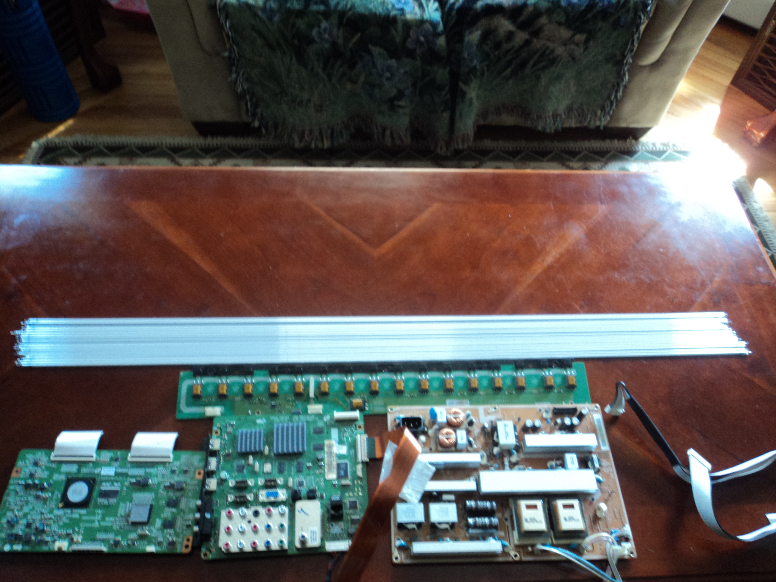

    Samsung LN46B64R3F parts?
    Hi guys; i found in the curve this Samsung LN46B640R3FXZA with broken screen,i got it apart and took out all boards including the lamp backlights.
    my question do these CCFL lamp back-lights fit to any other 46" led tv? don't if any of these boards are any good,but there are good parts for any other future repairs,see pic attach; thanks

    All parts should be saved out of any scrap tv. I always salvage backlights both CCFL and LED strips. The boards can either be sold on e bay or used as replacement boards on future repairs . I have loads of storage space so am lucky to have the room to store the bits. For me I have almost an addiction to collecting scrap tv parts . I love having lots of boards to practice de soldering the many types of chips and other bits. I save every single backlight from broken screens. I have a nice collection now.

      they will fit many other ccfl backlight tv's, but not led.
      the only catch when you change out a single ccfl is that some have a tint to them, blue or yellowish. but if you put the slightly off one on the very top or bottom, it normally isnt noticeable.
      i have a couple of boxes full and are annoying to store. i just write the length and diameter add length on a piece of paper and tape it to each set.
      you could of jumped the ps on to see if the ps and inverter was ok before you stripped it.

        Thanks guys; i also have a whole bunch of boards from different brands,i normally if screens are broken i strip them right on the spot. and leave the panels and such in there,and bring boards home
