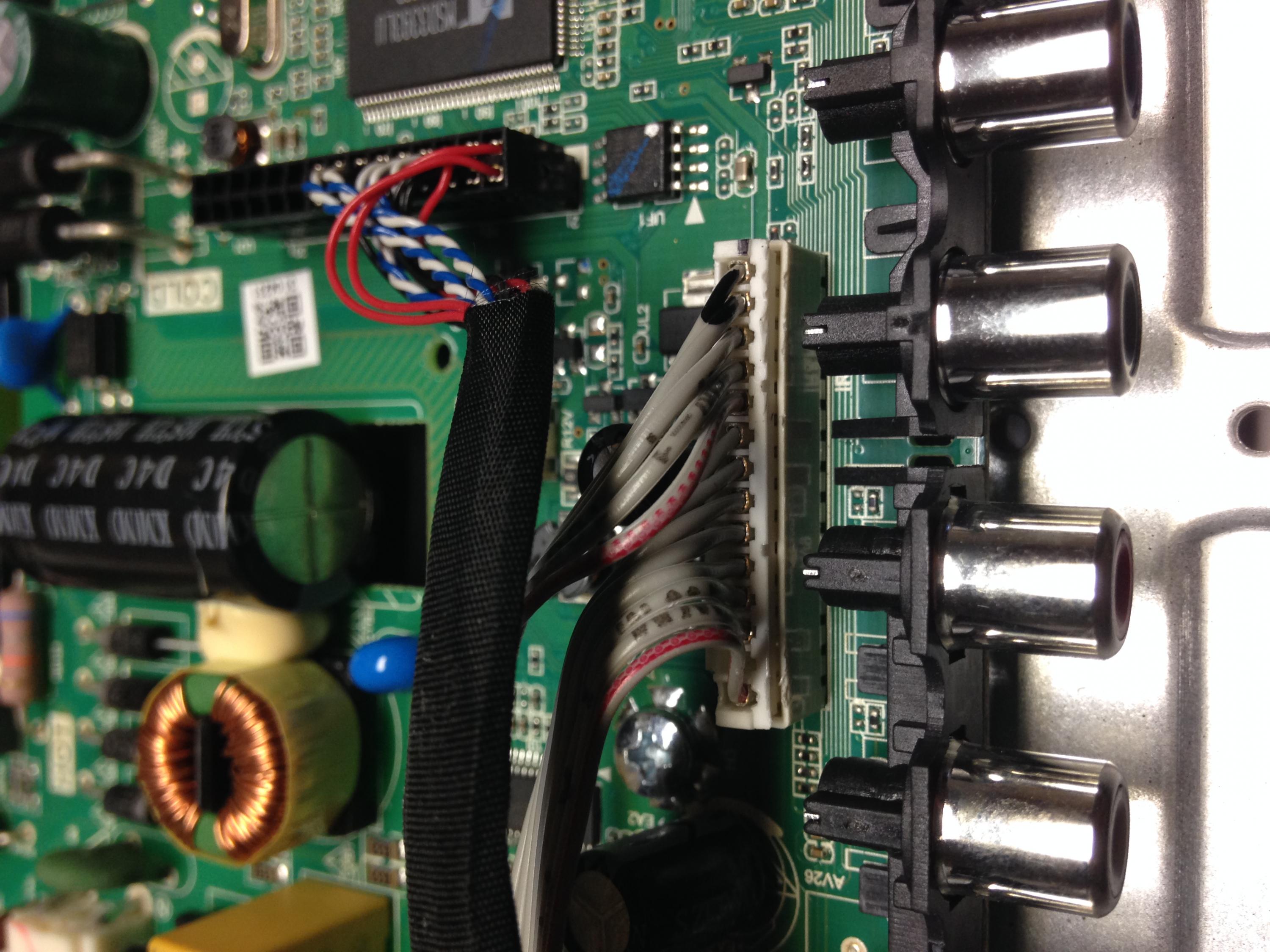

            ok here some update
            here my testing result at the connector on the logic/power board
            the wires come from the ir board and button board
            from left to right, result (VOLT) in stand by mode and when power button pressed
            1 GND 0 0
            2 K7/N - -
            3 K6/P 3.3 0
            4 K5/M 3.3 0
            5 K4/V- 3.3 0
            6 K3/V+ 3.3 0
            7 K2/C- 3.3 0
            8 K1/C+ 3.3 0
            9 K0/S 3.3 0
            10 GNS 0 0
            11 IR 5 5
            12 GRN 0.088 0.088
            13 RED 1.67 1.67
            14 5V 5.12 5.12

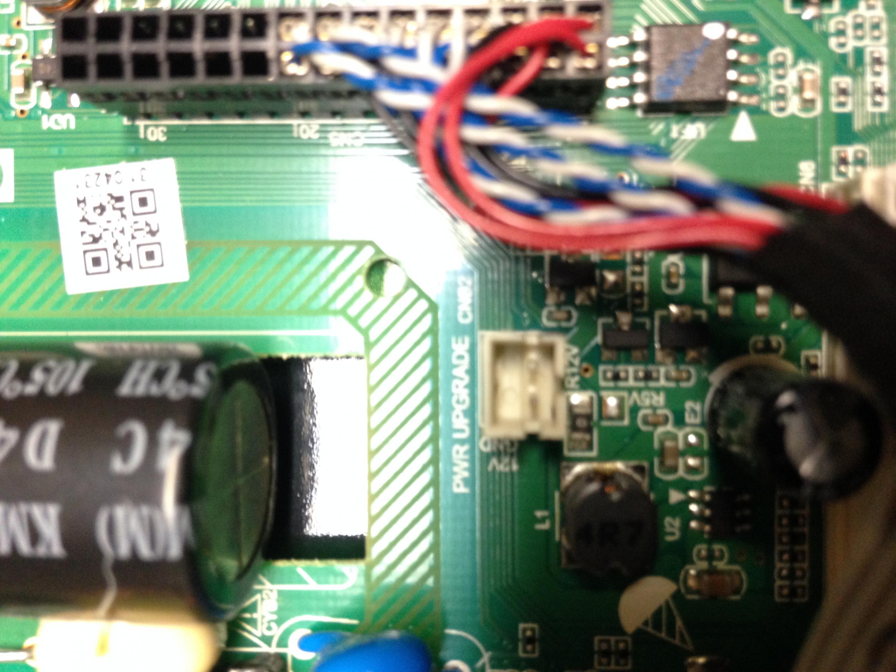

            I saw a little resistor or cap on the bord just at the left where its written R12V
            measure resistance = 0
            thanks again for your help

                  R12v has 12v only on one side

                    Re: RCA RLED2845A Red Led No Power Up
                    It is a 0 ohm resistor which should have 12V on both sides. Power down the set and measure using your meter set to ohms.
                    If it's the white connector you mean then one pin will be 12V the other 0V
                    • Icitte
                      • Aug 2011
                      • 61
                      Ok yeah finally 12v on each side of the resistor so here is not the problem

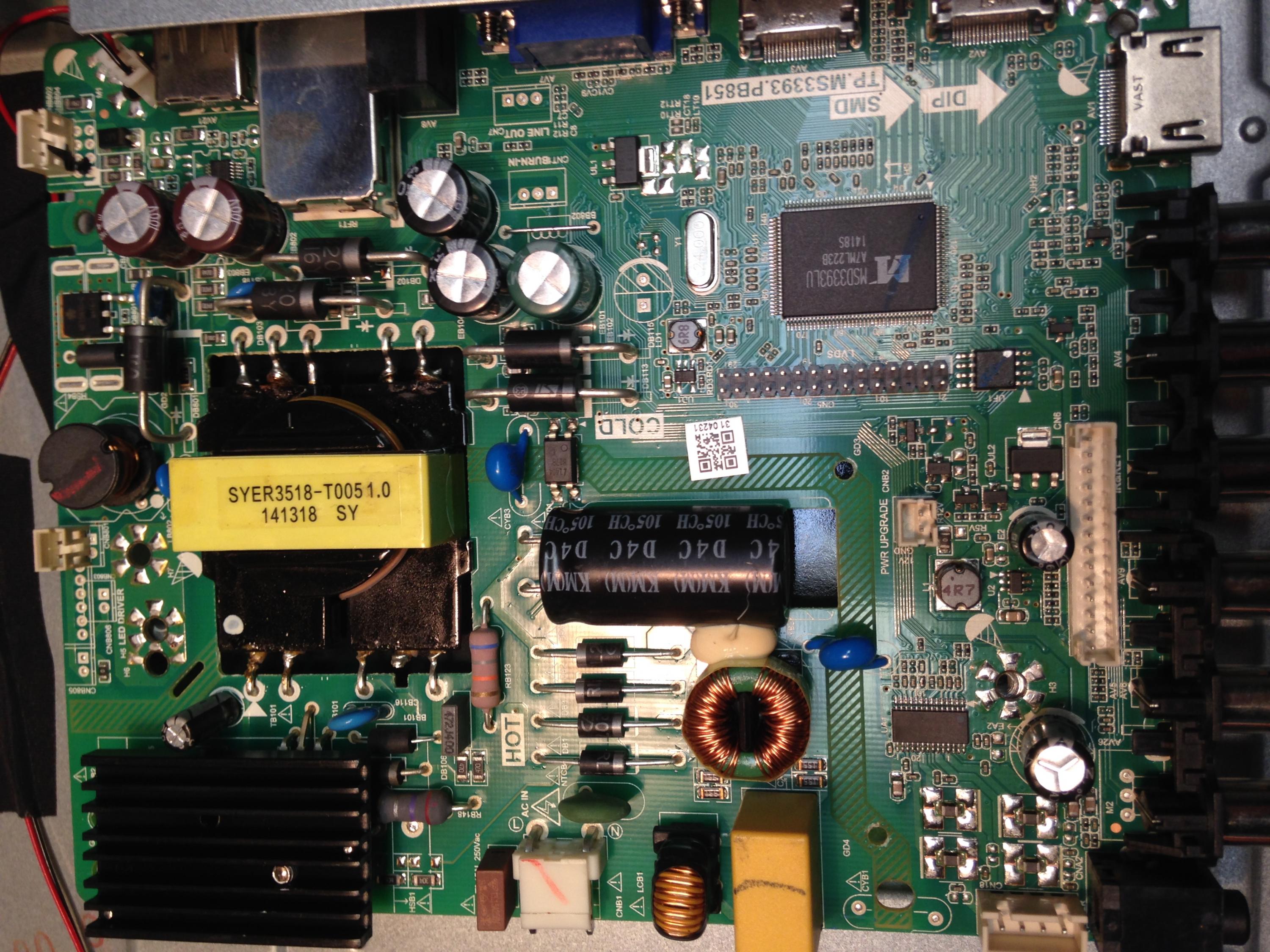

                              • attainteddragon
                                • Apr 2013
                                • 764
                                • australia
                                i am not very good at these intergrated main and ps boards, but i'll try to help a little.
                                check dcv (black probe on chassis ground) on ul1, and ul2 (from left to right) looks like a fixed regulator, but i cant read it.
                                also check the opto (there is only 1 that i can see). i believe that is where your on signal is transferred to the hot side to activate the pfc circuit.
                                    Every RCA TV I've looked at either has bad backlights (turns on with no backlight or flash of backlights) or bad EEPROMS (has standby light but doesn't turn on). Freeze the eeprom (8 pin SOIC by the main processor) with an upside down can of duster before plugging in. If it turns on, its the EEPROM. If it doesn't, it still could be the EEPROM.
                                    RCAs are low end TVs with very little value and not worth putting any money into repairing IMHO.
