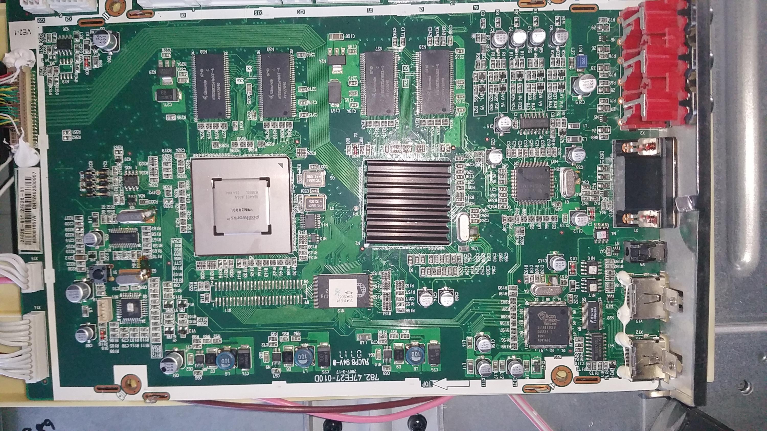

                    Here are the 2 boards in question. there is another with the standard def and tv tuner on is as well as to the long boards I just noticed today on each side.
                    As you can see this is a mess unit with plenty of ribbons and boards to look at.

                                Oh, and also, your TV probably has a main board, responsible for creating your picture and all the other logic, a power board that provides power, a TCON that controls timing of the screen, and than probably driver boards (usually long ones, on side or top/bottom) that split the power from the supply across all of the rows and columns, and controls the individual pixels. These driver boards are a bit complicated in that the screen has so many connections for the individual pixels, it is impossible to hook them all to one chip, so the driver boards minimize the number of connections needed, usually through multiplexing. Hopefully some of this information helped.

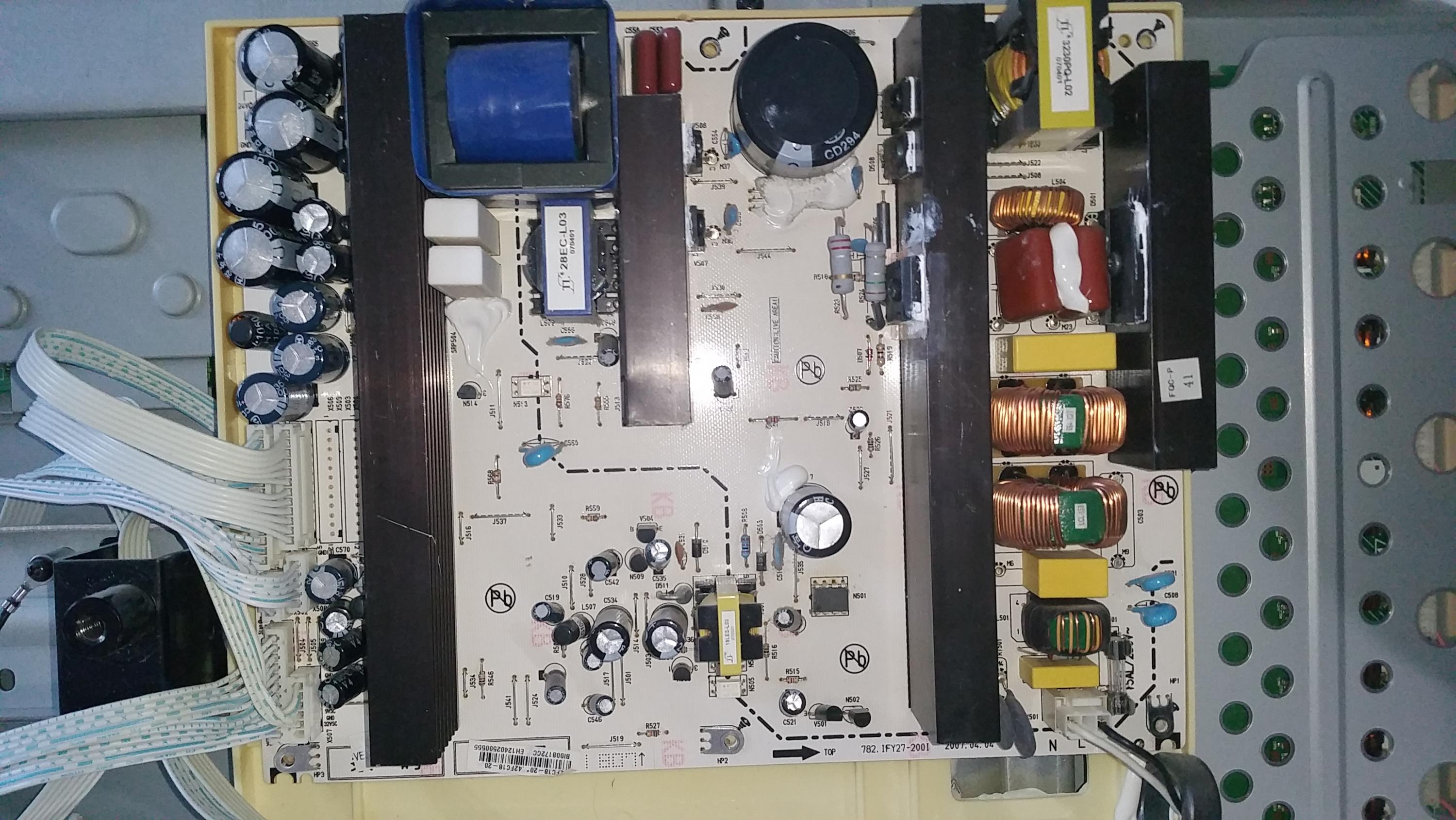

                                    Is that a burn mark on R523 on the power board or a pen mark?
                                    Also what DC voltage do you have between the two legs of the large capacitor with CD294 on top and what is the voltage rating written on it?

                                        Thanks...Petehall. first thing I do is put al my stuff through the dishwasher. Then I get to work on it....Movin' on.
                                        Dick_Barton.... that is a marker tick that I made. You may see a few around. Just reminders to recheck something if it was inconsistent with the other comparisons I made.
                                        I'm still waiting on parts also, if you notice there is some flux spillout on the 2nd pic in the bottom left corner. I have a variable power supply and a few more things to make my testing a little easier/safer.
                                        I will get back tomorrow after I try a few more things and hopefully have someting new to report.
