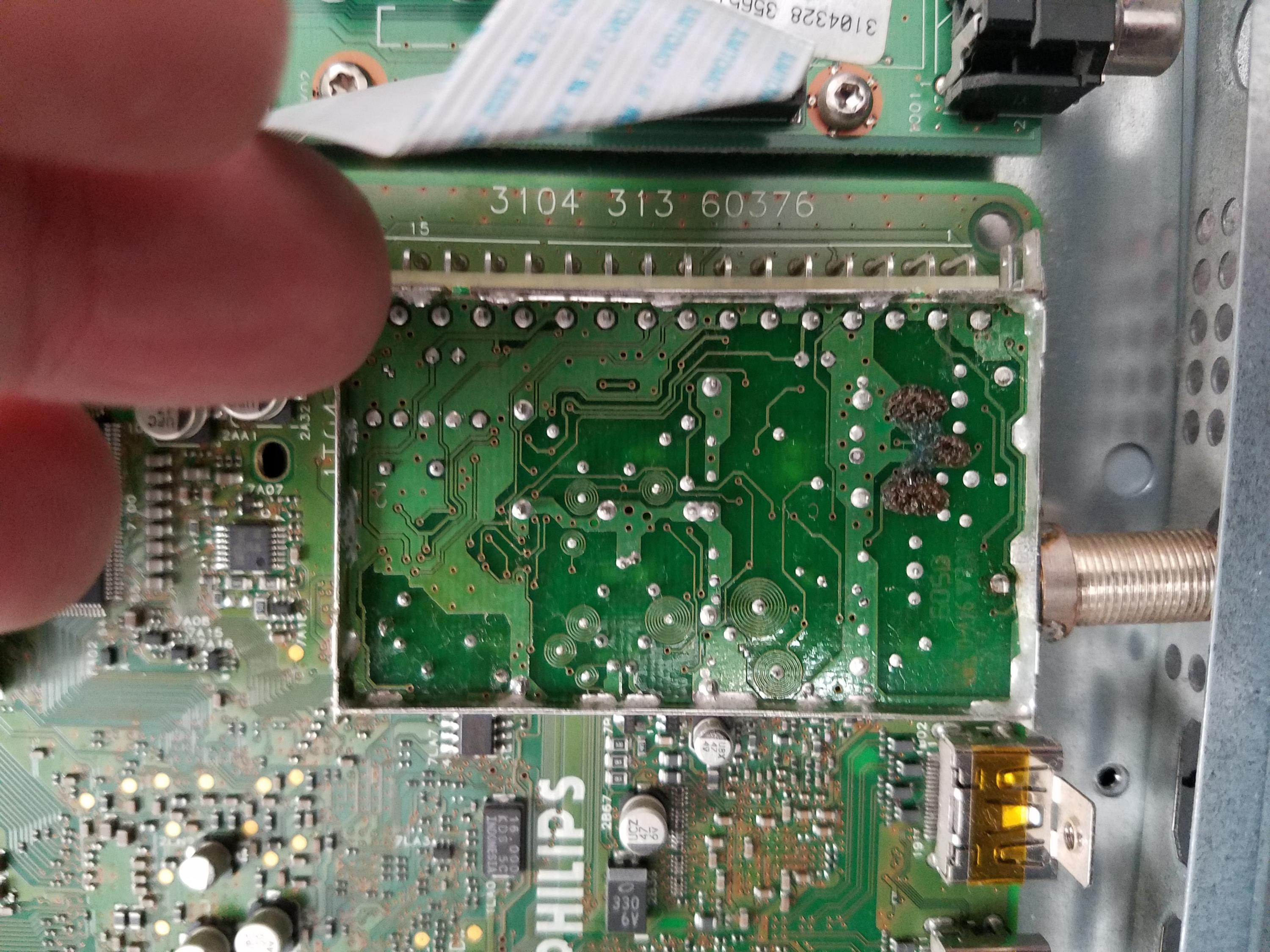

            I've been testing the X-SUS board by measuring the pins on the power supply side. If the X-SUS IPM is blown, that could cause a short-circuit, right? Would a short-circuit explain no reading on any of the pins? Or is there something wrong with the PSU?
            I took out the logic / main board. The one that has the blinking green LED. I removed the cover from the tuner. It has black stuff that appears to have leaked out from something. I don't think the tuner is easily repairable. Even if I desolder it, I don't think I can get to the circuit board. Is it safe to order a replacement logic board that has the same part number but is from a different television? I can't find one for this TV.
            ShopJimmy has one with this part number. The part number is 310431360376. http://www.shopjimmy.com/philips-310...main-board.htm E-Bay has a few with that number. Cheapest is around 20$ (free shipping). I'd probably order off e-bay, to save some money....I'm just afraid there's going to be firmware or something that communicates with some other board and a replacement main board won't work if it's from another tv.

              Thanks for the info on the peak atlas it good to hear from someone who has it themselves ive only done two repairs on plasmas and both panasonic 10 blink issues so hopefully someone with phillips experience will advise you but that tuner board certaily looks bad theres a few videos on you tube regarding testing the ipm for shorts etc not sure if you have saw them?
                I haven't seen them, but I did see a video where a guy removed the heatsink to work on the IPM. From what he was saying, desoldering braid isn't going to do the trick because of something about a multilayered PCB. He uses a thermocouple to watch the temperature (something I can do) and then a preheater to heat the board to 100C and then a desoldering gun that has a vacuum pump built in to remove the solder. I have everything but the desoldering gun. I don't even have a manual desoldering pump.
                I ordered a replacement X-SUS. Maybe we should just wait to see what happens when it comes? For the tuner, do you think it's a wise idea to replace the entire board? I'm trying to remove that nasty stuff on it, but it's really caked on. I doubt removing it will fix it, but I dunno, maybe there's an SMD capacitor under there that exploded or something?
