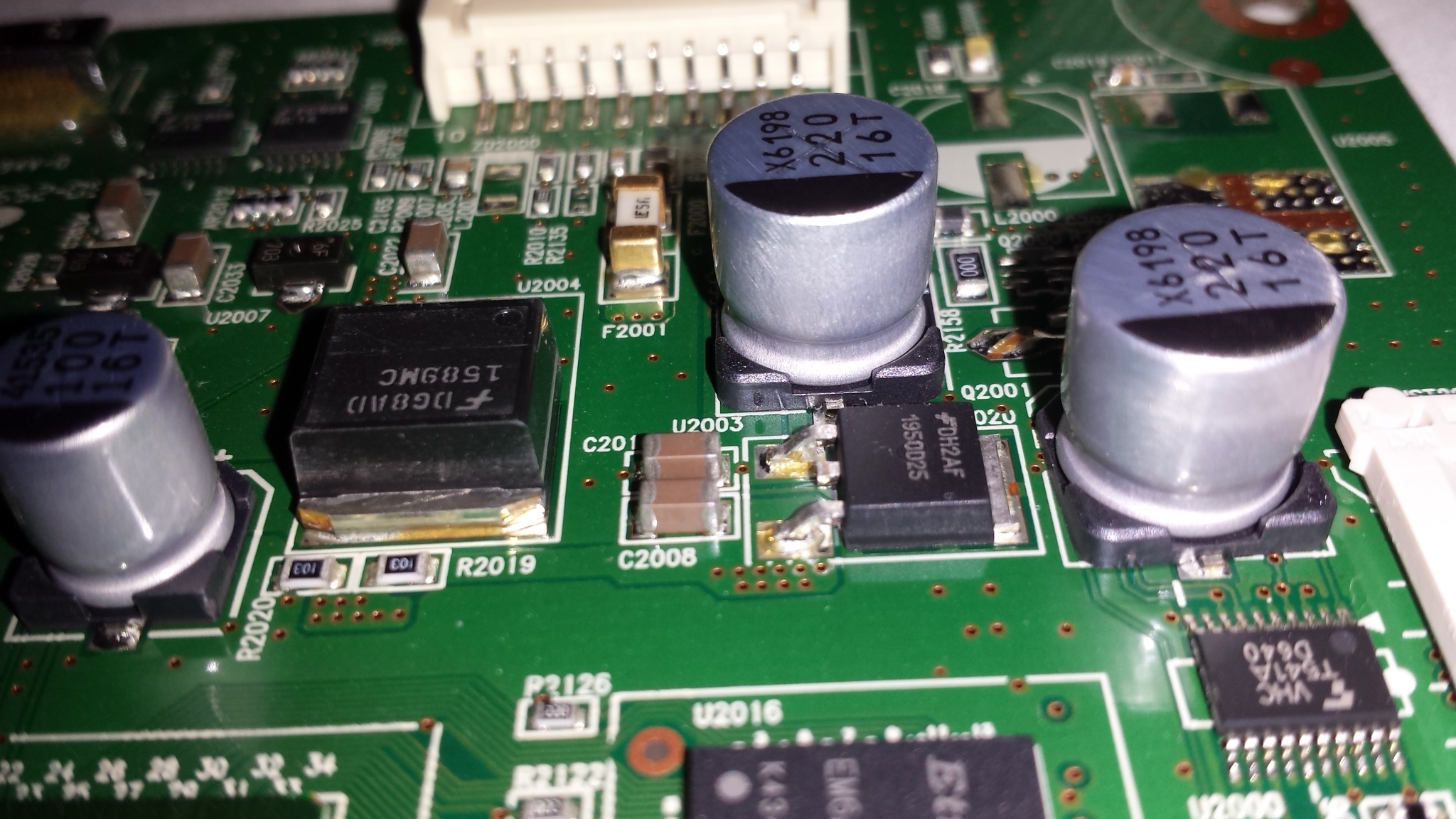

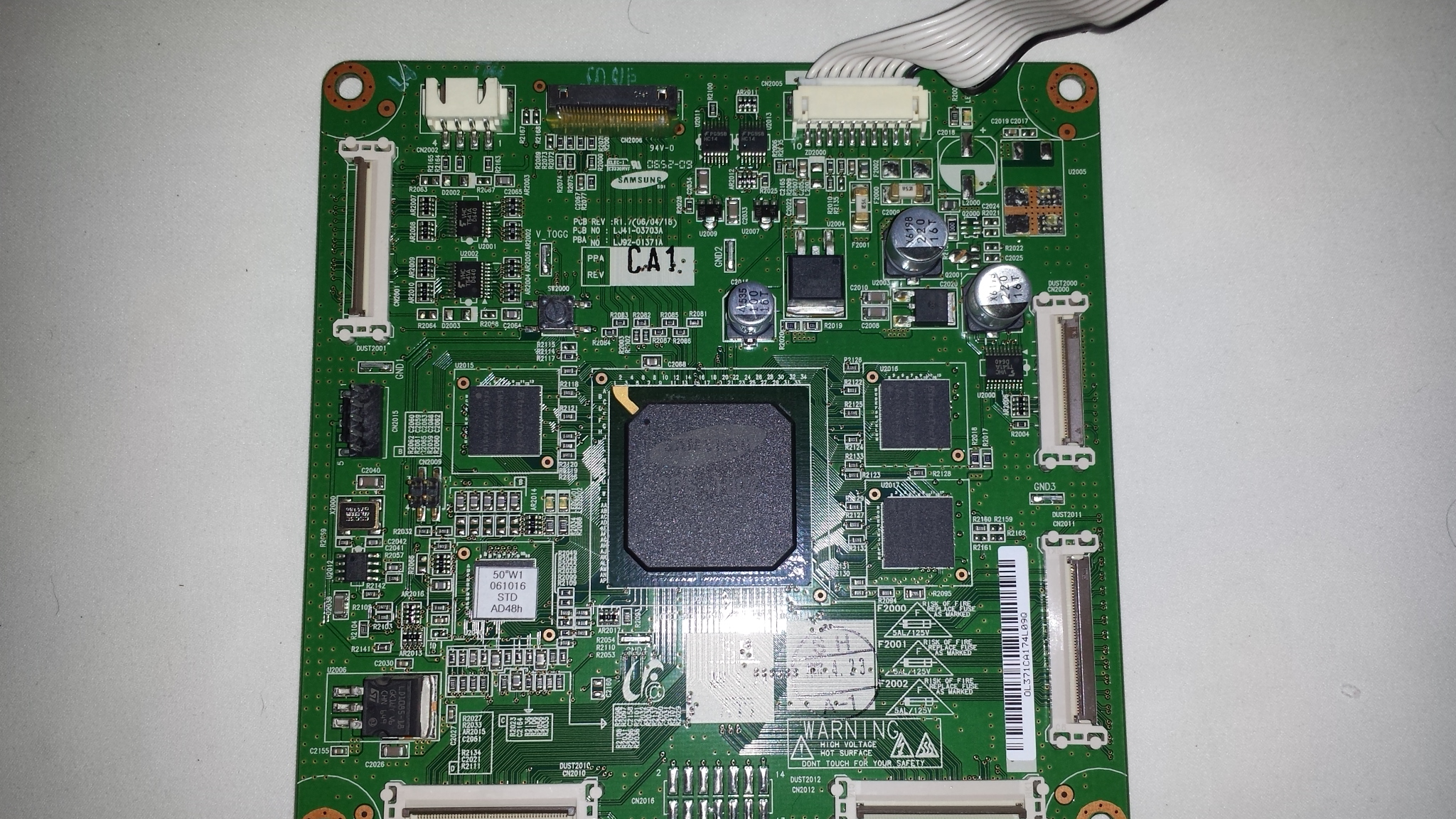

    I followed a few troubleshooting steps, disconnecting the X and Y boards and the issue still happened. I then disconnected the logic board and the X and Y boards were still connected. with the logic board disconnected, the TV will power and LED will stay lit up. The Y board has two caps that are visibly bulging (25v 660 iirc). the Logic board is a LJ92-01371C. it has three caps and it feels like one or two might be bulging. they are surface mount and i cannot read them.
    So my first question - is the logic board the problem here? it seems like the TV powers fine when the board is out, but im not familiar with the order of operations here. Do the X and Y work because they arent connected to the logic board? or is it just the logic board that is the problem? I'm going to replace the caps on the Y board because i can read the values on them, I'd like to replace the surface mount caps on the logic board and then see if that fixes it... if the logic board is the only thing wrong (aside from the Y caps) then i might just replace it altogether.

    Post some pictures of the circuit boards and of the caps you think may be bulging. Good pictures are worth more than words.

      The two caps are pretty obvious for bulge/leak but arent the worst I've ever seen. the two surface mount caps I cant tell if they are shot or not. That's why i'm trying to figure out if the Logic board needs to be replaced or not, since the TV appears to power without it...

          that's kind of what i was thinking. I just wasnt sure if the caps on the logic board looked lifted and if i should replace them at the same time or not..
          any way we can figure out the values on those? It's an hour's drive to the nearest cap store so I may as well get the caps for those as well in case i end up needing them..

                  also - when i turn it on the first time after a discharge the logic board has two LEDs that light up, and then turn off, and additional attempts to power dont bring the lights back on.
                  So now the question is, is this a logic board issue or Y board issue? from almost every troubleshooting guide i read it says the y board tends to go, but the only real troubleshooting guide told me that when the y board was disconnected it should power on and stay powered on with no picture...

                        A good picture of whole set from rear plus individual boards would help. The main has signal inputs. Usually you disconnect lead from power board to main then jumper pson lead on connector to gnd and vson lead to 5v lead similarly. Turn on and check voltages. If none disconnect y lead and if voltages OK that indicates y side problem. If no joy then do x side disconnect. If neither works PSU problem. If all voltages did come up though this indicates main board problem. For the logic board it is usual to see a led blinking about one second intervals indicating normal operation.
                          Re: Maxent MX-50HPT52 Powers on, blinks, then off.
                          thanks for the response it's nice to see one after getting nothing. I'll take some pics and post tomorrow (hopefully). Im at the point where even just knowing what board to replace in total would be fine by me. I'm good with a soldering iron, but want my TV back in a bad way.
