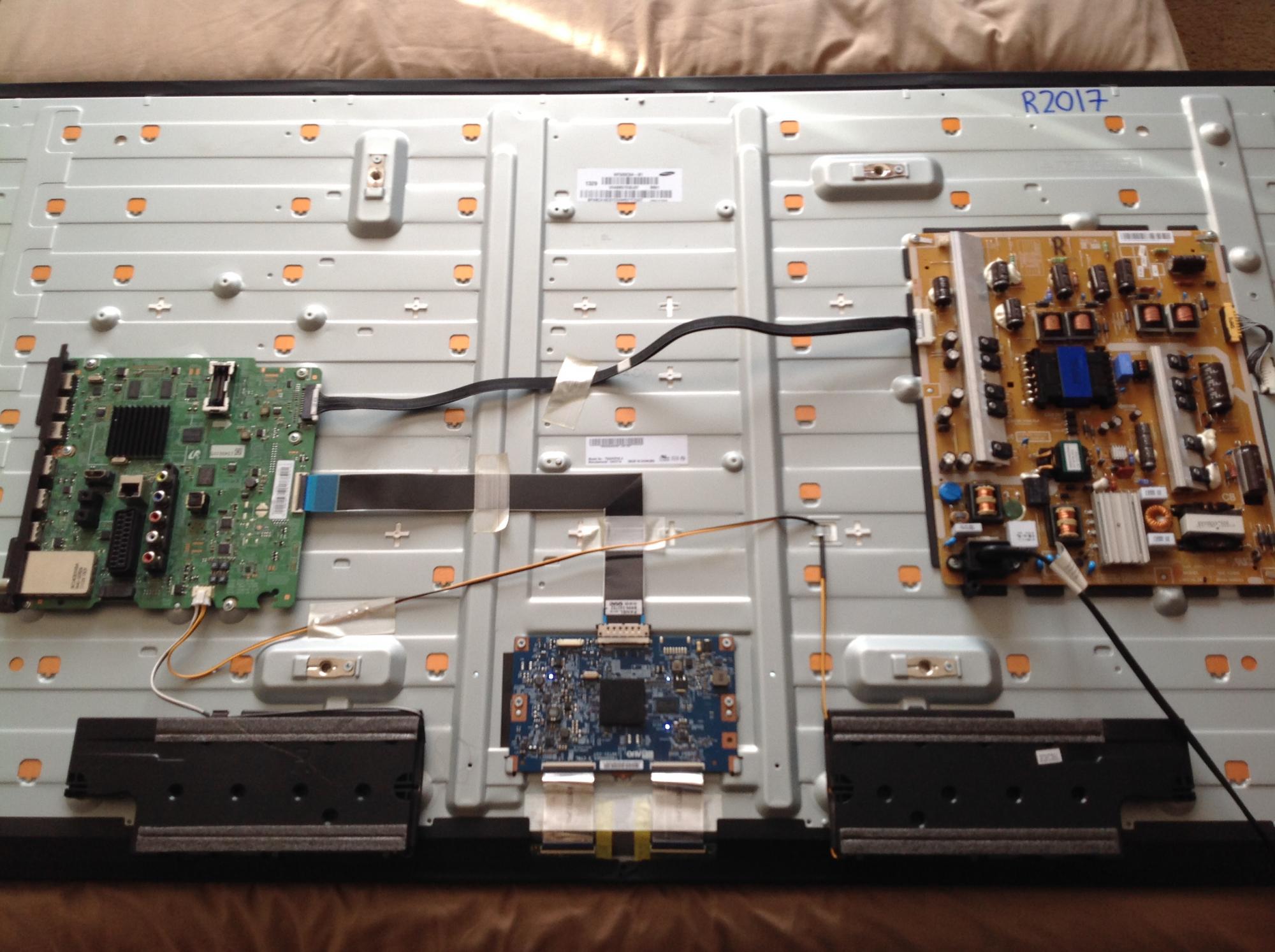

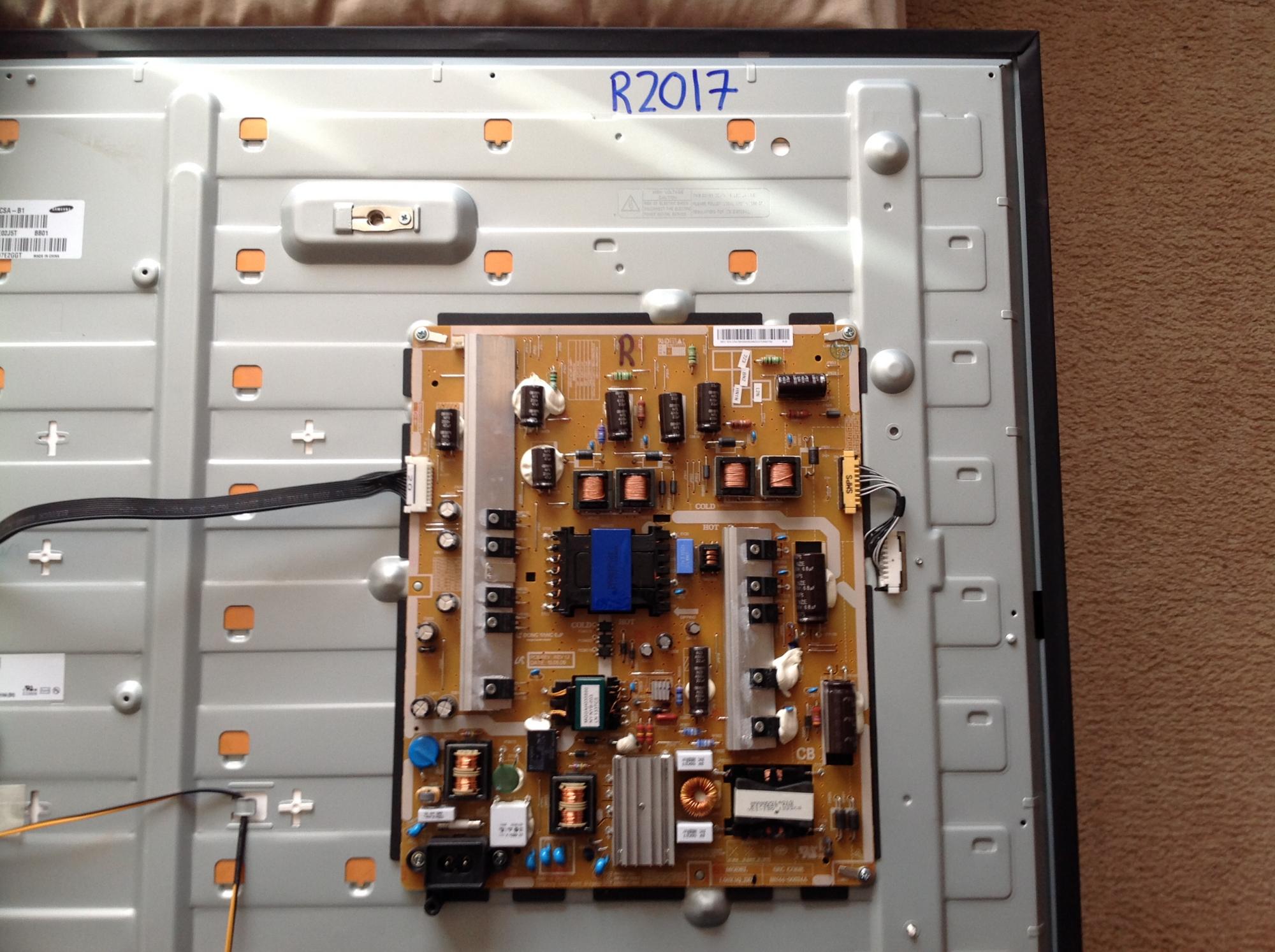

    Samsung UE50F6400 No Standby Repaired

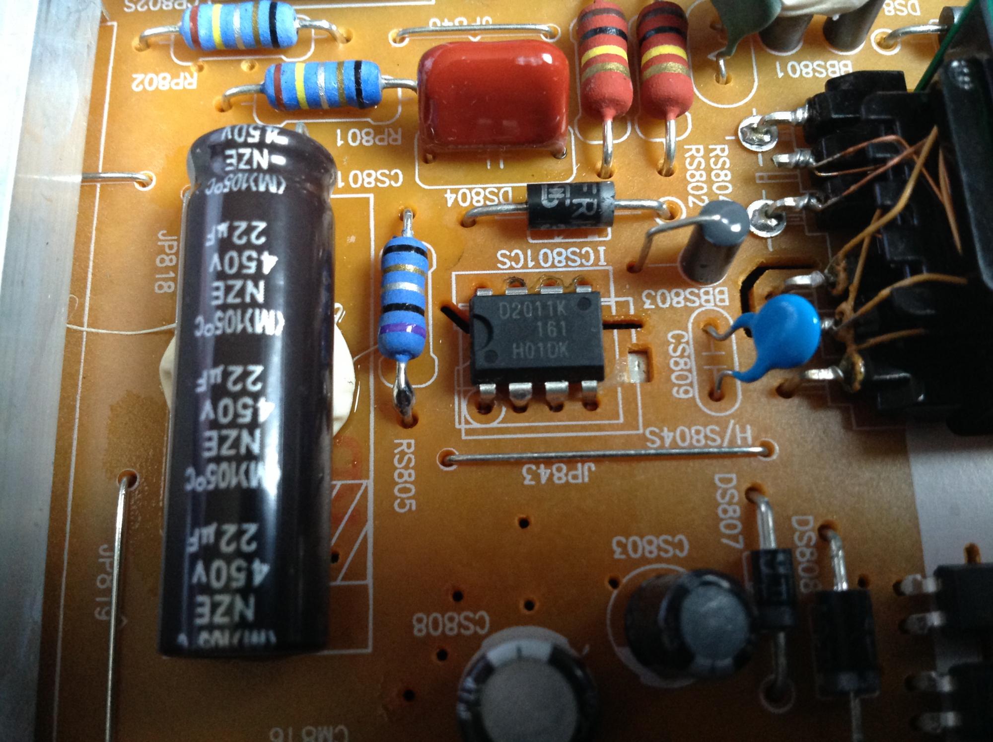

    Right got the nice 50" Sammy Led Tv here, the fault being no standby. Sadly the 5vstby Ic has had a meltdown the Ic number on the board is ICS801CS the part number being D2001K originally it had a hole blown in it. Board number is BN44-00624A by Dongyang.
    The mains fuse was not blown and all the AC input parts are ok, I also checked all the resistors and diodes both SMD and through-hole around the IC nothing was shorted or open. So I changed the IC and the set works good I also did some solder work on the board as there was a few bad looking joints and I also heatsunk the replacement Ic as it appeared to have gotten quite hot.
    Hopefully help someone if you get one of these will upload some pictures

    Look at the board:

      Have to upload these one by one as Vbullet attach doesn't like Safari, but Tv is on I also changed the thermal pad with thermal silicon on the CPU and tight ended all ground screws good:

            I've ran into this too a few times Reecey. Good job. Did you just change the IC as a gut feeling or did you actually use the O'scope in order to proof it?
            • ReeceyBurger123
              Never Give Up !
              • May 2014
              • 7325
              • Britain
              Re: Samsung UE50F6400 No Standby Repaired
              Cheers also, I changed the Ic because it had blew up half it was in the bottom case of the Tv lol
