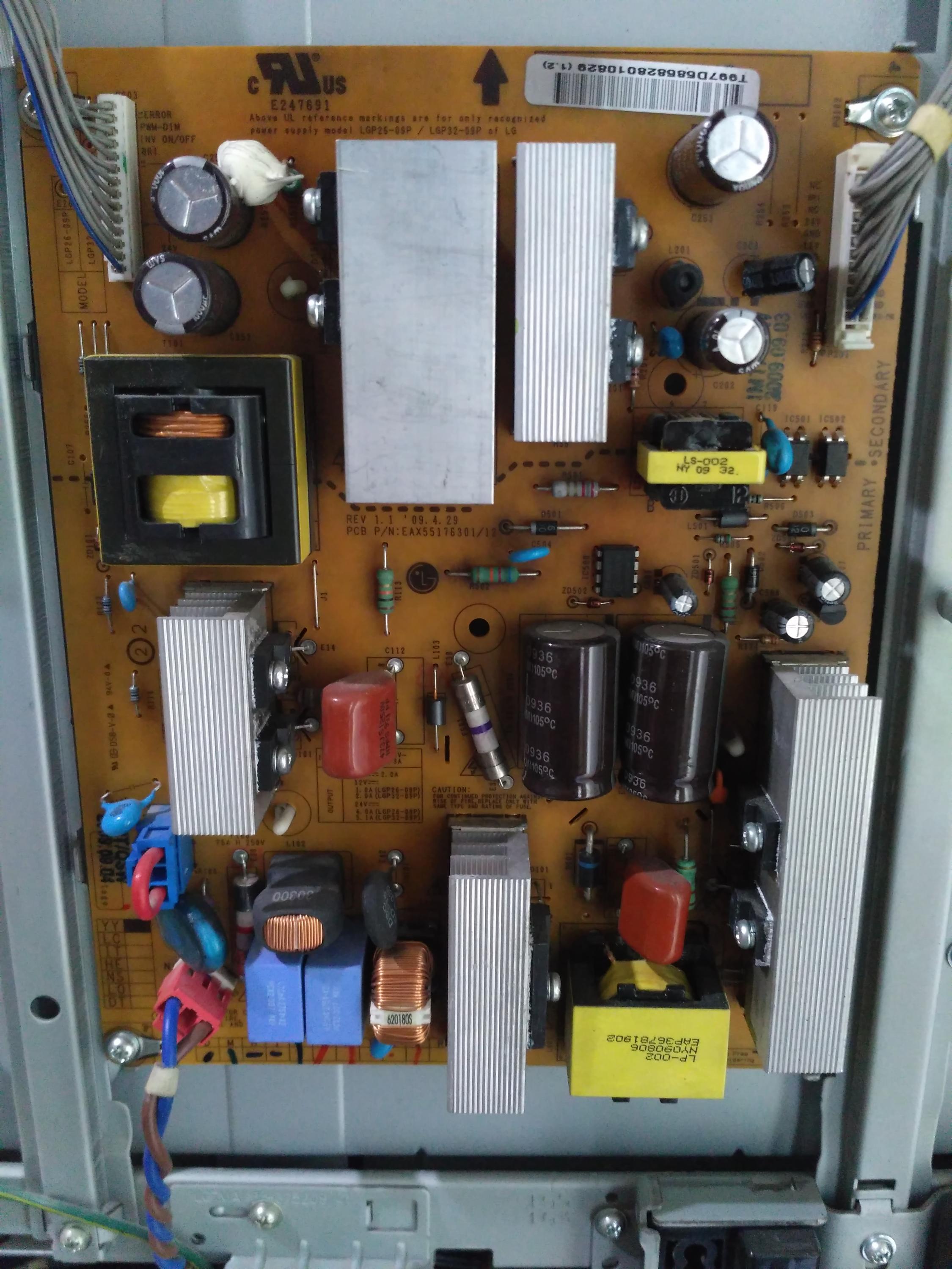

    Hello, i have a LG 32LF2510 that not power up, led red blinking 5 or 6 times, no sound and no picture.
    When i plug, i have 12V, 24V and 5V. The optical audio led is on and the IC100 on the mainboard is hot.
    This is possible to help me to find the problem ?
    Thanks in advance for your help
    Powerboard: LGP32-09P Rev 1.1
    Mainboard: LD91 A/G EAX60686904(2) 09.04.09 N.T.Y

    Do you have backlights? Pson? Need to post voltages. Identify pins and voltages you measure.
      Re: LG 32LF2510 led red blinking 5 or 6 times

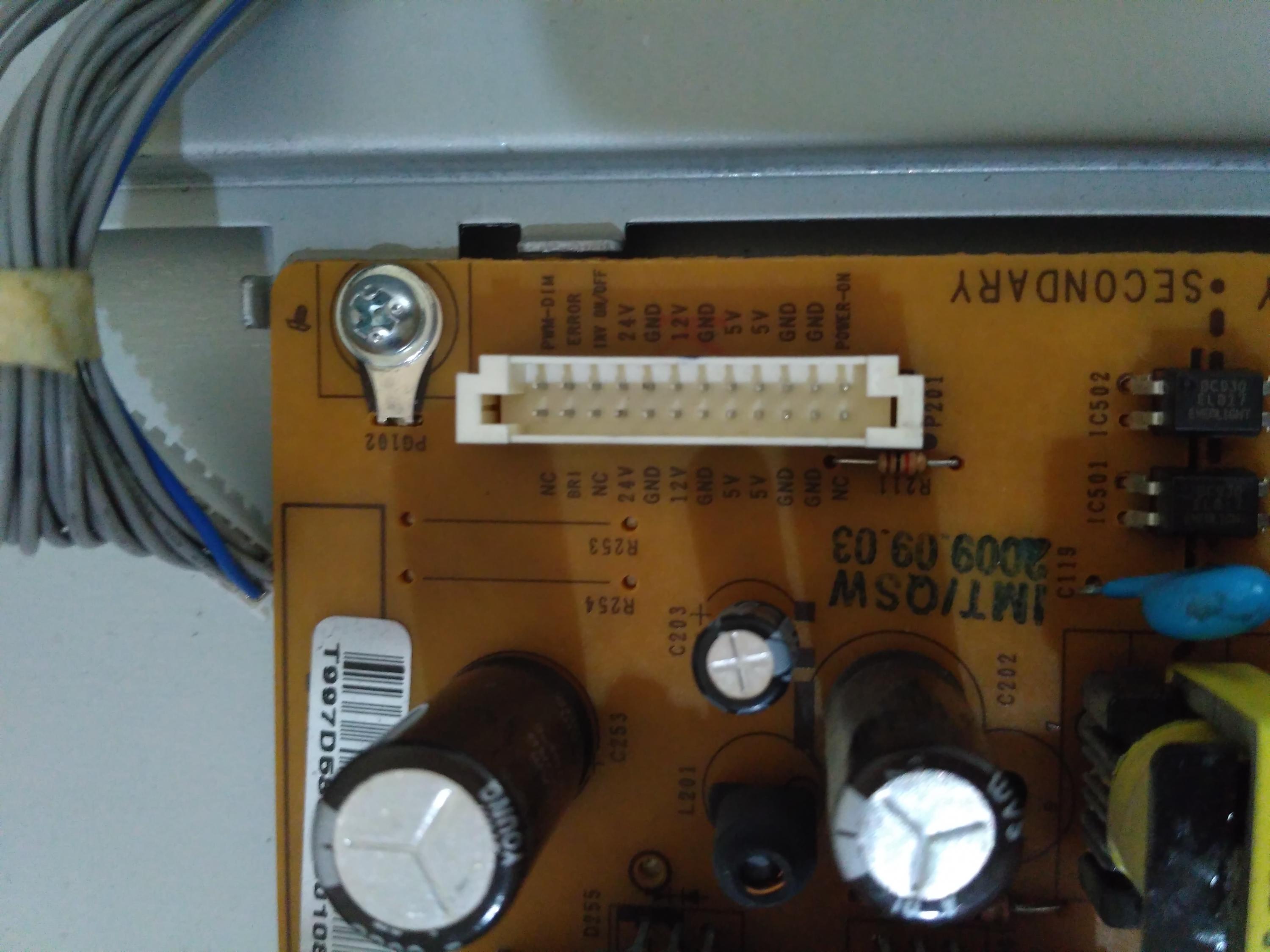

      Power supply board connector pins are labeled so make sure to put down pin name and follow by the DCV reading so we can see what are missing.

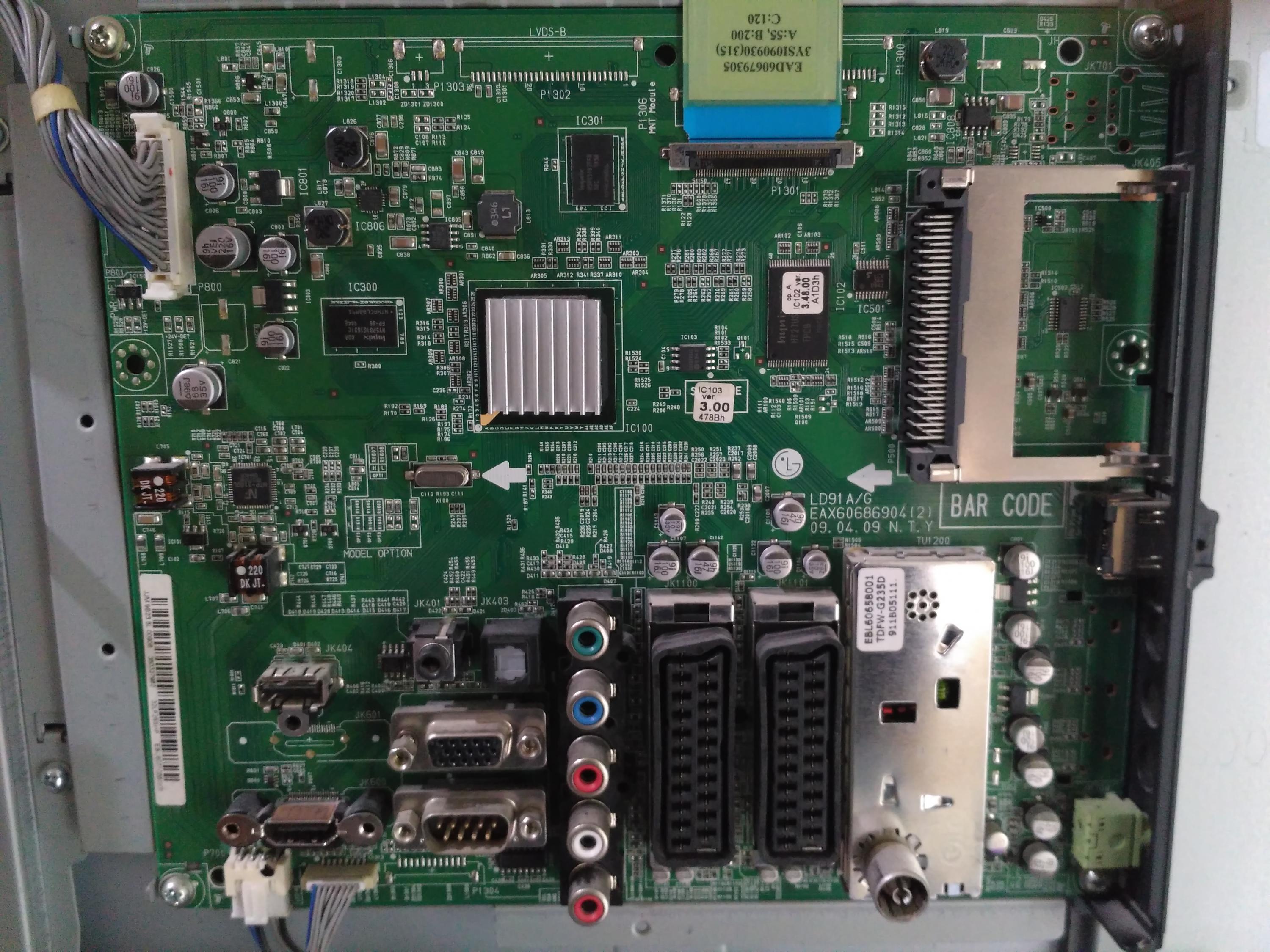

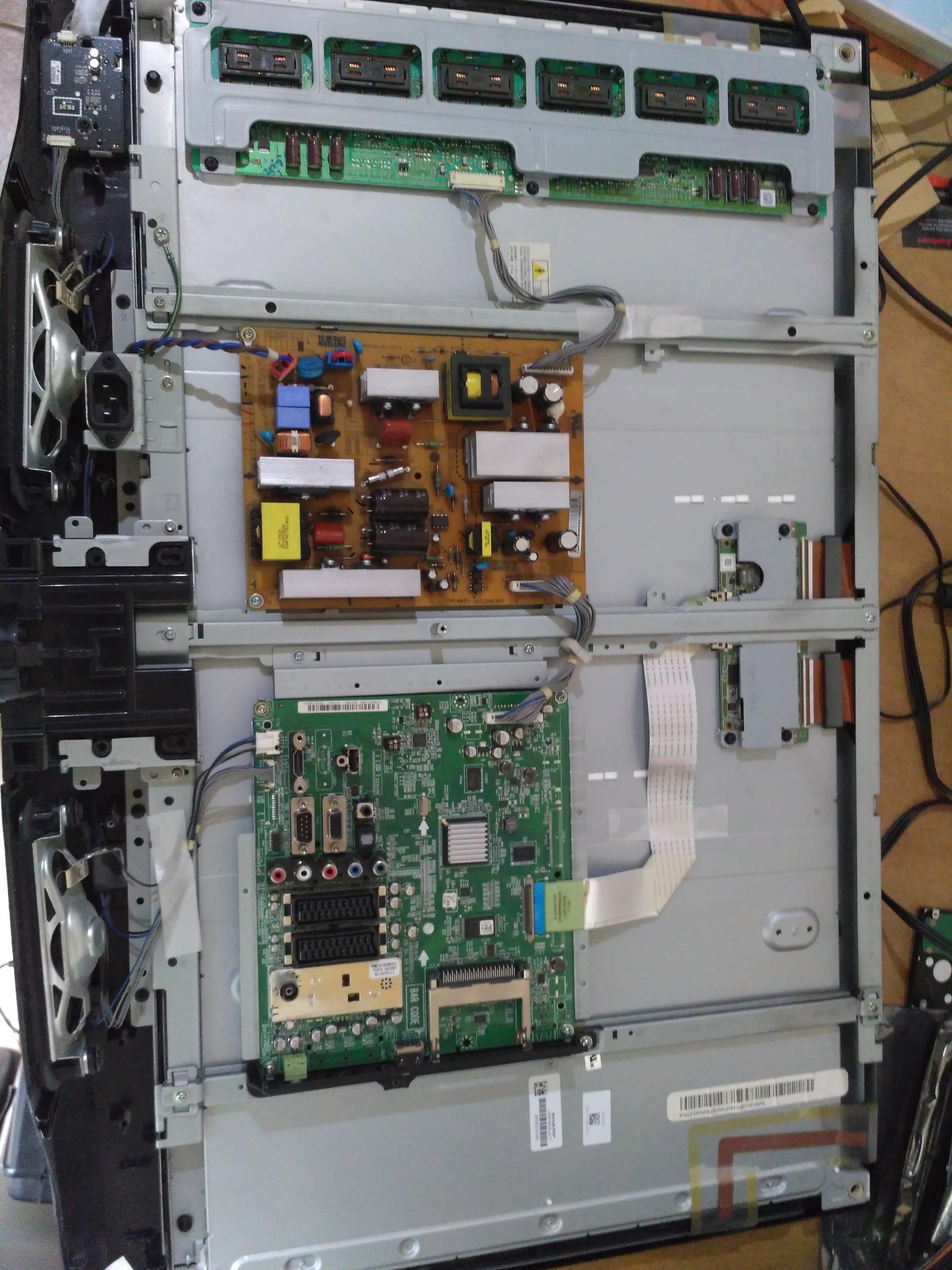

      We also need the pictures of the whole back side of the TV showing all the boards.

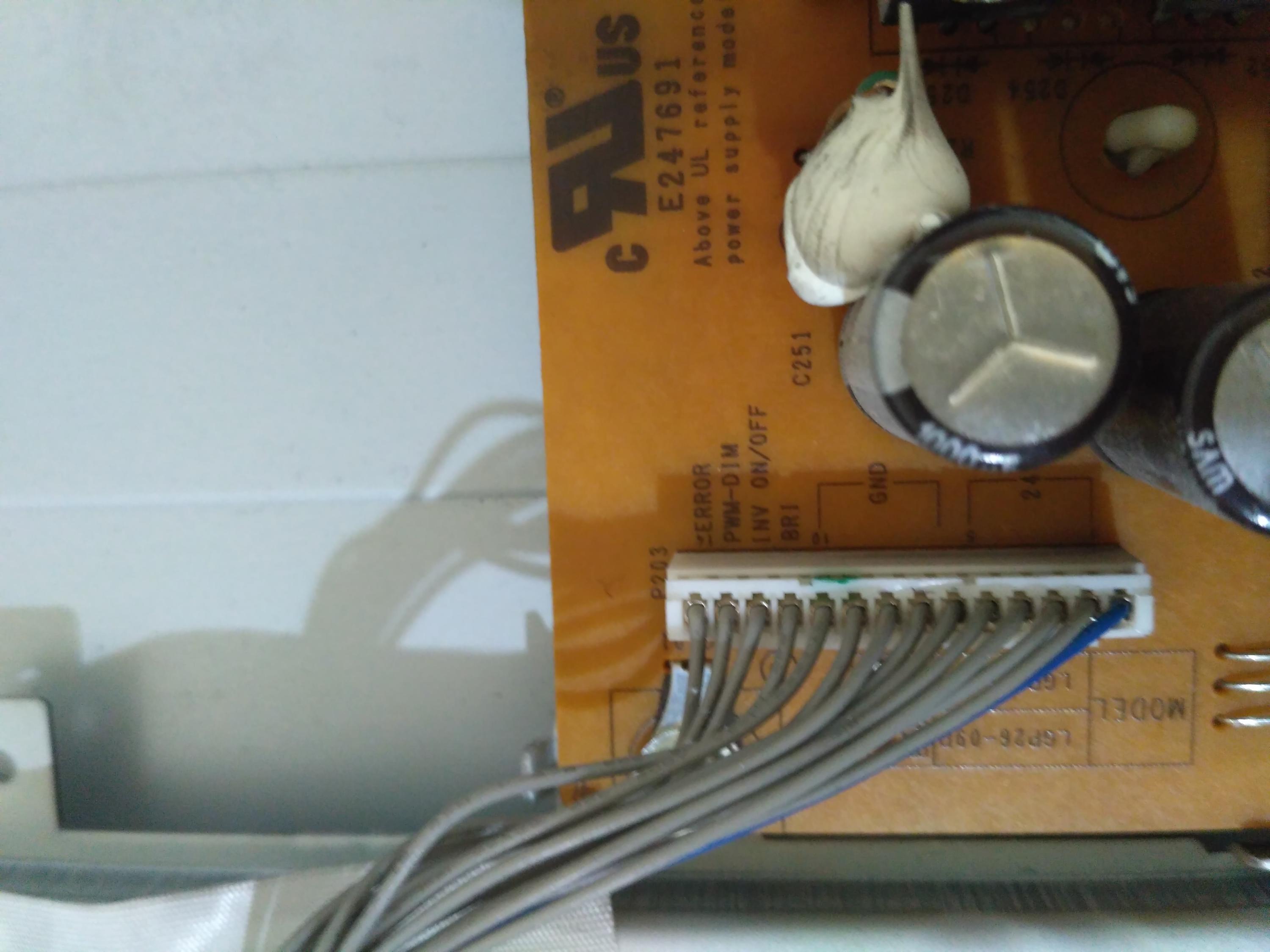

        Hello, thank you for your help. Here is the reading of the voltages on the spindle P201 and P203 of the powerboard.
        P201
        NC. - PWM-DIM :1.14V
        BRI :3.4V - ERROR :1.14V
        NC. - INV ON/OFF :5V
        24V :25.17V - 24V :25.18V
        GND - GND
        12V :11.87V - 12V :11.87
        GND - GND
        5V :5.12V - 5V :5.12V
        GND - GND
        GND - GND
        NC. - POWER ON :5.04V
        P203
        .Error :
        PWM-DIM :1.14V
        INV ON/OFF :5.08V
        BRI :3.40V
        GND .
        GND .
        GND .
        GND .
        GND .
        24V :25.18V
        24V :25.18V
        24V :25.19V
        24V :25.18V
        24V :25.18V
          You do have all the correct command signals.

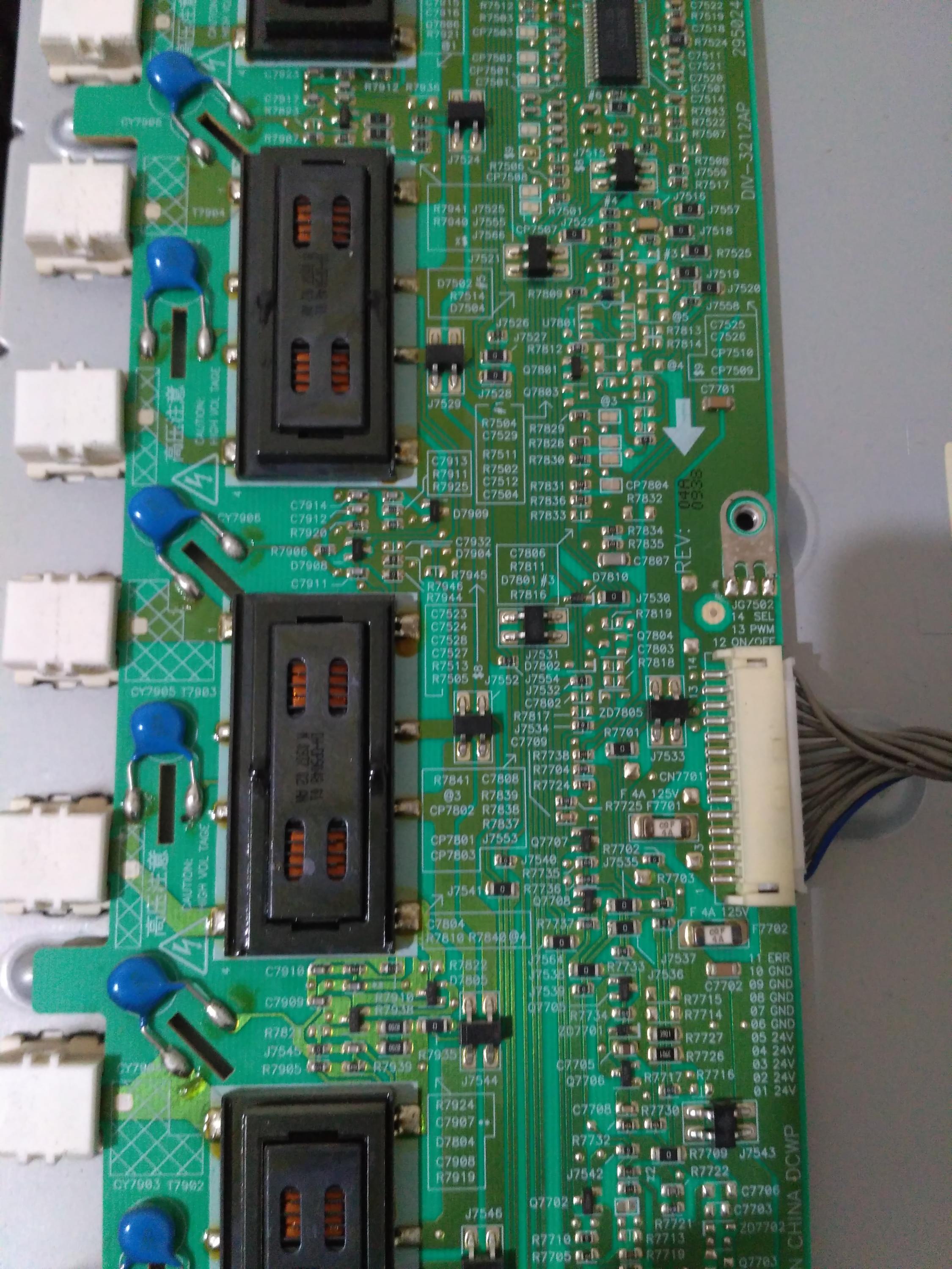

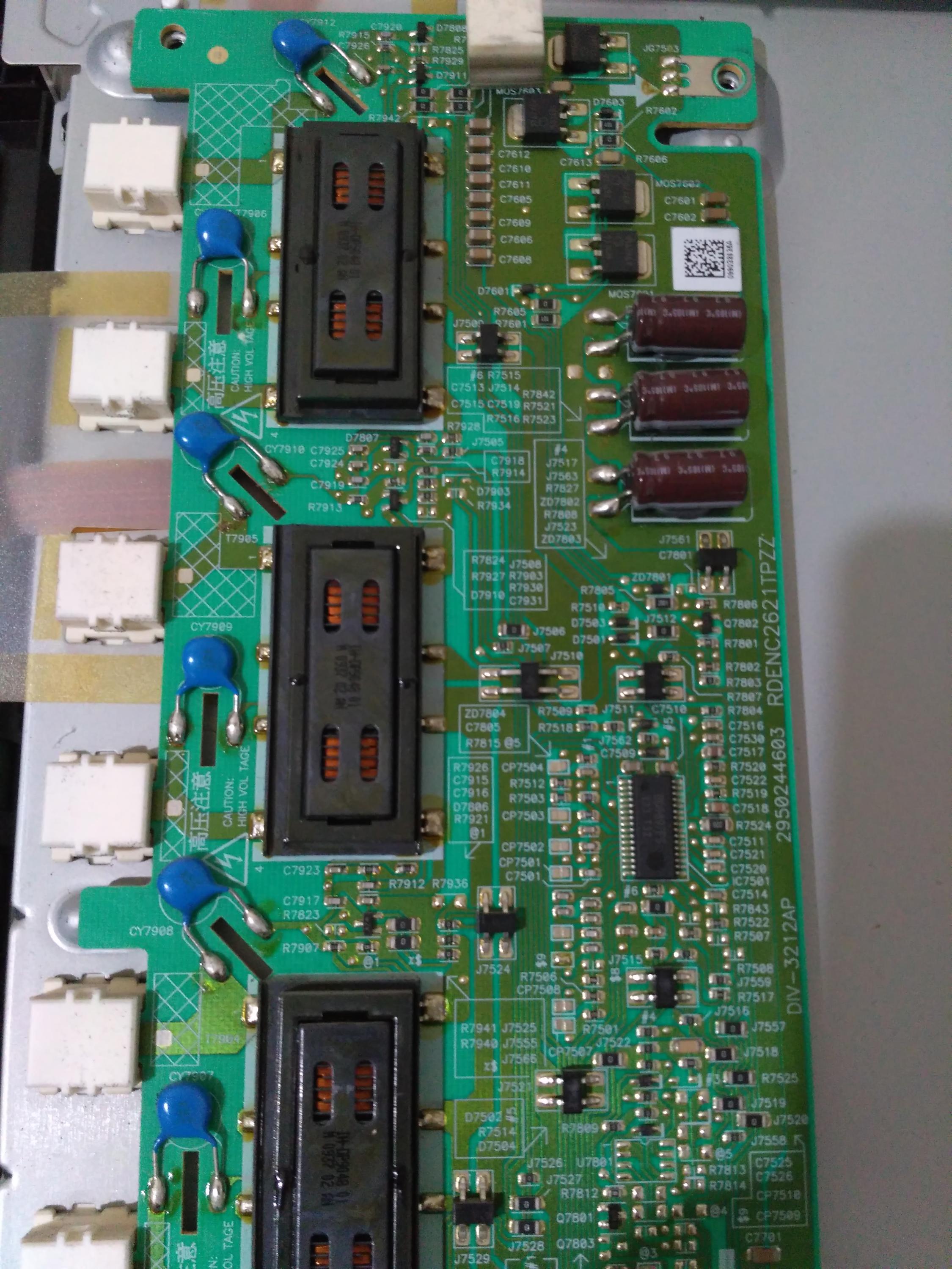

          Do you have backlights? If not then you need to remove the shield from the inverter board and take good clear pictures of the inverter board next.
          How hot is the IC100?
          "Hello, i have a LG 32LF2510 that not power up, led red blinking 5 or 6 times, no sound and no picture." So it stops blinking after 6 times?
            I do not have a backlight and I just see that I have an image.
            The IC100 is about 40 degrees Celsius.
              in your second picture there are two white fuses test the voltage on each side of the two fuses
                I have 25.21V in eatch side.
                  thats ok so none seem blown (did you test both sides of each fuse? some people only check one side) and in a really dark room when you first turn the tv on this maybe only 1 too 2 seconds flash on the screen

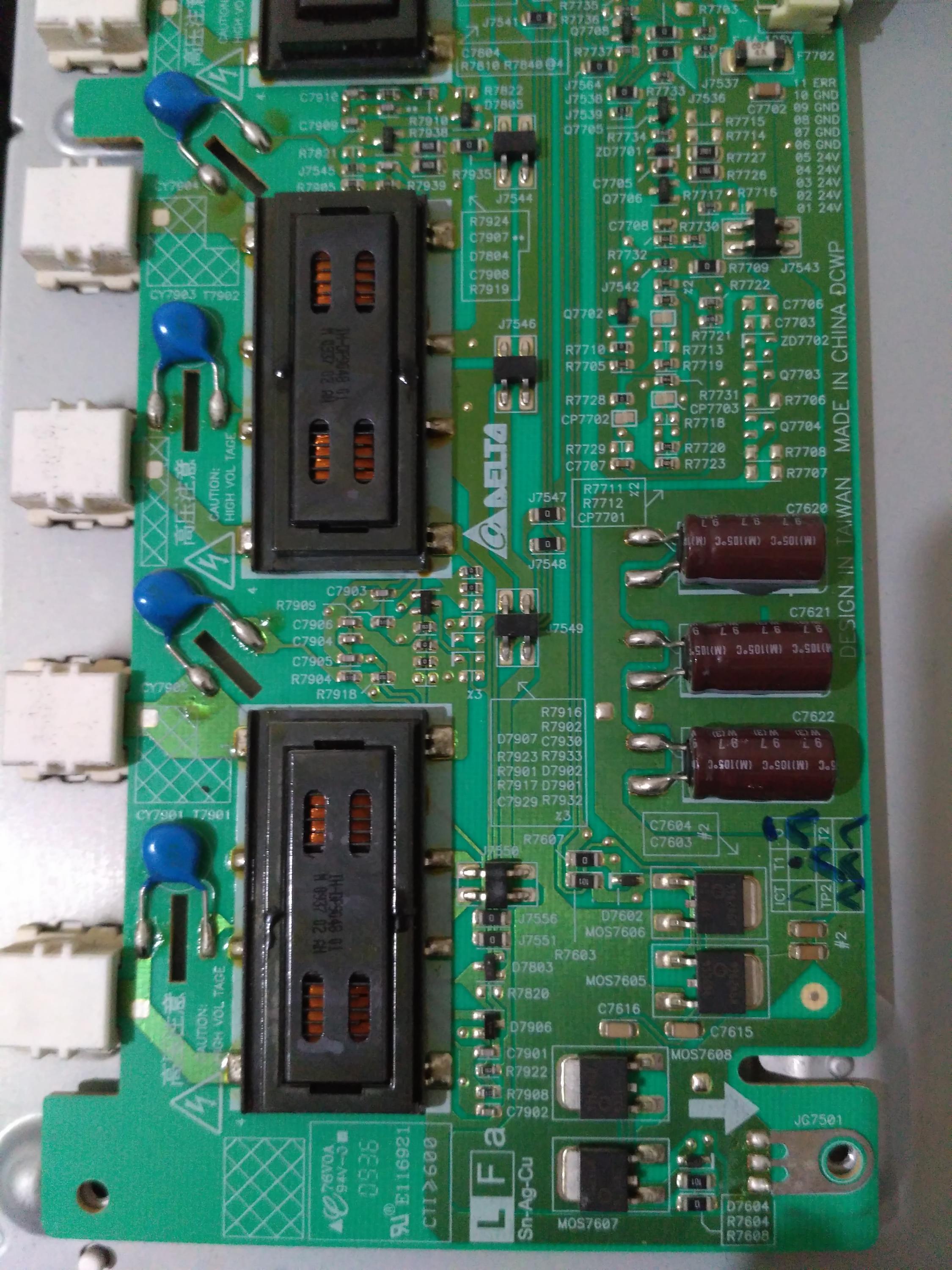

                    Yes I tested well on each side. Negative on chassis and test with positive on each side.
                    I do not see a flash light (I will repeat the test).
                    I find the following voltages on mofsets 7601 to 7608
                    MOS7601: 5.40V
                    MOS7602: 5.40V
                    MOS7603: 0V
                    MOS7604: 0V
                    MOS7605: 5.40V
                    MOS7606: 5.40V
                    MOS7607: 0V
                    MOS7608: 0V
                    it's good ?
                      try the flash test first as this gives us a idea if you have the common 2 seconds to black fault which is usually a failed invertor transfomer of ccfl/eefl tube
                        I just tested and I have no flash
                          hopefully budm will have some ideas what too check next as im still learing myself seems odd you are missing those voltages on those 4 mosfets
                            It's possible coming from the capacitor in inverter ?
                            I desolder them to test ?
