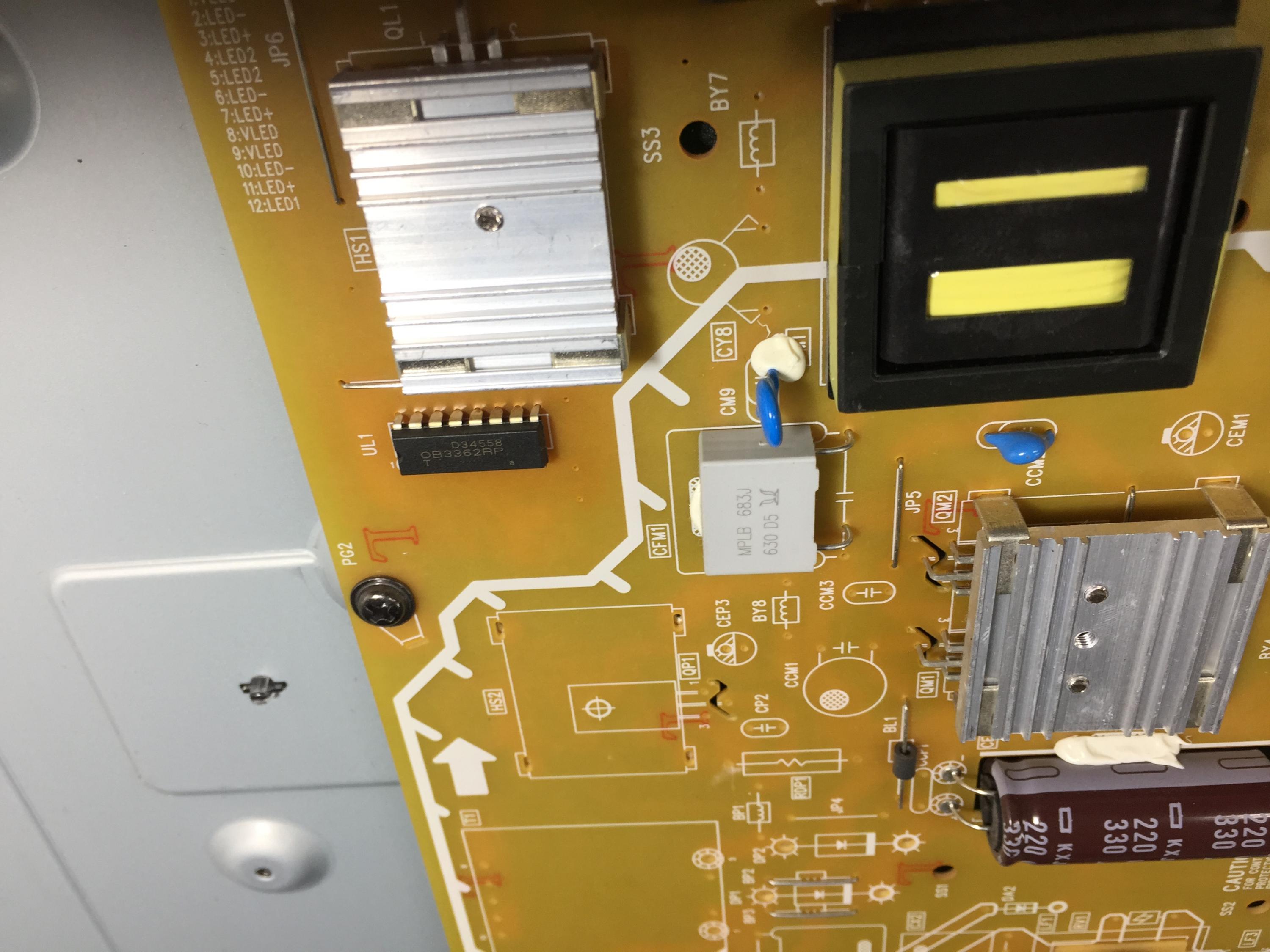

    Hello all,
    TV works great for about a minute and a half, then the back lights turn off. The image is still there under a bright light.
    I changed what caps I had on hand (black caps, greenish blue are original) the latter showed good ESR.
    The chip labeled UL1 gets very hot after just a few seconds, and I suspect this is the problem area.
    Which components near the device should I be looking at?

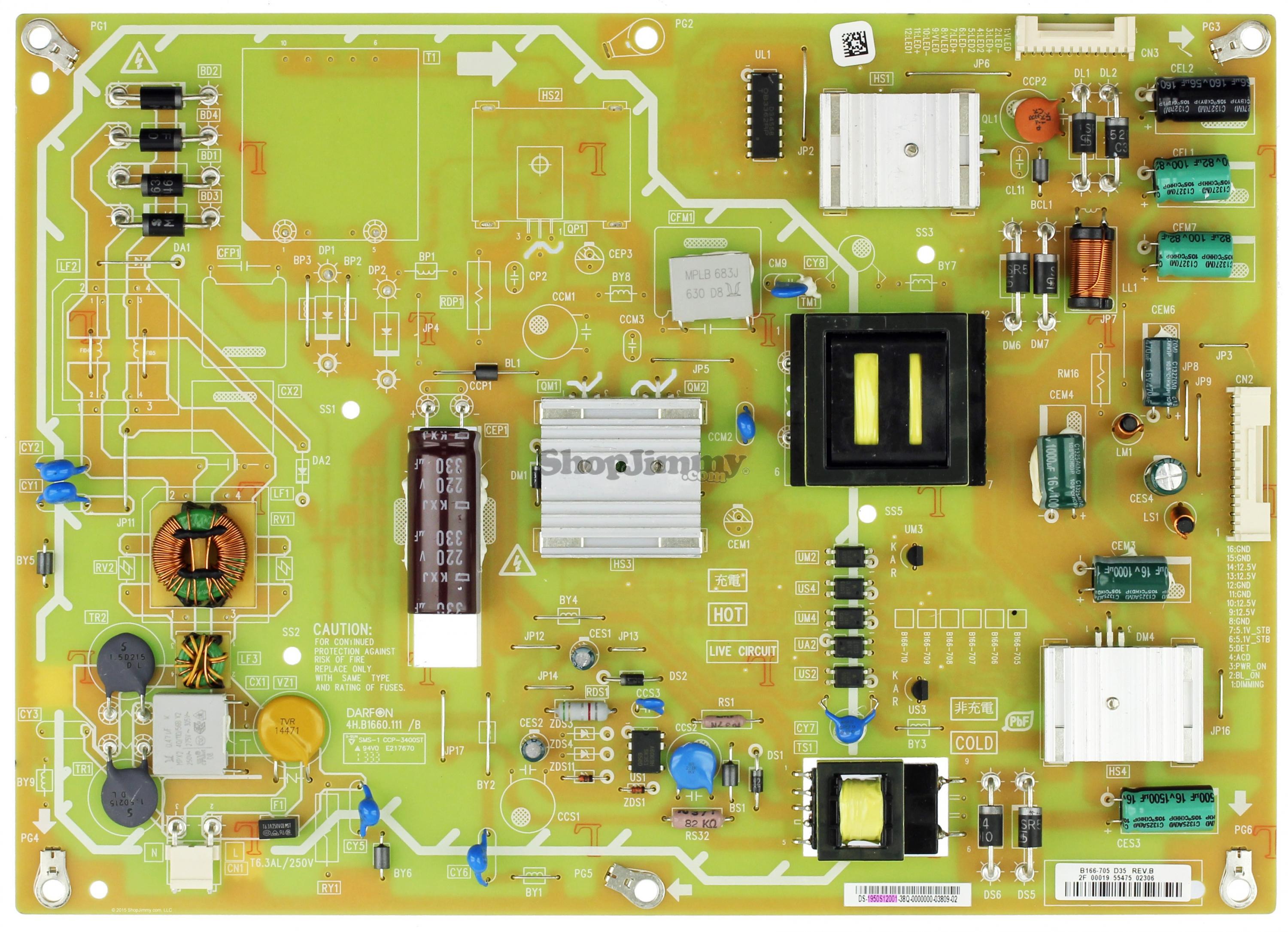

        OB3362: LED driver IC.
        It is over heated is probably due to too much LED sink current flowing through the IC or something in the boost converter section of the IC.
        I will not be surprised if one or both of the two LED strings have some shorted out LEDs.
        You should also remove the LED connector, the one with RED/WHITE/BLUE/Black and then turn on the TV to see if it still get hot, it should not because it should go into shutdown due to no load.
        You should also check the resistance between the chassis GND against each one of those 4 wires (connector not connected to the board) to see if we have any resistance reading, it should not have.
        Insignia 19.50S12.001 Power Supply / LED Board
        http://www.shopjimmy.com/insignia-19...led-board.htm#
        Pictures provided by shopjimmy

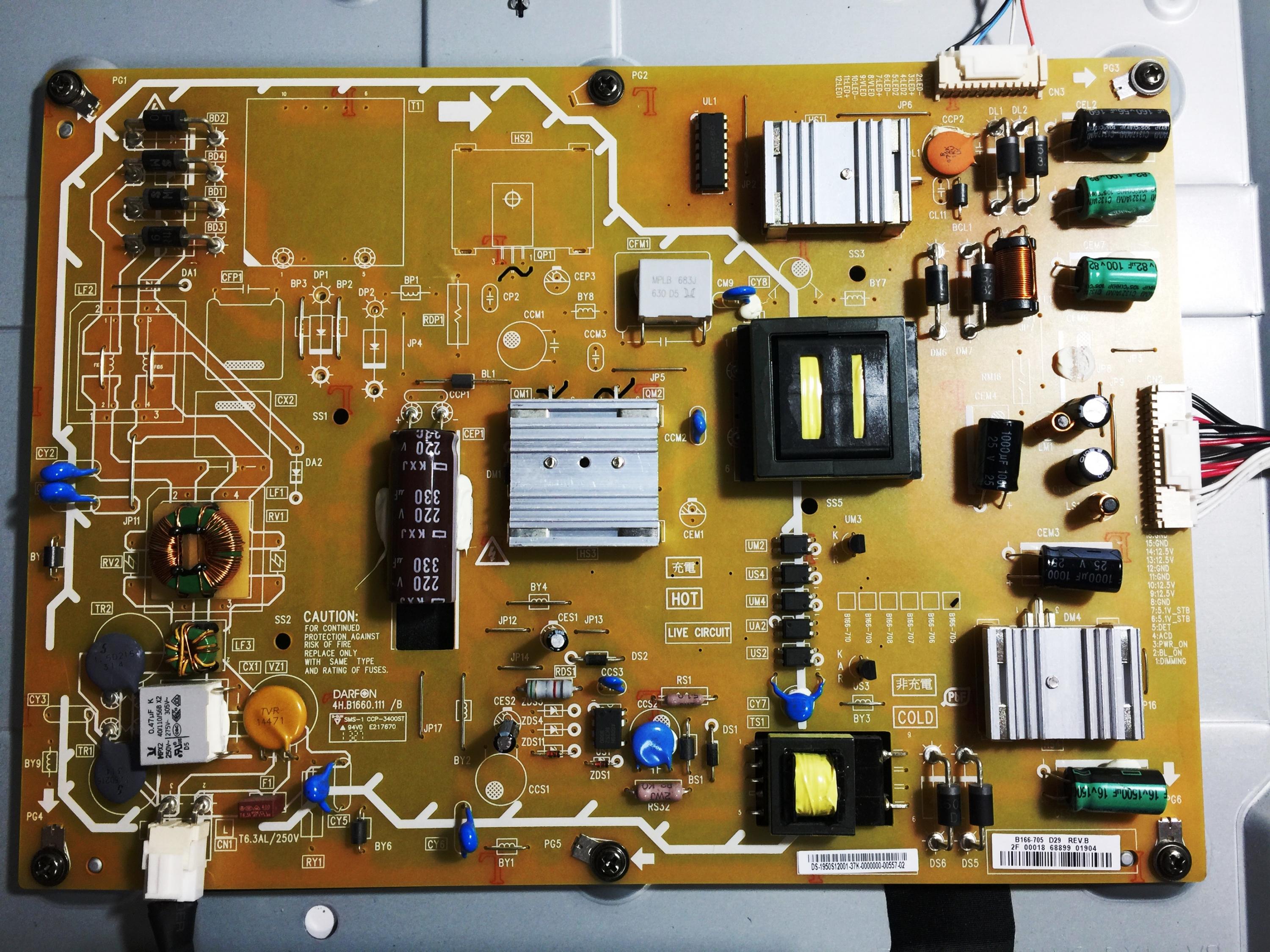

                      I have the same problem with the same model. IC chip UL1 does get very hot after about 3-5 minutes back light shuts off.Press power button to turn off and then press power button and back light comes on just briefly. I took a old aluminum heat sink and sort of attached it to the IC and TV ran for several hours and the heat sink just gets a bit warm. I see no dark areas on the picture when it is up and running. My thought is the current limiting resistors are to small of ohm value and can't restrict the current flow to the LED's. I just don't know which resistor or resistor bank is the problem. The heat sink works well, just need a way to permanently attach the heat sink.

                                    I actually ordered a new /used power board on Ebay. Same discoloration on board under UL1 chip. At least the board works, mine, I short circuited. After ordering 2 LED strips and testing, all LED's are working now but after assembly, same problem. I know it is Micky Mouse but I took a cooling fan and heat sink, drilled thru power board (making sure no traces where I drilled). The heat sink came from a Video card and I did have to do modifications to the heat sink. Anchored the heat sink with fan on top of chip with the 2 plastic pins that anchored the heat sink on the video card. Applied heat sink compound before mounting the heat sink. Tied in the fan to a on/off 12 volt power source (CEM4 capacitor) and can now watch the TV for as long as I want.So far over 5 hours at a time. Heat sink gets slightly warm. Was going to use a 5 volt fan but all 5 volts on the board stay on all the time.
