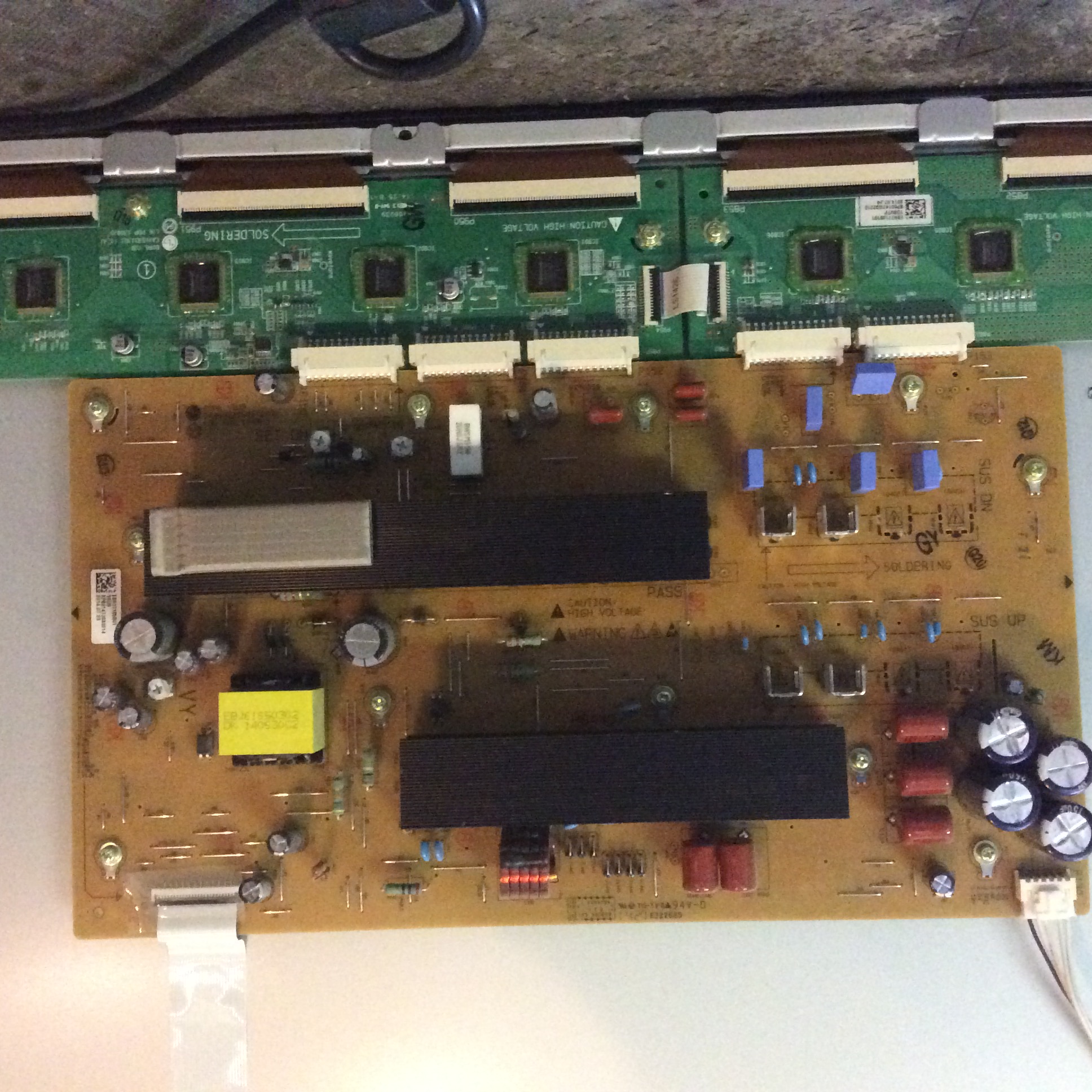

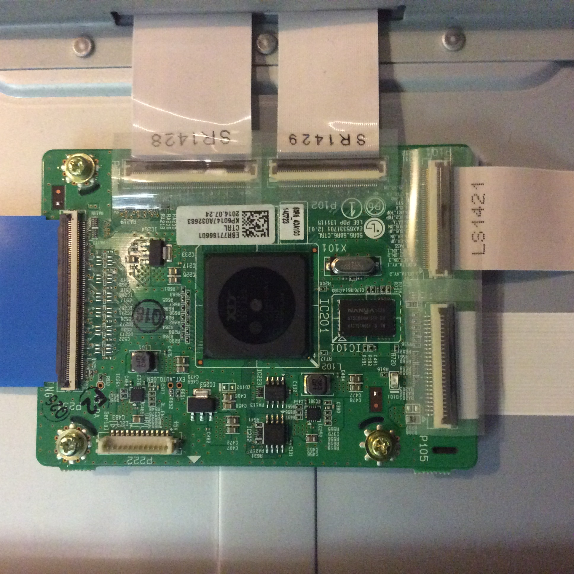

    I am just learning about Plasma and LCD/LED TV's and have an LG 60PB5600 that turns on but no picture or menu. It does power up with a white screen flash. The blue indicator light on the front of the set flashes when I press the menu button, but no menu appears on the screen.
    The vs and va voltages are according to the label as are all voltages on the connector to the main board. (RL_on =3v)
    After reading other posts, I tried getting the test patterns but no success. I jumpered EXT_AUTO_GEN, unplugged the blue ribbon from the main board, unplugged P231 from the main board and jumpered RL_on to 5.2v. Then plugged the set in and turned it on, but all I got was flashing green LED on the control board.
    At first it was three short and one long pattern. Now it is four long flashes.
    Where do I go from here? Thanks for sharing your knowledge.

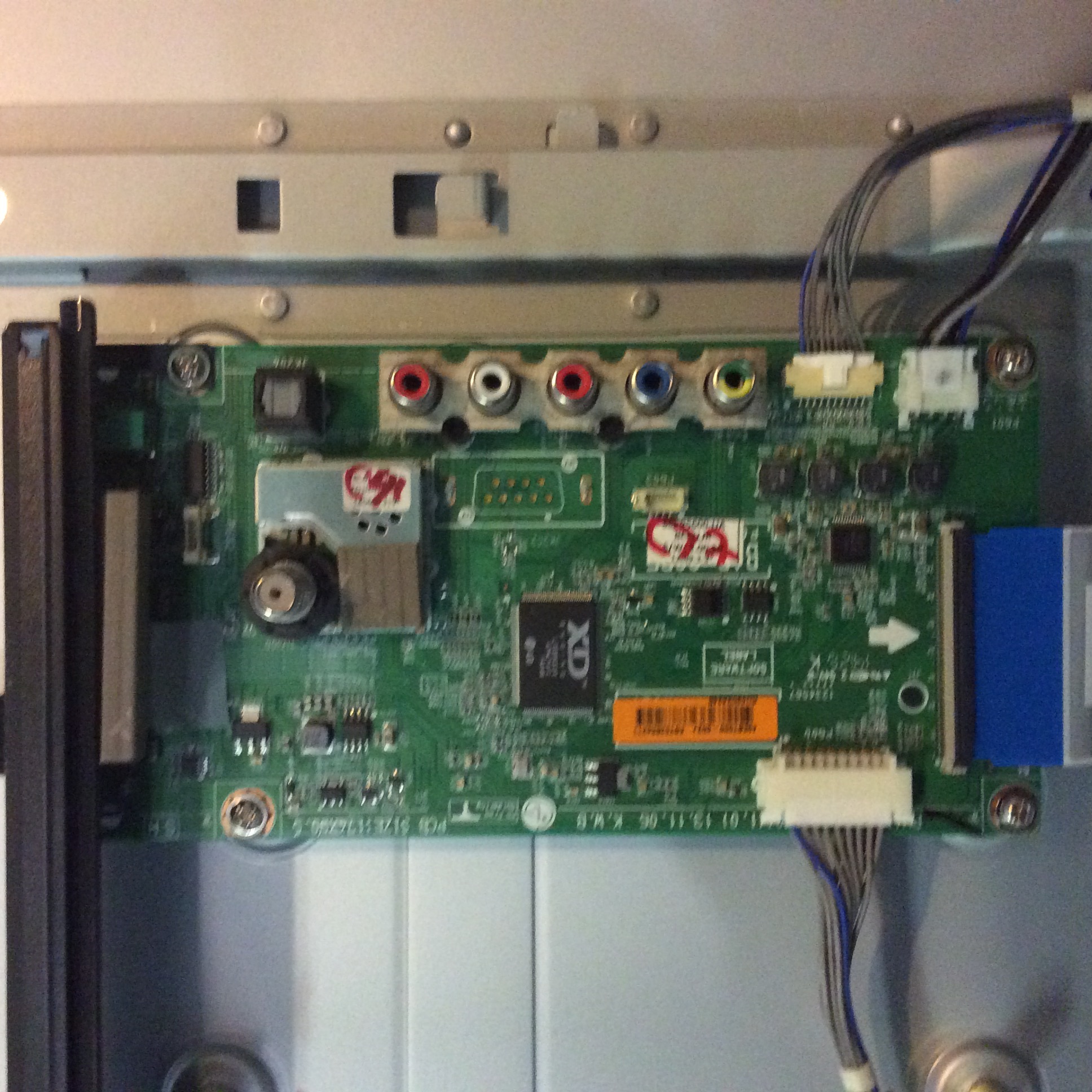

    Pictures of the boards?
    Need to check vsc and Vy test points on the ysus.

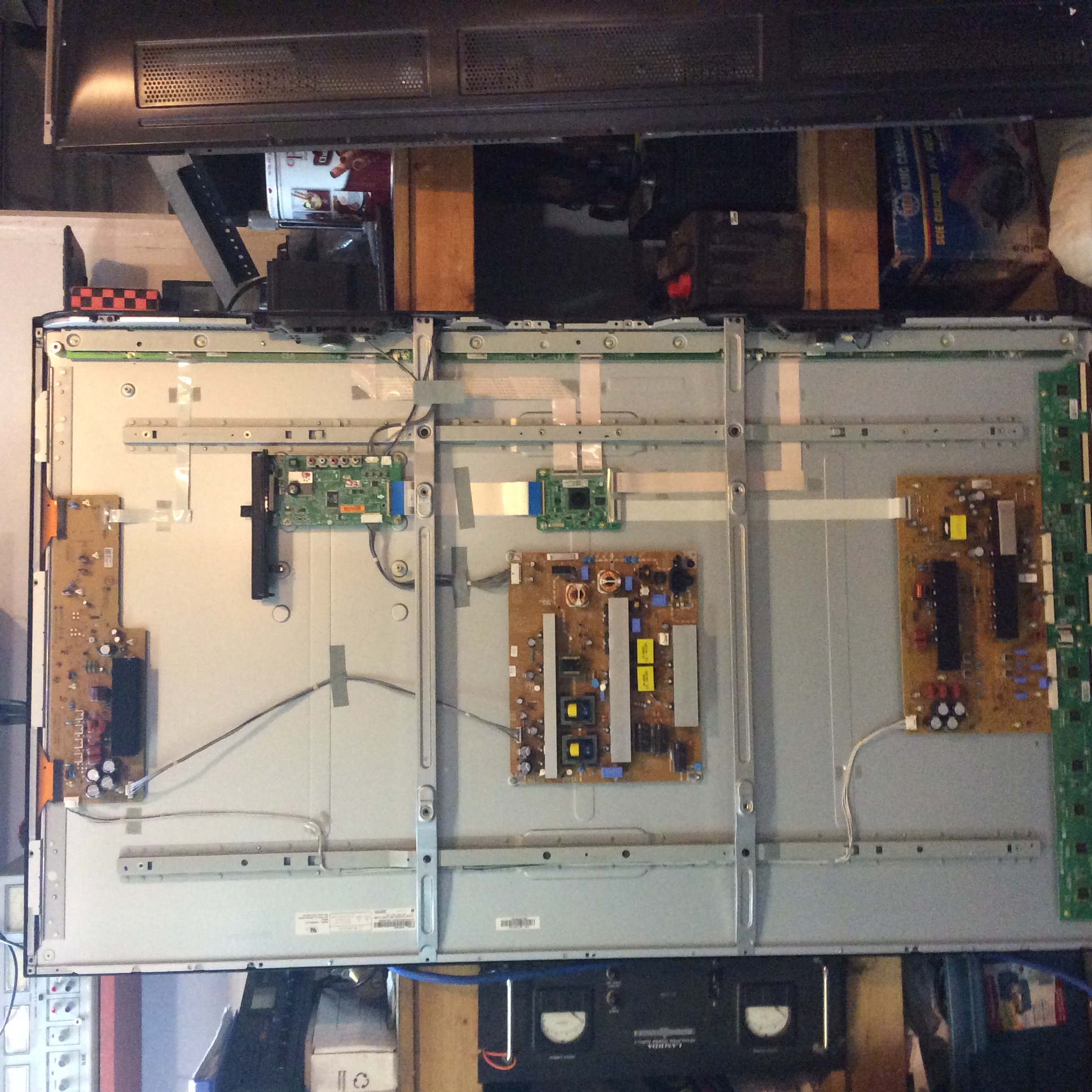

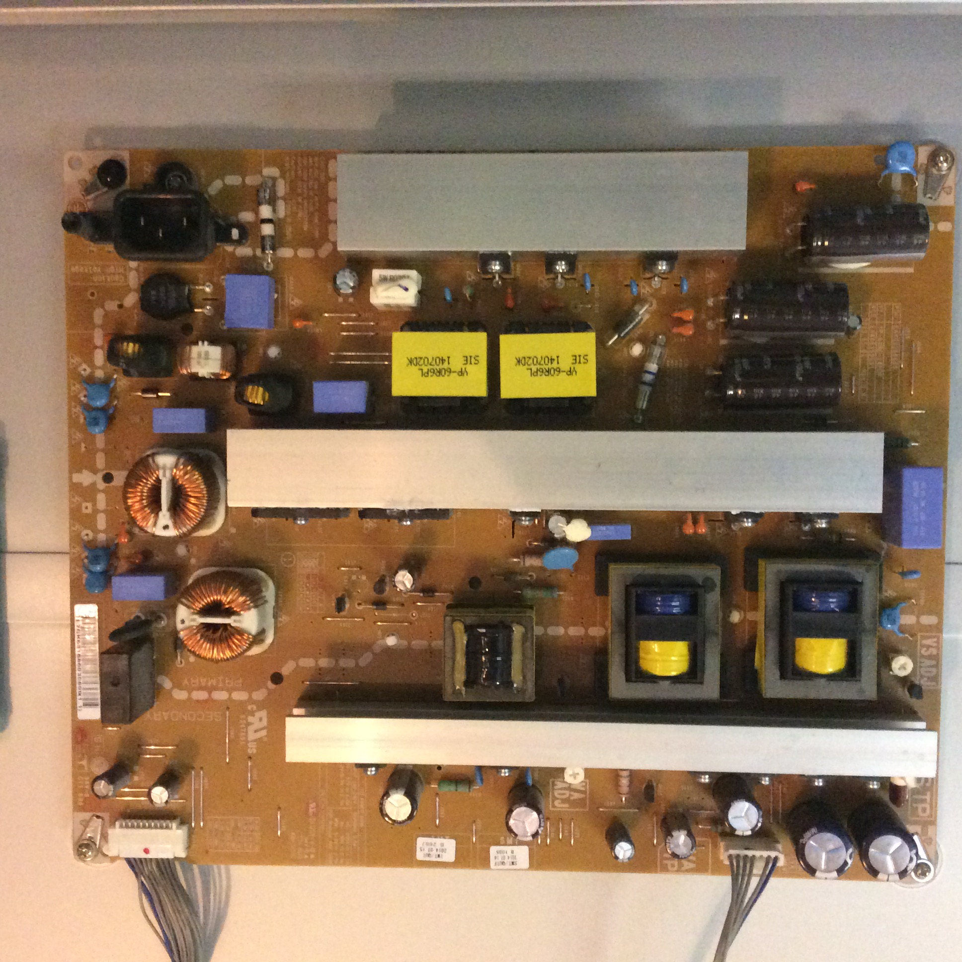

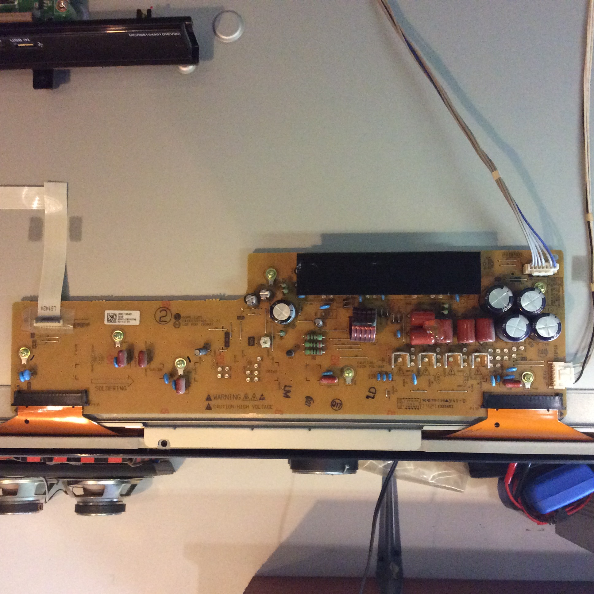

      Ok so here are a set of pictures.
      Measurements are vsc on P152 is at 235.7 vdc, and vy on the test point is 85.4 vdc.

        Ok, so after looking at the other messages on this tv, I did more checking.
        Voltages on y-sus board at P152 connector are:
        Vpp = 235.2v
        Vsc = 235.2v
        5vf = 90v
        Sus_on = 85v
        On P151 at pin 7 there is "15vf" = 100v
        Va on the power supply = 54.7v and the same on the z-sus board.
        I checked the four igbts Q401, Q404, Q405 and Q406 and none are shorted but test as diodes.
        So should I be looking at a Main Board? I have white screen flashes at power up, and sound is working, just no picture or menus.

          In addition Imchecked the following voltages at the power supply connector P813
          M_on = 3.06v
          RL_on = 3.1v
          5.2 = 5.2v
          17 = 17v
          AC_on = 5v
          17v_det = 2.5v
          VS_on = 3.07v
          vs_det = 2.5v

            Remove buffer and recheck vy and vsc.
            • Srtech
              • Jan 2017
              • 19
              Re: 60PB5600 no picture

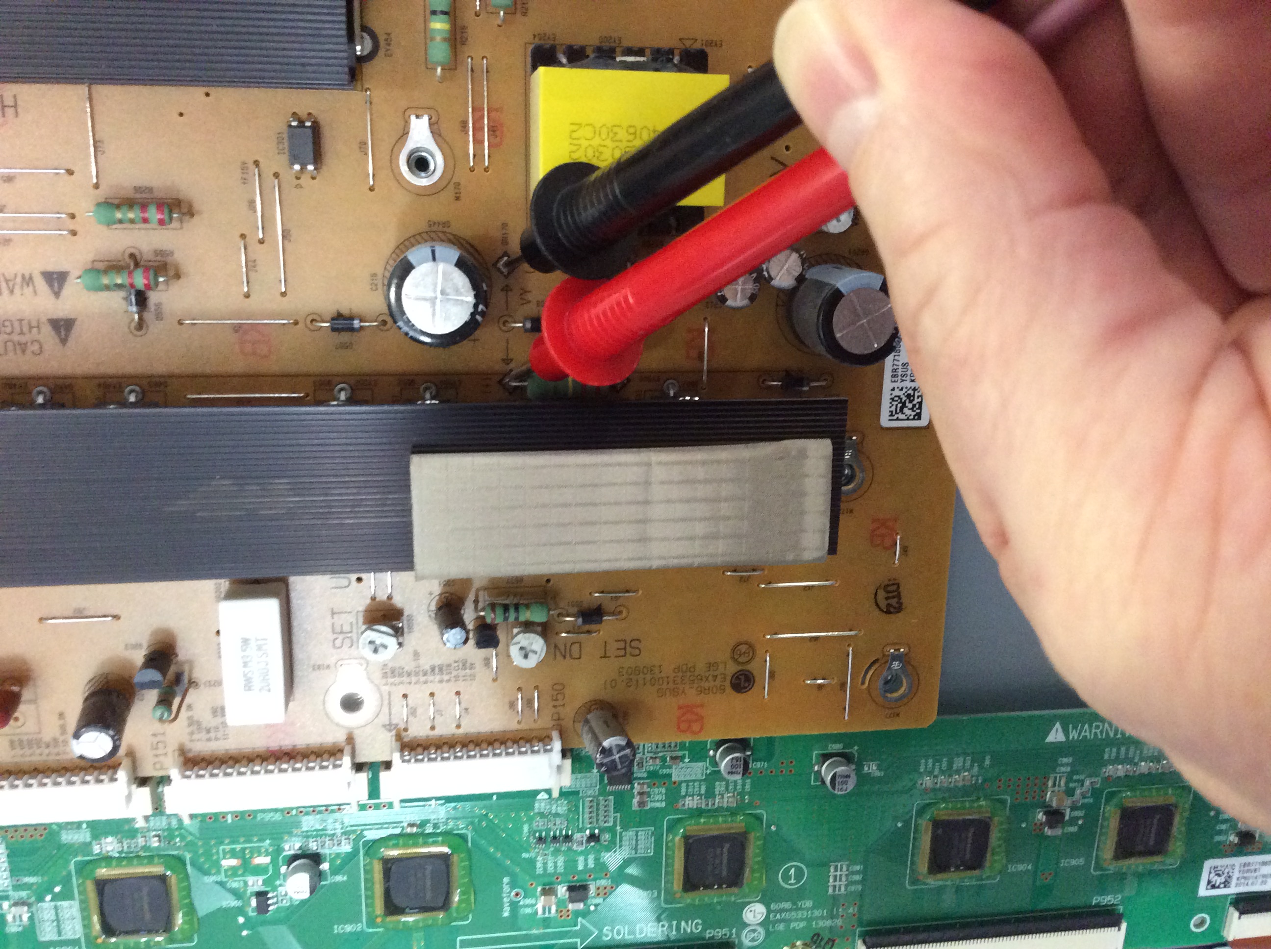

              I am not sure where vy is accessible as I don't see a clear identification on the y-sus board.
              However at GR 170 = 84.7v
              And at GR250 = 271v, since they are marked as vy - and vy+ respectively, I assume vy is the difference of 187v. It is the same with the buffer disconnected.
              With buffer connected vsc = 235.3v measured at P152, but with the buffer disconnected vsc = 0v at P152.
                No
                black probe to -
                Red probe to +
                    Ok the vy voltage reads 187v DC and is the same with both buffers disconnected.
                      Like this?

                        OK y-sus is probably OK.
                        When you first turn on the tv do you get a brief flash of the screen? Or does it always remain pitch black?
                        • Hamie
                          • Apr 2014
                          • 1383

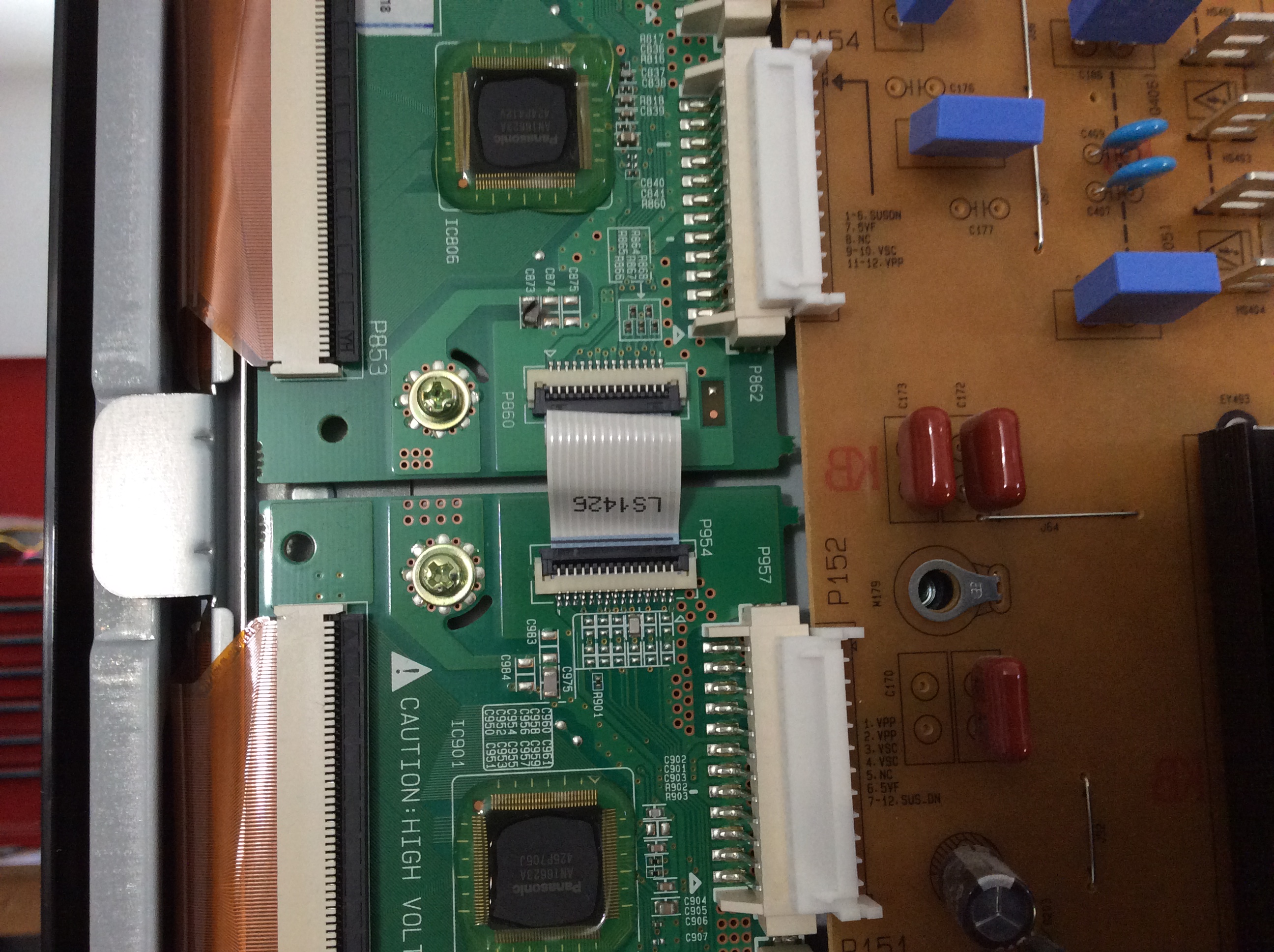

                          Do you see where the top buffer connects to the bottom buffer. (white flat cable)
                          There are some smd capacitors, can you tell if any are shorted?
                              Yes I see three caps and measure two at 0.01uf (shorted I assume) and one at 35uf. One is blown apart also!
                              • Hamie
                                • Apr 2014
                                • 1383
                                No probs, check those smd caps, that may be your only problem and you can fix this for practically nothing.
                                      So for resistance two are open (C873 & C975) and C956 measures 5k.
                                      C873 is broken also.
                                      • Hamie
                                        • Apr 2014
                                        • 1383
                                        Yeah I though it was just your photography that c873 is actually split in 2!
                                        The other 2 are probably OK.
                                        OK so change it out, give me few minutes I need to get the exact value.
