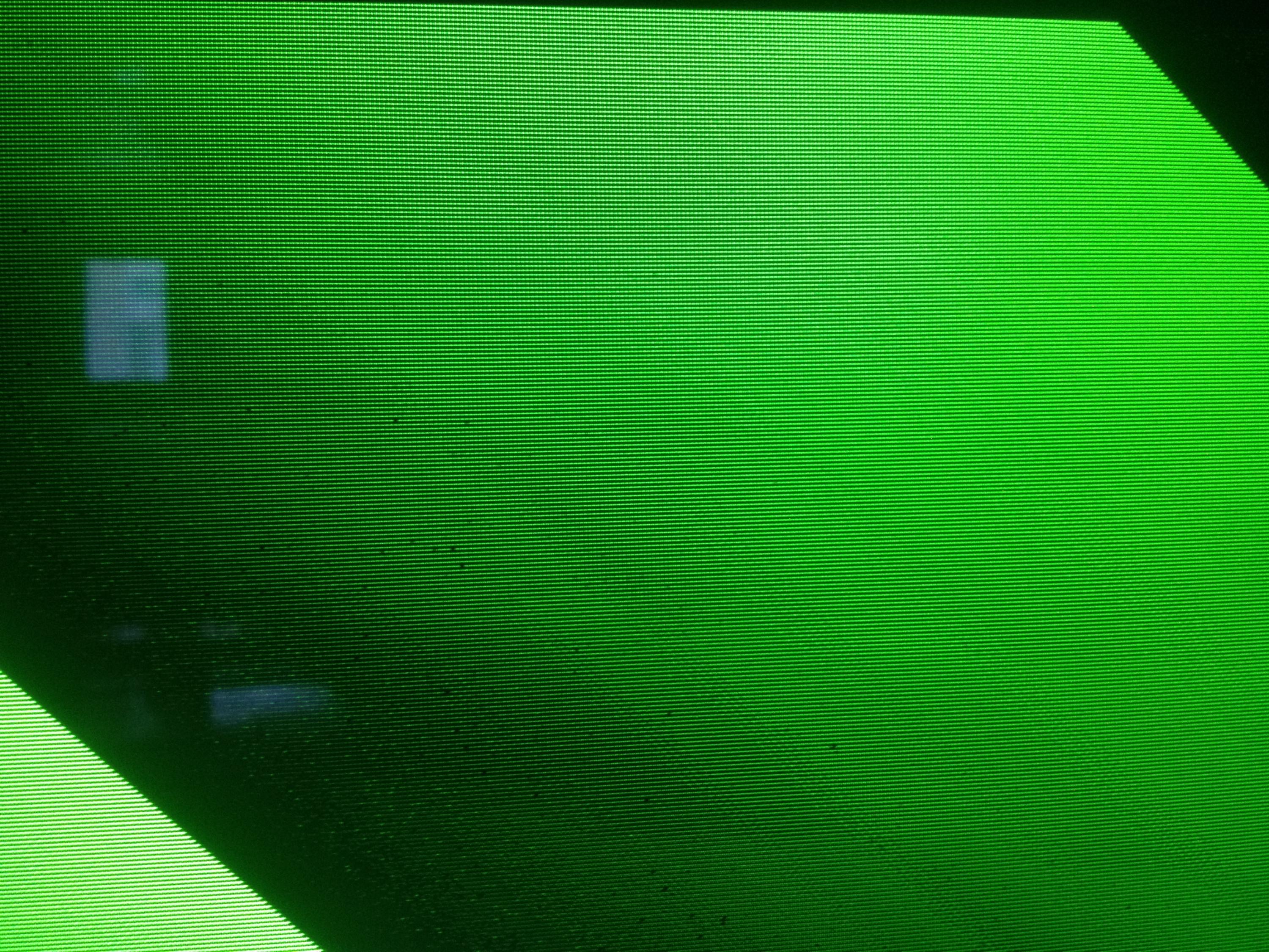

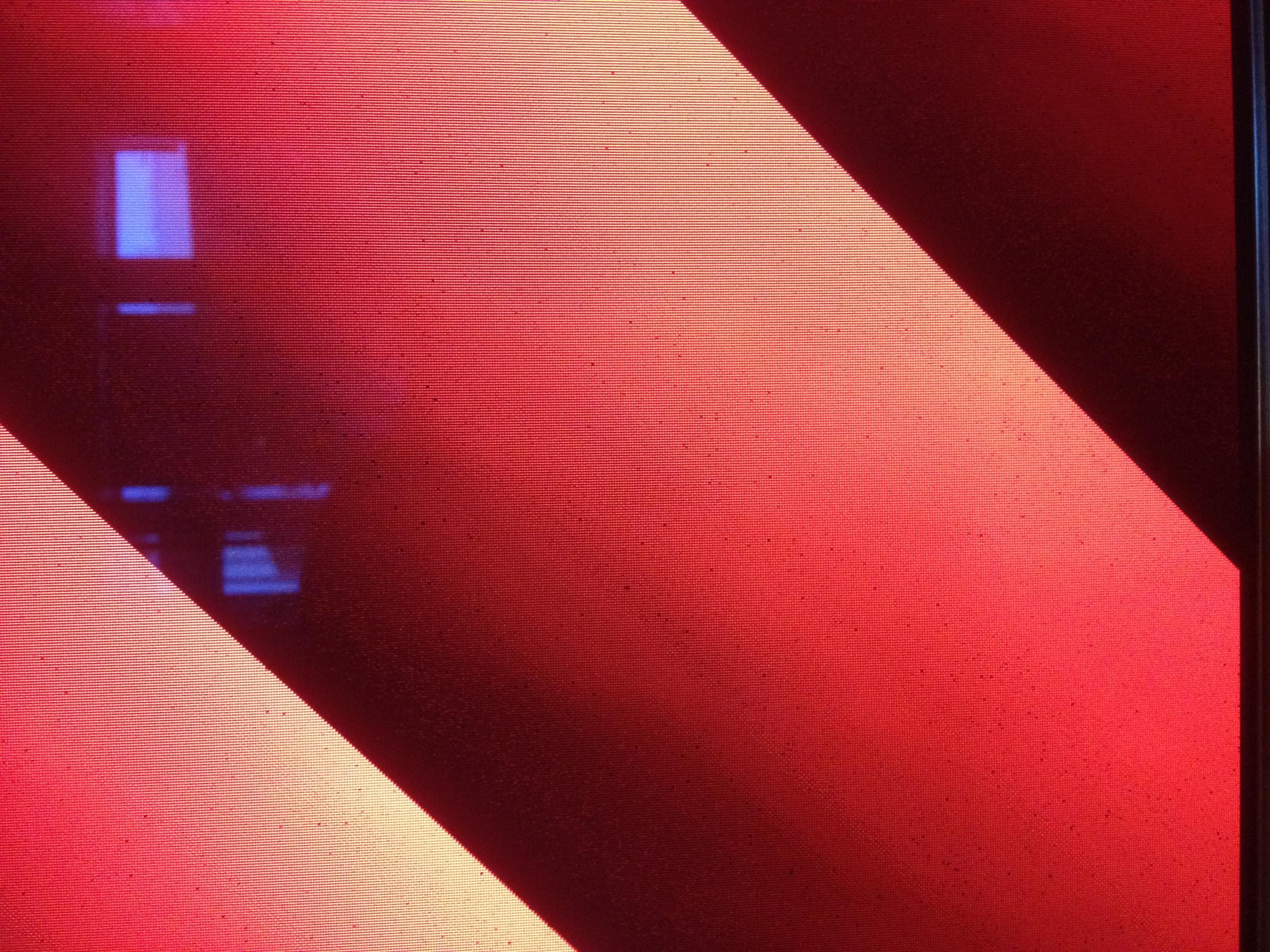

    VIERA TX-PR42GT30 Noise (black pixels)
    Hi.
    Purchased TV with 7 blinks.
    I repaired SN Board, everything works fine but this noise... It is clearly visible on green and red patterns.
    is that normal? Lifetime is 9500 hours.
    I have U30 tv with 10000+ lifetime and can't see any noise...
    Tried to play with VSUS on powerboard - no difference (from 208 to 219)

    Re: VIERA TX-PR42GT30 Noise (black pixels)
    Its normal but its not normal if you see it from 2/3 meter distance.
    Vsus has to be 215V from factory. U30 is a different panel and technique. All these ST/GT/VT models have the same "issue"
        No this SC board does not have potmeters. Only on the powerboard. You could set V-sus to high in service menu but this is normal , i have it on all my Panasonic tv's. ( Except cheaper sets like U30 ).
          My friend have 50GT30 with ~5500 lifetime and no visible noise.
          I see that noise only when I close to the tv - something like from 30cm.
          I can see that only on the patterns from service menu. I see nothing on a usual content like movies =) Just I wanted to hear another opinion.
