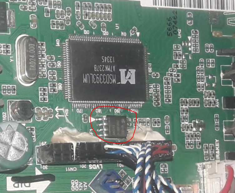

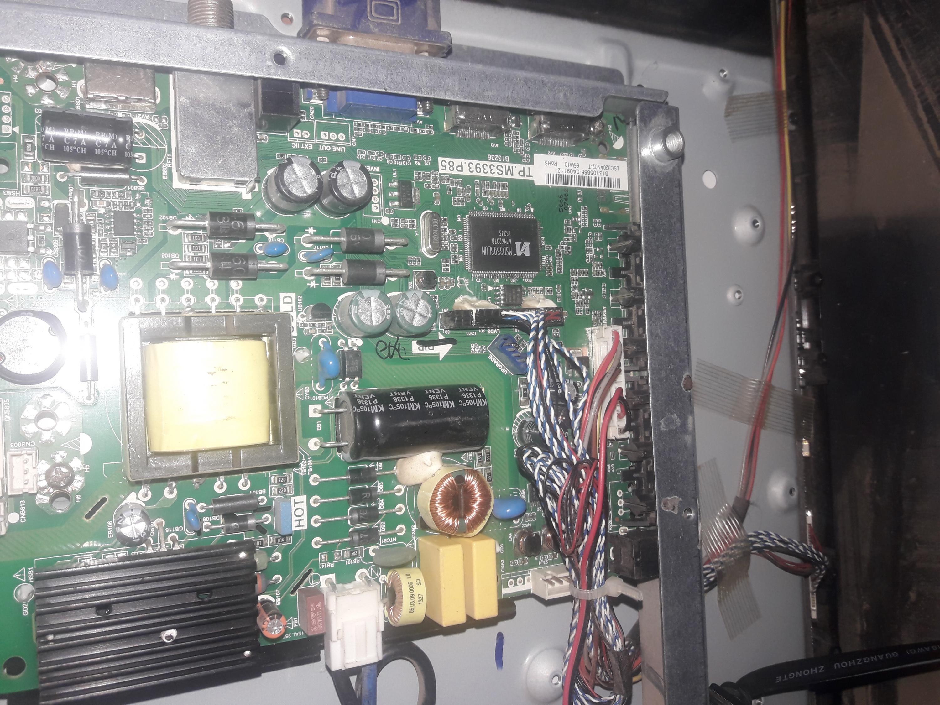

                        #1111
                        Re: Eeprom dump thread!
                        Pleas I want dump for seiki model se32hy27 main tp.ms3393.p85 think for help
                        • lotas
                          • Jan 2016
                          • 4831
                          • Russia
                          #1112
                          Post your own, non-working dump, I'll try to fix it.
                          • dodysallam
                            • Jan 2022
                            • 7
                            • egypt
                            #1113
                            Think you I want flash for tp.ms3393.p85 model SEIKI Se32hy27
                            • lotas
                              • Jan 2016
                              • 4831
                              • Russia
                              #1114
                              If the problem is in the firmware, then read the data (DUMP) from the spi flash and put it here and I will restore the firmware for you.
