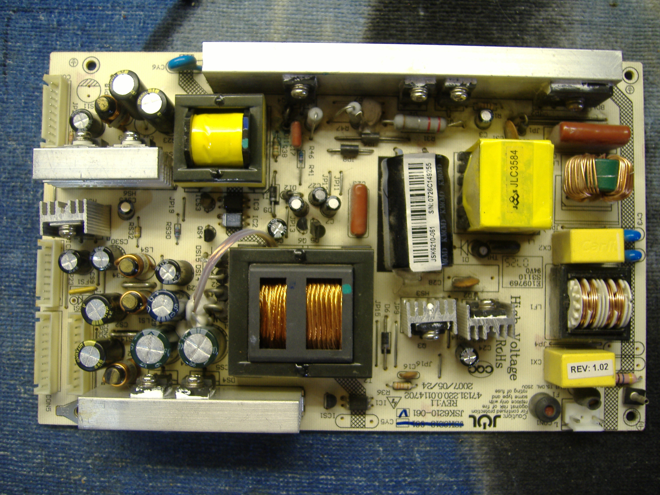

    Hi guys,
    I need help determining the value of two components on the power supply.

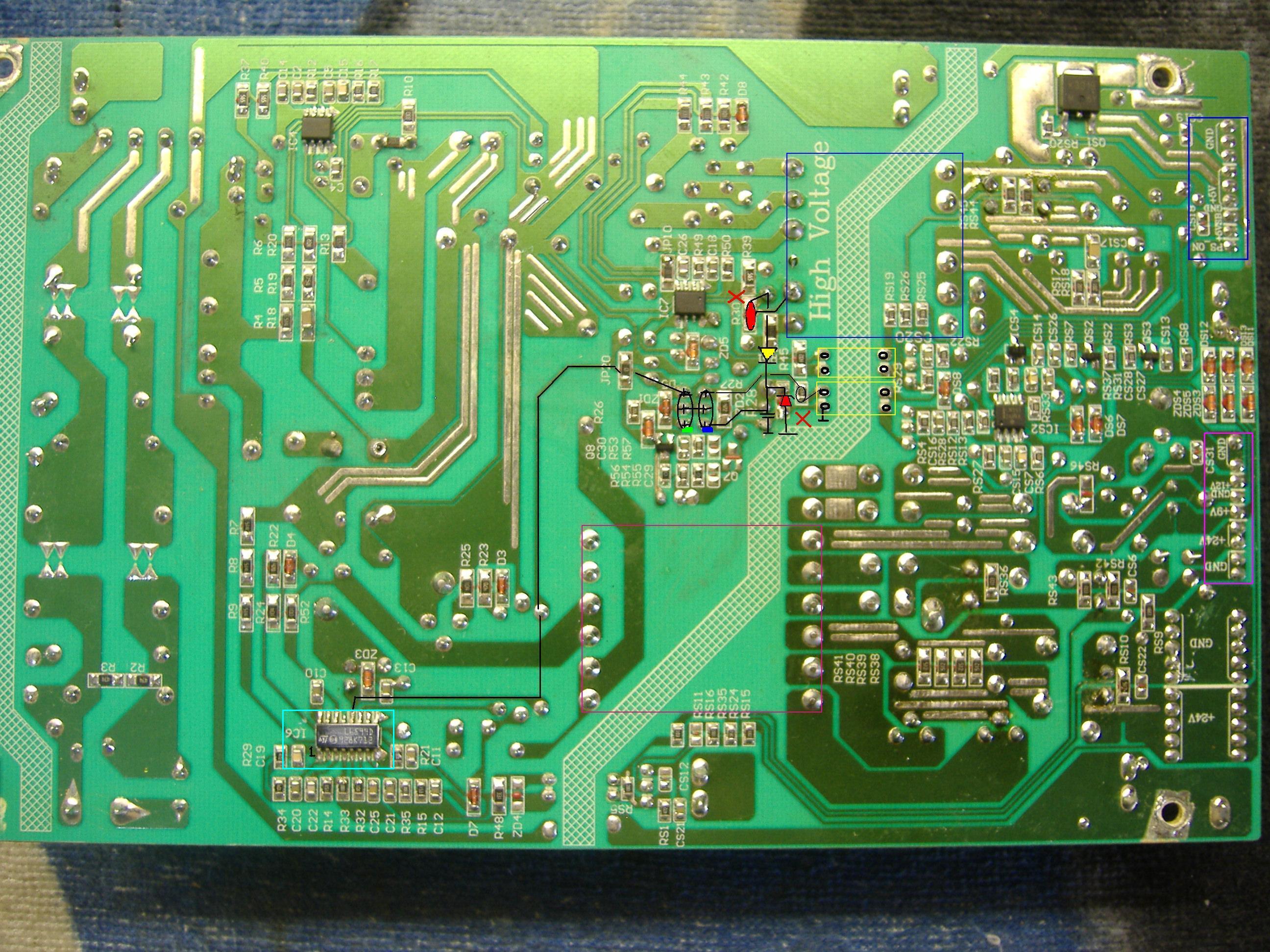

    I've included a photo of the pcb with the components high lighted.
    IC6 = L6599 Hv resonant controller Turquoise square. Vcc is pin 12 (self limiting).
    IC3 = opto couple Yellow square.
    Trans 5. 2SA1815 (on top of pcb) marked Green. measured okay.
    Trans 6. 2SA1015 (on top of pcb) marked Blue. Short/ replaced.
    Diode 9. (on top of pcb) marked yellow. okay.
    R30. determine value. marked Red. burned beyond recognition.
    Zener diode determine value. marked Red. short No inscription.
    I tried a 1 ohm (feed resistor?) in position R30. and 5v8 for the Zener.
    But set wouldnt switch on and both slowly got hot and burned black.
    I tried electro tanya for the diagram, but no luck.
    I'm hoping one of the guys on BADCAPS with design knowledge, might be able to determine the values. Thanks.
    I forgot to say the 5v stby is there, and the psu-on does appear when pressing standby button, with led going from red to green. I reckon IC 6 isn't getting a supply, so it cant drive the transformer responsible for generating the 9,12 & 24v rails

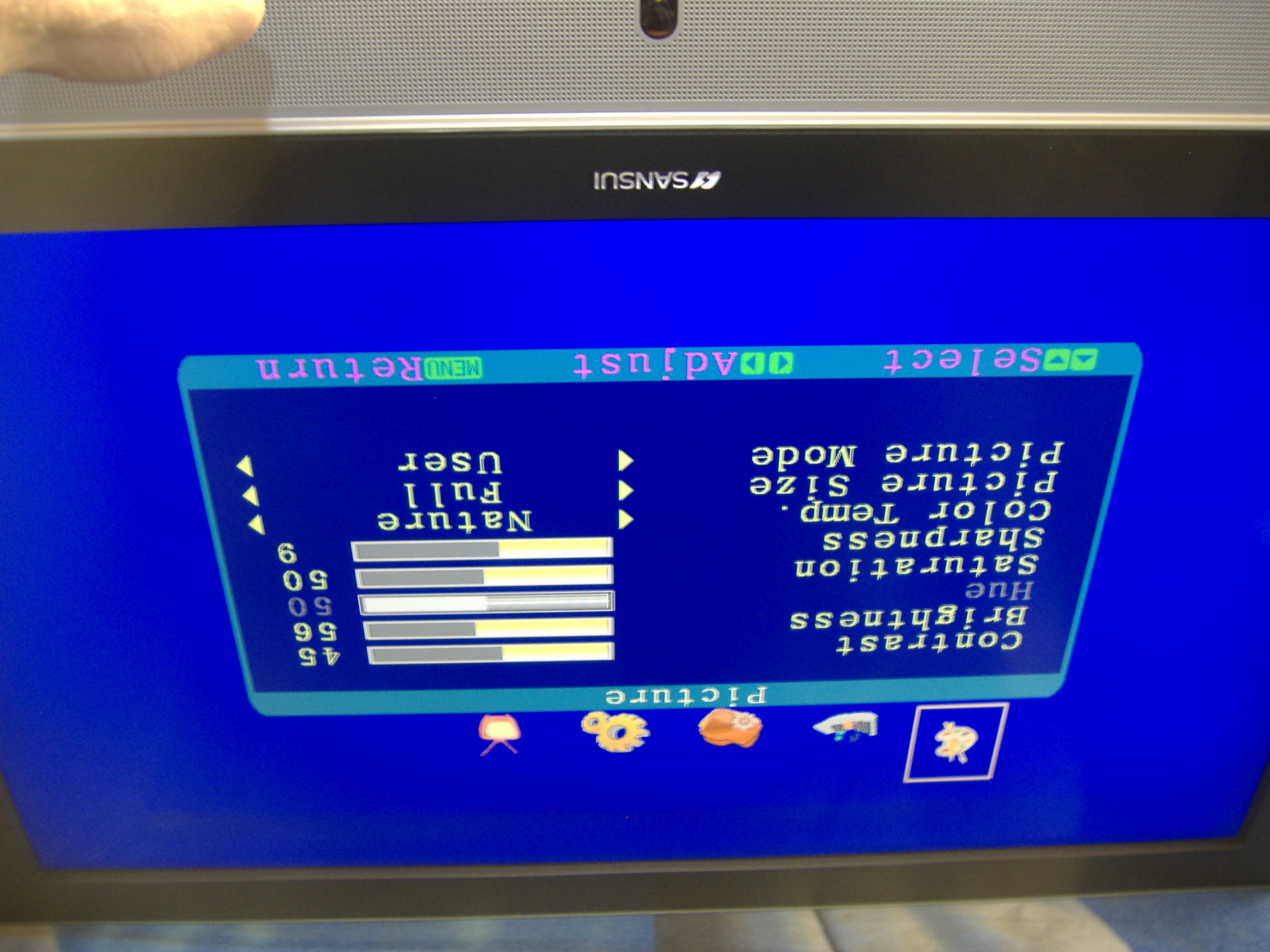

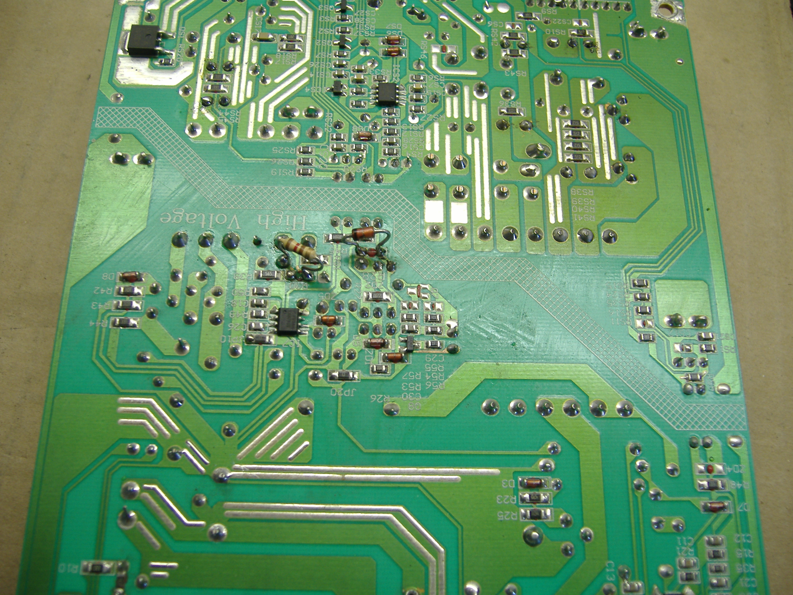

      Hi Guys,
      Took a chance and done a little experimentation.
      Replaced the burned resistor with a 120 ohm 1/4 watt resistor (photo 1)
      Replaced the shorted zener with a 12v zener.
      Set now switches on (backlights on), and working perfectly! (Photo 2)
      I guess the resistor was a limiting resistor, and the first attempt using the 1 ohm allowed too much current through, burning up the zener.
      I now get 12v across the zener in standby. 11.3v when the set is running.
      I now get 10.7 volts supplied to pin 12 (Vcc) on the Hv resonant ic.
