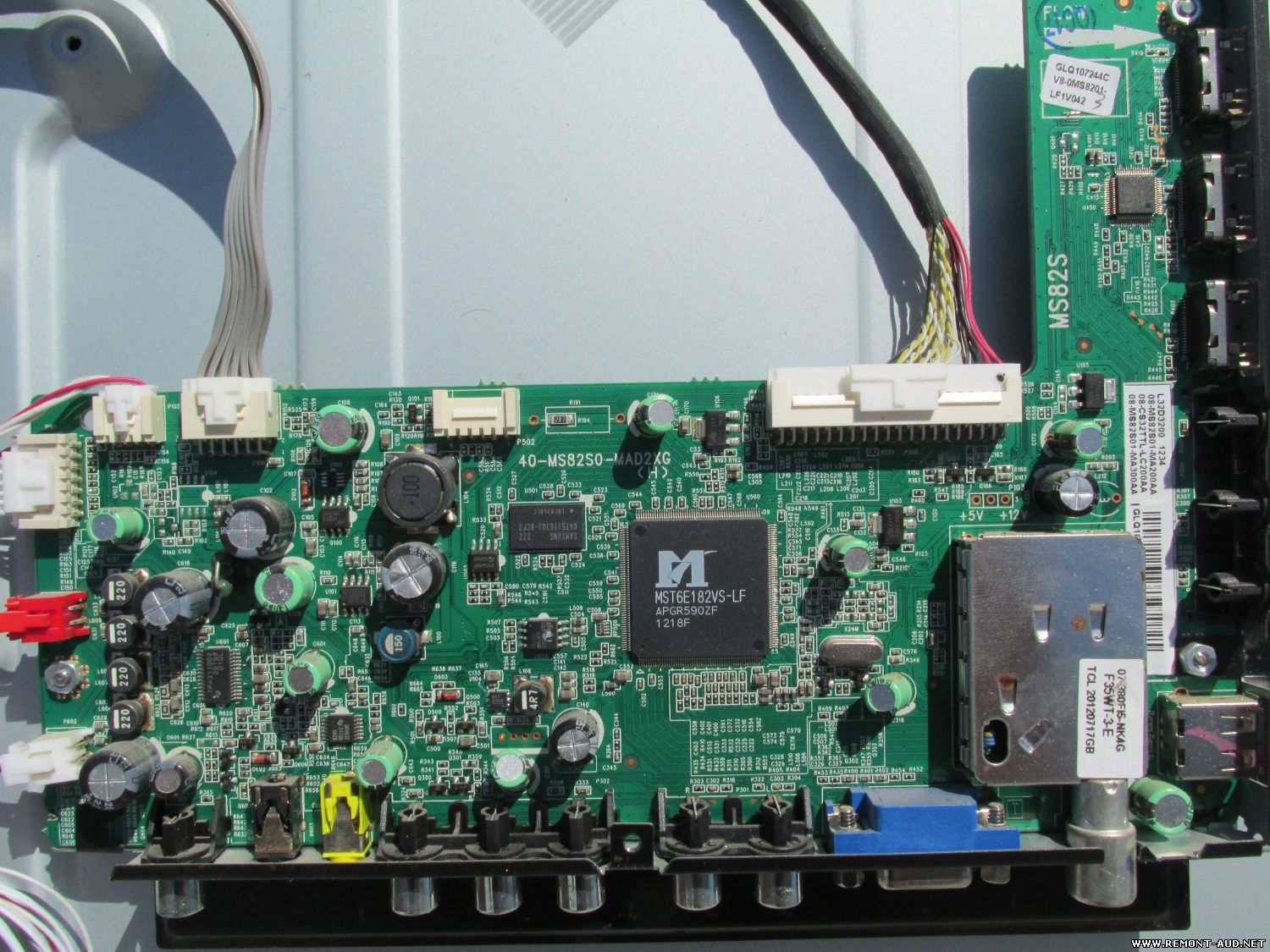

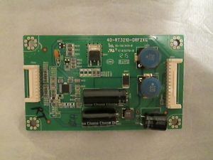

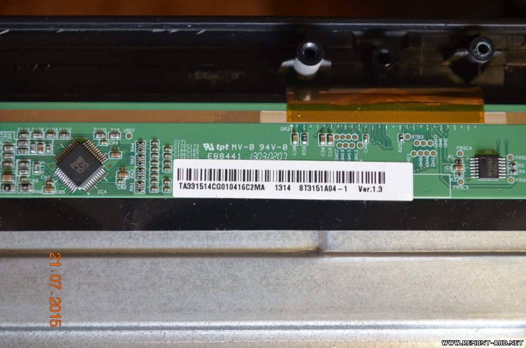

                    The board numbers are:-
                    Main board #40MS82S0-MAD2XG.
                    Power Supply #08-PE081CO-PW200AA.
                    Led Driver board #RT3210-DRF2X9.
                    T-CON #ST3151A04-1.
